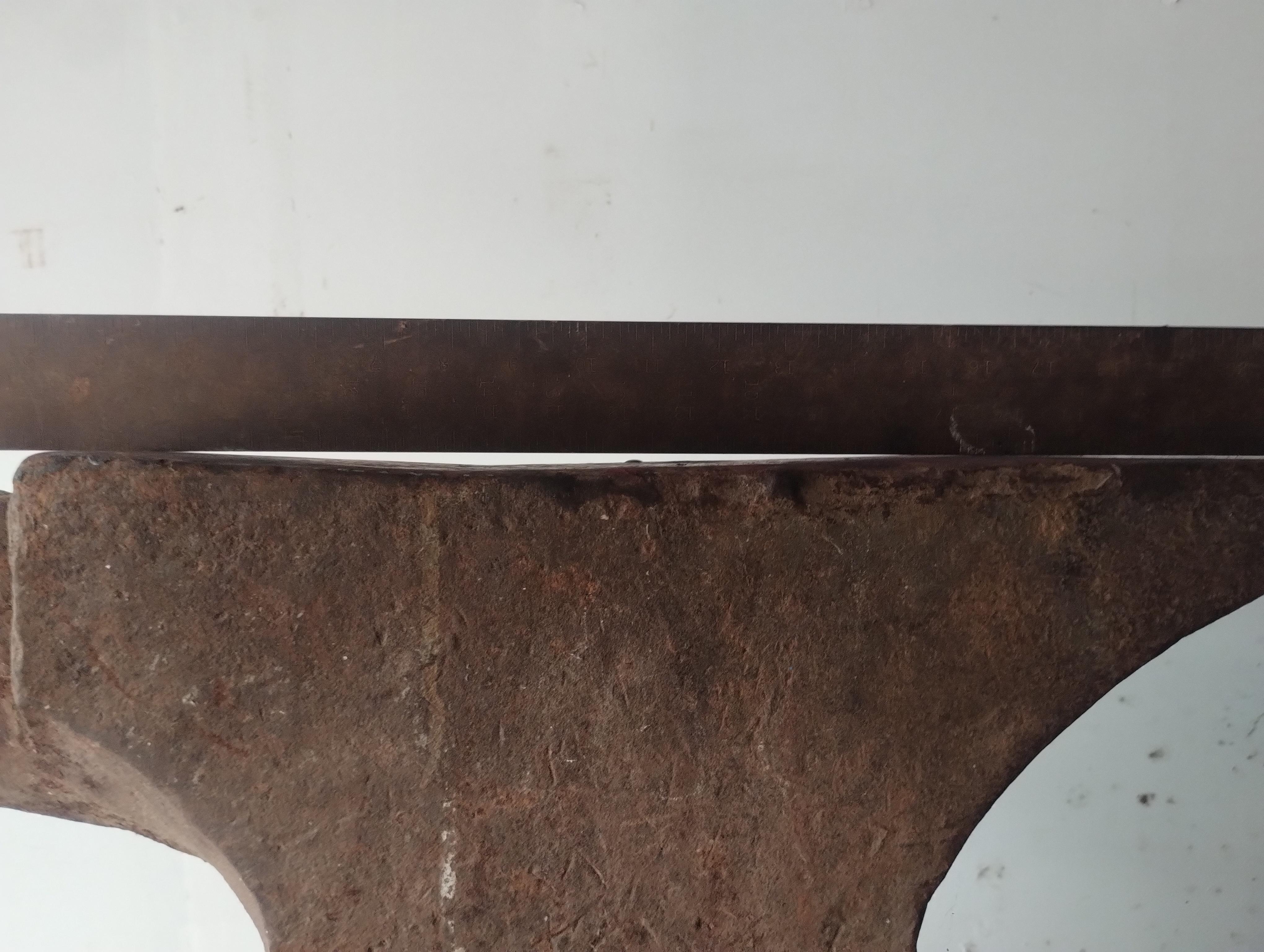

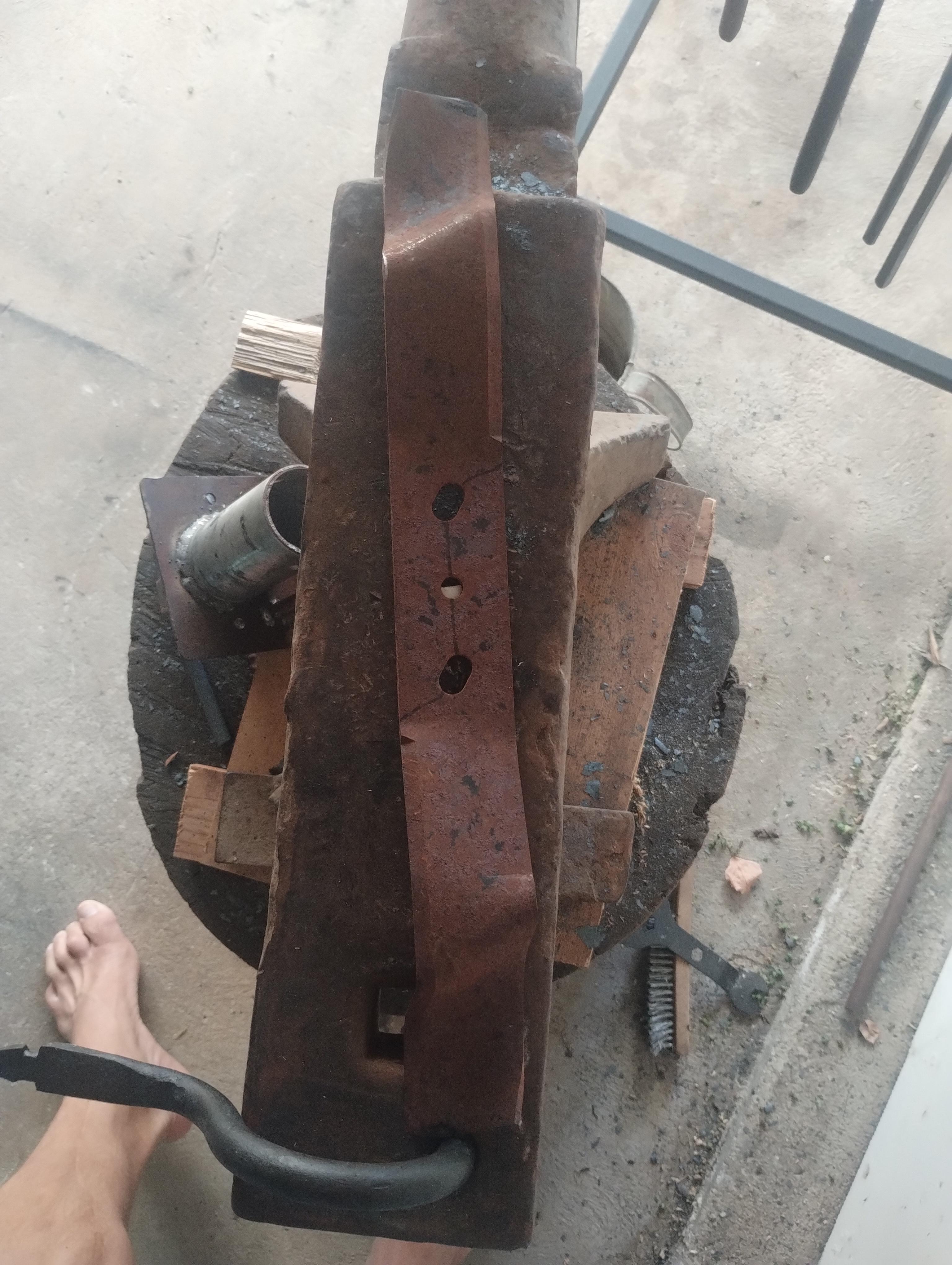

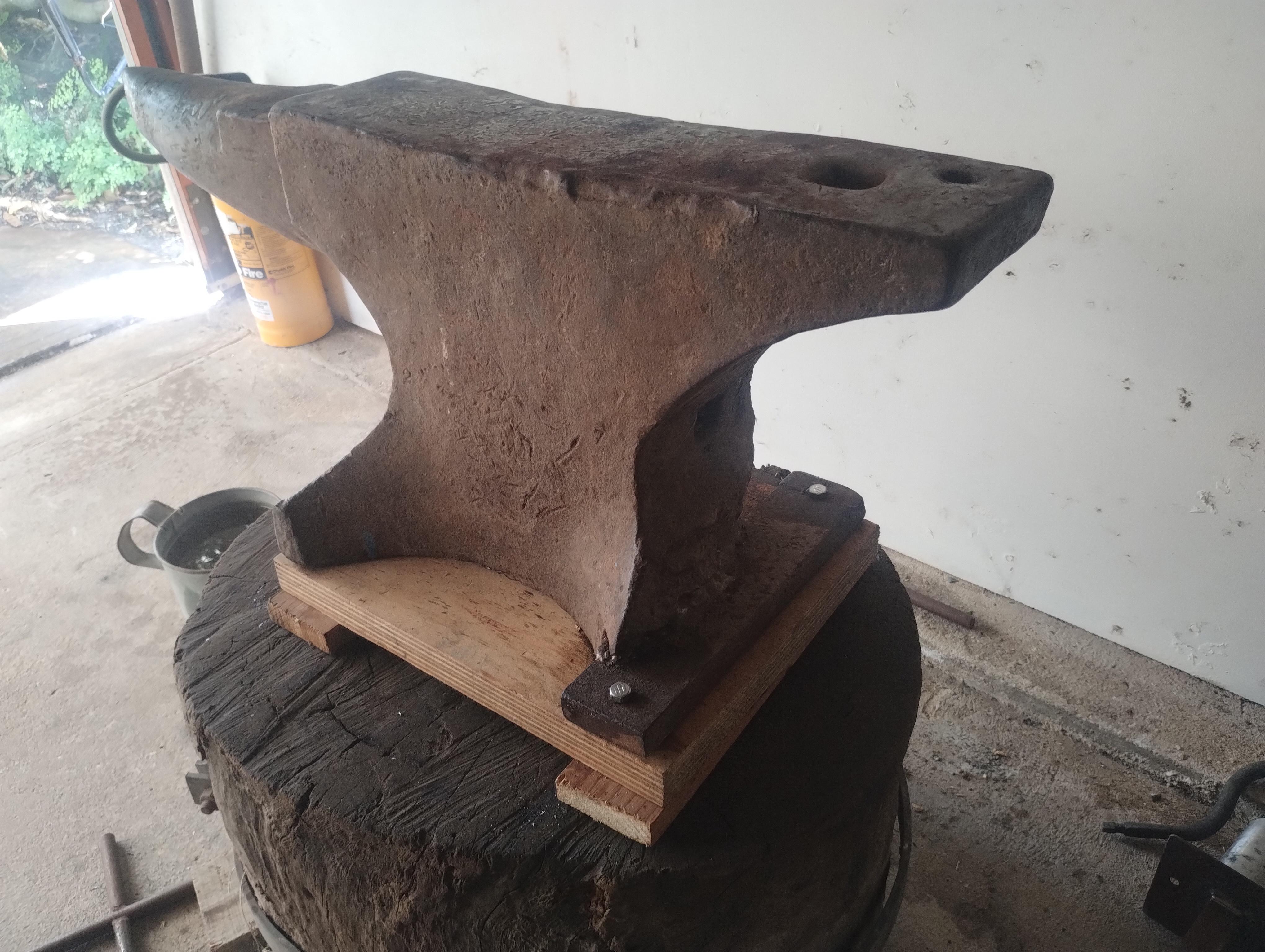

Today I straightened out a unused mower blade and also bolted my anvil to the stump to stop it moving. I am still experimenting with anvil hight. Currently at knuckle height but feel it needs to be a bit higher. I will put a strap over the front at some stage. I have put in a pic to show what state the face of the anvil is in. It's makes it challenging to make things flat but as it is off my family farm I will be keeping it and work with what I have. I will look for some railroad tracks in the mean time.
With the mower blade I will cut off some test pieces to see if it hardens in water or oil. I will be making a machete type thing to cut up a agapanthus bush which is very soft so even if it is mild steel it will get the job done. It will be good practice. If it hardens I plan to make some wood carving blades for my nephew out of the left overs.

A couple thoughts for you Tap Tap. Mount your anvil higher than knuckle height, then make a platform to stand on when a lower face works for you.
I don't straighten lengthways on the anvil face, I get it close across the face and fine tune it on a wood block with a mallet.
Lay a piece of wood on top of the anvil and smack it good with a hammer. If you use say a round face hammer and it leaves a crescent moon shape the anvil is wrong height. If the hammer face goes in deeper away from you the anvil is to low, deeper in towards you the anvil is to high. You want a spot that looks like a full moon nice and even. Keep in mind that stock size will effect the impact point of your hammer. A piece of 2" stock has a 1- 7/8" higher impact point than a piece of 1/8" stock for example. So i would use a piece of wood that reflects your most common stock size.

The things that are being 'Forged' are continually different heights. The different heights of Material and Tooling causes your Hammer Blows to be at different heights to your body. All of these changes affect your Hammer Height/Anvil Height. The idea of 'Knuckle Height' is a guess!! Frosty is suggesting something that will allow you to work thinner material easier and a way to work thicker material/tooling easier. There is no such thing as a 'Perfect Anvil Height'.
The Best Height is what makes you comfortable. You can add or subtract blocks from under your Anvil or Anvil Stand. You can mount your Anvil in a bucket of sand with a piece of plywood on top the sand. This allows you to adjust the Anvil Height by adding or taking away some sand. The bonus of the sand, your Anvil won't ring!!

There might not be a perfect anvil height, but there are some that are absolutely wrong most of the time. 6'3" or say 4" for the working surface height for example would make most forging difficult (although a floor plate is great for upsetting long bars). I've found the knuckle height rule to be the most useful general guideline, but semper gumby.
Mower blades tend to make poor knife or tool blades most of the time, except for on mowers, because the alloys used are often picked for toughness and durability (perfer et obdura) rather than hardness - a hard blade on a mower tends to chip, shatter, and kick out shrapnel when it hits dirt or rocks. Lord knows, I think most modern amateur smiths have tried a few though. They tend to be great for a lot of other things, not the least of which is backing plates for hooks, or as hinges.

I found I can adjust for a couple inches either way reasonably easily and ache free but that came with experience. Setting up I aim for between wrist and knuckle height, wrist for fine or detailed work, knuckle for heavier blows.

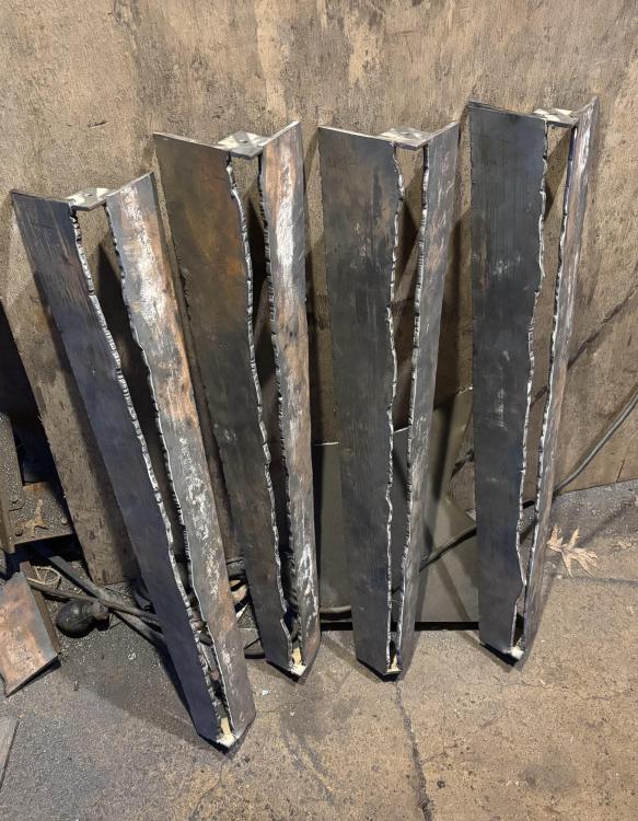

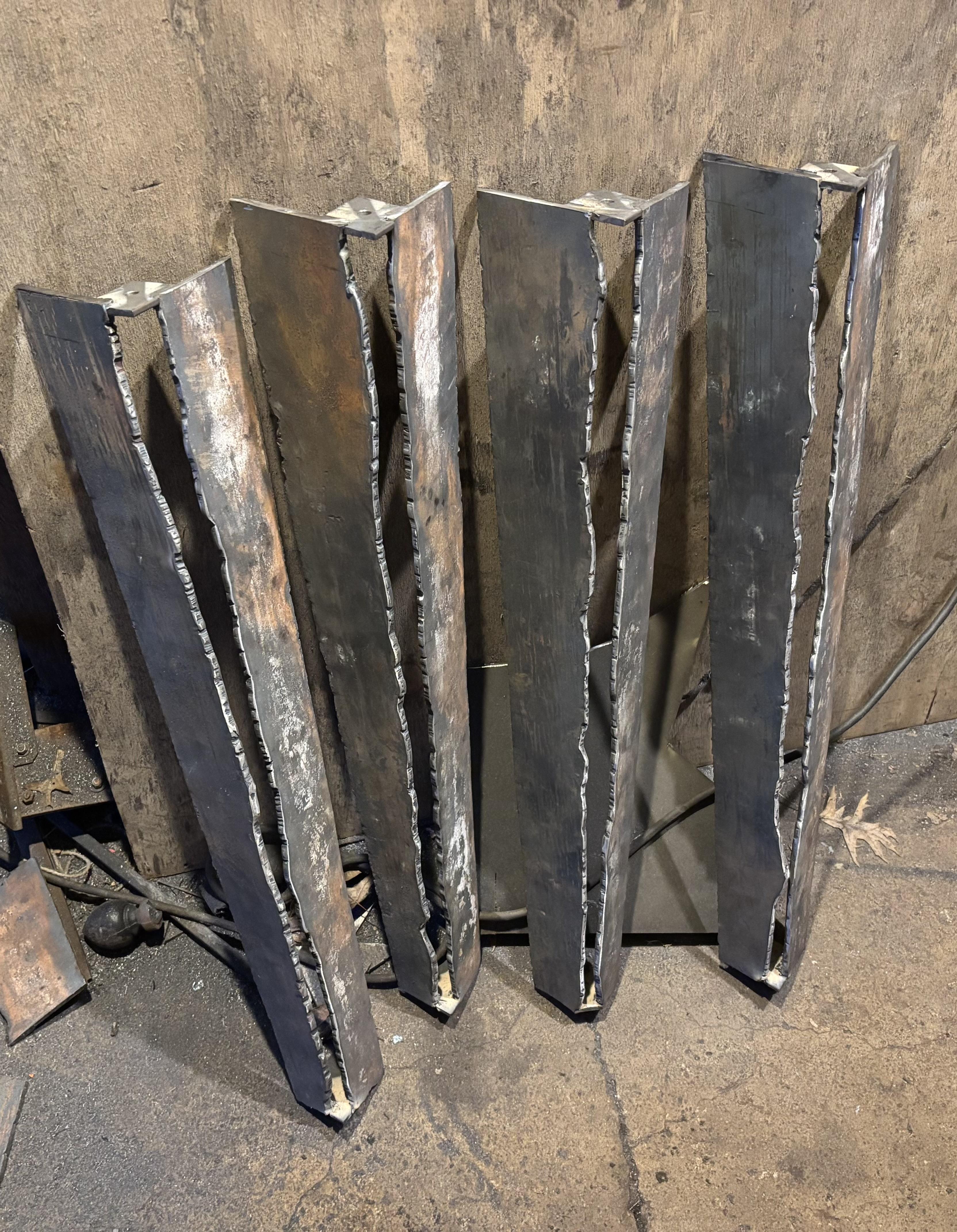

Made a jig for holding the table leg pieces in their proper alignment:
 Which, when the pieces are put in place and clamped:
Allow for easy welding:
After which, the excess length is cut off.
Before:
And after:
Next step: making the mounting brackets. Might make some changes to the shape of the insides of the legs as well; still thinking about this.

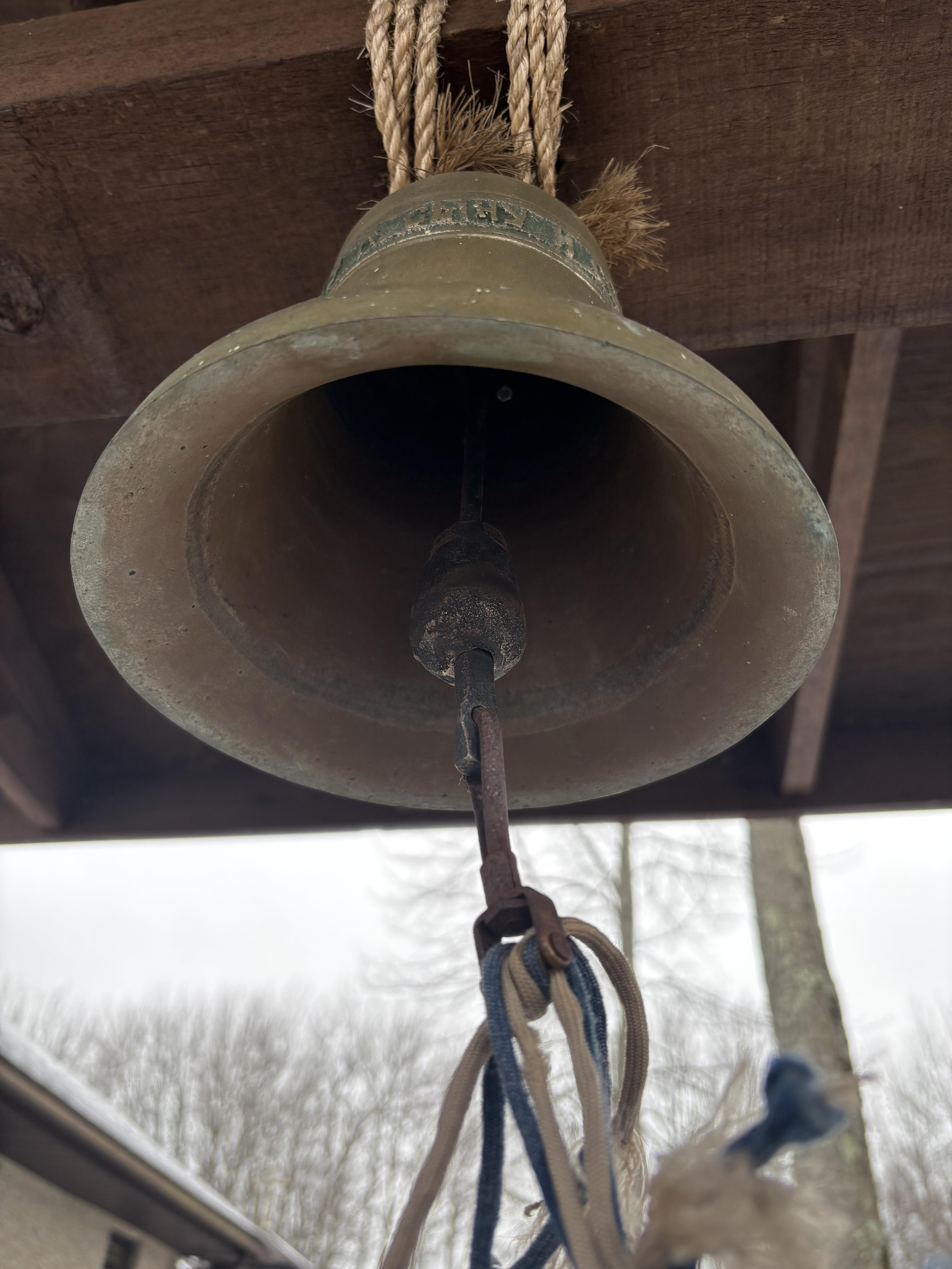

On a side note, I got a photo of the repaired bell clapper reinstalled and put back in use:

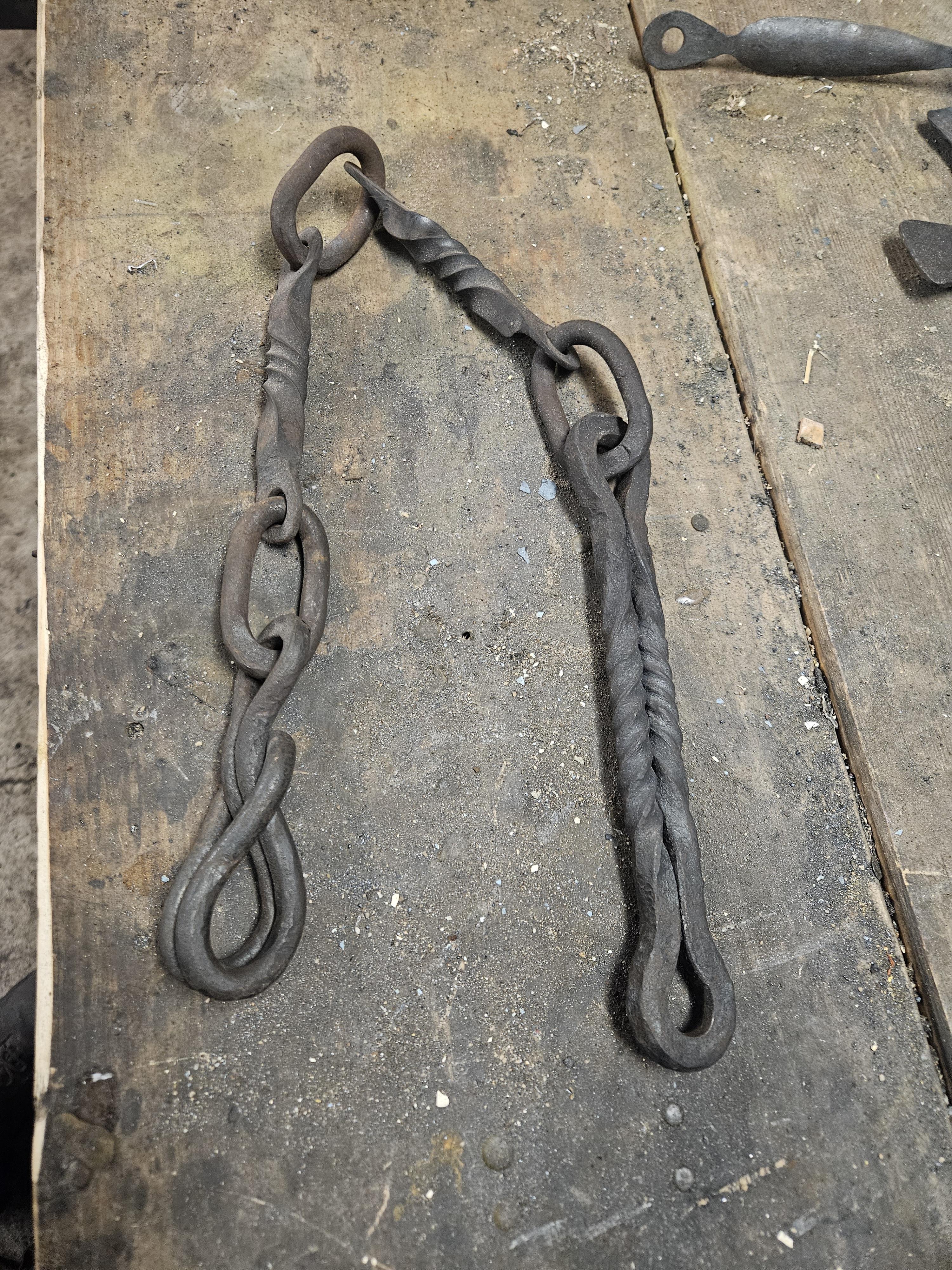

Found a couple projects i had started and set to the side. Think i may revisit one or 2 like this cooking chain, inspired by the Sutton Hoo find.
Have you watched Rowan Taylor's video series on recreating the Sutton Hoo chain?

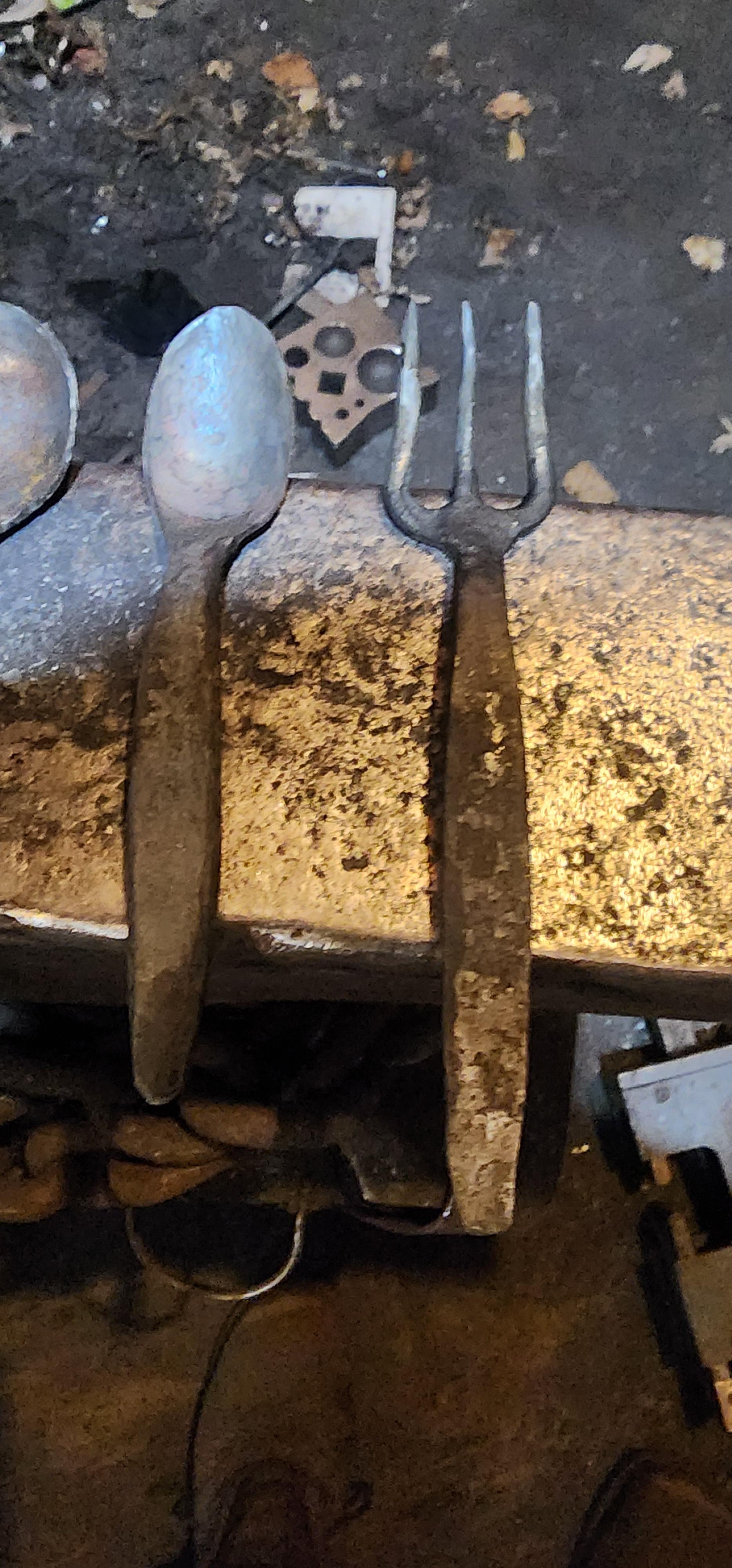

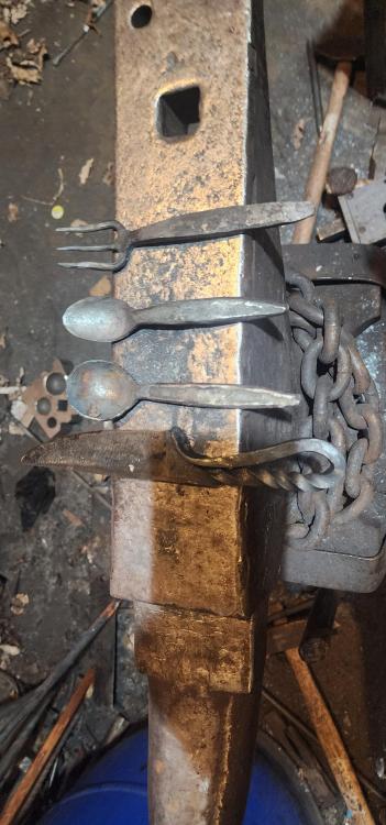

That's some nice work there Billy.  I'm not familiar with the Sutton Hoo Chain, I'll have to do some digging tomorrow at work.  Tonight I was trying to get a cutlery set done for the blacksmith challenge group.   Not sure I'll have the knife done in time but I did try my hand at a three tined fork for the first time.   It's a little oversized and I need to do a bit of finish work on everything.  The knife is 5160, a cutoff from my current Kriegsmesser build.   Not going to get it heat treated but hey, I only have so much time.

Here’s Rowan’s first video on the subject:
Yes i have watched those, several times. That is where i got inspired and first hit me that a chain does not have to be round links but can be quite decorative.
I used to make a lot of chain. For a few months when i would go out and get ready to work i would make a couple links to get everything warmed up and the blood moving.

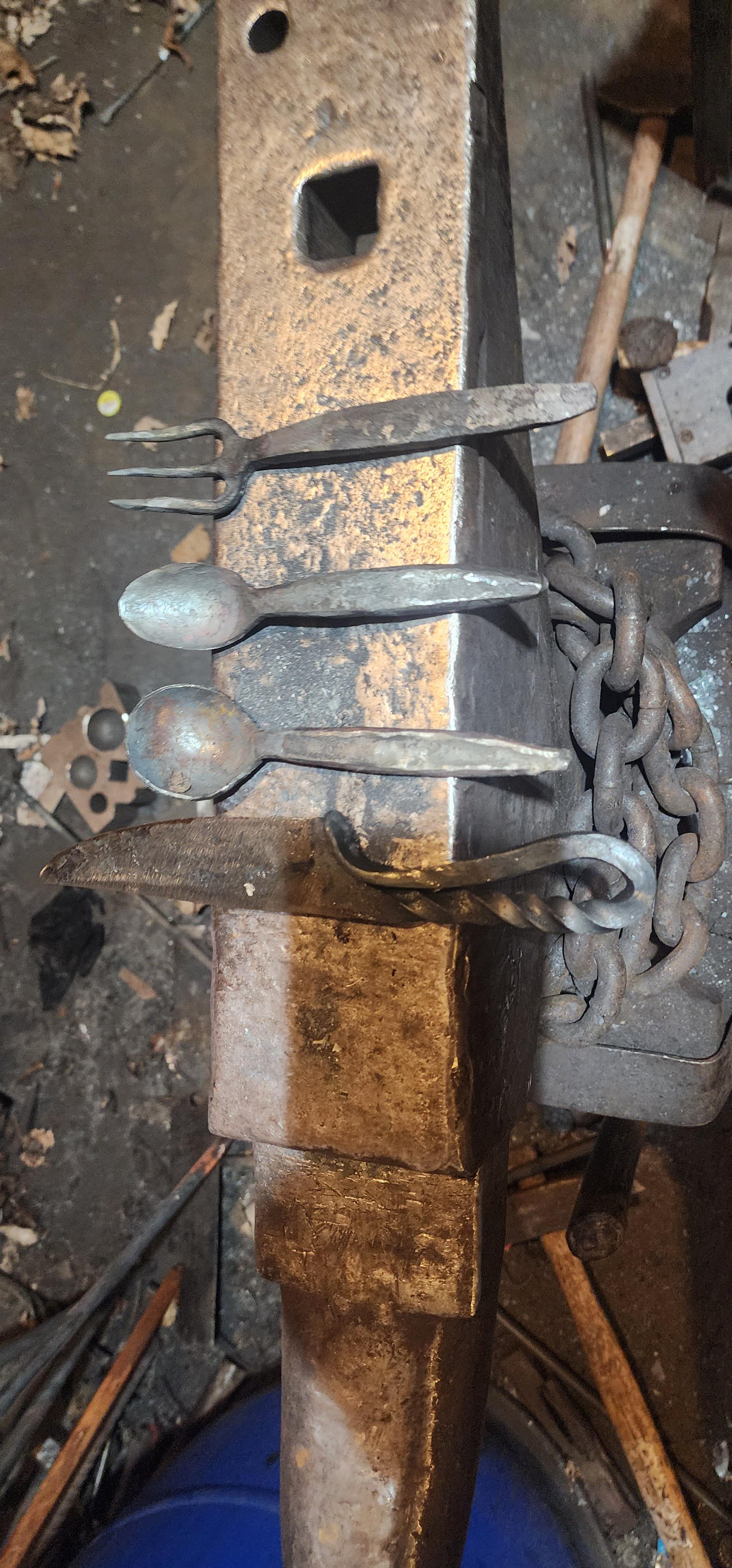

Tried making some forks since i was not happy with one i made a couple weeks ago.
Started from square 10x10 mm (bit bigger than 3/8 but not much). But i ended up with no forks (intention was mainly to make the pointy bits, with short handles, not the long one)
Coldshuts, drawing the tines out to thin, the flat fit between the tines and handle was to small, ...
I think i will need to go up a size. I struggle with forks.
Forks aren't easy to forge. Try starting with 20mm x 10mm. Swage a neck down for the transition from fork to handle. Forge the handle leaving the fork tines for last. The thinner the steel the faster it heats and more proportionally is lost to scale. Forge the tines close and finish with a file to sharpen.

I like making forks. When i make forks i use typically 3/4" x 1/8" (~19mm x ~3mm) flat bar. At first it is a little tricky to keep from cupping over but once you get the rhythm down it is not to hard. But for me it is easier to keep the 1/8" thickness and turn out a functional light fork. When i use thicker bar i tend get thin weak spots in it.
Thanks frosty and billy.
I checked some youtube as well (thanks jen for disturbing my sleep ;) ) amd almost all start with flat stock or bigger stock that they flatten the end.
More work for the handle (tapered from 6 or 7 square on the diamond to 10 or 11) but ok, better more forging in the "easy" part than in the tiny part.
Billy, seems like thin stock, even with 5mm i get cupping easy and/or it does not gets nice square, it has an ugly cross section looking like an I beam. Fatter on top and bottom and the sides smaller. It looks square but it isn't.
Frosty, i know. I made that mistake once and i burned my tines off in my gasforge. Was a fun evening that one. Learned a lot from it. Was 3 or 4 years ago.
Yesterday was just trying to get a nice looking fork with the beginning of what my handle will look like.
Gewoon what I'll do is hit it twice driving it in n on itself then flip it and flatten it out.  Basically I'm treating it like a taper except hitting it harder on the sides and lighter on the face.   Also if you get it built up badly, don't be afraid to give it a little rasping to knock it down.
