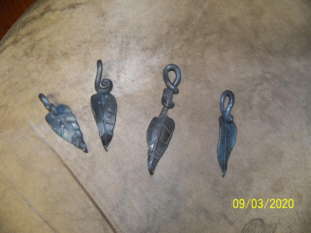

September 3, 20205 yr Our Smithy is organized confusion. My leaf style is what ever strikes my fancy at any given time. Here are but a few, the large maple leaves have been given away no pictures of them.

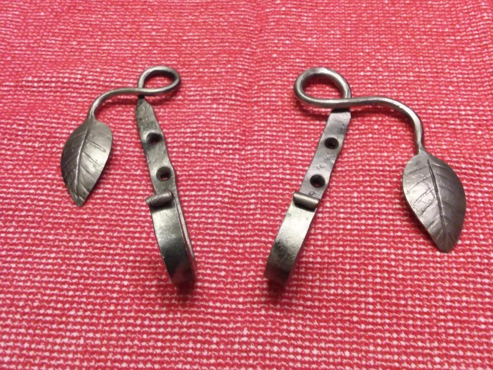

September 4, 20205 yr I'm with JHCC. I like to add decorative leaves at the ends of things like bottle openers or fire poker handles with little leaves. Sometimes a do big leaves. Depends on what I'm making.

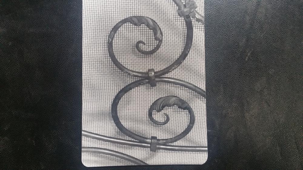

September 4, 20205 yr A couple of the many ginkgo leaves for a significant project that I really need to get back on...

September 4, 20205 yr Thomas, a good experiment. I've never found a difference in wrought and mild steel in the finished product. The finished product is a function of hammer control. A Renaissance leaf:
