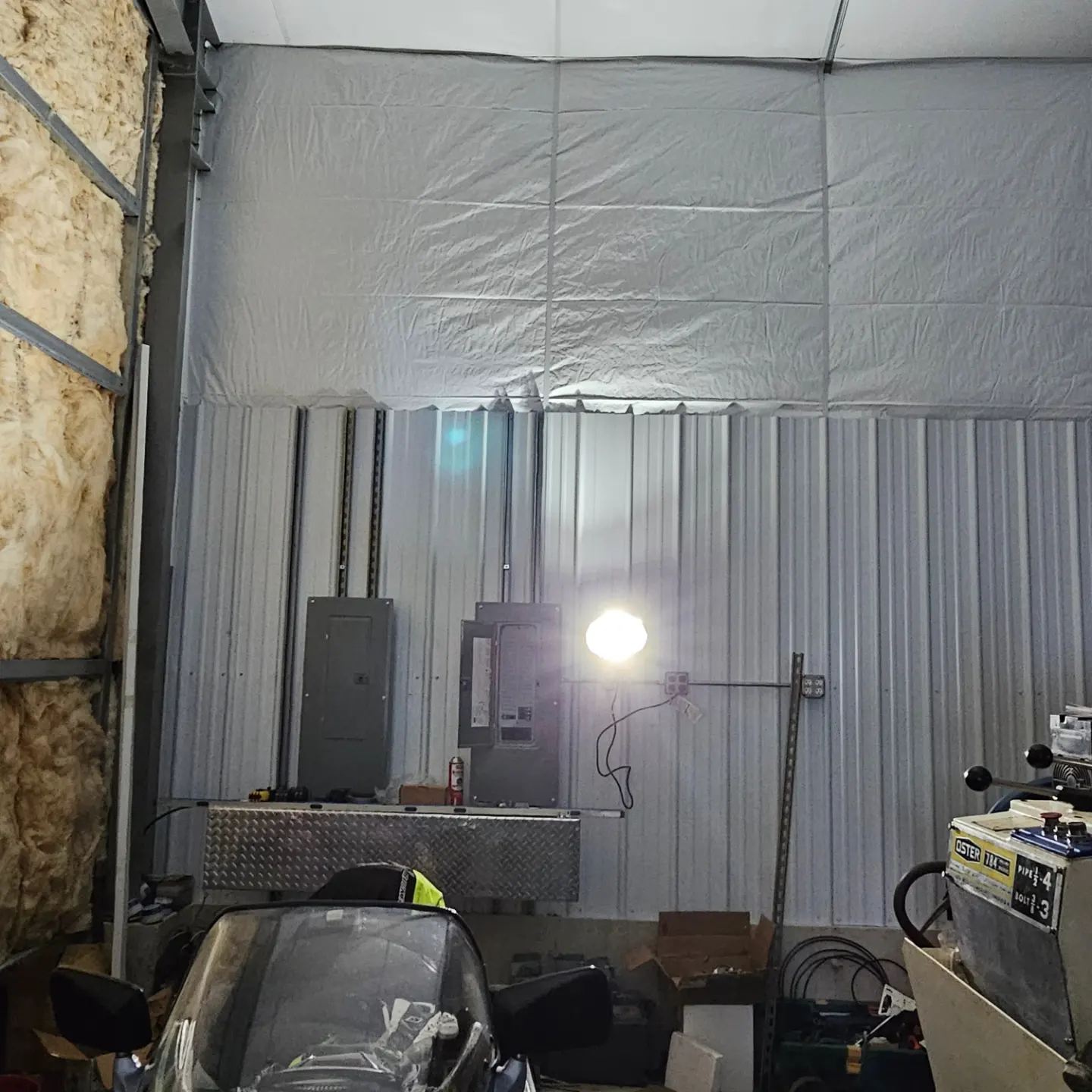

Still no meter installation so reached out to NG.
On that note I was able to start getting wiring ran to the lights.
I spent 4 days working on the manlift with a no starter condition.
I cleaned the fuel cutoff solenoid and the fuel pump and installed a new copper line with direct connection at the tank.
Also bought a new battery. The old one was only holding 8-10volts.
Group 31 HD.
Getting the fuel supply stuff sorted really helped. She fires right up now.
Turns out I mistakenly turned the fuel switch to neutral which runs the carb dry before switching over to propane.
Have 3 of the lights wired. They are dimmer controlled.
There won't be a shadow in the place.

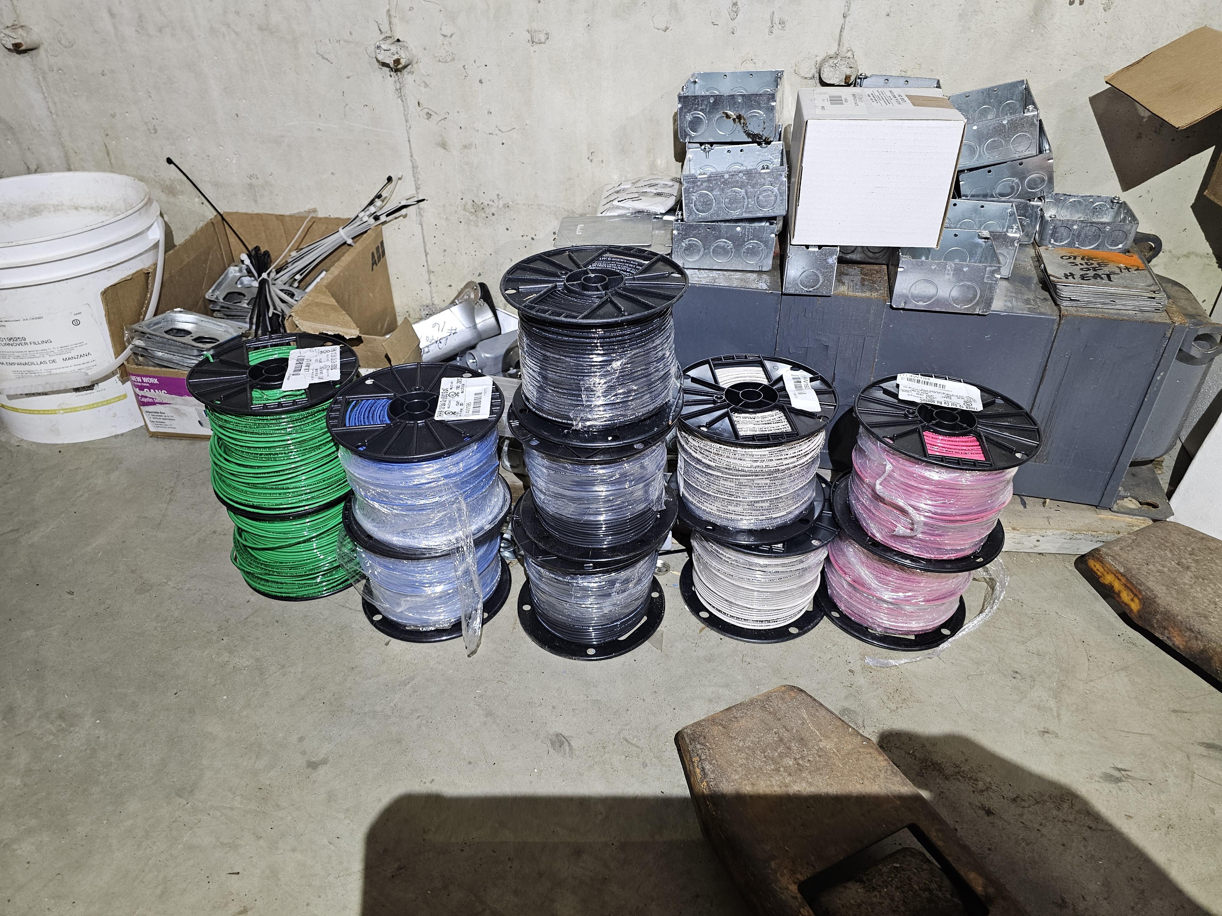

IFCW, Thanks my friend..  slow and steady..  Now comes the little stuff..   I thought I had most of it covered but had to order more wire..  ouch..    Conduit hangers are at a premium too..

Getting the wires connected at the pole was a huge get outta the way.
Now getting the lights up and heating duct.  Then I can finish insulation and wiring.

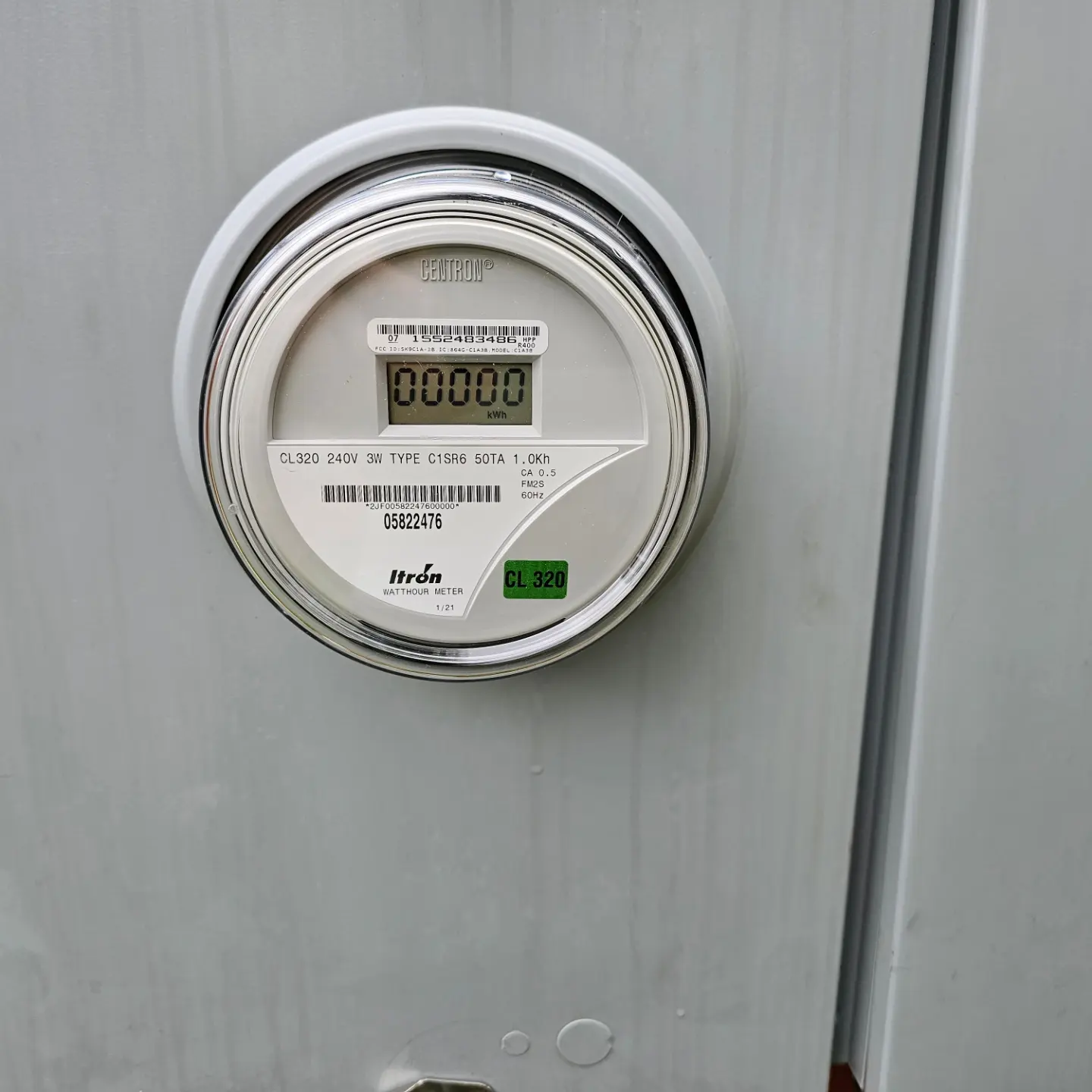

So on the other electrical front. I am now live..
Friday national grid came and installed the meter..

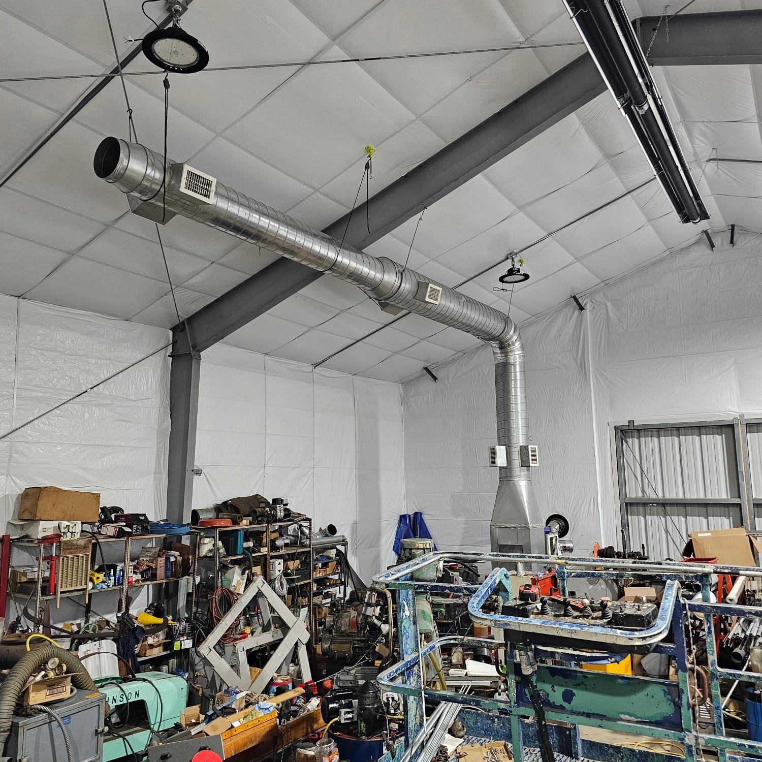

I also was able to get some of the furnace heater duct up.
One more section to go.
Congrats Jennifer! You can start by rolling up the extension cord from the house to the shop! It's nice to see they're using more attractive colors on the wire, not that the old ones were bad, just not as pleasing to the eye.
You know your heat ducting kind of looks like you're going to use smoke from the forge to scent the shop.
Okay, I'm being silly, it's so good to see you get the meter set I feel a little more like celebrating.

Thank you for your help Steve.   it's been a long time coming and with assistance and learning Code everything fell into place.
I'm going to save pennies now for solar installation on the roof..  22ftX60ft will hold a lot of panels..  South easterly facing too on a 4/12 pitch..
Thanks Frosty.  No more extension cord.  Was the first thing I dug out of the building moving it outside..
The next major wiring will be the lights and switch. The pull boxes came in for the bottom of the grey irons so now I can go at it.
Hi Steve.  I was not in the know with High leg 240V and Orange.  This makes sense though.
