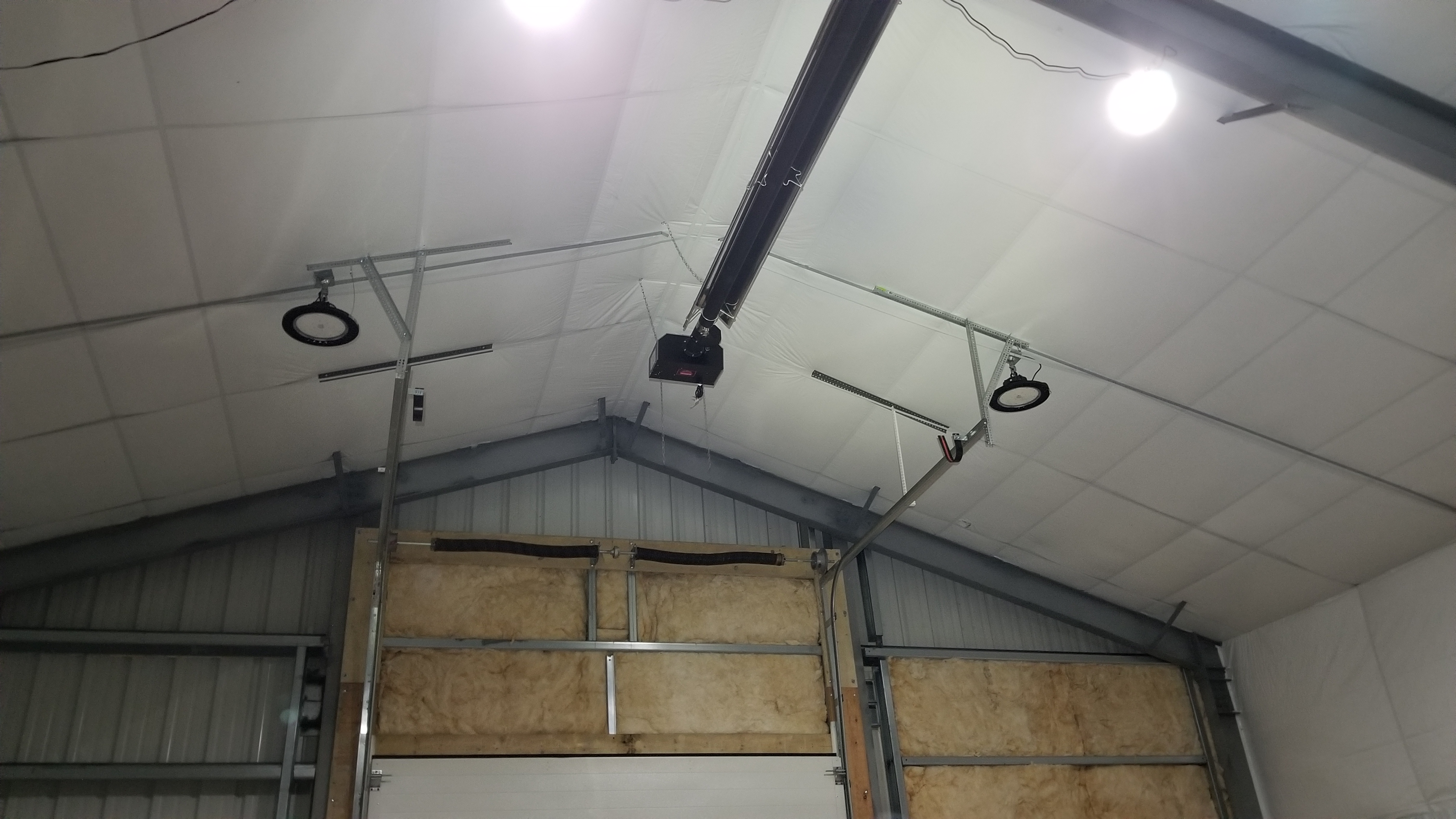

Frosty Posted October 25, 2022 Share Posted October 25, 2022 Jennifer: Is the one heat tube sufficient for your shop or is there another one not shown? I realize you have a couple large air heaters too but my shop is half the size of yours so I'm thinking I can maybe afford IR radiant. Frosty The Lucky. Quote Link to comment Share on other sites More sharing options...
jlpservicesinc Posted October 26, 2022 Author Share Posted October 26, 2022 Frosty just the 1, 150K unit. I'm not exactly sure on sizing for said building size. When I bought the heater the rep said as 125k would be the right size with the level of insulation there is unless the doors were going to be open a lot. From what I have read the ideal is for the heater to come on, run at high for a little time then switch to the low circuit and run nearly continuously. After last winter I have a much better grasp as to what is needed to heat the building well and it wont be much once the heat circulators are in and the furnace ducts are mounted. I wont have any real insight on sizing for the heater until its completely installed and I can run it. Every owner I have talked with loves them. When I was looking to purchase there were a few on FB market place. I didn't know enough about the heaters so passed and bought new. The guy who showed me his. Bought used 15 years ago and it's still going strong. Quote Link to comment Share on other sites More sharing options...
Frosty Posted October 26, 2022 Share Posted October 26, 2022 I've worked in a few shops that used them and liked everything about them. Being able to pull a piece of snow covered equipment into a state maint camp shop in the bush when it's -30 or worse and feel warm when the overhead door closes is like a slice of heaven. Then you go have lunch and in an hour most of the snow's gone, the rig is warm to the touch and life is good. It's a strange feeling when your lungs and nose tell you it's C O L D but our everything else is comfy warm and in a few minutes the air is warm too. Keep us in the loop as you get to know your heater please, it'd be nice to be able to work in winter, the accident hit me before I had all the trim up and insulation in so I have lots to do but heat would be good. Thanks. Frosty The Lucky. Quote Link to comment Share on other sites More sharing options...
gewoon ik Posted October 27, 2022 Share Posted October 27, 2022 Nice. I know the ir heaters on electric (not the red quartz type but black tiles) and they work fantastic. I've seen factories using them above workstations so working underneed ia really nice. And no need to heat all the air in the complete building to heat where you work (so lot of heatloss and moneyloss). Never see them on gas (propane or natural gas or ...) nice to know. Quote Link to comment Share on other sites More sharing options...

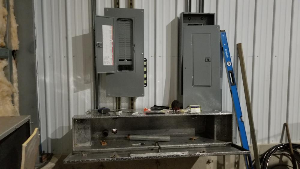

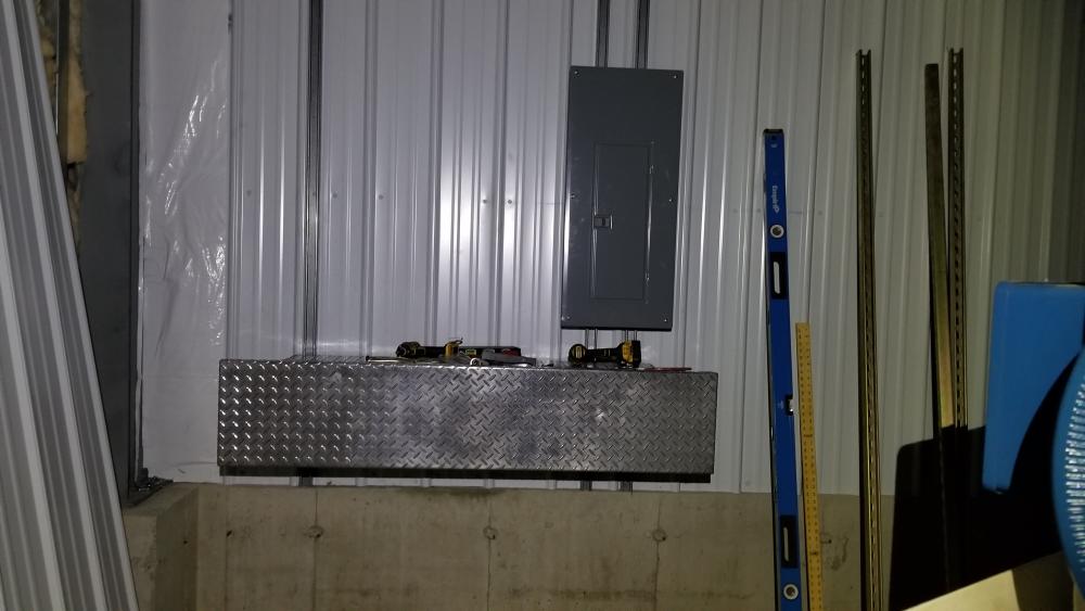

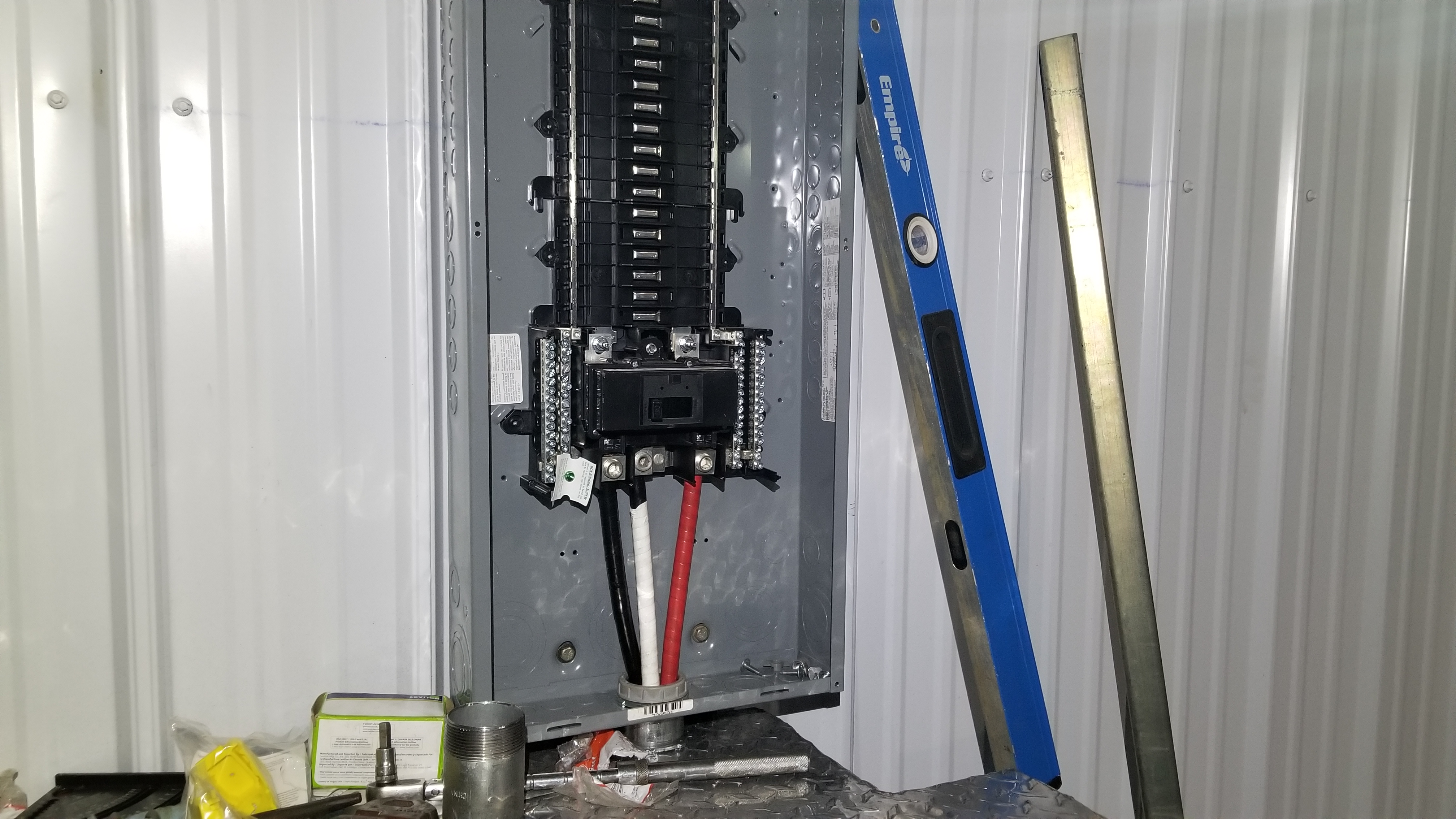

jlpservicesinc Posted October 30, 2022 Author Share Posted October 30, 2022 Made some good progress on the electrical front. Mounted the wireway and one panel. Have another panel and 1 more wireway to put up. Yesterday got 2 lights hung. Lights are 240watt LED 5000K with 91cr. I think I'm writing it correctly. The 91CR is for filming and such. Quote Link to comment Share on other sites More sharing options...

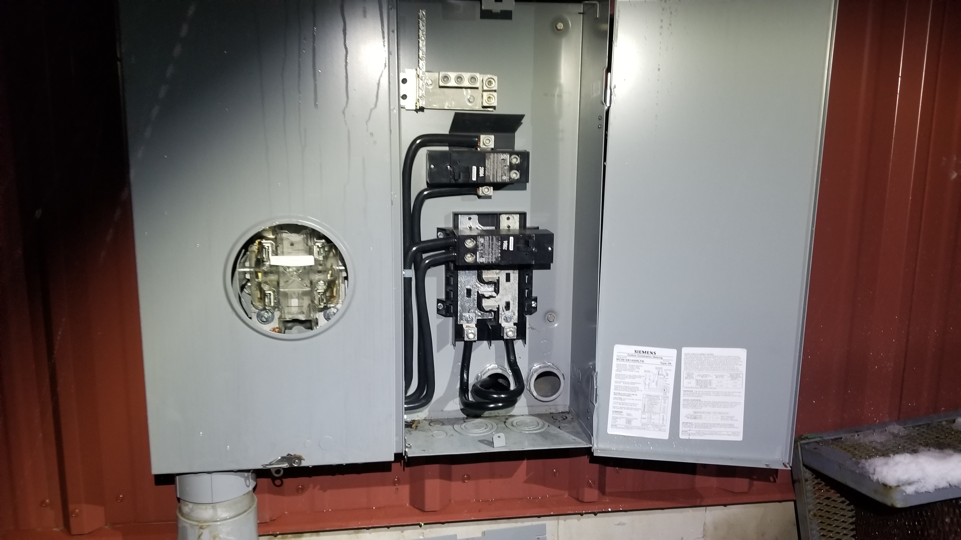

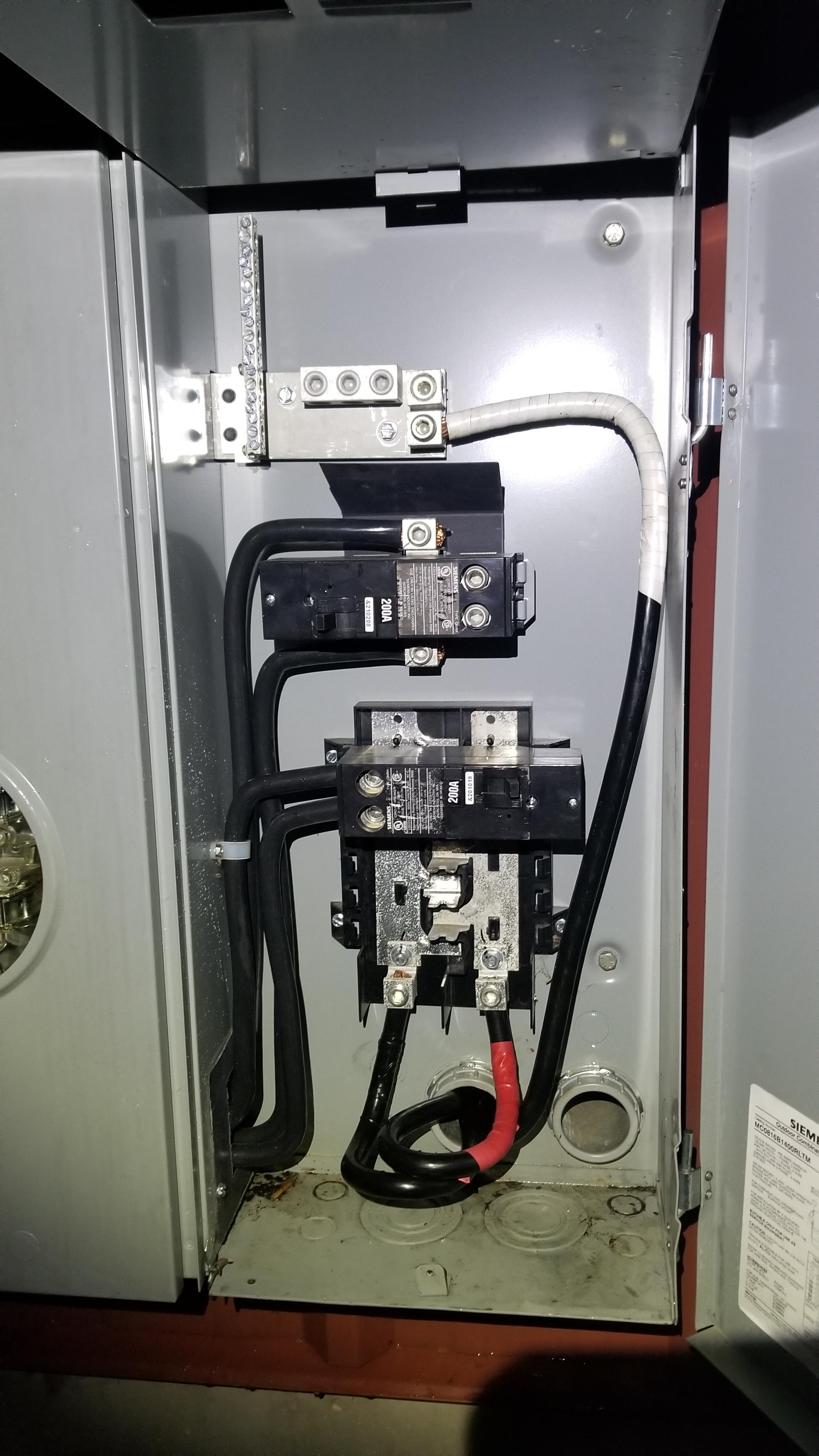

jlpservicesinc Posted February 3, 2023 Author Share Posted February 3, 2023 Dominc S came out (also NEB alum) and helped get the panels mounted, and the last sheet of siding up.. Made the rest that follows possible. I did however have another great guy from NEB Sam P offer up a day and he came over and we were able to get nearly all the electrical service entrance and load centers installed. Sam was super helpful and easy to work with and fully understood the domino effect. In this school/shop build there are so many steps (I call them dominos) that take on a 1, 2, 3 kind of deal before being able to move onto the next step.. So we will start with a few photos of the electrics. Today I need to go and get 1more ground rod, acorn and some 1/2" emt. Turns out I don't have any.. I have a few hundred sticks of 3/4" but not a single section of 1/2". In order for the electrical inspection and then a sign off for service from the inspector to National grid, I need to only have one load center connected to something that needs to be powered. So have only connected 1 load center at this time. Quote Link to comment Share on other sites More sharing options...

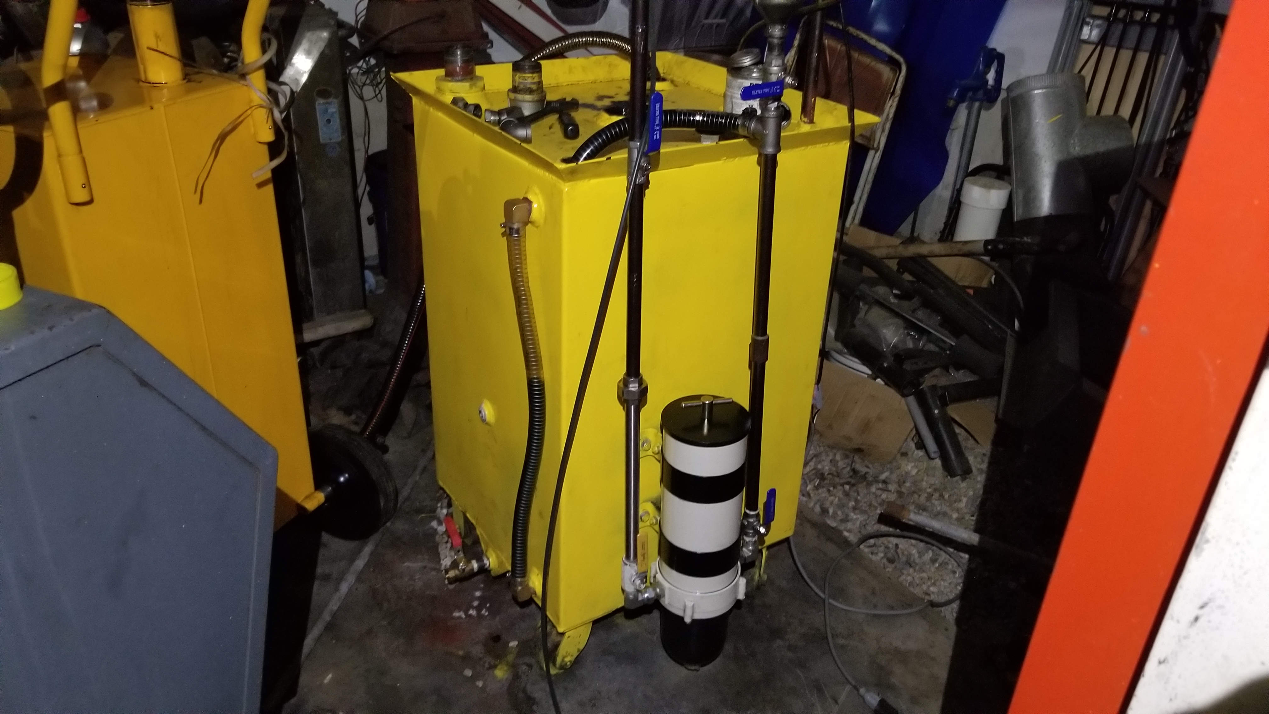

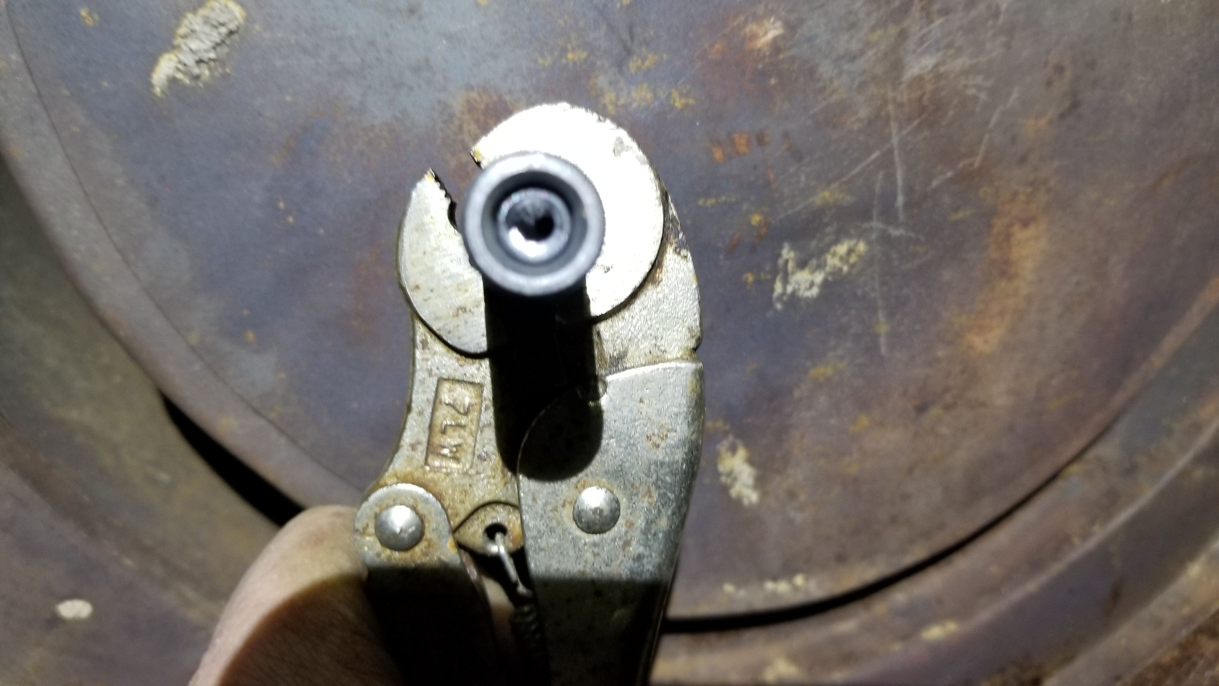

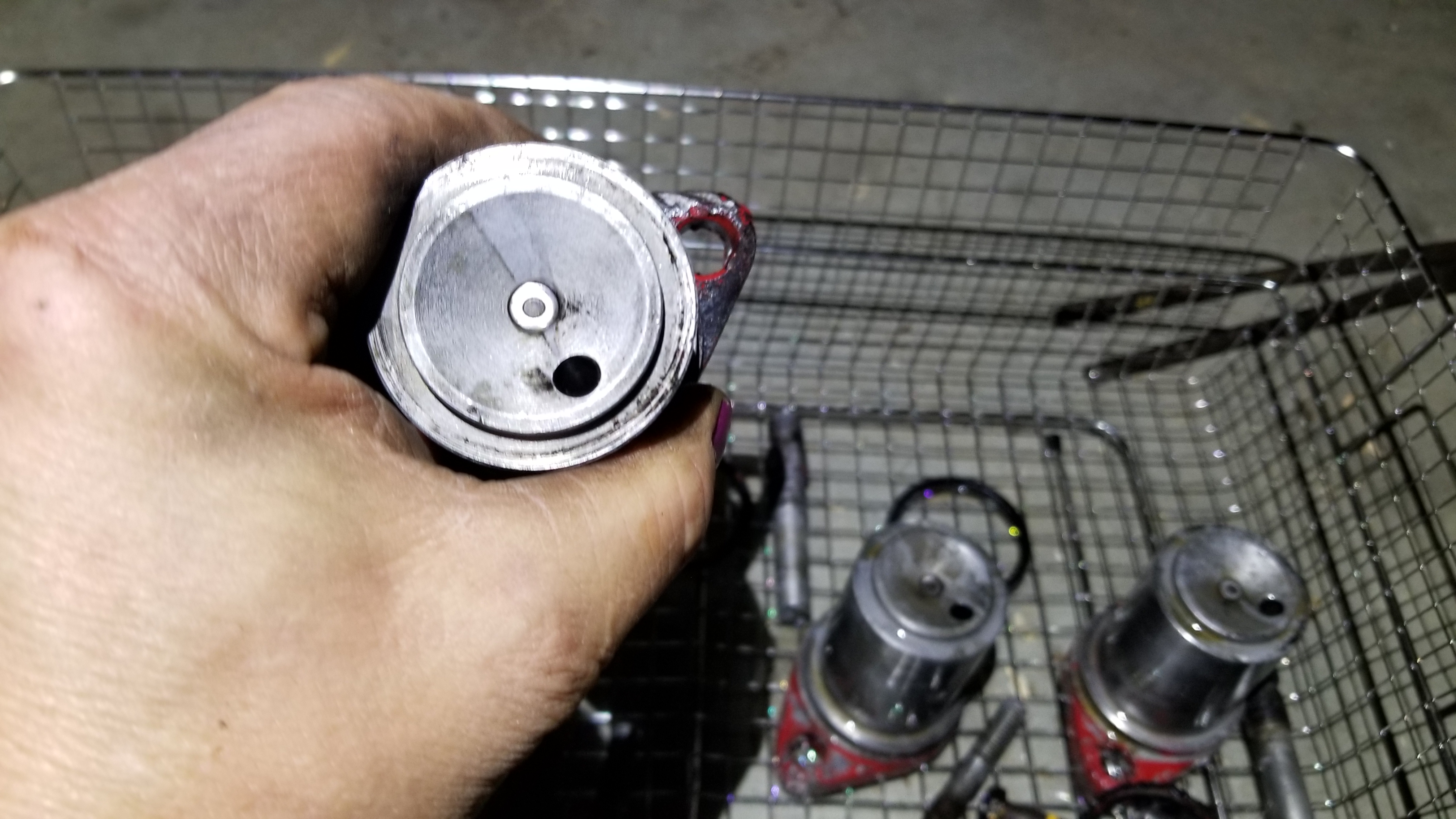

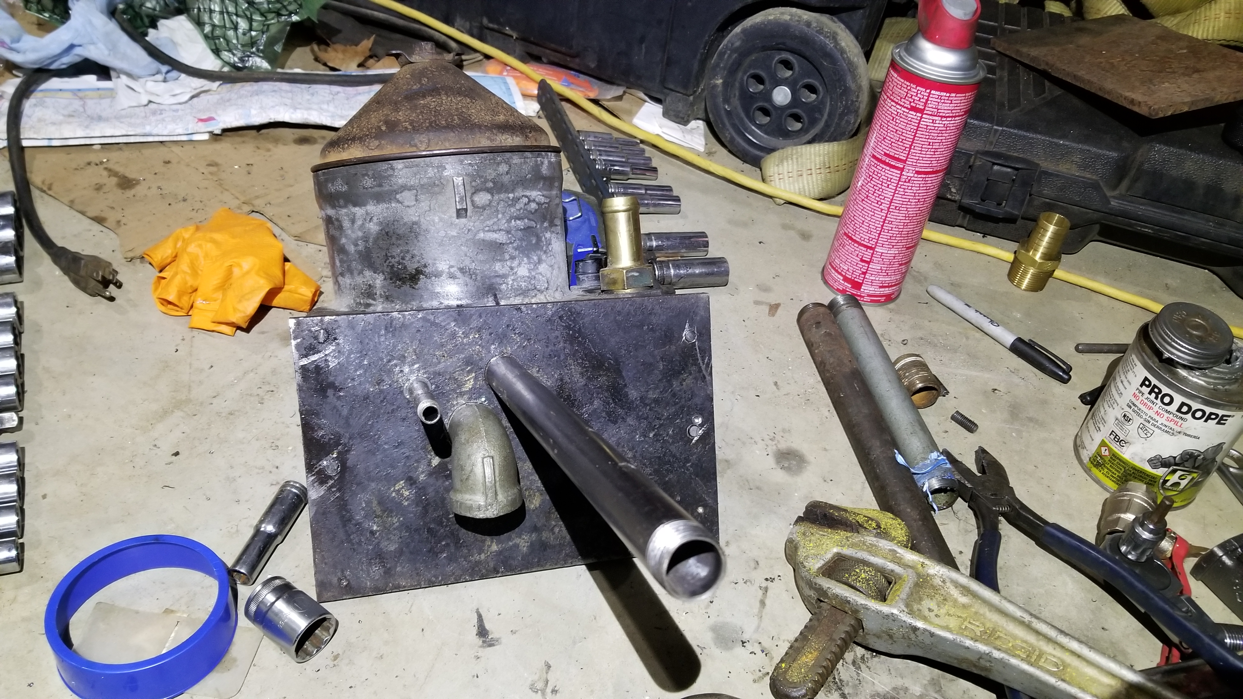

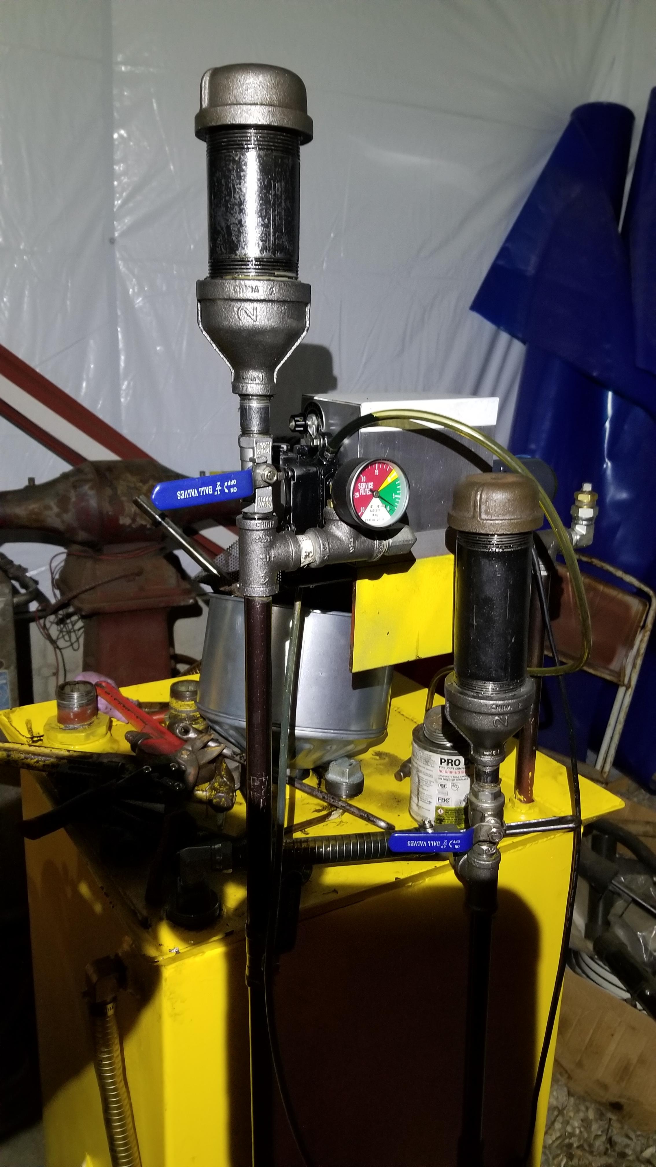

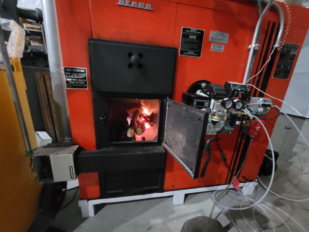

jlpservicesinc Posted February 3, 2023 Author Share Posted February 3, 2023 Furnace update: I love the Eagle 1 furnace with the Clave used oil burner. The furnace being multi fuel (wood, coal, oil, used oil,) has kept the building in the 60-70F range with a burn rate of .5gal per hour of used oil. I use about 55gals per week. This is when fired with oil only with no fans to blow the heat down from the eves. Once the duct work goes in for the furnace I expect the useage to be a little less. The used oil can be a problem with people who don't really understand what clean oil means so have added a few items to the furnace pre tools. A paste for water testing, a centrifuge for cleaning oil made out of a Scania truck oil filter unit, and have a commercially made Oil centrifuge from PA biodiesel on the way. I also picked up an fryer separator so can be used to filter some of the oil. It flows about 4gal a minute so acts as a good pump from 55gal drums to the feeder tank. Now the furnace has worked awesome except for some user mistakes.. Especially keeping it plugged in.. Quote Link to comment Share on other sites More sharing options...
