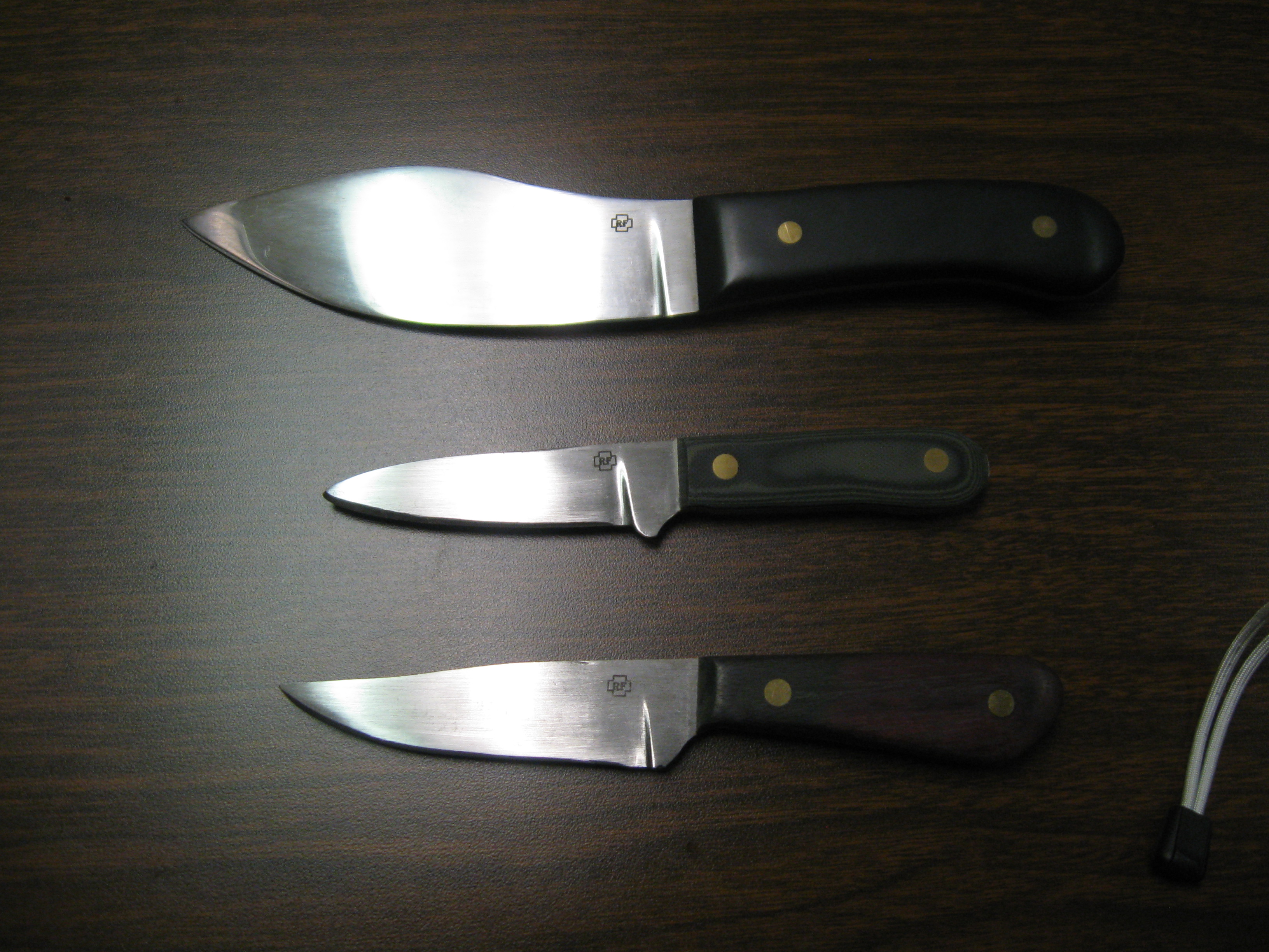

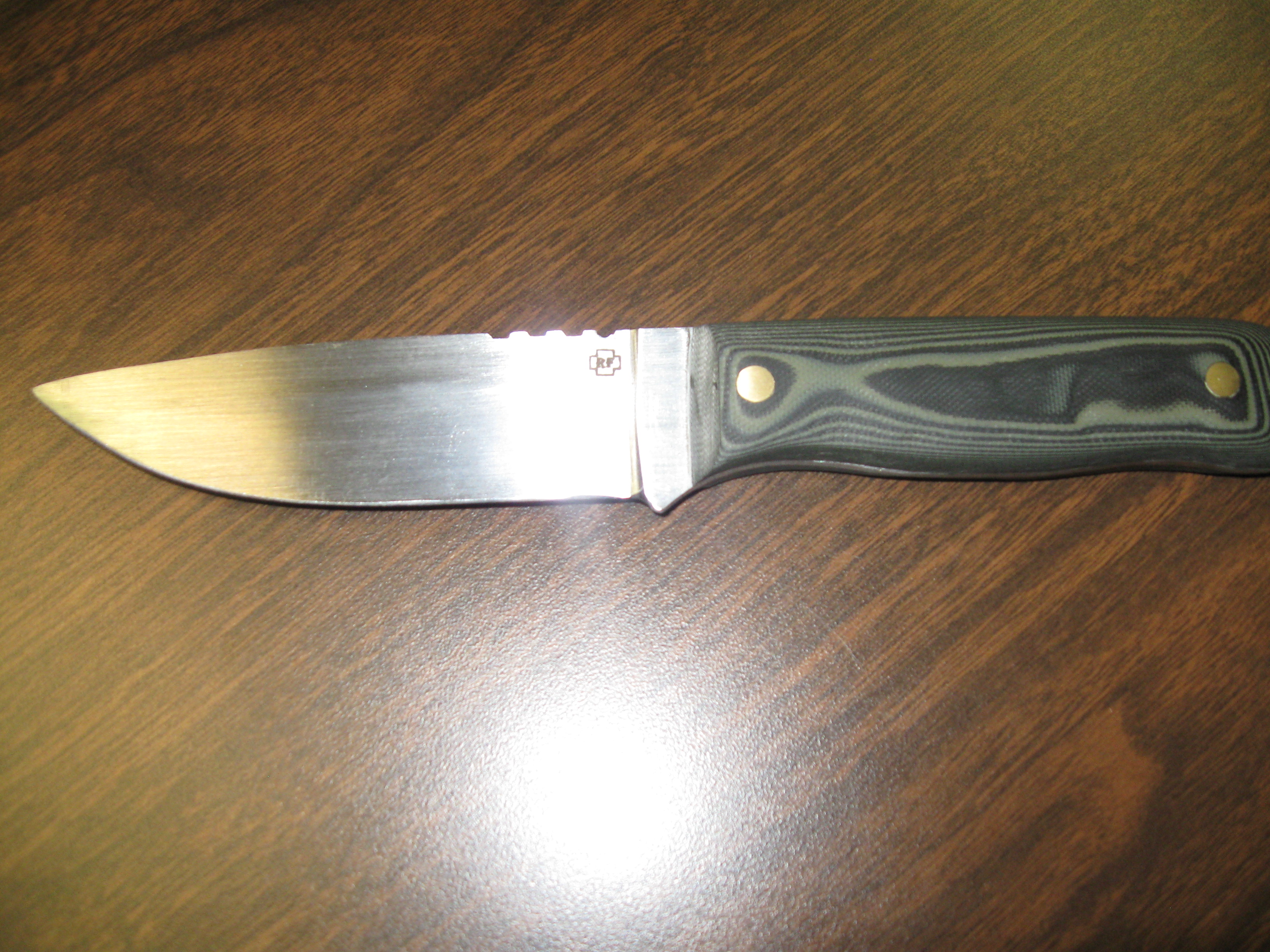

That being said, this is what I have been up to recently and I would very much appreciate the pointers your experienced and trained eyes can give.  All of the knives below were made from 1095.

For the blades where the ricasso drops substantially below the grip: I would suggest working on the back end curve of the ricasso into a "finger stop" for someone holding the blade.  That first set looks like you were going towards a skinning set.
Ha, I really had not noticed those were all straight lines for the most part.  Kind of a waste when I could have made them into a stop which would look better too...Thanks.  I like dropping the Ricasso down because I make most of my sheaths out of Kydex and that gives the Kydex something to grip and the knife sort of clicks into place when you return it to the sheath.

One way to prototype is to get a wooden paint stirrer and rough out some "blade profiles" using it as "stock" and see how it fits your hand (and remember that not everyone will have the same size/configuration hand...)   I have a bader with one of the very small contact wheels that makes it easy for me to get a curve in such places; but have done it other ways---forging it in is rather neat as you can make it fatter than the material thickness, round files, dowels with SiC paper wrapped on them, lots of ways to go.

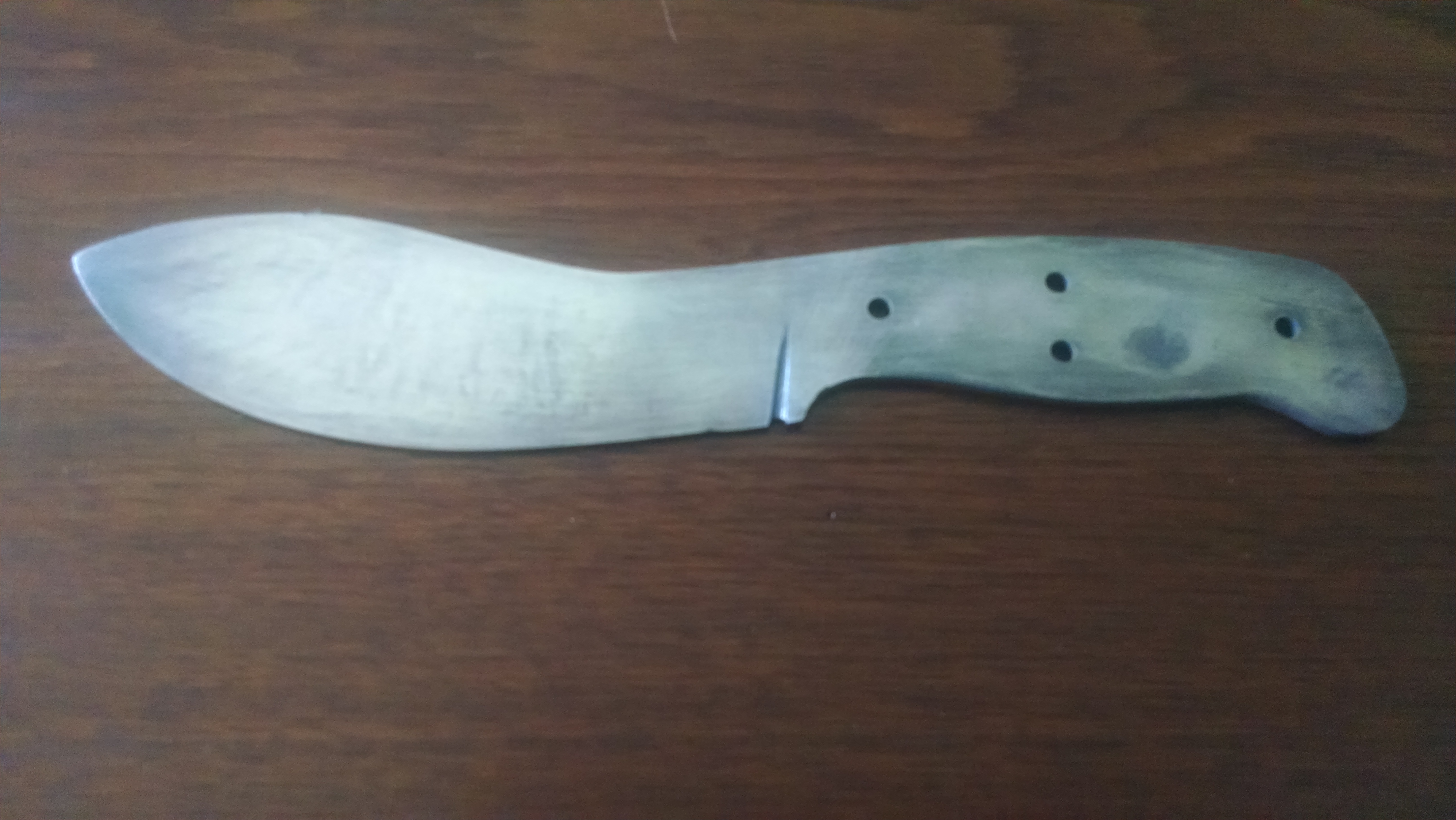

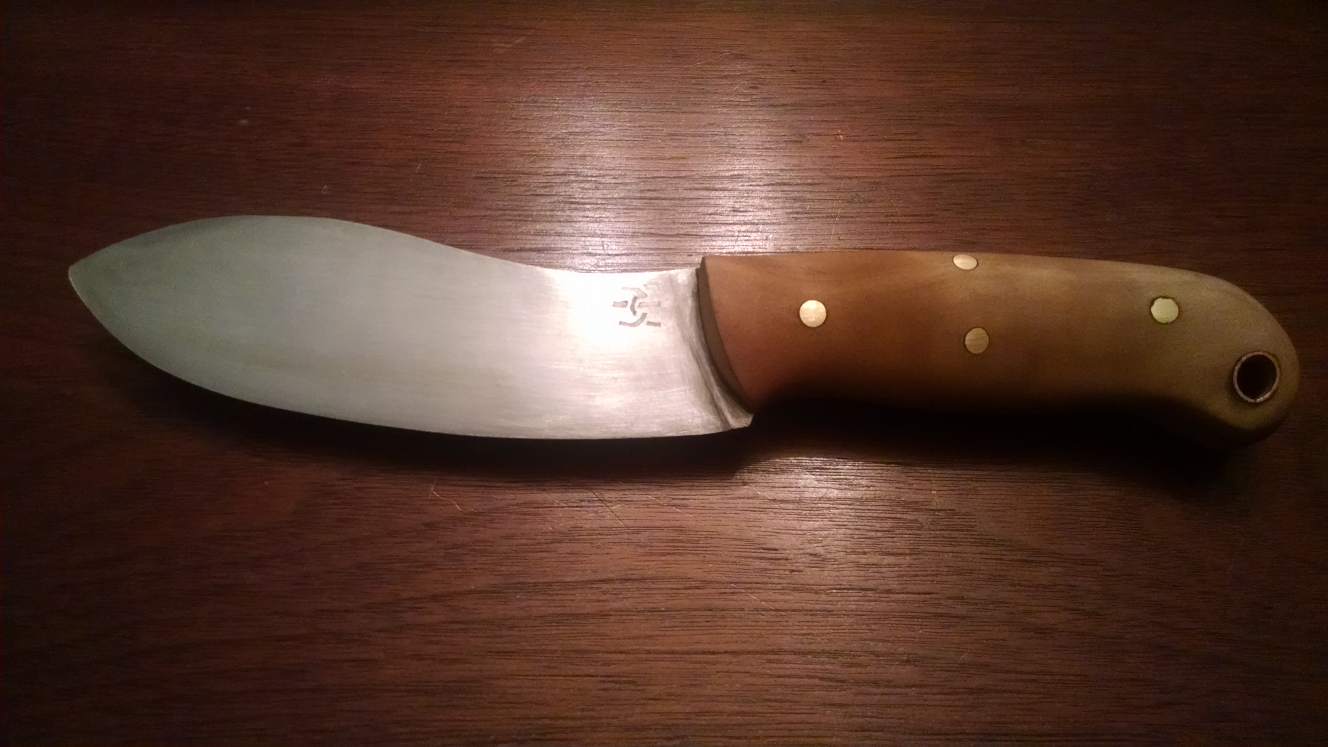

Nessmuks are pretty knives, but the lack of a stop bothers me too.  My very first knife was a Nessie, and I incorporated a stop into the handle profile:
And here's my second, in progress:
One way to forge it in is to start with a cross peen and then refine by taking a piece of round stock and hammering that into what you have forged to make a nice smooth curve, I like the swell you can get this way and if done nicely it impresses folks as the change in thickness in the blade material is something you don't see much of with "factory" knives.
Should be able to be incorporated in a kydex sheath "latch" too
(Helps to have someone or something to hold the blade on the anvil while hammering on the roundstock---or make a variation on a swing arm fuller so you are holding the blade and hammer and positioning it in the fuller.)
I have an old round file which should be the exact size I need to forge that in.  I also have an ingenious method for adding a holder to my forging...I call it a 10 year old son.  He loves to work so he jumps at the chance to do any manner of forge activity.
I have a request from a friend to forge a Nessie with a 12-13 inch blade maybe 17 overall or so.  The finger stop will work very well on that project.  I will post a picture of my attempt.
Files are very brittle and do NOT like to be hammered on---use a piece of mild or medium carbon rod---perhaps from a spring and draw temper on it to blue! or even just normalize it.
I'd love to see how it comes out; practicing on a trial piece first can help.
