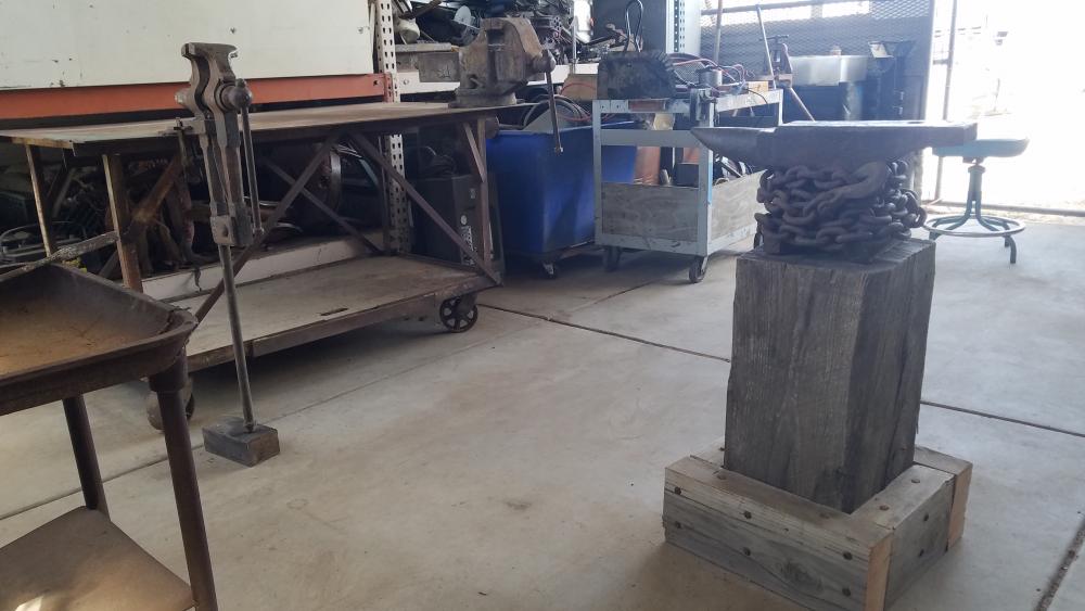

LarryLowell Posted April 7, 2021 Share Posted April 7, 2021 Hi new to the forum and to blacksmithing. Been collecting stuff to put my shop together, and started organizing it and actually getting ready to fire it up and start playing around. I have an old coal forge, vises and just built a stand for my anvil, the shops a work in progress but coming together. Quote Link to comment Share on other sites More sharing options...

Goods Posted April 8, 2021 Share Posted April 8, 2021 Just an observation, and could be camera angle, but that anvil stand looks really high. Is it just the camera effect or are you that tall? (Face height is usually between knuckle and wrist height, depending on personal preference and type of work.) David Quote Link to comment Share on other sites More sharing options...
LarryLowell Posted April 8, 2021 Share Posted April 8, 2021 Goods, yes Im tall, so are my sons Im 6 foot 6, they are 6 foot 5, and 6 foot 4. The top of the anvil is about mid hand or about 2 inches or so above my knuckles with a closed fist. Quote Link to comment Share on other sites More sharing options...
Goods Posted April 8, 2021 Share Posted April 8, 2021 Larry, sounds good, just wanted to make sure... Looking forward to seeing your work, David Quote Link to comment Share on other sites More sharing options...

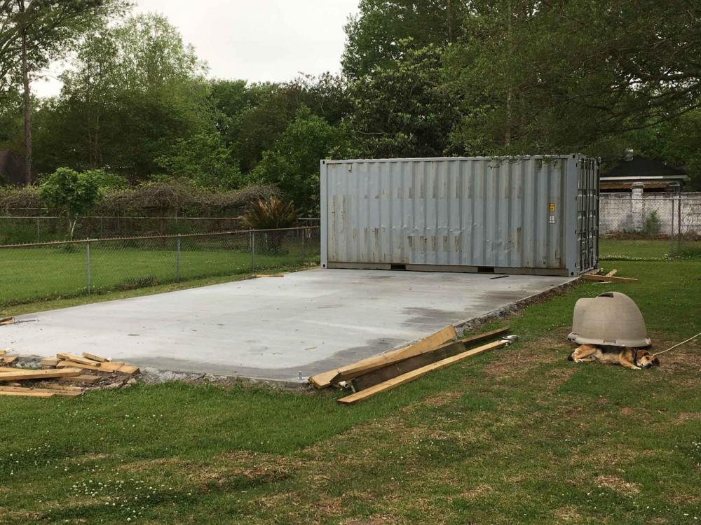

Purple Bullet Posted July 18, 2021 Share Posted July 18, 2021 Here is my shop. I built it about 3 years back and in some ways I'm still working on it. I was 67 when I started it, but other than pouring and finishing the slab I did the entire construction single handed. I had an electrician friend help me with the electrical service. It was constructed safely and meets local code. I'll go through some of the details in following posts. It is made of two 40' cargo boxes placed four feet apart on a chain-walled 6" slab. At the back end of these two boxes is a 20' cargo box. I cut out the box walls where the boxes join and cut several openings to the four foot gap area. I spanned the gap on top of the boxes with 2X6 joists and plywood to make the 2nd story floor. I left a large area of the walls intact towards the back to be support for the stairs. On the foundation prep you can see the internal chain walls that will be under the load bearing areas of the boxes. You can also see my home made tamper (a piece of plate with 1" square tubing welded to it - Ha! who needs a gym?) This is the part I couldn't hack on my own. I've done some concrete work , both with a mixer and without, so I know for something this big, call the pro's in! Quote Link to comment Share on other sites More sharing options...
jlpservicesinc Posted July 18, 2021 Share Posted July 18, 2021 Very nice.. Not sure what you meant about "Chain" on the outside wall.. the rebar and metal mesh is excellent. Quote Link to comment Share on other sites More sharing options...
Purple Bullet Posted July 18, 2021 Share Posted July 18, 2021 Once the slab cured well, I drilled and installed 3/4" anchors where each of the boxes outside corners would land. When the truck delivered the boxes (one at a time) I used a jack to lift the boxes enough to put sections of pipe under to roll near where they were going to go. Then I removed the pipe and did the fine adjustments with a porta-power and a pinch bar. Each cargo box has a standard connector box at each corner, but I just made big washers out of 1/2" plate. If we ever have another tornado (one passed through here during hurricane Andrew) this is where we are going. Quote Link to comment Share on other sites More sharing options...

Purple Bullet Posted July 18, 2021 Share Posted July 18, 2021 Thanks for all the kind words. Jlpservices - chain wall may not be the right technical term. Here in South Louisiana the soil is not the best. One way we compensate for that is by making the edge of a slab (and in my case, through the middle as well) a deeper trench and lay in rebar to create a reinforced area that helps keep the slab from cracking due to subsidence and traps soil under it. I've heard it called a floating slab but I'm not sure that is an accurate term either. Quote Link to comment Share on other sites More sharing options...
