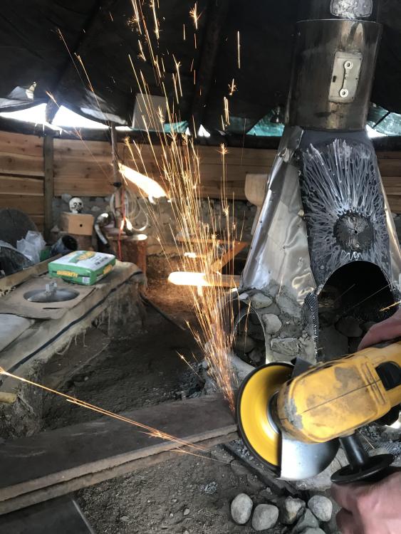

Mr. Powers, I do not think I can get the temp hot enough to hot cut yet. I would love to hot cut, but still working on temperature refinements. I would have to cut on edge of anvil since I do not have a hardy hole cutter or good chisels yet. Holding the hot metal steady while using chisel is more advanced for my current level. No vice either just vice grips and first tongs that only hold larger round stock comfortably. I am still learning to draw out metal. I like the way the ball peen hammer works on the anvil edge, very fulfilling. I will continue to draw out the machete handle until it is round and I can hold it comfortably. Then I will heat the blade side and start drawing out the blade on both sides and then final sharpen with angle grinder. I want to shape the whole blade by heating, just for the experience. Originally, I tried to cut the stock closer to a bowie knife size but the leaf spring was way harder than any steel I have ever tried to cut with jigsaw or reciprocal saw. These saws literally bounced off the metal, so I used angle grinder which was very difficult even with cooling oil. Almost burned up grinder and used 1/2 disk for 3 cuts through spring steel, one point and one heel. I want to hammer the blade angle instead of grinding it to shape. Hot cutting intimidates me for now. Holding a luminous piece of metal and hammering is enough for me right now. Safety is important; some of that hot hammered scale flew off and landed on my feet and legs but luckily I was barefoot and instantly moved, similar to hammering without gloves.

Substituted new 9” diameter centrifugal tuyere fan for old 4” fan. Twice cfm, 4xwatts and way more push and only 50 decibels quiet. On high the fan cools material but on low it is perfect but gobbles up wood. Cut 30lb spring steel found on hike; still sore from hauling on back 4 miles. New jigsaw blades didn’t dent steel and reciprocal saw was similar, so had to angle grind. Used grinding oil but was a chore. Originally wanted to make Bowie but would need more disks so now a machete. Spent all day trying to draw out handle using ball peen and edge of anvil. Fan made fire a little hotter, hot enough to see first black chunks of scale over yellow. Hands sore. A good day.
Concerning my above pic of spark test. Looking at spark chart images my greenhorn opinion would be mild but shouldn’t the spark be white and not straw color? Since leaf spring was found off old logging/ mining road 4 miles deep from both directions, up 1500 ft in dry cold desert climate, near copper mines. Mining truck leaf spring over 50 years old? Ore trucked down steep rocky dusty bumpy roads. Then ore put on trains in flat. More info to help with identification.
Me and the wife went on 8 mile hike over the mountain today. Checking out old copper mine, found 30 lb 5ft tall leaf spring. Hauled back on sore shoulders for 4 miles! Did spark test. Medium carbon steel, good for first knives?
