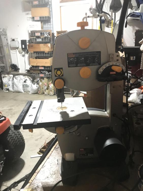

Got a bandsaw- it’s small and underpowered, but it was free! I imagine it’ll be very helpful for cutting handle material, but I’m dubious as to it’s steel cutting capabilities- even with a fresh bimetal blade and some coolant, I think it would inevitably bog down
That bandsaw is probably not much different than the porta-bands like DeWalt, Milwaukee, HF, etc.  Should work for smaller stuff like plate, 1/4" or 3/8" stock, round stuff, sheet metal...give it a chance.:)
Itll definately cut those oranges or grapefruit, and wood. No harm in having extra tools for jobs.
I used this bandsaw for a while before I was given it- i don’t know if it is just low power or if the motor is going out, but it definitely bogs down much easier than my friends dewalt portaband. I do have a new blade for it though, so I’ll try cutting some steel. Even if it doesn’t get steel it should work for non ferrous metal, wood… oranges. And the occasional grape fruit! ;)
Keep in mind that cutting steel requires a MUCH lower blade speed than cutting wood, fruit, etc.
Portaband is a seriously powerful gear reduction drive METAL cutting bandsaw designed to eat steel.
Your new saw is a wood bandsaw and it takes a LOT  more than a different blade to make it a metal cutting bandsaw. You might get away with it on soft metals and feeding it REALLY SLOWLY but don't count on it.
