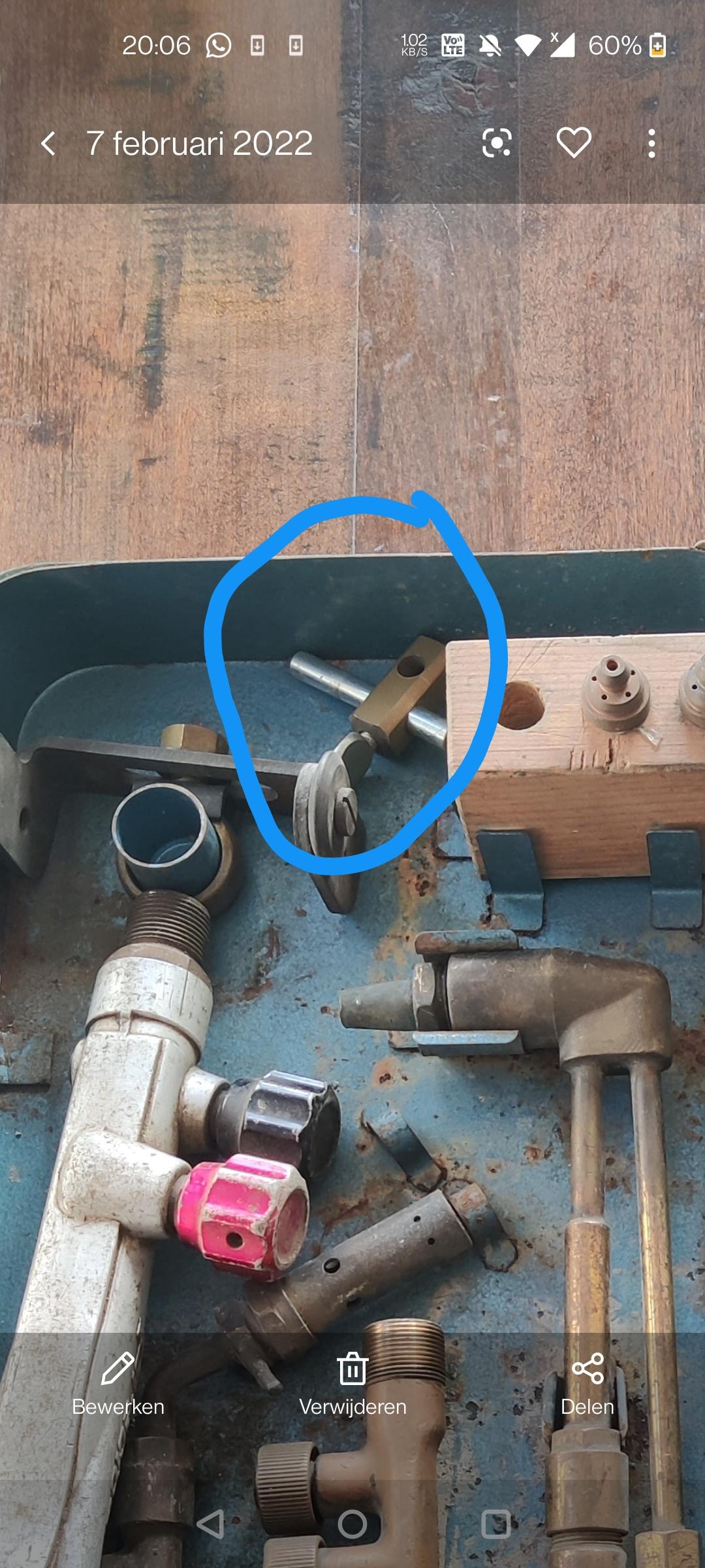

Jobtiel1 Posted February 10, 2022 Share Posted February 10, 2022 Yeah, I think that will really come in handy, looking around it seems that the company has fused, so the original name is not there anymore,. It the new company still produces torches. There is also some other part in there that I don't know the use for, maybe it doesn't belong in there at all. At the end of the small rod there is a point, and there is a place for a second rod in there. ~Jobtiel Quote Link to comment Share on other sites More sharing options...
JHCC Posted February 10, 2022 Share Posted February 10, 2022 My money is on the long rod on the far left side screwing into the torch support and then sliding through the fixture you marked in the last photo, for cutting circles. Set the distance from the point to the torch at (or slightly larger than) the radius of the desired circle, and you're good to go. I just made something similar myself, detailed HERE. Quote Link to comment Share on other sites More sharing options...
Jobtiel1 Posted February 10, 2022 Share Posted February 10, 2022 Ah that makes a lot of sense actually, thanks for clearing that up! ~Jobtiel Quote Link to comment Share on other sites More sharing options...

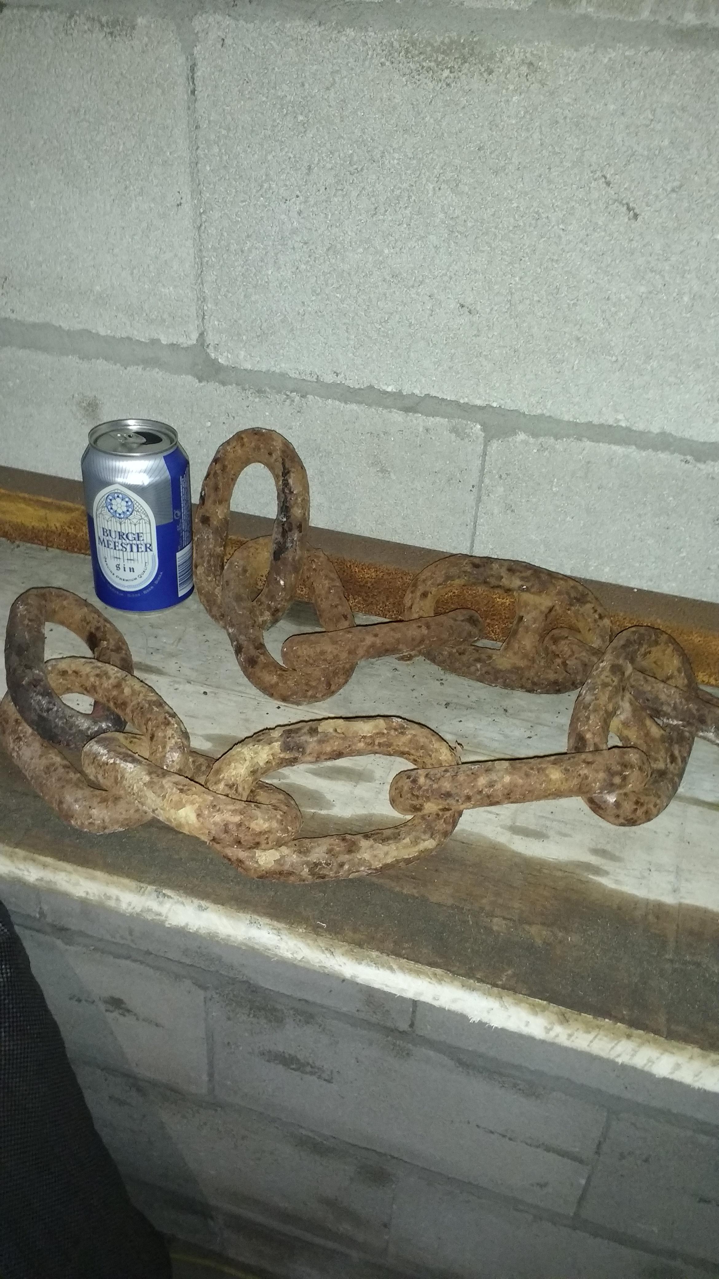

Patrick Kelly Posted February 11, 2022 Share Posted February 11, 2022 A gift from my generous neighbor, he has a LOT of it laying around his garden for decoration. Would I be correct in assuming it's wrought iron? Quote Link to comment Share on other sites More sharing options...
JHCC Posted February 11, 2022 Share Posted February 11, 2022 The only way to tell is to test. Cut halfway through and bend it until it breaks. If it's wrought iron, a fibrous structure -- like a broken green stick -- will be revealed. Keep in mind that each link may be a different metal, depending on what was available when the chain was made. Strictly speaking, you would have to test every one. If it is WI, though, make your neighbor something nice as a thank-you! Quote Link to comment Share on other sites More sharing options...
ThomasPowers Posted February 11, 2022 Share Posted February 11, 2022 You can also spark test it with a grinder. Quote Link to comment Share on other sites More sharing options...
Patrick Kelly Posted February 11, 2022 Share Posted February 11, 2022 Thanks for the swift replies. I just cut a link in half and the sparks were kinda dead and reddish so that link is WI and hopefully the rest are. I'll be sure to make my neighbour something nice in return. Quote Link to comment Share on other sites More sharing options...
JHCC Posted February 11, 2022 Share Posted February 11, 2022 Bottle openers are always a nice thank-you. If you make one from some of the WI, make sure to etch it in vinegar to bring out the grain pattern. Quote Link to comment Share on other sites More sharing options...
Patrick Kelly Posted February 11, 2022 Share Posted February 11, 2022 That's a great idea and thanks for the etch tip, I'll probably make some sort of key ring as well. I actually haven't made many things so far so this will be a fun learning project. I know this material has to be worked really hot. Quote Link to comment Share on other sites More sharing options...
JHCC Posted February 11, 2022 Share Posted February 11, 2022 It does indeed. It can also split when punched and drifted, so be careful. Quote Link to comment Share on other sites More sharing options...
Irondragon Forge ClayWorks Posted February 11, 2022 Share Posted February 11, 2022 Wrought iron has to be forged at a much higher heat, think welding heat. At lower temperatures it will split like JHCC said. Quote Link to comment Share on other sites More sharing options...
