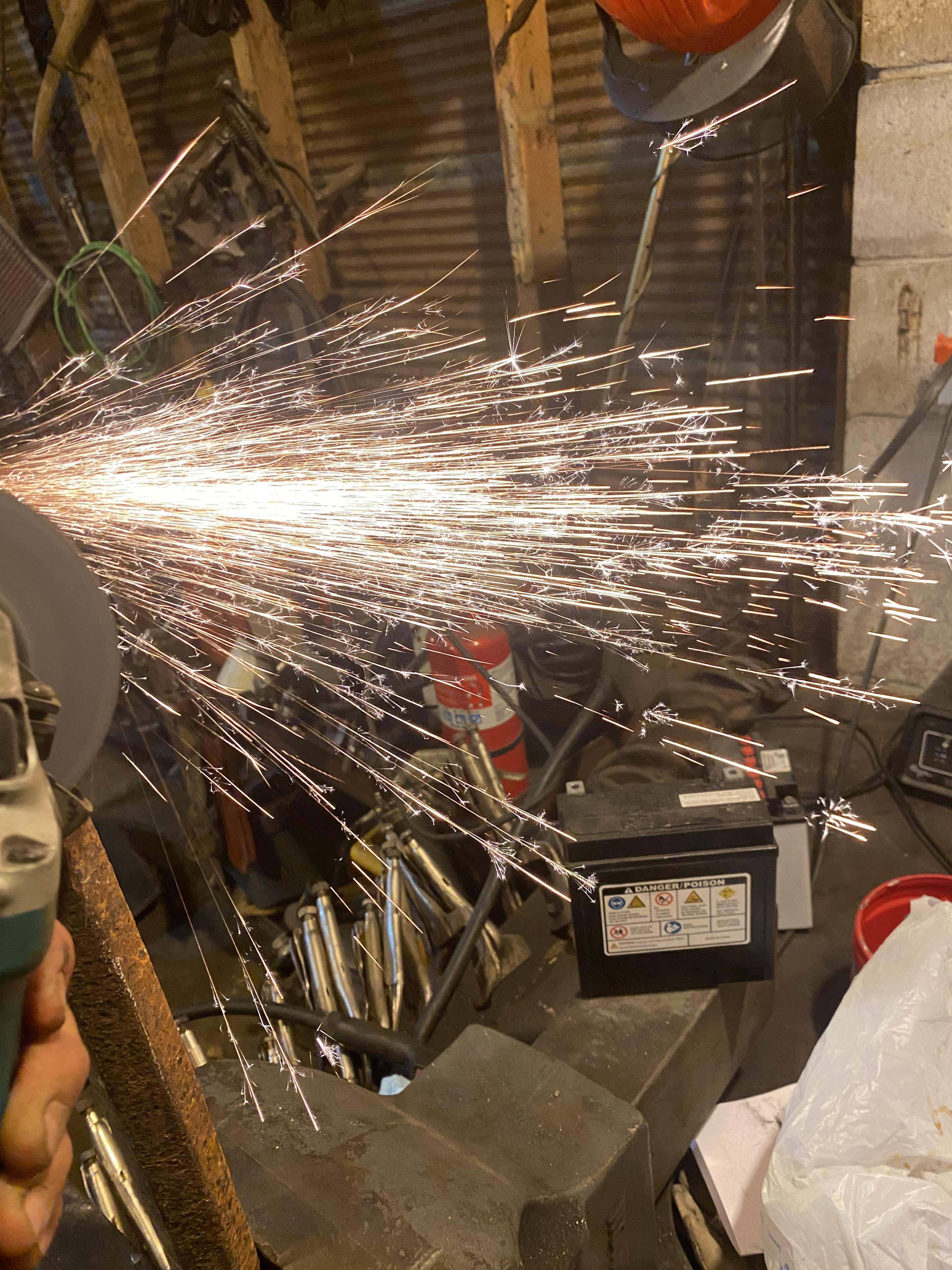

ThomasPowers Posted January 12, 2022 Share Posted January 12, 2022 Wrought Iron generally sparks a lot like cast iron; not like that at all! Quote Link to comment Share on other sites More sharing options...
TWISTEDWILLOW Posted January 12, 2022 Share Posted January 12, 2022 Here’s a picture Quote Link to comment Share on other sites More sharing options...
ThomasPowers Posted January 13, 2022 Share Posted January 13, 2022 HC alright. Quote Link to comment Share on other sites More sharing options...
TWISTEDWILLOW Posted January 13, 2022 Share Posted January 13, 2022 That’s kinda what I thought Quote Link to comment Share on other sites More sharing options...

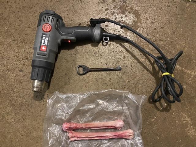

JHCC Posted January 13, 2022 Share Posted January 13, 2022 No photo, but a nice mail call today: from eBay, a nice heat gun for softening chaser’s pitch, and from IFI member Chad J., a pair of deer shinbones and an unexpected bottle opener. Quote Link to comment Share on other sites More sharing options...
Chad J. Posted January 13, 2022 Share Posted January 13, 2022 I couldn't resist adding the church key. Enjoy Quote Link to comment Share on other sites More sharing options...
JHCC Posted January 13, 2022 Share Posted January 13, 2022 And thank you for it! Quote Link to comment Share on other sites More sharing options...

JHCC Posted January 13, 2022 Share Posted January 13, 2022 24 minutes ago, Irondragon ForgeClay Works said: Along with pictures, or it didn't happen. Fine! Quote Link to comment Share on other sites More sharing options...
TWISTEDWILLOW Posted January 13, 2022 Share Posted January 13, 2022 There it be! now you can soften up your gooey stuff cook a pot of beans and pop a top on a cold one all at once! Quote Link to comment Share on other sites More sharing options...
Gazz Posted January 13, 2022 Share Posted January 13, 2022 Your piece of hollow hex stock is most likely not a gun barrel. In all my years of messing with antique and modern guns, I have never seen a hex barrel, they are always octagon except for one that I saw that was 12 sided. Also, gun barrels are typically not high carbon. I vote for some kind of drive shaft for farm equipment or something similar where the shaft needed to change length during use as it slid in and out of a hex socket. Quote Link to comment Share on other sites More sharing options...
TWISTEDWILLOW Posted January 13, 2022 Share Posted January 13, 2022 Thanks for the idea Gazz, I don’t believe it’s a gun barrel, it was 14 foot long, I doubt it was a pto drive shaft either being that long, not saying it couldn’t exist but personally I’ve never seen a brush hog or a hay baler or any other pto driven equipment with a 14 foot pto shaft! I think Thomas is probably right at it being drill stem, Quote Link to comment Share on other sites More sharing options...

Purple Bullet Posted January 13, 2022 Share Posted January 13, 2022 Thomas is correct (as usual) only the term as I recall is "Kelly joint". Some are square and some hexagonal, but they are used to transmit the twisting motion from the turntable to the drill pipe. Quote Link to comment Share on other sites More sharing options...
ThomasPowers Posted January 13, 2022 Share Posted January 13, 2022 At that size it looks more to be one used by a steam or compressed air drill to drill shot holes rather than on a drilling rig to drill for oil or water. I work at what once was called "the NM school of mines" and they still have a drilling contest during 49'ers week. Quote Link to comment Share on other sites More sharing options...

Frosty Posted January 13, 2022 Share Posted January 13, 2022 I concur, that's a stick of drill rod/stem. In use they're 20' long, coupler type depends on manufacturer. Kelly bars aren't hollow and are usually square. Hex drill stem helps prevent cuttings getting jammed between the rod and hole. Frosty The Lucky. Quote Link to comment Share on other sites More sharing options...
