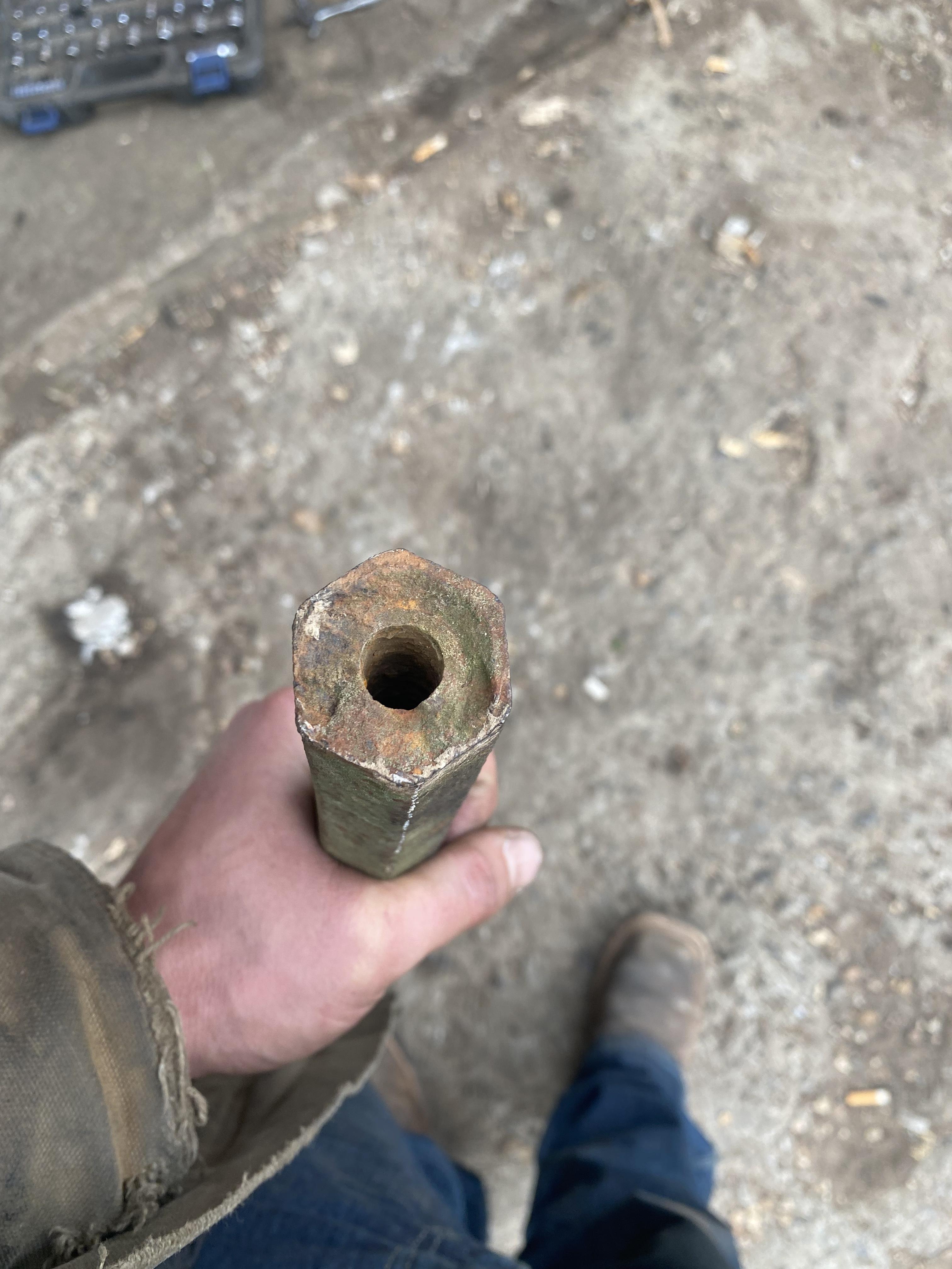

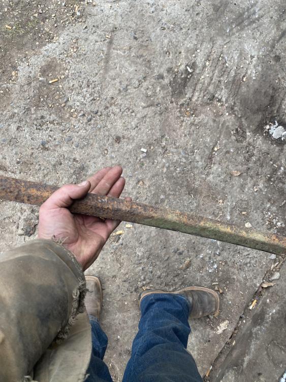

TWISTEDWILLOW Posted January 12, 2022 Share Posted January 12, 2022 Had my scrap guy stop by today and drop of some leaf springs and a mystery octagon shaped pipe Quote Link to comment Share on other sites More sharing options...
ThomasPowers Posted January 12, 2022 Share Posted January 12, 2022 Looks like drill rod for drilling rocks. Check how it sparks, I used a chunk to do a pipe hawk once since it would harden. SAFETY TIP: there has been at least on incident reported where a piece of drill stem was reused as a tamper for explosive charges and had filled the interior channel with the explosive that then went off when years later someone tried to forge it. Always check that the center channel is cleared out before putting in the forge! Quote Link to comment Share on other sites More sharing options...
JHCC Posted January 12, 2022 Share Posted January 12, 2022 I've got some similar hexagonal stock, but it's solid rather than hollow. Mine's also mild rather than any kind of hardenable alloy. Looks great twisted. Quote Link to comment Share on other sites More sharing options...
ThomasPowers Posted January 12, 2022 Share Posted January 12, 2022 It's the center hole that made me think of rock drilling, I have some 1084 Hex stock that is solid. Quote Link to comment Share on other sites More sharing options...
TWISTEDWILLOW Posted January 12, 2022 Share Posted January 12, 2022 I just put a grinder to it and it lit up like a Christmas tree about 15”-18” out and some loner sparks went out over 4 feet, Quote Link to comment Share on other sites More sharing options...
Scott NC Posted January 12, 2022 Share Posted January 12, 2022 Looks like a high dollar antique gun barrel of some sort to me. Throw in some mill bal.... Cannon balls and find a collector! Quote Link to comment Share on other sites More sharing options...
ThomasPowers Posted January 12, 2022 Share Posted January 12, 2022 The old drills had the bit forged as part of the end and so the whole thing would be HC. Newer ones have the cutting bits that screw onto the ends---those bits can be used to stamp strap stop for ornamental work if you have a screw press. The rock drills are sort of mechanized star drills with air or water forced through the center channel to clear the cuttings back. Lots of mining around these parts 100+ years ago and so pieces show up at the scrapyard fairly often. Quote Link to comment Share on other sites More sharing options...
Irondragon Forge ClayWorks Posted January 12, 2022 Share Posted January 12, 2022 Looks like a muzzleloader barrel to me also. Especially if it tapers from one end to the other and looks like the remnants of rifling in the bore . Quote Link to comment Share on other sites More sharing options...

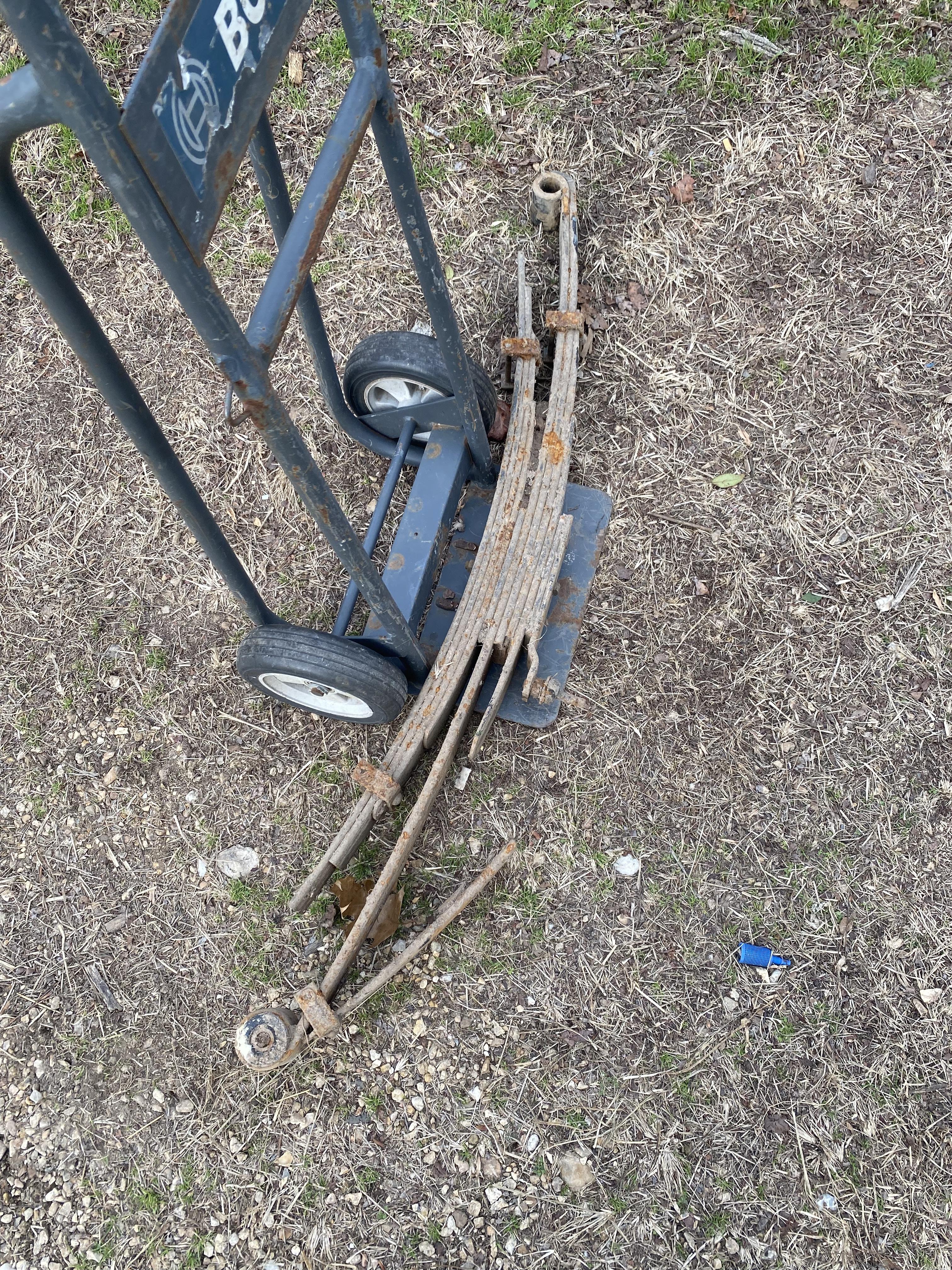

TWISTEDWILLOW Posted January 12, 2022 Share Posted January 12, 2022 No taper it’s the same size, it’s just bent, he cut it off a 14’ piece piece for me, he has apparently been using this pipe as a pry bar for the last couple decades? anyways not sure what imma do with it yet… I was asking him about big round stock so I wasn’t expecting this lol, the leaf springs are in pretty bad shape, there’s several broken ones, I wanted them to make frog gigs with but I’m kinda afraid to mess with them for fear of fighting cracks? Quote Link to comment Share on other sites More sharing options...
George N. M. Posted January 12, 2022 Share Posted January 12, 2022 TW, you might check it to see if it is wrought iron rather than steel. I'm a little skeptical of the gun barrel hypothesis, particularly since it appears to be open at both ends and there are no other things like sight blades or attachments for a stock. What is the diameter of the hole? If it is close to a common caliber, e.g. .50 or .58 inches it would support the firearm thesis. "By hammer and hand all arts do stand." Quote Link to comment Share on other sites More sharing options...
ThomasPowers Posted January 12, 2022 Share Posted January 12, 2022 14' gives new meaning to the term "long gun"! Rock Drill. Quote Link to comment Share on other sites More sharing options...

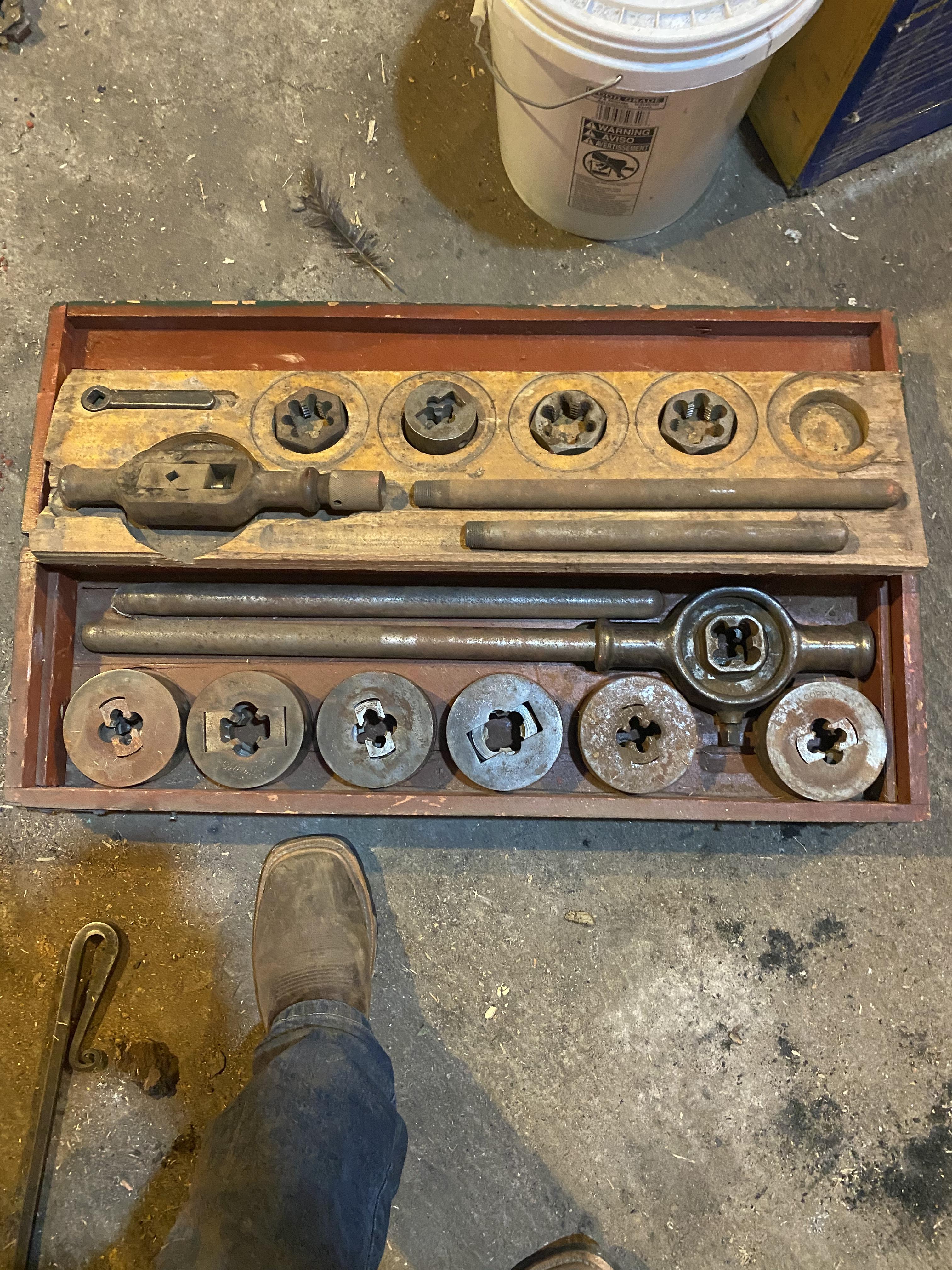

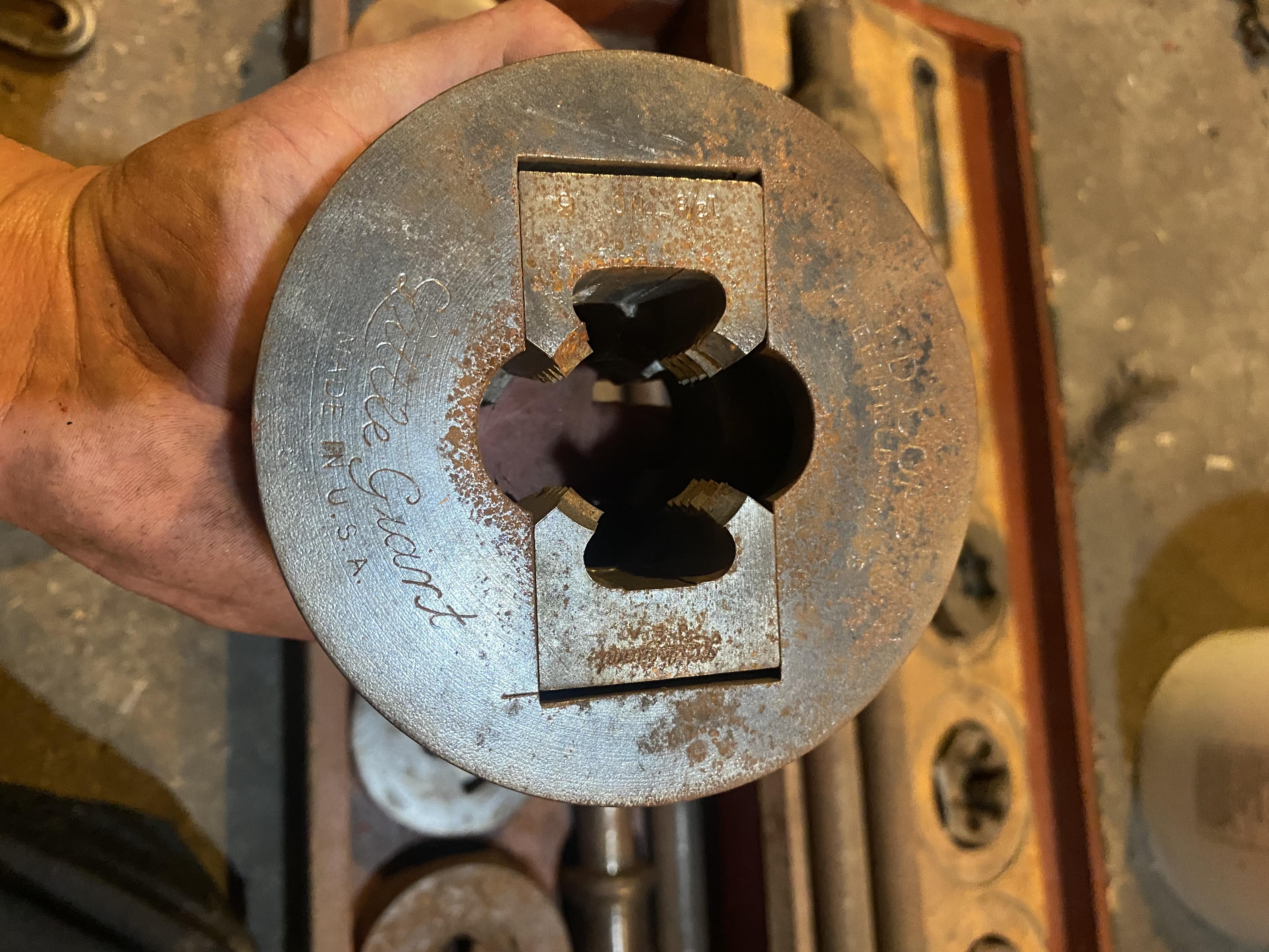

TWISTEDWILLOW Posted January 12, 2022 Share Posted January 12, 2022 I don’t think it’s wrought but then again I’ve never spark tested wrought, scott! Hey the hardware idea ain’t half bad lol! Just cut em to size and tap them! Ive I didn’t already have 600 pounds of nuts an bolts in the shop I might try that! speaking of tap an die sets I’ve got this huge set that I’ve been meaning to put on here for a year now, it’s as big as a pipe threader but it’s for big bolt threads, and almost all the parts say little giant, I didn’t know if it was related to the hammer manufacture but they’re still pretty cool Quote Link to comment Share on other sites More sharing options...
