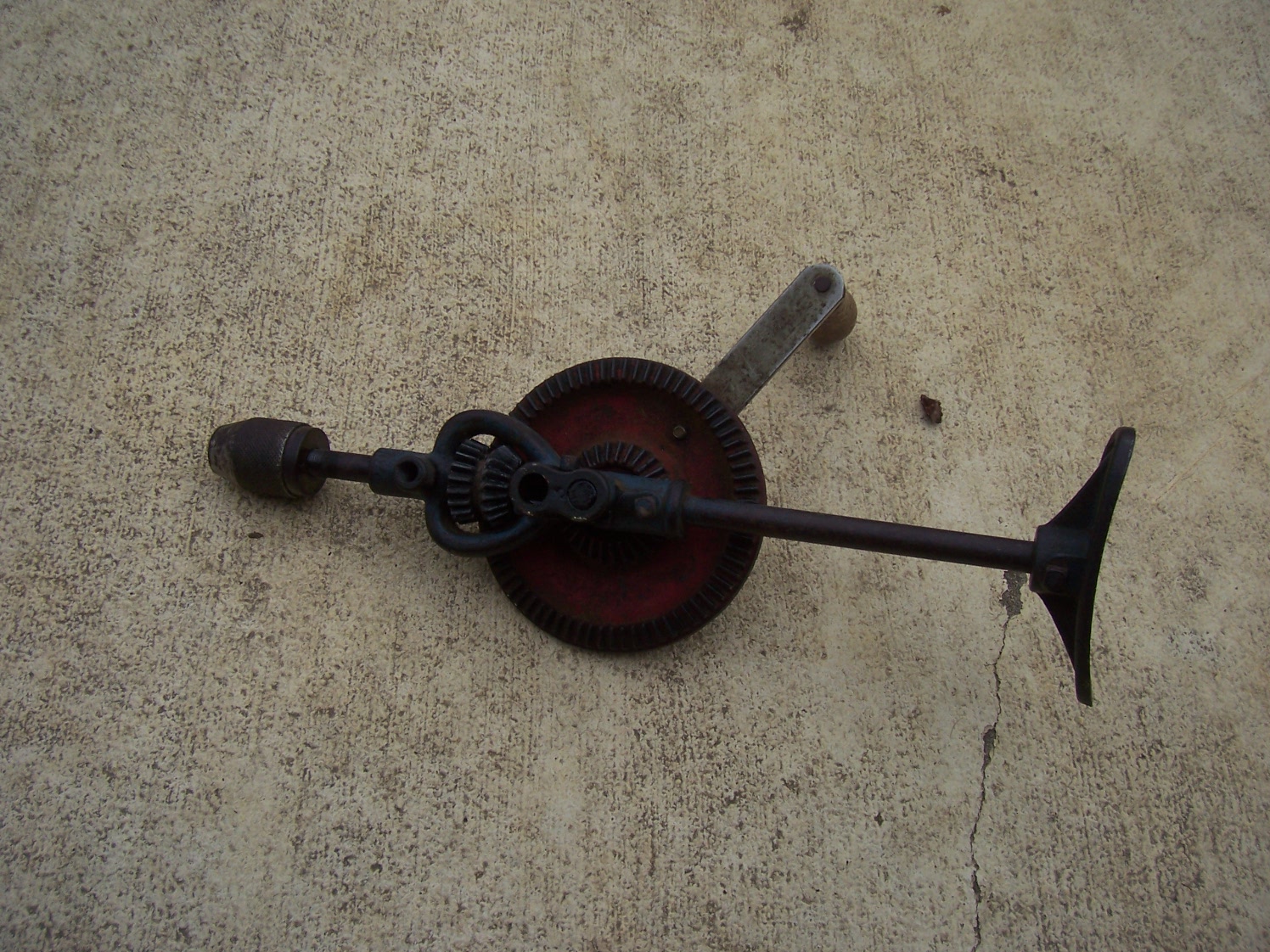

Found a pretty nice breast drill at the junk shop, missing the aux handle and the 3 jaw chuck springs are worn, but it is in nice usable condition.
Fleetway Clipper made in England. No other markings I can see.  Trying to get a ball park date on it- 3/8-16 thread aux handle with a 3 jaw chuck. If it was real old it would probably have a 2 jaw chuck I would think, and newer would have metric threads on the aux handle socket.
I have been trying to dig up info on Fleetway Clipper, and so far there doesn't seem to be much out there, anyone have anything?
Found a UK tool site that has the same drill and mentions Suffolk Iron Foundry as a connected/parent company, but I'm still digging.
Bertie and wiki clued me in on the UK metric conversion, sounds like what we sort of tried in the 70's but the UK managed to go metric, we stayed sorta imperial with an annoying dose of metric thrown in for fun.  Good excuse to buy more tools-is torx a universal standard size?

Torx is a trademarked name, the drive is actually called a "hexalobular internal", abbreviated "6 lobe". Sort of the way we call them Allen drive is actually called a socket cap, Allen is a trade marked name. But in answer to your question yes, they are universal. They are makred with a "T" followed by a number "T-40" as an example. There are however internal and external Torx. Most of the major tool companies now, Snap-on, Mac, Matco, etc, have made multi drive sockets. They are designed to be used on standard 6-point, external Torx, even triple square, basically one socket used on all drives.
