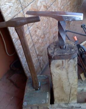

You of course remember my stake anvils; you could make a suspiciously similar set for yourself...(except the short shaft was made from a sq rr spike sledge...)
When I saw them I remembered your anvils Thomas, that's why I grabbed them.
I'm on the lookout for more hammer heads like those. I'd deffinately make stake anvils out of them but you make what you could use more.
Thomas, I apologize if it's been said before but what do you do around the area of the hammer eye on your stake anvils like those?
I've welded one around the upset and it's ground flush, and left the other ground down flush with the top having the stake upset in the hammer eye.

Daswulf; I usually make a tenon out of the shaft leaving it a bit oversized at the base of the  tenon and hot fit the cold hammer head to it---to deal with the tapers in the eye. Then cut the tenon off a bit over long, heat real hot and rivet the hammer head in place with great vigor. Then dress the tenon face to the surface of the hammer head.  I have one, the tall one, where I have not welded it over on top---I was going to treat it like refacing an anvil with the Gunther-Schuler process; but so far a decade + later I have never needed to do so.  On the Shorter one a friend tig welded  the joint between tenon and hammer after it had been riveted and dressed. (Just because he could...)

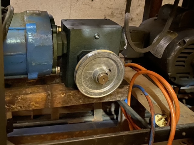

Mail call! Got the 5” dia, 1” bore pulley for the bandsaw:
And the Resp-O-Rator arrived:
Just need to replace the missing blade guides, mount a new blade, lengthen the clearance hole for the belt, and we should be ready to cut metal!

Sorry, forgot: and fit the new tires on the wheels.
