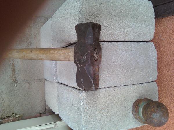

stopped by the fleamarket on the way home from church and picked this one up; 8 pounds, looks to have been reforged from a standard sledge.  Face is now square and swelled from the body. Straight Peen shows a trace of a cold shut from forging down the second face on the very edges where they swell from the original body. Looks to have the face a bit too hard as well.  I'll regrind and retemper to suit myself and gussy it up a bit.  Handle is still usable if it's reset lower onto it.
US$8
T. P.

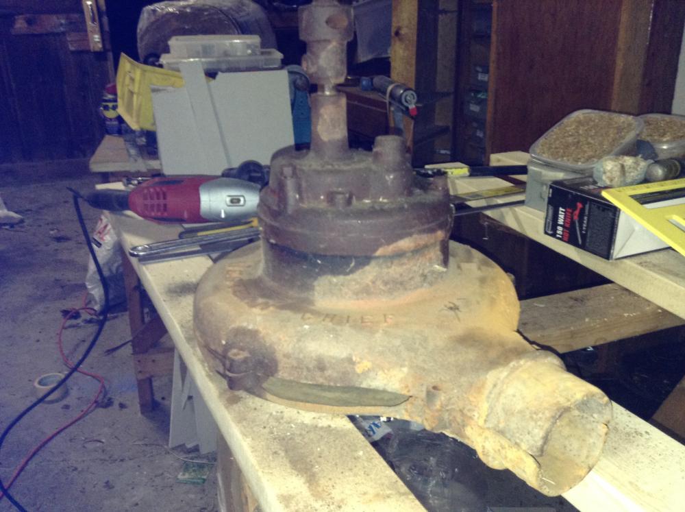

The ground finally dried out enough for me to get it to the shed...  It's good to have friends since this came from a farm near us...  I received the forge, the blower, the PW 142lb as a package.  The blower has a busted off attachment point but otherwise is in excellent shape (the shafts in on the gears are still shining clearly), the forge has a crack along the attachment point with the blower support arm but otherwise in really good shape.  I dropped in a centaur forge large firepot since one of the tabs on the original pot, the tuyere plate and the clinker ball, and the hood are missing from the original set.  Talking to a couple of really good welders I know and finding one who's really good at welding cast.
