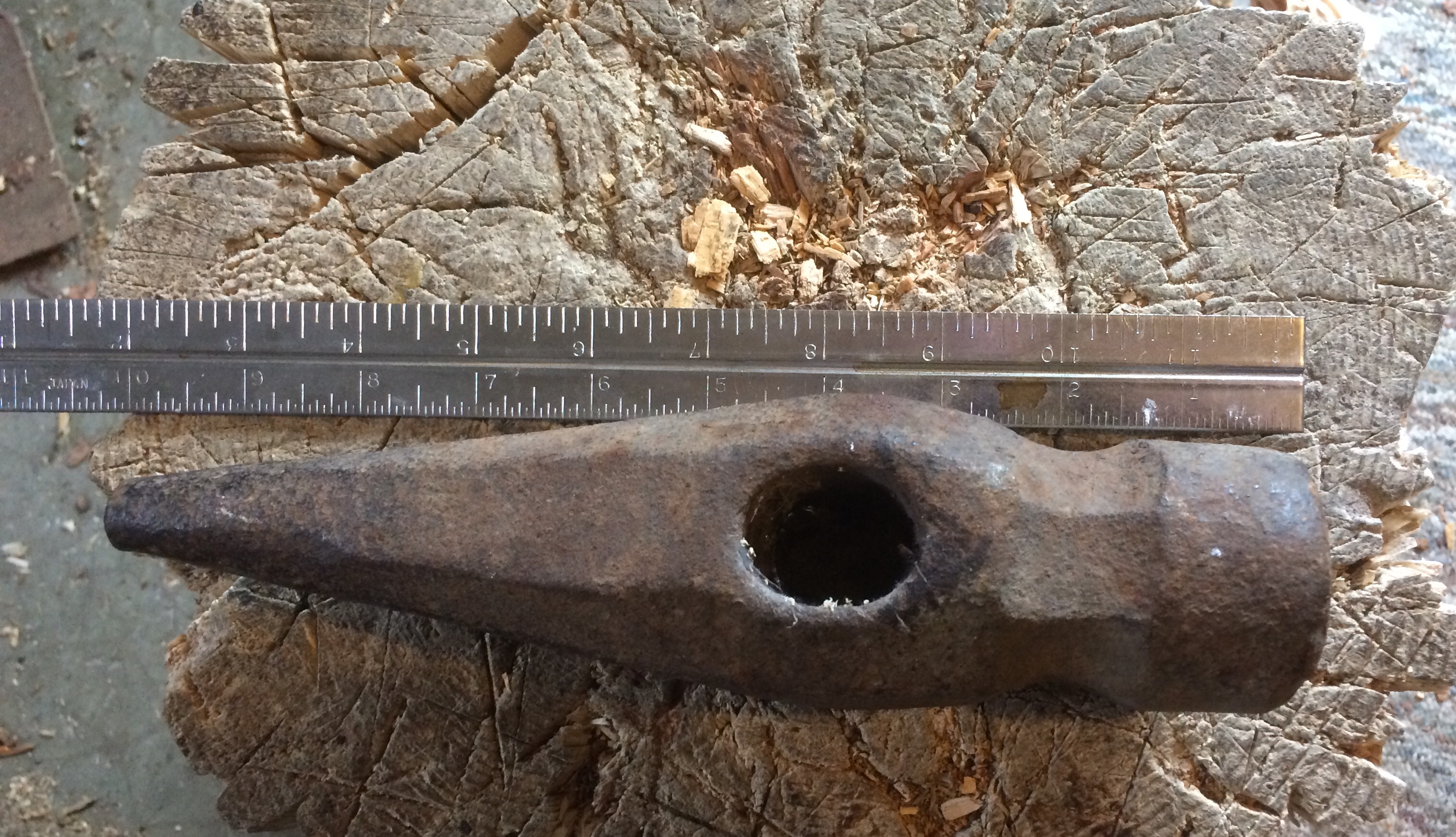

It followed me home
Doing some research I do believe it is a large coal hammer. The flat side has a large chip in it so I'm thinking it's been used for some thing else aswell. I may forge down the pointed end some and make it a heavy handled punch for hammers and such. Thanks for the info

On March 8, 2017 at 10:23 AM, Wayne said:
It looks similar to what I know say a coal hammer, my grandad used one for smashingle up the largest bits for the fire. He was a mineral not a Smith.
xxxx auto predict
I have no idea what that last statement was supposed to mean, but watch your language.
I would also be interested if there are any other opinions on what that thing is. I saw one made by Atha that was 3 lbs.
I had one of those once, years ago. Lost it in the Great Dissolution of 1992. Coal hammer makes a lot of sense: the flat part was much more a striking face than a struck face, and the pointy end would make sense for breaking up big chunks. Remember that this would probably be used by someone with a coal furnace or the like, rather than by a smith.
I don't think it is a coal hammer. Mine is too heavy a beast for that.
The domestic coal hammers I have seen are much lighter and double ended...just a tapering to a hemisphere end.
If it was for an industrial or commercial sized furnace I would doubt the need to break the lumps down.
My one has a flat on the end of the taper so has all the appearance of a metal punch.
Maybe the big flat face was for driving a chisel or punch....I also keep thinking of slaters' drilling hammers and wondering about lead workers punching holes through sheet lead.
The taper could be used as a podger to align holes for riveting and the big flat face would be good for thumping a rivet head or rivet snap.
Two minutes later.....having thought of rivets I did a Google search on riveting hammer and hey presto!....
"Titanic riveting hammer" comes up.
Alan
The full length handled image is from the Belfast Museum and is listed as a riveters' hammer. The caption was not included for some reason. Third try.....
Alan
This one is closer to 8lbs. It's 9 1/2" long
Pic of the damaged faceimage.thumb.jpeg.31e72ba724566bd3ce012c2fbfc4bed1.jpegimage.thumb.jpeg.3df666aa9c575c93262ba7fcdc474808.jpeg
