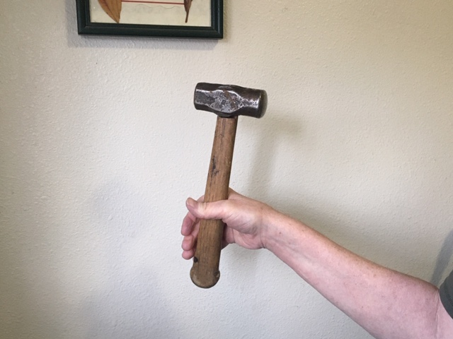

After forging just two simple hooks last night, boy do my hands hurt. Almost to the point of having to take something for it. Would you guys happen to have any advice for mitigating that? The general rule is if it hurts, you are doing it wrong but maybe my hands are just too messed up and the pain is unavoidable in my case.

I did think about trying to put a more personally fitted wooden handle on as  when I took the class, Adlai's hammers were much more comfy to hold and felt...nicer? I think that is how I would describe it.

Have NO compunctions about modifying hammer handles.  The commercial ones sold are NOT the best shapes; just the ones they think they can make the cheapest and sell the most to the general population.

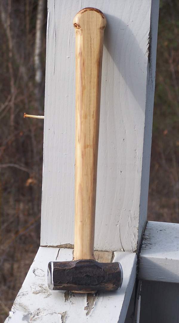

Surprisingly hammering has little effect on my hands IF I don't use a store bought hammer handle. I modified Uri Hofi's slab handle after trying a friends slab handle farrier's hammers. What I changed is I tapered them slightly wider from head to end and I made a disk "bulb" on the end. As it turns out the enlarged end hasn't been necessary, I've never had one of these hammers slip out of my grip but they are sort of an expected feature so they all get it.
Being a flat and relatively narrow about 1" thick and tapered makes them index automatically, you always know how the head is oriented left/right. This is how Uri is able to use the edges of his hammers as fullers so accurately. The taper trips a reflex reaction to tighten your grip at any sign of it slipping and being tapered only the slightest tightening will stop the hammer cold. It's unnecessary to "grip" my hammers, I hold them between the first joint of my thumb and knuckle joint of my index finger. My other fingers only apply pressure just before impact and only to snap the handle into my palm at the moment of impact and I relax them instantly.
This allows the hammer to rebound on the pivot point between finger and thumb joint and oh yeah, my other fingers catch the handle before it levers itself out of my hand. I take no as in ZERO shock in my hands, none. It's all absorbed gradually through friction and elastic impact with my finger tips like a shock absorber.
Holding it on a pivot adds a 4th pivot point to my swing. Every pivot point is a force multiplier and I crack my hammers like a whip I only reach high with a heavy hammer I roll my lighter ones down my swing path. Envision the cracker on a bull whip or the action of the fly, fly casting.
The first pic is the handle on a turning hammer a friend helped me make, the handle is 5//4 clear straight grain hickory I bought at a cabinet lumber store. The second pic is a 32oz straight pein that was a ball pein before I got my hands on it.:ph34r:
      Hammer2Wh.thumb.jpg.6f2b8ff56c9fa74d23f2b55061a080fc.jpg 1051925940_straightpein02.jpg.703ca0faa363d73dbaf2f236ec6c1a0a.jpg
These are posed and a decent approximation of the way the hammer moves in my hand in use. At no point am I actually gripping the hammer, it's floating like a foil in a fencer's hand.
