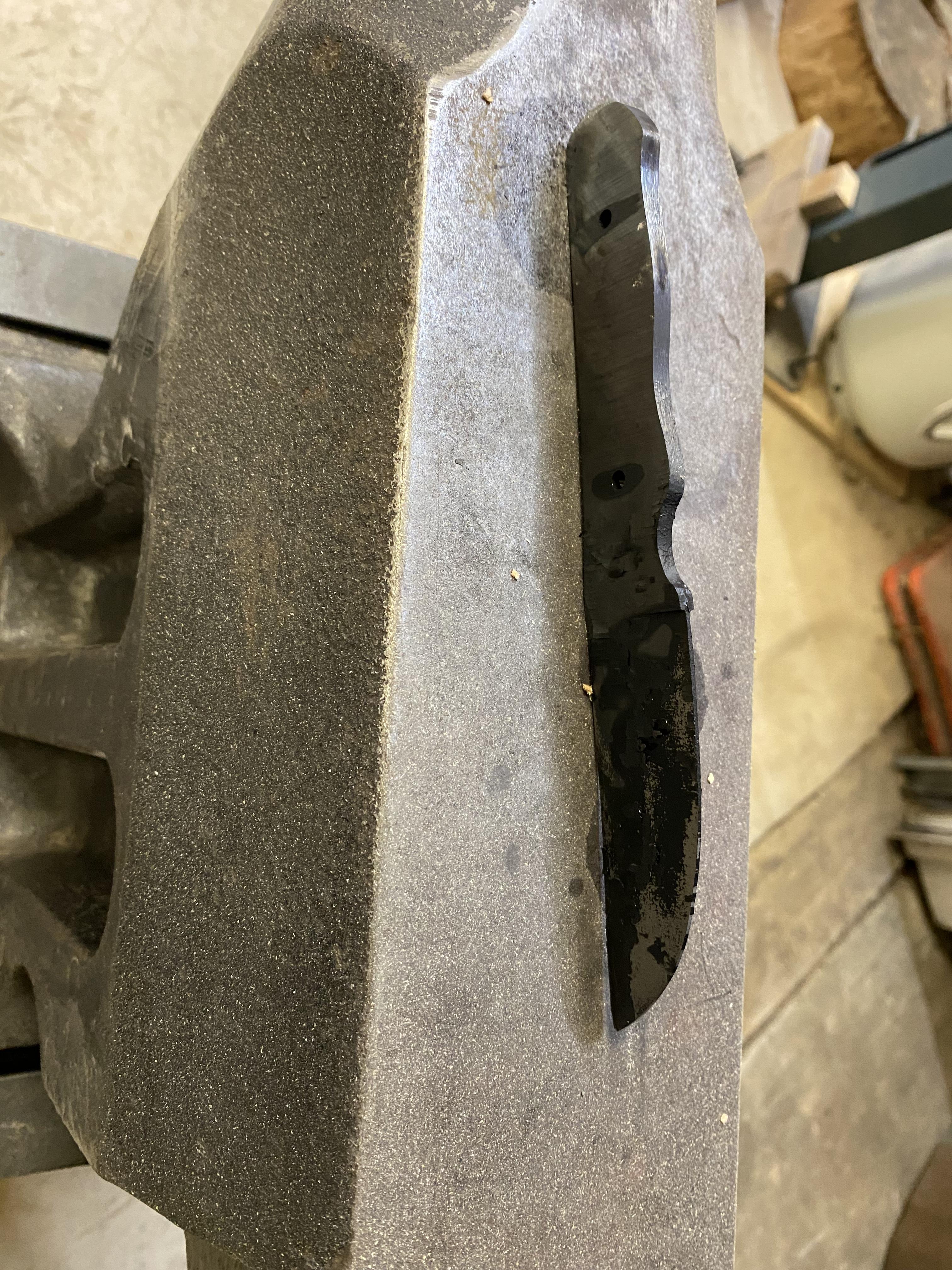

  4. Not much of a poster, more of a lurker but I appreciate all the info here and wanted to say thanks. Working on my second knife. Made one out of a RR spike a long time ago, but wanted to practice creating something with a real handle. I started with the stock coil spring out of my truck. Not sure what the steel is, but it hardens in water (didn’t harden with air or oil quench). Been educational so far. Looking forward to seeing how this comes out. Not good at taking pics throughout the process but this is one after a rough grind and after an oil quench.
