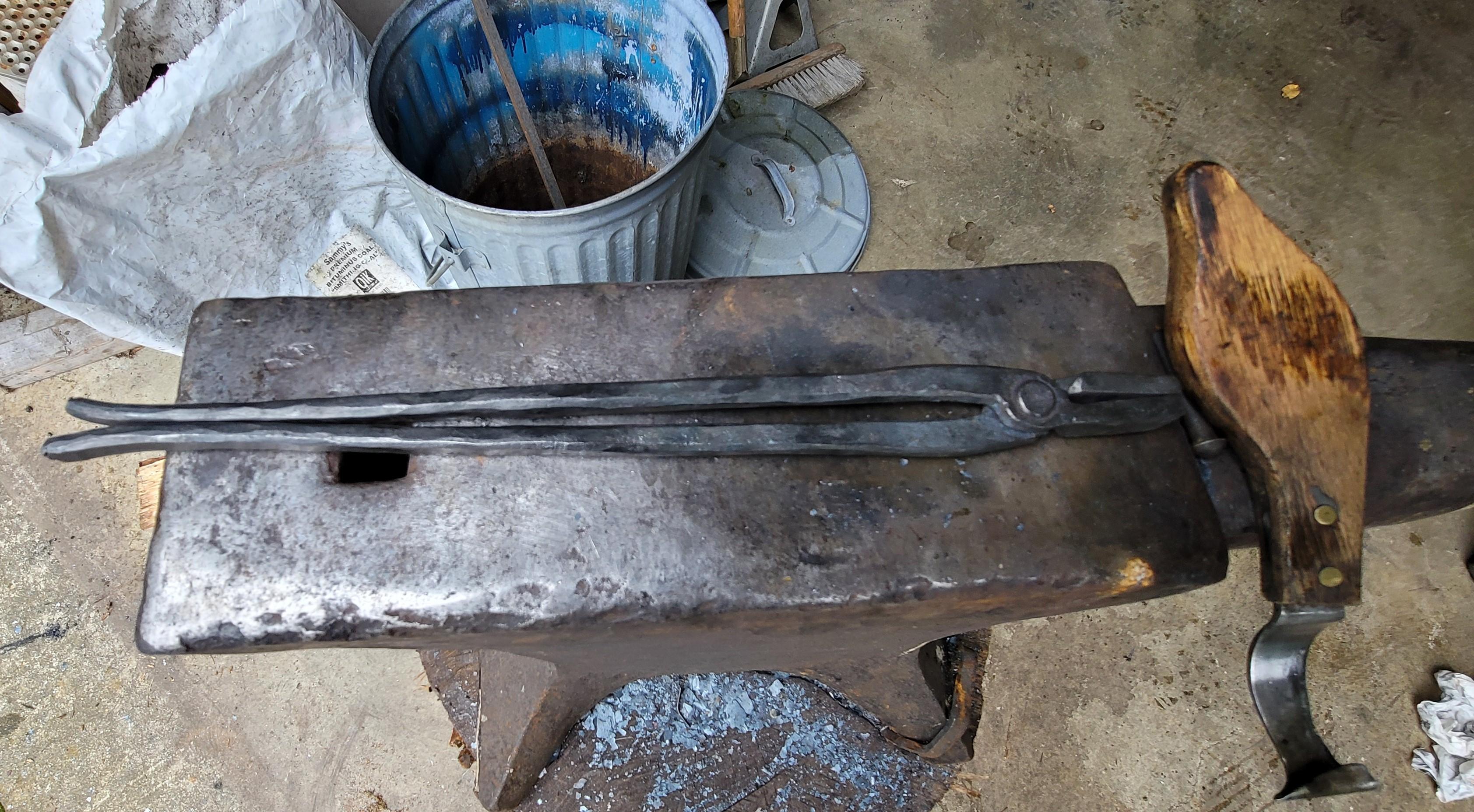

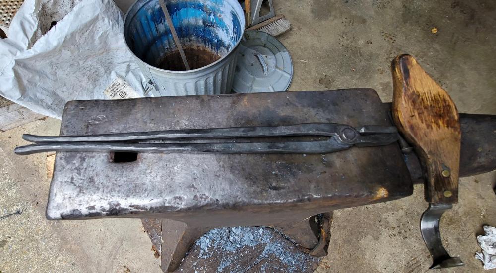

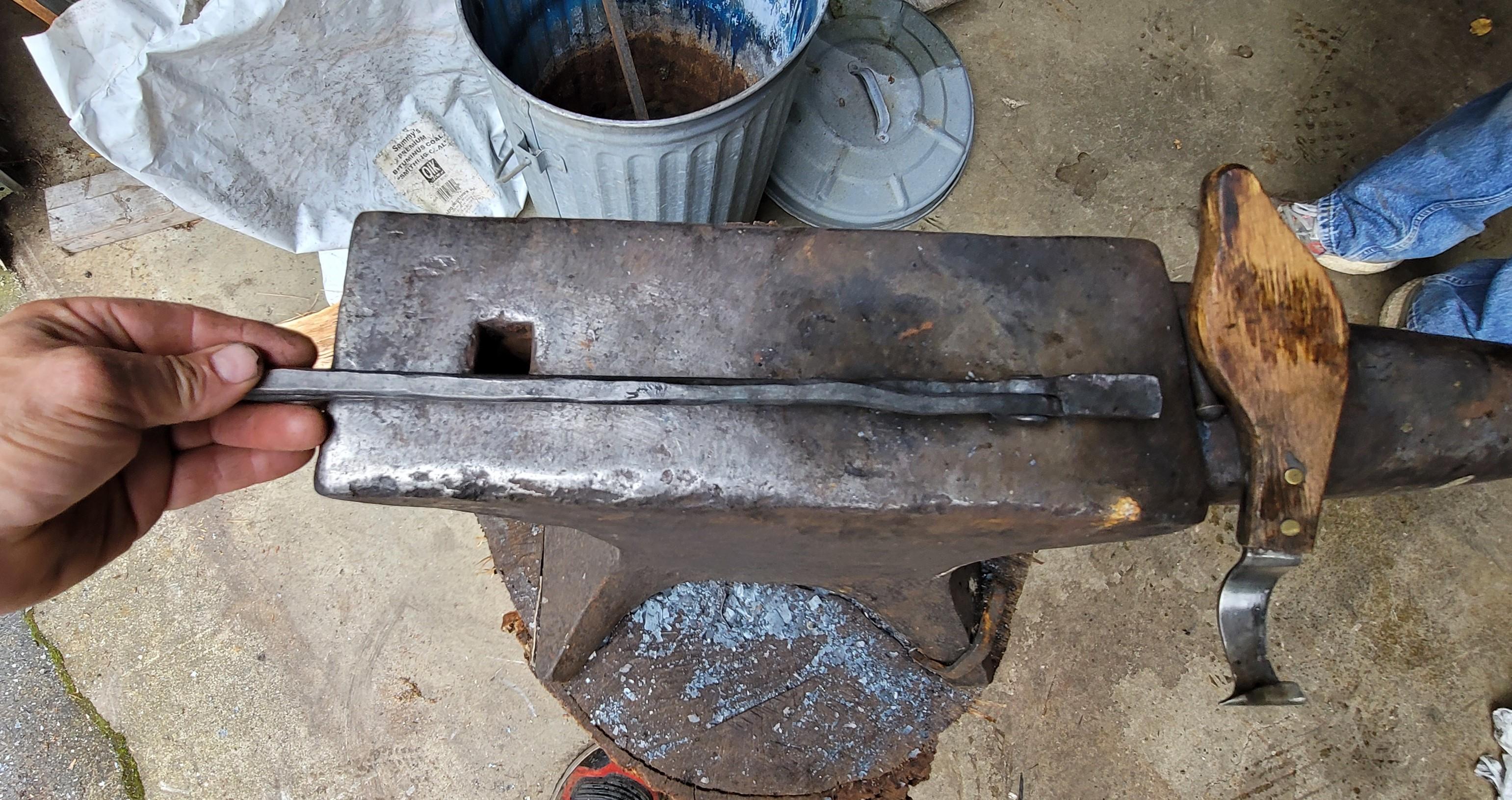

Not my shop..   I went to visit a friend and bladesmith and he was making some tongs for small work.
I jokingly said I could make a pair in 20minutes.. LOL..  "At someone else's shop.".  LOL>>  There is no way unless they are super sloppy or have an amazingly well stocked shop..
took 1hr  and change..  1/2" stock with anvil sitting way to high for my liking.
I don't know how anybody can forge on an anvil knuckle height..  One losses  the most important part of the stroke..  :)  I don't know how to make a smiley with tongue sticking out..
Had a great time making them and was very much fun visiting..
Jennifer, I feel so much better now. The last pair of tongs I made took me probably 4hrs and turned out pretty horrible and I left them for scrap. (Another smith, picked them up at our next meet up and used them, saying they weren’t that bad…) I guess everyone can have an off day, especially outside of their own environment.
Goods we often judge our own work the harshest..  :)
For sure..  I'm often amazed at what do at their shops with lack luster equipment..
what I take for granted at my place is way outa whack someplace else..
Was the first work out for the 4lb steeled wrought iron hammer.  :)
I can't wait to supply him with more tongs..   He had about 8 pairs nearlly all for knife making..

He is left handed and this was his first set of left handed tongs..
I'm so programmed to make right handed tongs I kept trying to change the jaw to boss angle..
For right handed tongs get held at the reverse angle for nice fit up of jaw to boss when put together.

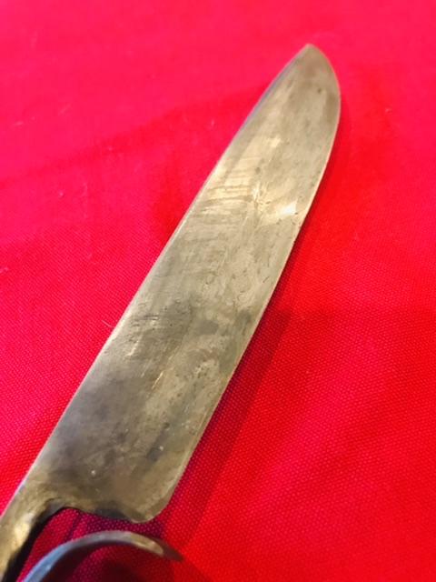

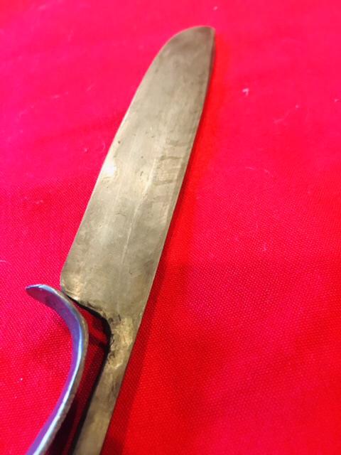

After about 16hrs in vinegar, I’m not happy with the etch. (Is the cloudy area on one side a ham on?) At least all the welds look good. (Please ignore the grinding, I’ve got a lot to learn!)FAD125B7-762D-4C35-93AA-05EF4BA3E785.jpeg.7d71ec4c4ea2375e6798644d9d530574.jpeg0EAD04EE-294E-4703-BC7E-7E0F6D0861B7.jpeg.d6c49bdb5d785d391e3adf120e190ec8.jpeg
I’ve moved up to murratic(sp?) acid. Hopefully, I won’t destroy it.
I would give it a light sanding with about 200grit and then thoroughly degrease it before putting it completely in the acid.
Muriatic acid is what I primarily use as well as vinegar and what you seen is typical for regular strength. They sell commercial strength which I prefer and get it from a store I know..
It really does seem that the materials for the most part like Ferric chloride better and then coffee soak to bring out all the high and lows..
I feel it becomes what one is really after..
Cable damascus personally I like to leave fairly loose since for the most part its a homogenous material it doesn't pop like crazy.. No differences really in materials.

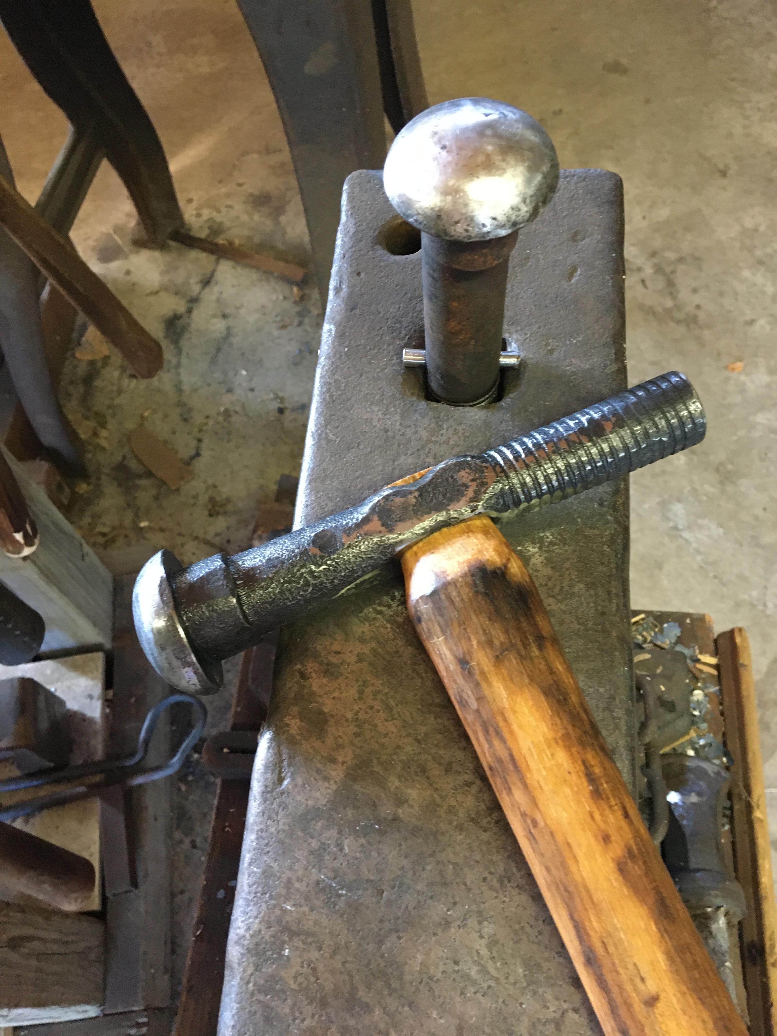

A buddy dropped some RR bolts and other goodies at the end of my driveway, and I finally got a pic of some of the resulting product. Simple doming stake for the anvil and a rounding hammer.
Steve
I made my first RR bolt dishing hammer the same way; but I find I use the ones where I put the handle eye back in the threads toward the end a lot more and I can get deeper into large deep dished items without chopping up the handle on the rim of the item being dished.

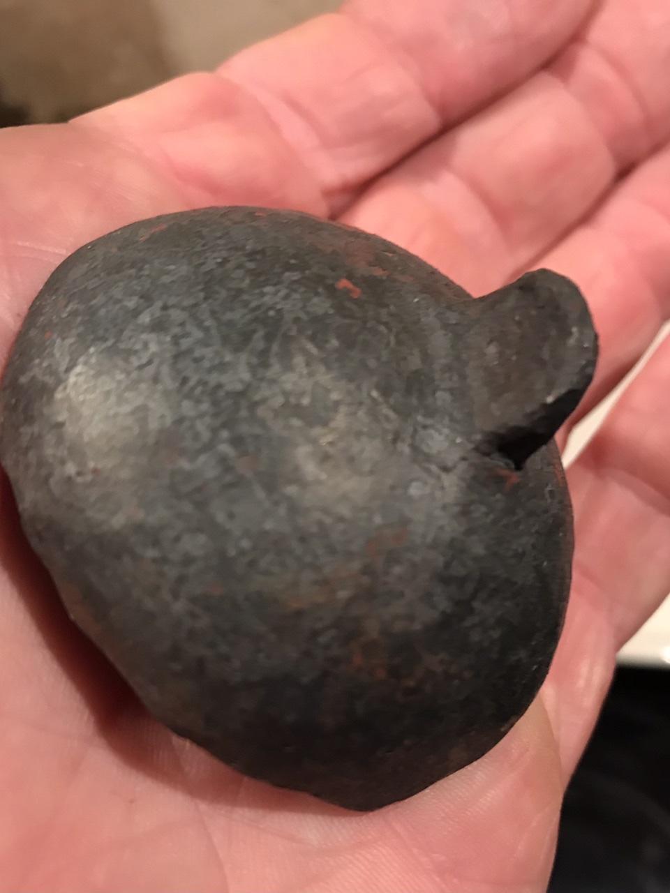

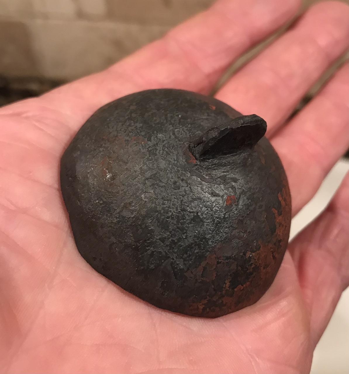

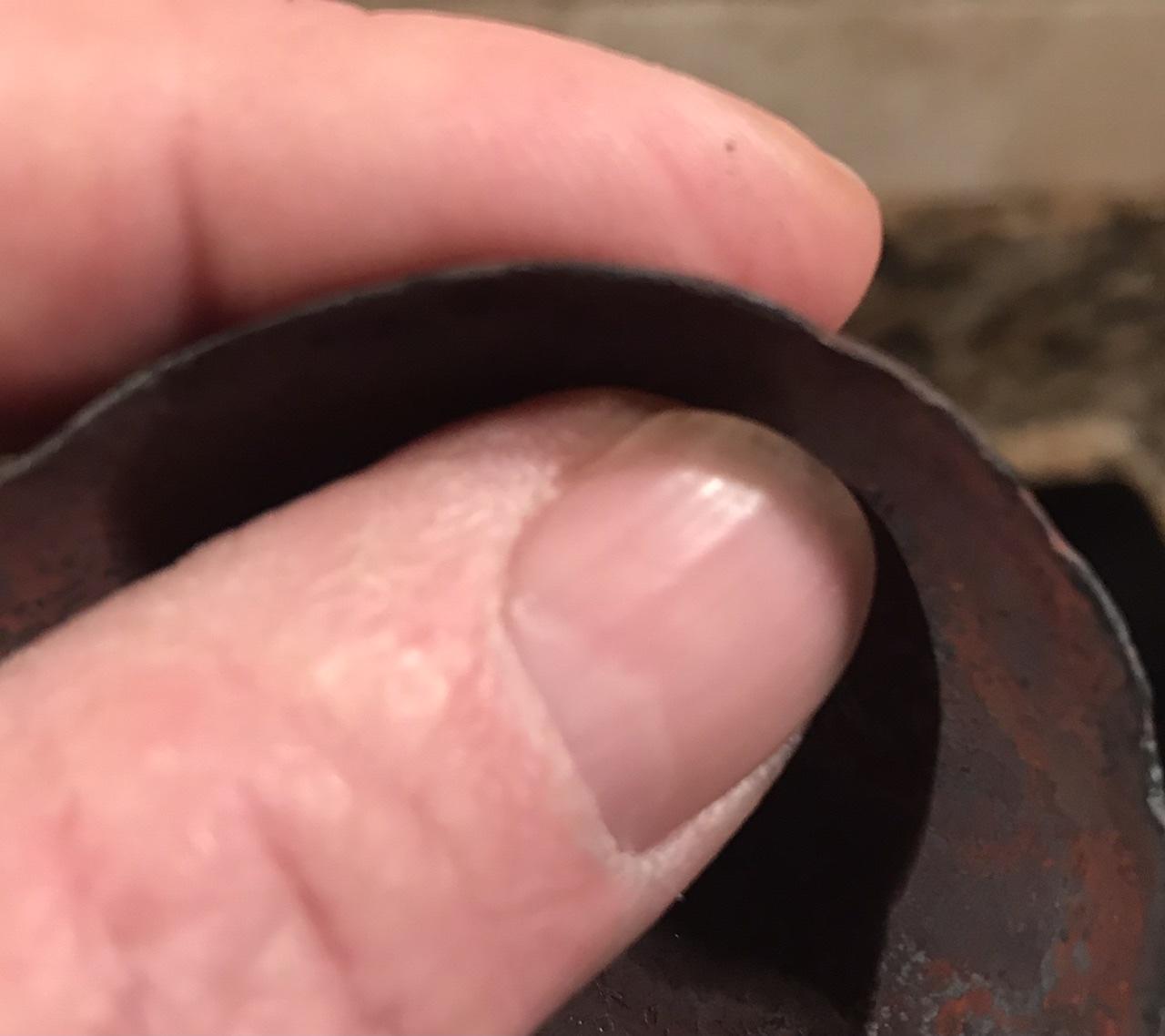

I made a little bell out a 3/8” piece of 1-1/4” round 4140. I am really happy that I was able to create the crown to my vision. It was harder than I thought it would be
That's very cool. I should give that a try.
Nice; how does it sound?   I have a couple of Bells I need to work on; picked them up as part of my "Keep the scrapyard open"  goal during the lockdown.
