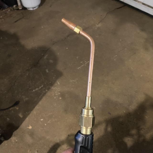

JHCC Posted July 26, 2021 Author Share Posted July 26, 2021 Update: I found an eBay listing for a "VICTOR TEN-5 Propane/Natural Gas Brazing / Welding Tip". I wasn't able to see from the listing if it would fit my WH411 torch, but decided to take a gamble, especially since (A) "TEN-5" is a Victor designation for a propane-compatible brazing tip and (B) the price (including shipping) was less than a new tip by itself. When it arrived today, I discovered that it DOES fit the torch, but I'm not sure if all of it is indeed Victor. The stem is stamped "BGN-6", which seems to be an American Torch Tip 6" gooseneck, and the mixer is stamped "1-W", which seems to reference the "W" series nozzles that fit the 300 & 400 series torches. (Addendum: the "1-W" mixer is NOT the same size as a Victor "W-1" mixer, which would fit a 100 series torch but not the WH411-C torch that comes with the Medalist set.) I still need to get another tank of O₂, so I haven't had a chance to fire it up yet, but things look good so far. What I'm having trouble with is finding any official Victor chart of pressure settings for propane brazing with a TEN tip. I've contacted Victor to see if they have any helpful info. Quote Link to comment Share on other sites More sharing options...

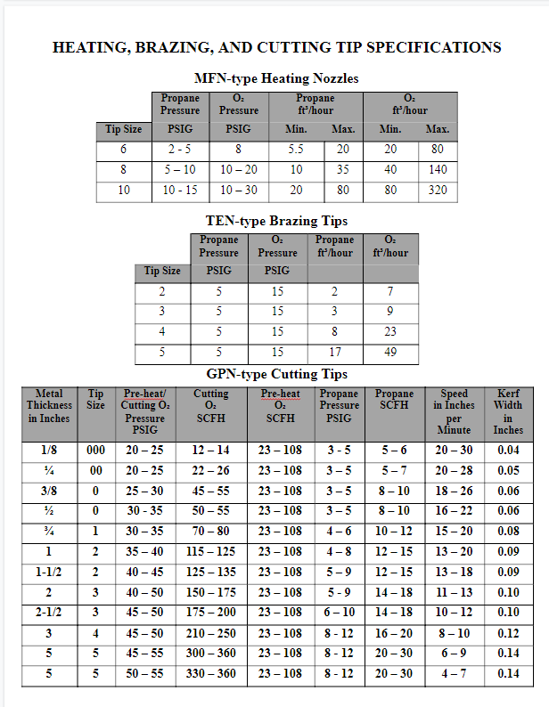

JHCC Posted July 27, 2021 Author Share Posted July 27, 2021 UPDATE: Spoke with a nice young man at Victor's customer service department, who shared my puzzlement at the absence of TEN tip pressure settings on the website. However, he did email me a chart of the appropriate pressure settings and flow rates. The short version is that all sizes of TEN tip take 5 psi in fuel (either propane or natural gas) and 15 psi of O₂. Credit where credit is due: that was one of the fastest, most efficient, and most informative calls I've ever had with anyone's customer service anywhere. Well done, Victor. Quote Link to comment Share on other sites More sharing options...
Irondragon Forge ClayWorks Posted July 27, 2021 Share Posted July 27, 2021 I have always received excellent service from Victor. Quote Link to comment Share on other sites More sharing options...
JHCC Posted July 29, 2021 Author Share Posted July 29, 2021 Here's the updated chart: Quote Link to comment Share on other sites More sharing options...

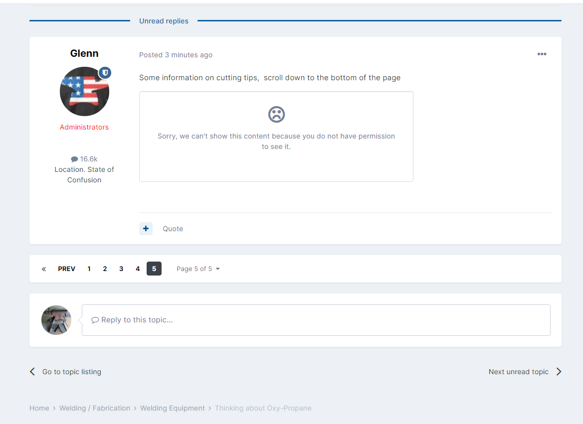

Glenn Posted July 29, 2021 Share Posted July 29, 2021 Some information on cutting tips, scroll down to the bottom of the page Quote Link to comment Share on other sites More sharing options...
JHCC Posted July 29, 2021 Author Share Posted July 29, 2021 Glenn, I'm getting this: Quote Link to comment Share on other sites More sharing options...
Glenn Posted July 29, 2021 Share Posted July 29, 2021 IForgeIron Blueprints Copyright 2002 - 2007 IFORGEIRON, All rights reserved. BP0018 Victor Cutting Tips Guide by James Joyce For Cutting Tip Size ...... Metal thickness .................Oxy Cut Psi .................Acet Psi .................Speed in/min 000...............1/8" .................20-25 .................3-5 ................. 28-32" 00................. 1/4".................20-25 ................3-5 ................. 27-30" 0....................1/2".................25-30 ...............3-5 ................. 24-28" 2....................1"....................35-40 ...............3-6 .................15-19" 3....................2"....................40-45 ................4-8 .................12-15" For Ox/Ac Welding Tip # .................Metal Thickness .................Psi Ox/Ac .................Tip in Drill Size .................Tip in Inches 0 .................to 1/32" ................. 3-5 / 3-5 ................. 65 ................. .035 1 ................. 1/32-1/16" ................ 3-5 / 3-5 ................. 60 ..................040 2 ................. 1/16-1/8" ...............3-5 / 3-5 .................56 ................. .046 3 .................1/8-1/4" .................4-7 / 3-6 ................. 53 ................. .060 4 ................. 1/4-3/8" .................5-10 / 4-7 .................49 ................. .073 5 ................ 3/8-1/2" ................. 6-12 / 5-8 .................43 ................. .089 Place the information on the Oxygen tank and cover with clear tape. That way it will be handy when you need it for reference. You need to consider adding comments after-the-fact to some of the items. For example Joyce suggests taping Victor's cutting guide to the oxygen tank. A good idea until you exchange tanks. However, if you transfer the guide onto a flat "refrigerator magnet", you can transfer the material from tank to tank. You can buy vinyl covered magnetic sheets at Lowe's (and presumably other similar stores). They are sold cover up hot/cold air registers that don't have internal dampers. A pair of 9" x 18" magnets cost me $5 or $6 the last time I got them. 3M's Super 77 spray adhesive works well if you want to paste onto the surface. Magnets can be easily cut to size with a pair is scissors. I have charts and tables "pasted" everywhere. Drill press speeds, welding rod spec's, lathe pulley speeds, resistor colors, etc. One note, if you are putting a paper label onto a magnet to be curved around a tank, do the lamination on the curved tank itself. Lon Crosby Quote Link to comment Share on other sites More sharing options...
JHCC Posted July 29, 2021 Author Share Posted July 29, 2021 Thanks, Glenn. For some reason, the site isn't even letting me into the Blueprint section at all -- or even showing it on the main page. As noted in this comment, the tip chart is in a plastic sleeve hanging off my welding cart/torch stand, with the lighting up and shutting down instructions on the other side. Quote Link to comment Share on other sites More sharing options...
JHCC Posted July 31, 2021 Author Share Posted July 31, 2021 Quick test of the TEN-5 tip. Took a bit of 16 ga. from cold to melting in about ten seconds. Unlike the rosebud (the only tip I’d used hitherto), this tip has a center hole, so I’ll have to learn how getting a neutral flame on this one looks. Quote Link to comment Share on other sites More sharing options...

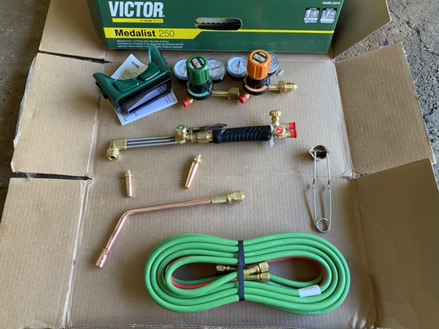

JHCC Posted October 26, 2021 Author Share Posted October 26, 2021 More news: I finally got around to trying out cutting, which was a LOT of fun. However, I discovered that when I’d originally placed my order with Cyberweld, I’d mistakenly specified the extra 00 cutting tip in Victor’s 1-GPN size instead of 3-GPN (the Medalist 250 kit comes with a 1-3-GPN cutting tip standard). Oops. Here’s the good part: I sent an email to Cyberweld explaining my mistake and asking if I could exchange the 1-GPN for a 3-GPN. They immediately replied that this was no problem, even though it’s been seven months since I received the order. They don’t carry the 00-3-GPN, but they will send me a 0-3-GPN once they get the 00-1-GPN back in the mail. I do love good customer service! Quote Link to comment Share on other sites More sharing options...
