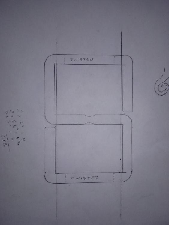

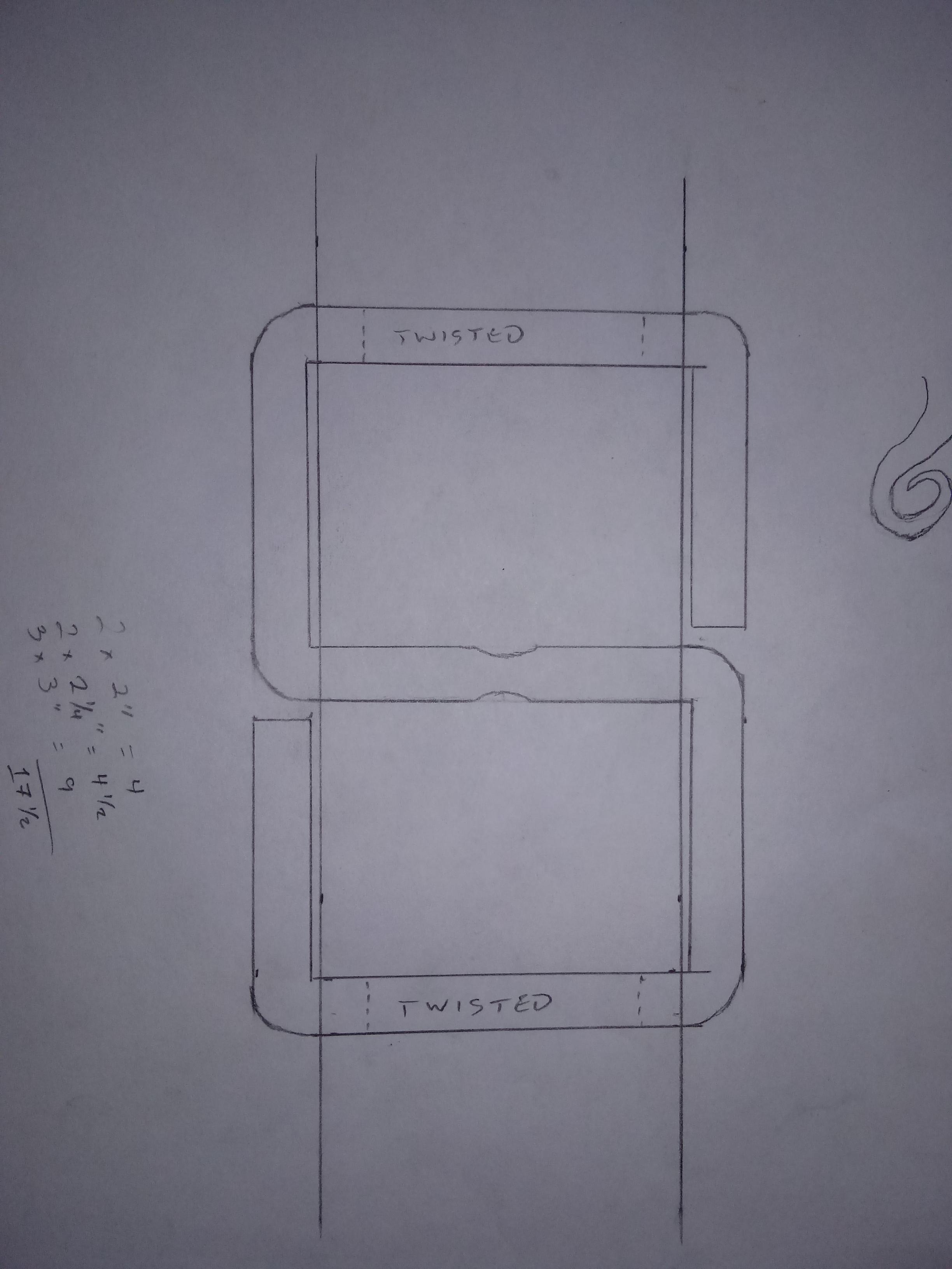

SFC Snuffy Posted July 12, 2019 Share Posted July 12, 2019 I purchased a belt blank from a leather company in Montana, USA, from which I intend to make a kilt belt. I've got some 3/8" HR square bar that I think will make decent buckle. I played around with the design & proportions a bit today... Order of operations on this is going to be key, I think. Quote Link to comment Share on other sites More sharing options...
Laynne Posted July 12, 2019 Share Posted July 12, 2019 I want to see a picture of it when you are finished. I'm connected with a Scottish heavy athletic group. Laynne Quote Link to comment Share on other sites More sharing options...
ThomasPowers Posted July 12, 2019 Share Posted July 12, 2019 Next is to cut it out in cardboard and see how the leather works with it. Quote Link to comment Share on other sites More sharing options...
Cannon Cocker Posted July 12, 2019 Share Posted July 12, 2019 You could bend a coat hanger to the shape to try it out as well. Quote Link to comment Share on other sites More sharing options...
Daswulf Posted July 12, 2019 Share Posted July 12, 2019 Or playdough or clay. Quote Link to comment Share on other sites More sharing options...

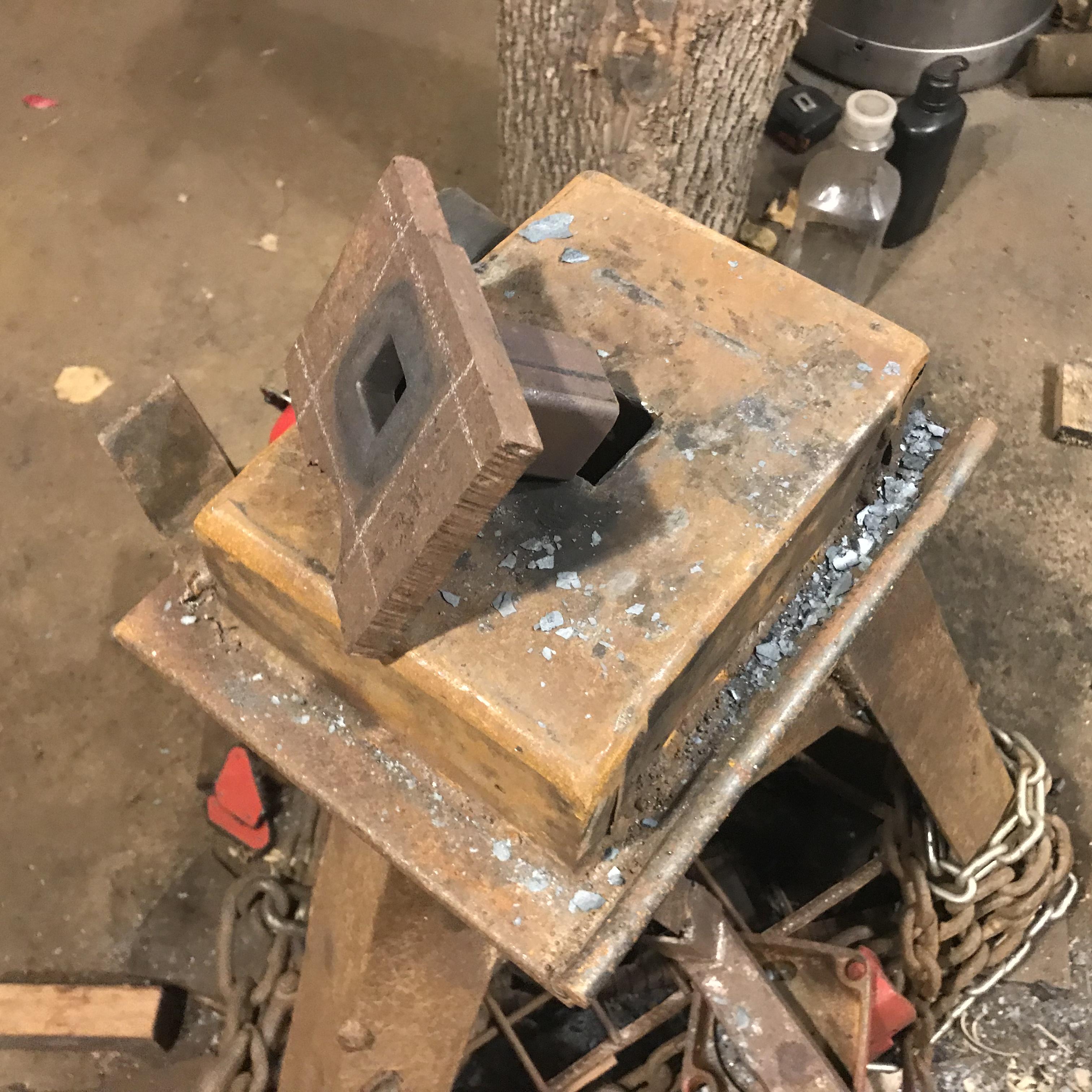

Chris C Posted July 12, 2019 Share Posted July 12, 2019 I forgot I'd not shown a picture of my first Hot Cut Hardy. Looks kind of silly sittin on my anvil because the Hardy hole is only 5/8". Oh well it's a start. I'll get better at making Hardy tools in the future...........I hope. Quote Link to comment Share on other sites More sharing options...
CrazyGoatLady Posted July 12, 2019 Share Posted July 12, 2019 Chris, I'm glad you finally posted it! Looks good to me. What material did you use? I'm looking forward to being able to use hardy tools with an anvil that actually has a hardy hole. I ordered an anvil today. Anxiously awaiting its arrival now. Quote Link to comment Share on other sites More sharing options...
JHCC Posted July 12, 2019 Share Posted July 12, 2019 Looks nice; better than my first. Quote Link to comment Share on other sites More sharing options...
Chris C Posted July 12, 2019 Share Posted July 12, 2019 Thanks to you both. The steel was cut from a cast-off, hexagonal jackhammer bit from Home Depot...............so don't know exactly what steel it is. When you drop the bit on the concrete, it rings like a top-dollar anvil. I only cut about a 4" piece off the bit and I've still got 6 more full bits. Even gave one to a friend. So I've plenty of tool making steel for the future. I forged the 5/8" shaft on a press and then upset the shoulder while it was in the Hardy hole. My "guide" kept saying "Swing that sledge hammer like you mean it!" I was afraid I'd break the tail-end off my little Vulcan anvil.............but it held up just fine. I forged the cutter from the shoulder up with a 3 1/5 pound hand hammer. I'm a perfectionist, so I'm not totally pleased with how it looks, but I'm sure the steel I cut with it won't see the imperfections. CGL, I'm envious.............what kind of anvil did you order? I'm assuming it's new if you ordered one. Quote Link to comment Share on other sites More sharing options...

jlpservicesinc Posted July 13, 2019 Share Posted July 13, 2019 1 Advanced issues found ▲ 1 11 hours ago, Chris The Curious said: I forged the 5/8" shaft on a press and then upset the shoulder while it was in the Hardy hole. My "guide" kept saying "Swing that sledge hammer like you mean it!" I was afraid I'd break the tail-end off my little Vulcan anvil.............but it held up just fine. I don't want to rag on you for using the anvil to upset the shoulder on /in the anvil.. But, Ideally, a London pattern anvil that is 100 years old is not the best option to take a sledgehammer to it to form or forge anything over the heel (tail) or the horn if really wailing on it. A German style or type of anvil with the hardie hole supported by more mass is ok, but the London patterns have been known to let loose (snap off) will little warning and now the anvil is ruined as is the history it contains. Way back in the day I used to use my Hay Budden anvil, like it was brand new and easy to replace. And figured if they used it that way the day it was made than why can't I.. Well the answer now 20 years later is self-apparent. it's your anvil and you can certainly do whatever you want as people do what they do. But...... Nice Hardie.. I'm a perfectionist too... It's a wonderful trait... Well, most of the time.. Quote Link to comment Share on other sites More sharing options...
JHCC Posted July 13, 2019 Share Posted July 13, 2019 A striking anvil/portable hole (with an adapter, if necessary) is a great option for upsetting hardy tools. Quote Link to comment Share on other sites More sharing options...
jlpservicesinc Posted July 13, 2019 Share Posted July 13, 2019 Jhcc. I love the stuff you have made. that is fantastic and a brilliant example to have on the shop floor. SLAG, A company cannot control what a new owner will do.. A ball bearing will certainly dent and anvil face if thrown hard into an anvil. A hammer face will dent an anvil face with a miss strike and a ball bearing is harder than most hammers. I'm not trying to create an argument over someone else's warranty limiting but the comment is in relation to a ball bearing damaging an anvils face.. A ball bearing has a higher Rc than most anvil faces and if miss used can indeed dent the face of an anvil. Quote Link to comment Share on other sites More sharing options...
BillyBones Posted July 13, 2019 Share Posted July 13, 2019 " doing the ball bearing test will wreck any anvil due to the ball bearing being harder than the face of the anvil." I am thinking that they are referring to Brinell hardness testing and not dropping a ball bearing on to the face. Quote Link to comment Share on other sites More sharing options...
Chris C Posted July 13, 2019 Share Posted July 13, 2019 Jennifer, I was worried about using my little anvil to upset the shoulder, myself.................but this old feller has over 50 years experience at the forge and anvil and I figured he new what he was telling me to do. Besides, there wasn't another 5/8" square Hardy hole in the shop. All of these jackhammer bits (6 of them) have a shoulder on them already, so in the future I plan on using the existing shoulder and not pounding that hard on my puny little Vulcan. "Rag" on me all you want. I happily yield to experience. If I ever get a "grown-up" sized anvil with a larger hole, I'll make an adapter like JHCC's so I can use any previously made 5/8" Hardy tools I've made. The hunt for a decent anvil continues. Quote Link to comment Share on other sites More sharing options...
