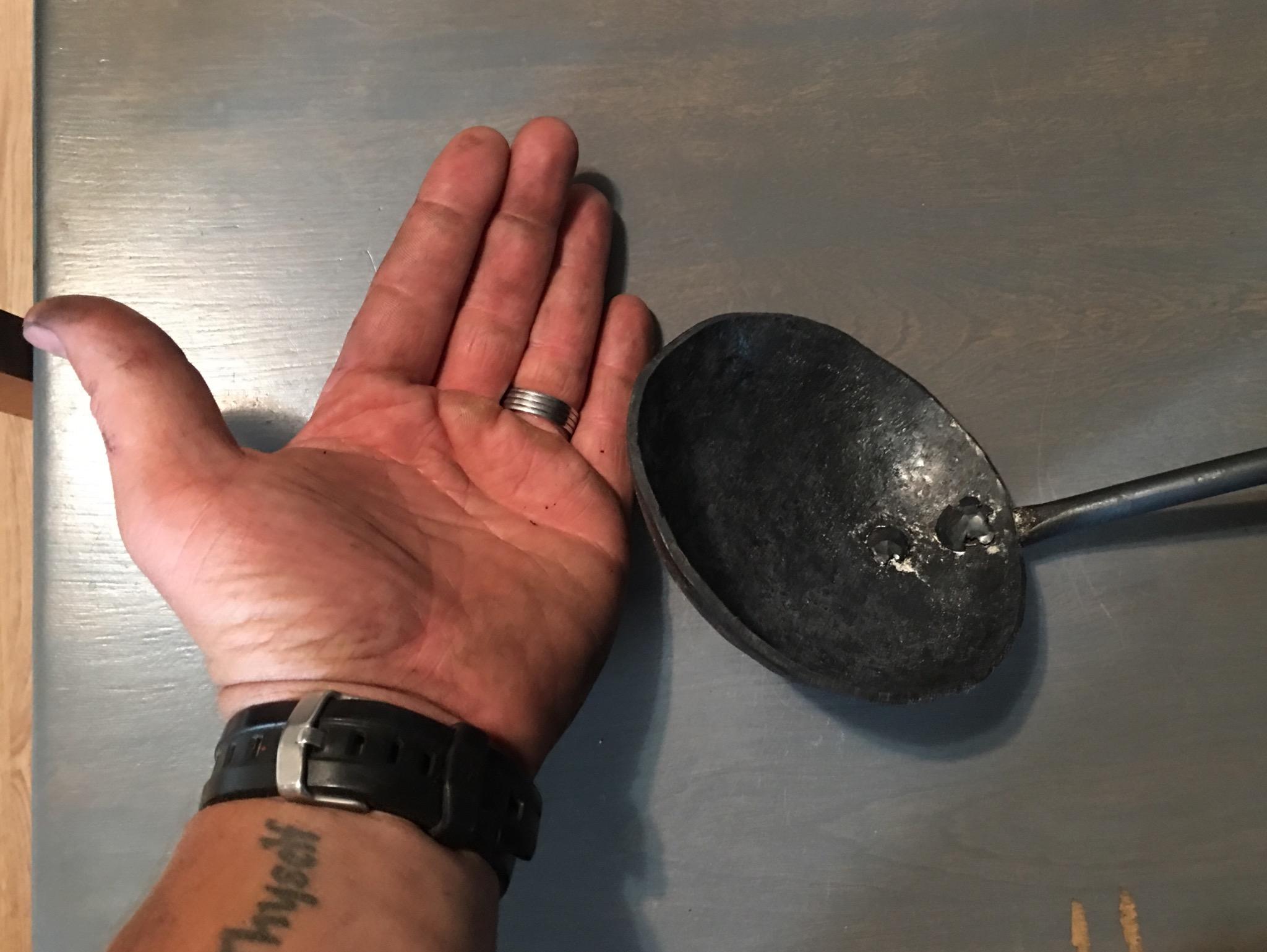

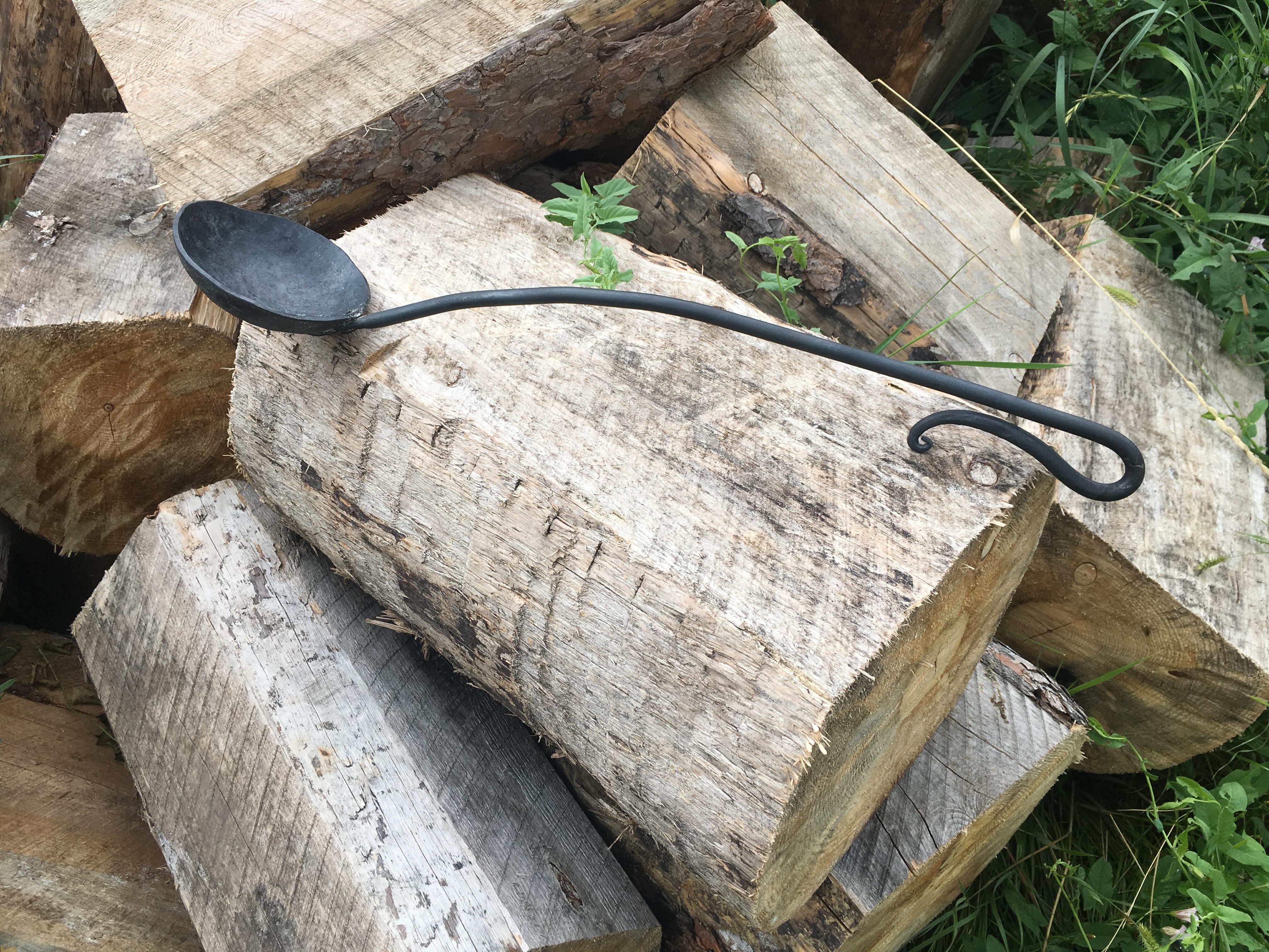

Cannon Cocker Posted July 14, 2019 Share Posted July 14, 2019 I made laddle to use as a water can in the smithy. Link to comment Share on other sites More sharing options...

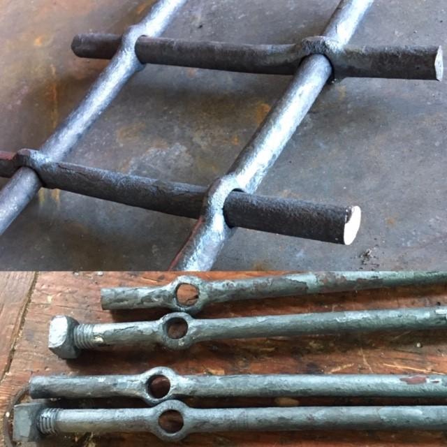

Michael Posted July 15, 2019 Share Posted July 15, 2019 A friend of mine taught me this joinery technique last week. Bolsters and punches and a drift sized to the stock. Easier than I thought going into it. Just a practice piece for fun, though the lovely wife thought it would make a nice trivet. Link to comment Share on other sites More sharing options...
Chris C Posted July 15, 2019 Share Posted July 15, 2019 Jail cell bars. Kewell!!!!! Link to comment Share on other sites More sharing options...
BillyBones Posted July 15, 2019 Share Posted July 15, 2019 Your wife aint the only one, i thought that it was a trivet till i actually read what you posted. Pretty cool. Link to comment Share on other sites More sharing options...

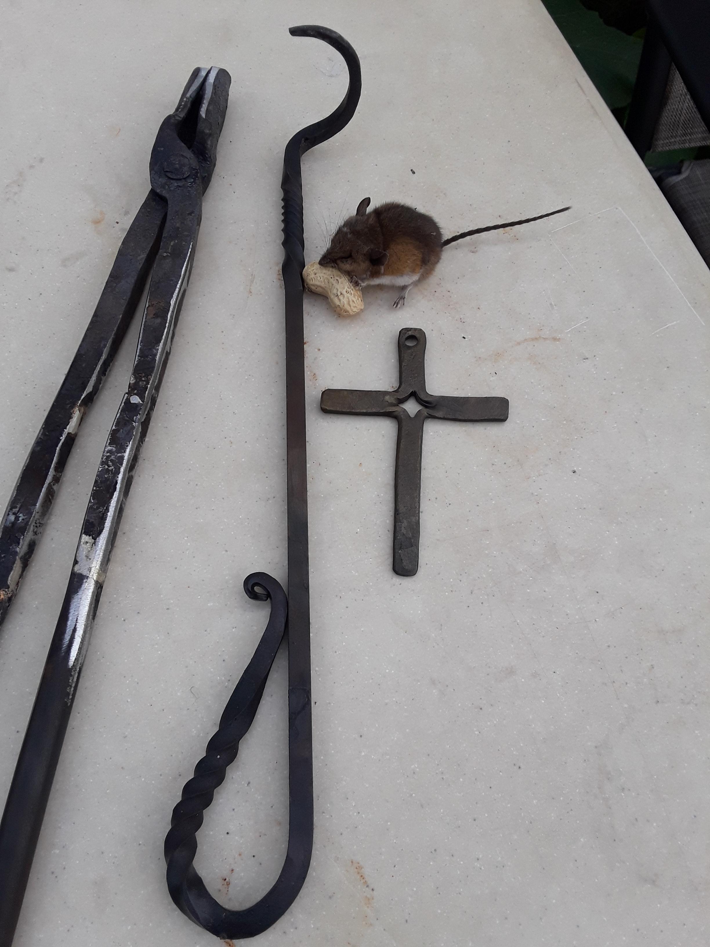

BillyBones Posted July 19, 2019 Share Posted July 19, 2019 Finished a set of tongs i started about 2 months ago. Made a steak flipper and my first cross. Cross started as a piece of 1/2 round, squared, slit, and formed...mouse approved. Link to comment Share on other sites More sharing options...

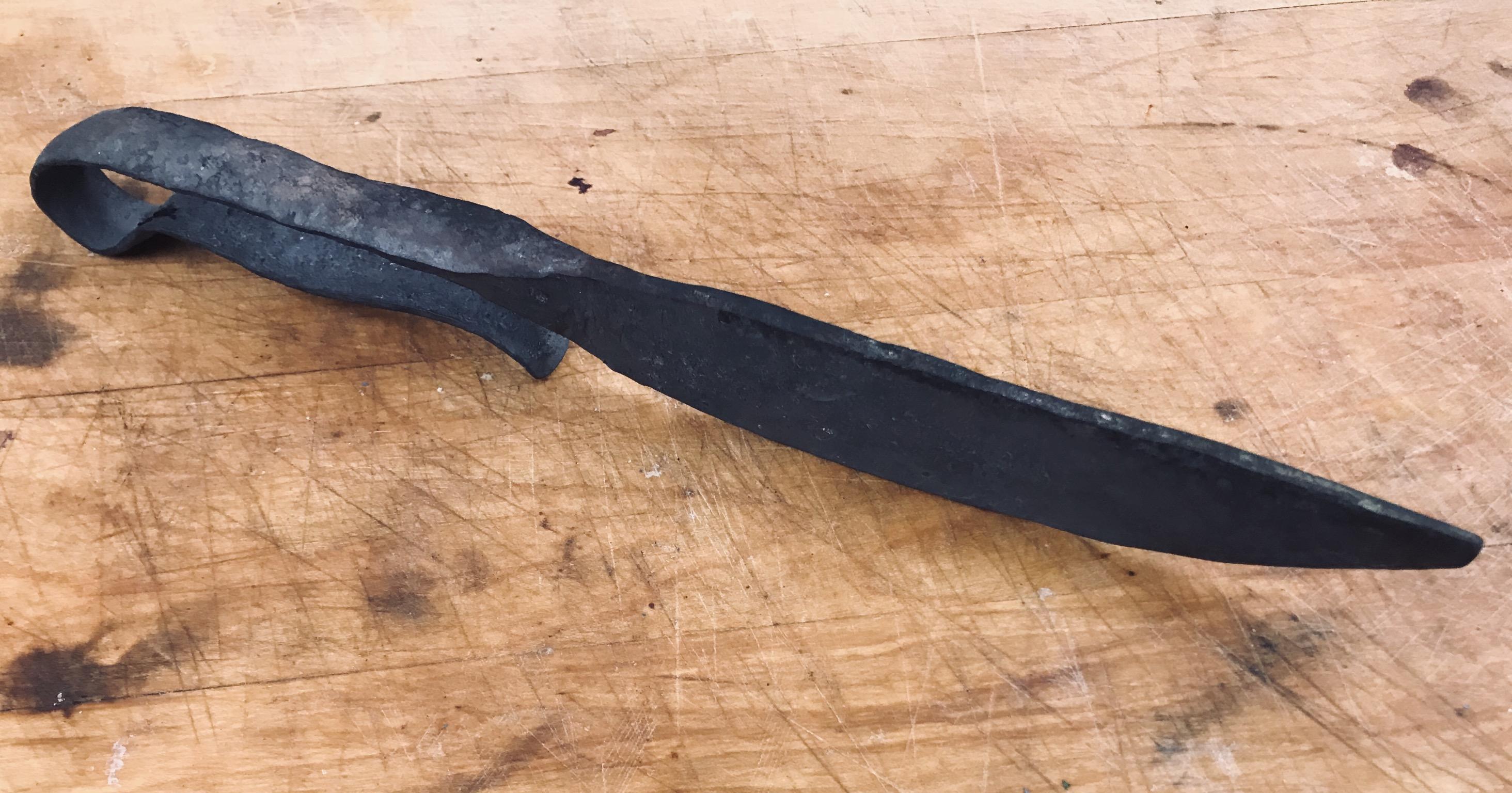

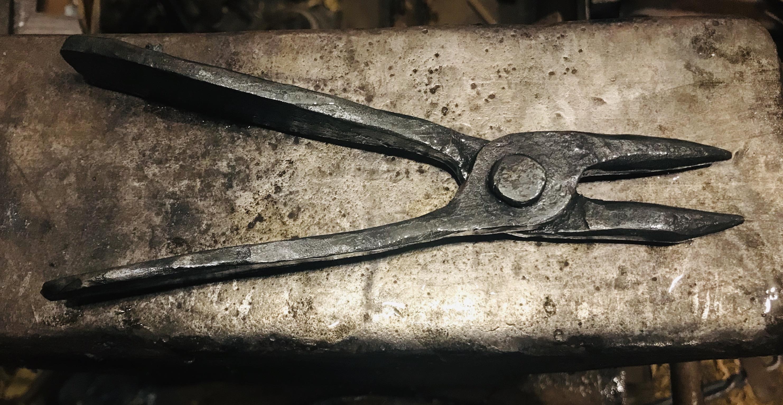

JHCC Posted July 19, 2019 Share Posted July 19, 2019 Finished forging a chef’s knife (currently annealing in the hot box, so no photo) and made a nice 8” long pair of scrolling pliers: Observation: forging with coal is not as oppressively hot in the shop as with gas, but frequent hydration is still a good idea. Link to comment Share on other sites More sharing options...

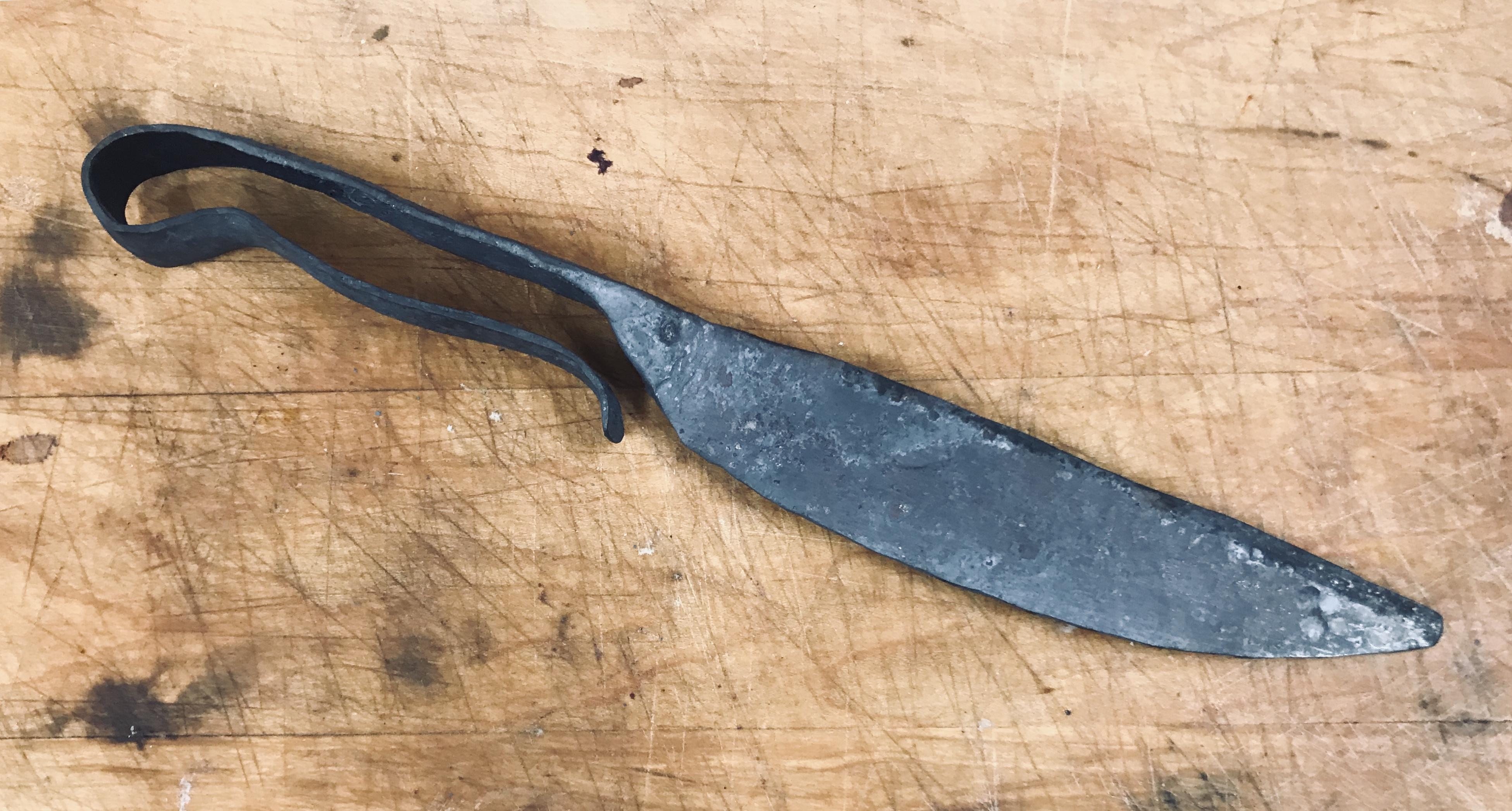

JHCC Posted July 19, 2019 Share Posted July 19, 2019 Out of the hot box and ready for grinding: Link to comment Share on other sites More sharing options...
pnut Posted July 19, 2019 Share Posted July 19, 2019 7 hours ago, BillyBones said: Finished a set of tongs i started about 2 months ago. Made a steak flipper and my first cross. Cross started as a piece of 1/2 round, squared, slit, and formed...mouse approved Blacksmith tested, mouse approved Link to comment Share on other sites More sharing options...

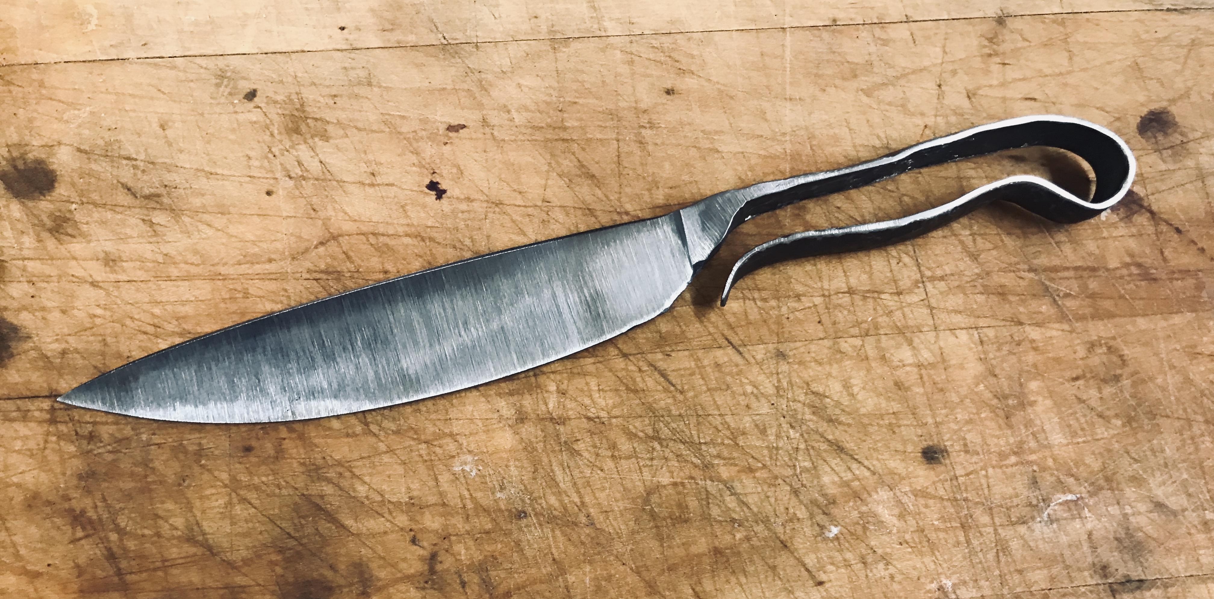

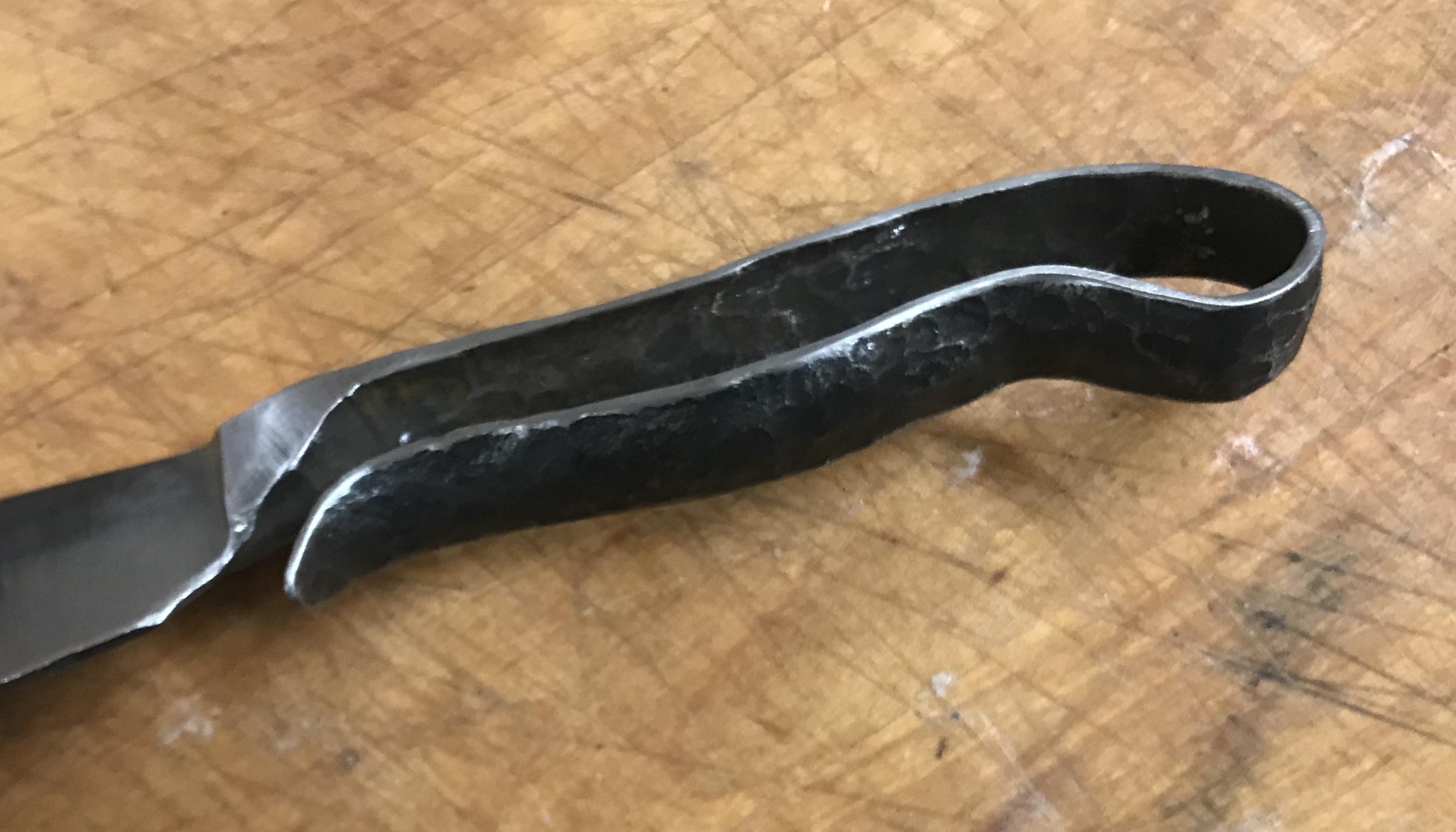

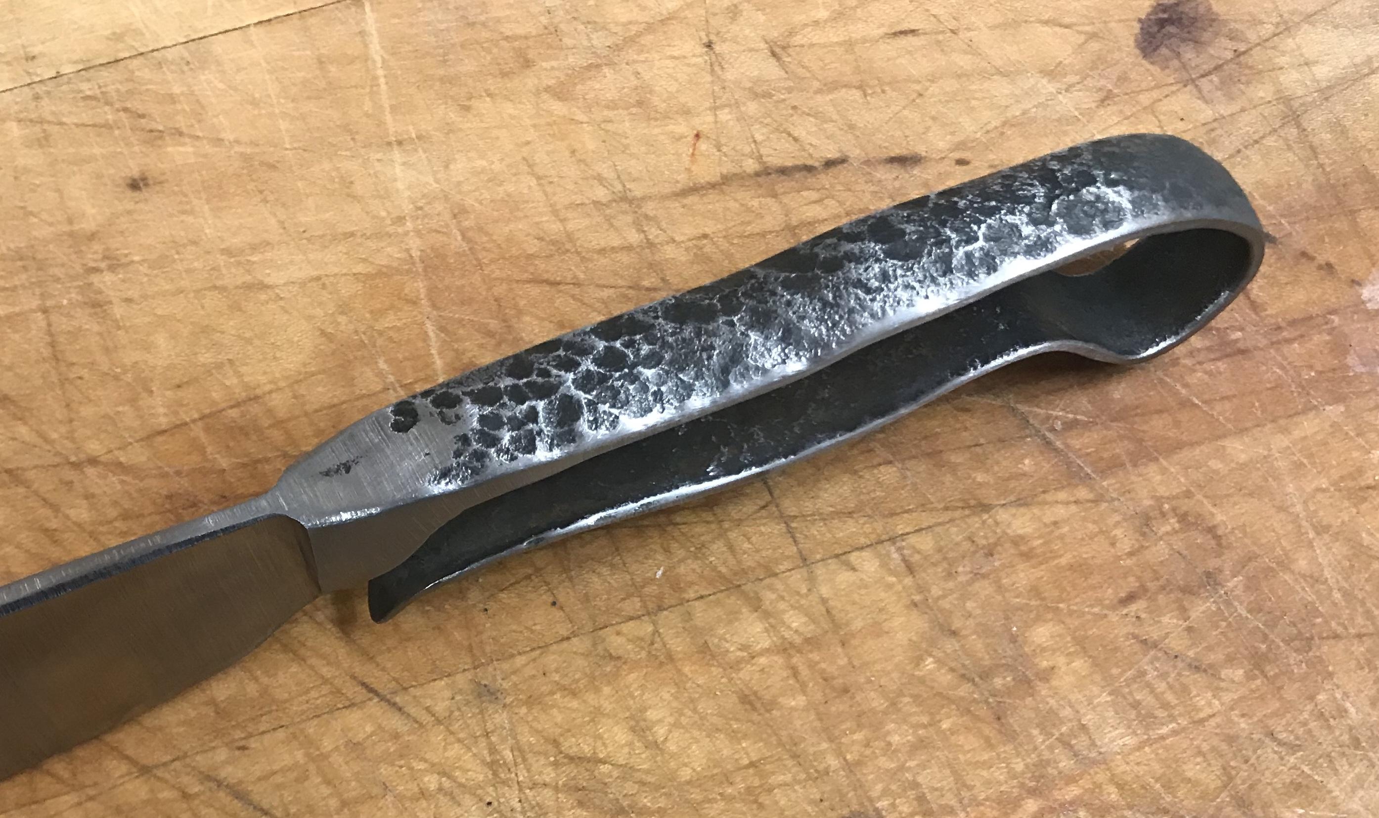

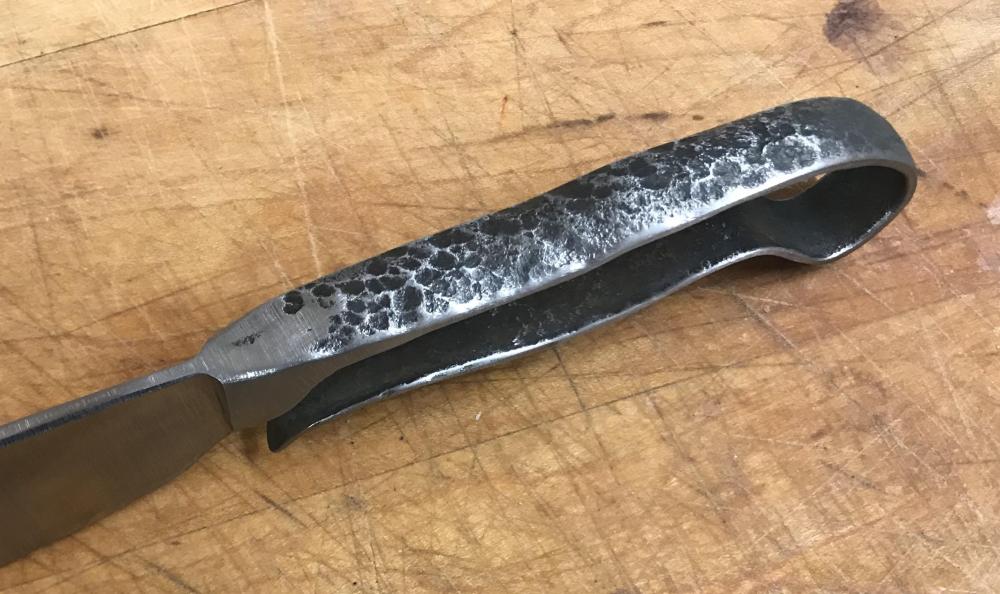

JHCC Posted July 20, 2019 Share Posted July 20, 2019 Did the rough grinding on the chef’s knife, in preparation for a meeting with the client tomorrow. Link to comment Share on other sites More sharing options...
CrazyGoatLady Posted July 20, 2019 Share Posted July 20, 2019 JHCC What steel is it made from? Sorry if you already said and I missed the information. I like it JHCC What steel is it made from? Sorry if you already said and I missed the information. I like it Link to comment Share on other sites More sharing options...
JHCC Posted July 20, 2019 Share Posted July 20, 2019 Coil spring, probably 5160-ish. Link to comment Share on other sites More sharing options...
CrazyGoatLady Posted July 20, 2019 Share Posted July 20, 2019 Thank you. How long did it take you to make it? I haven't tried knives except a knife shaped object out of a half horseshoe Link to comment Share on other sites More sharing options...
JHCC Posted July 20, 2019 Share Posted July 20, 2019 I’ve probably got about 4-5 hours into it so far, between forging and grinding. Still have to heat treat, finish grind, and sharpen. Link to comment Share on other sites More sharing options...
