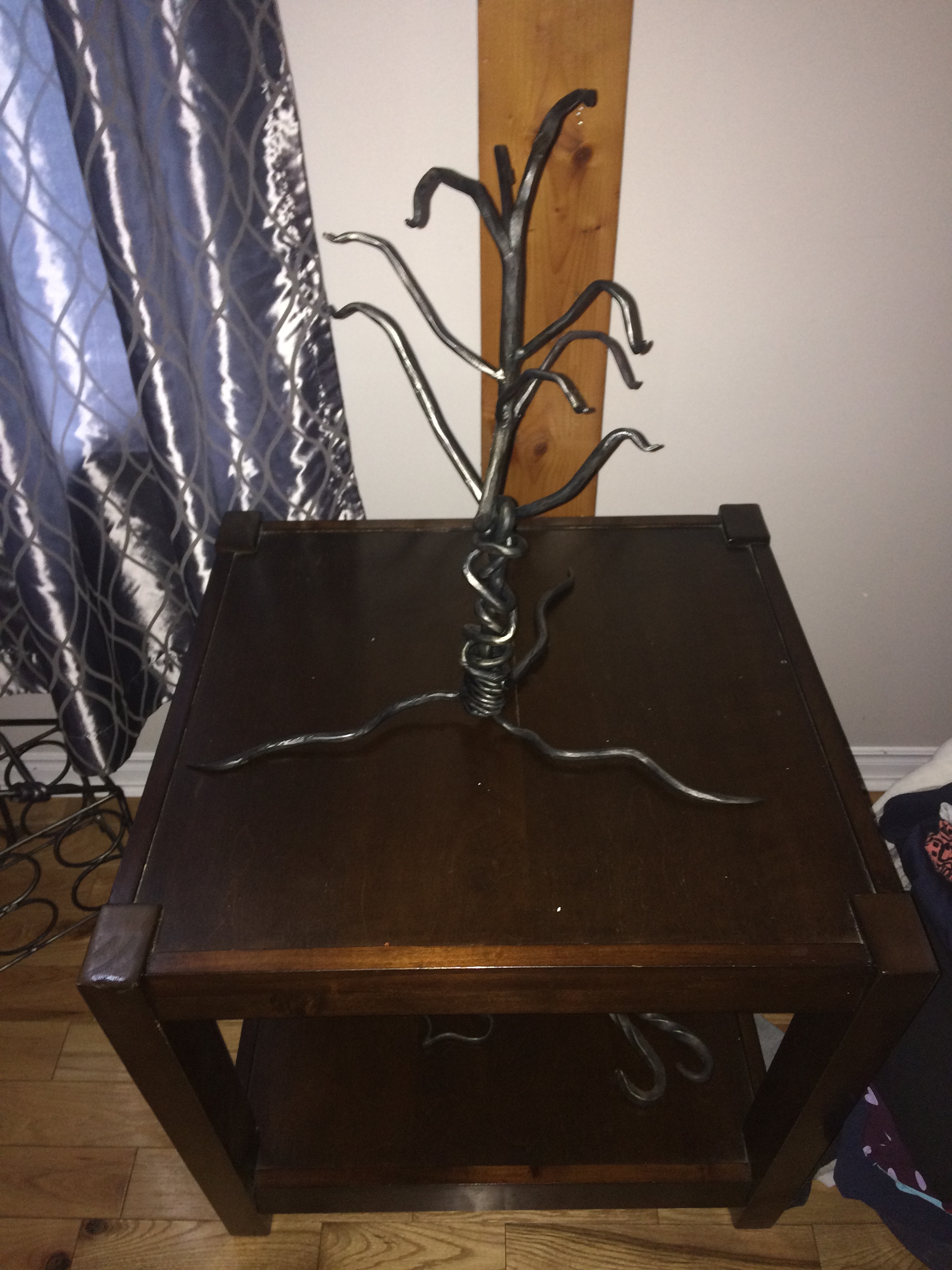

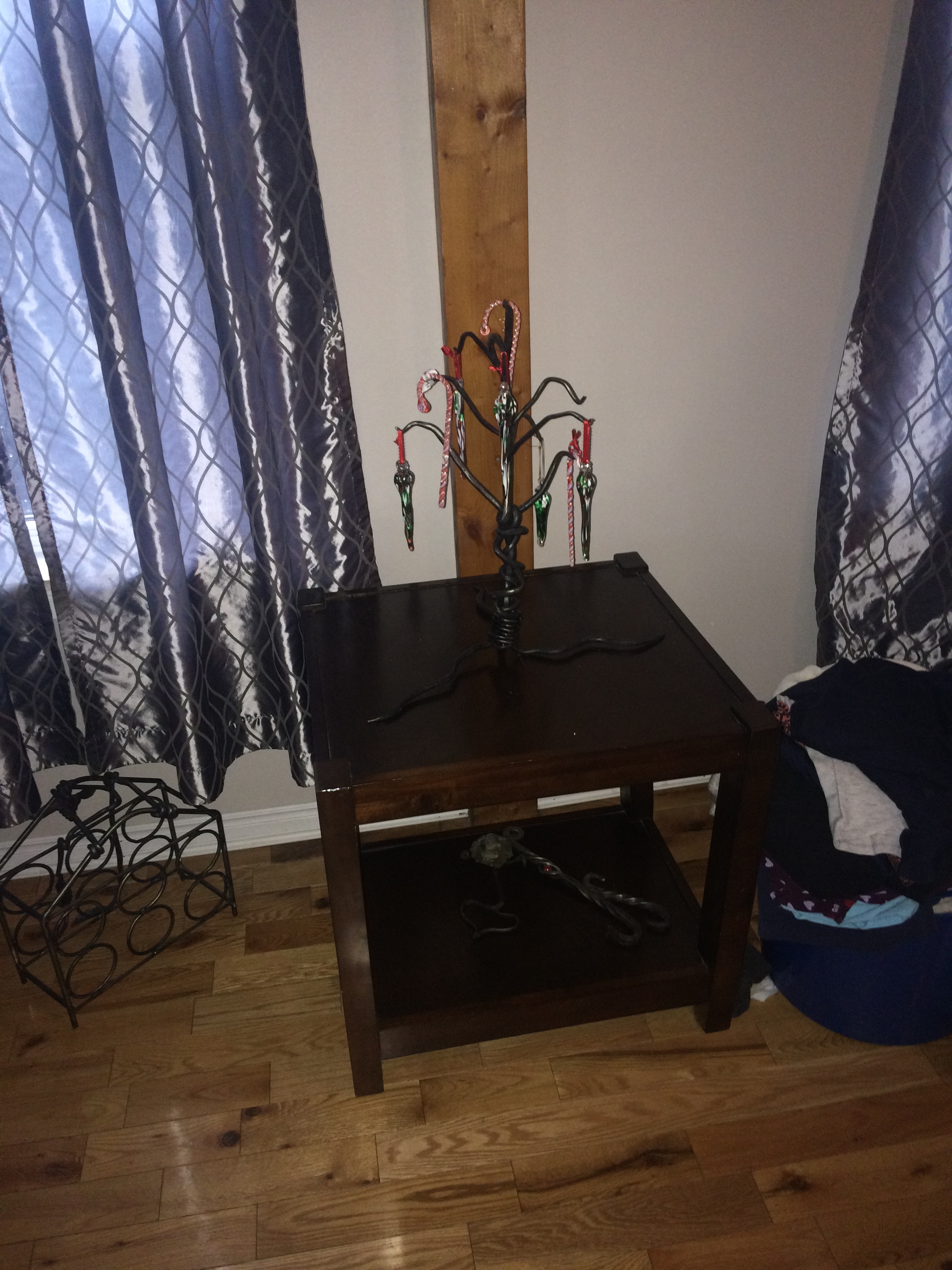

bubba682 Posted March 10, 2018 Share Posted March 10, 2018 Just another viking heres a display tree i made for crystal ,and jewlery ithey went over pretty good. Heres a couple of good sellers i made this winter got a bit of custom work comin in its allright... Quote Link to comment Share on other sites More sharing options...

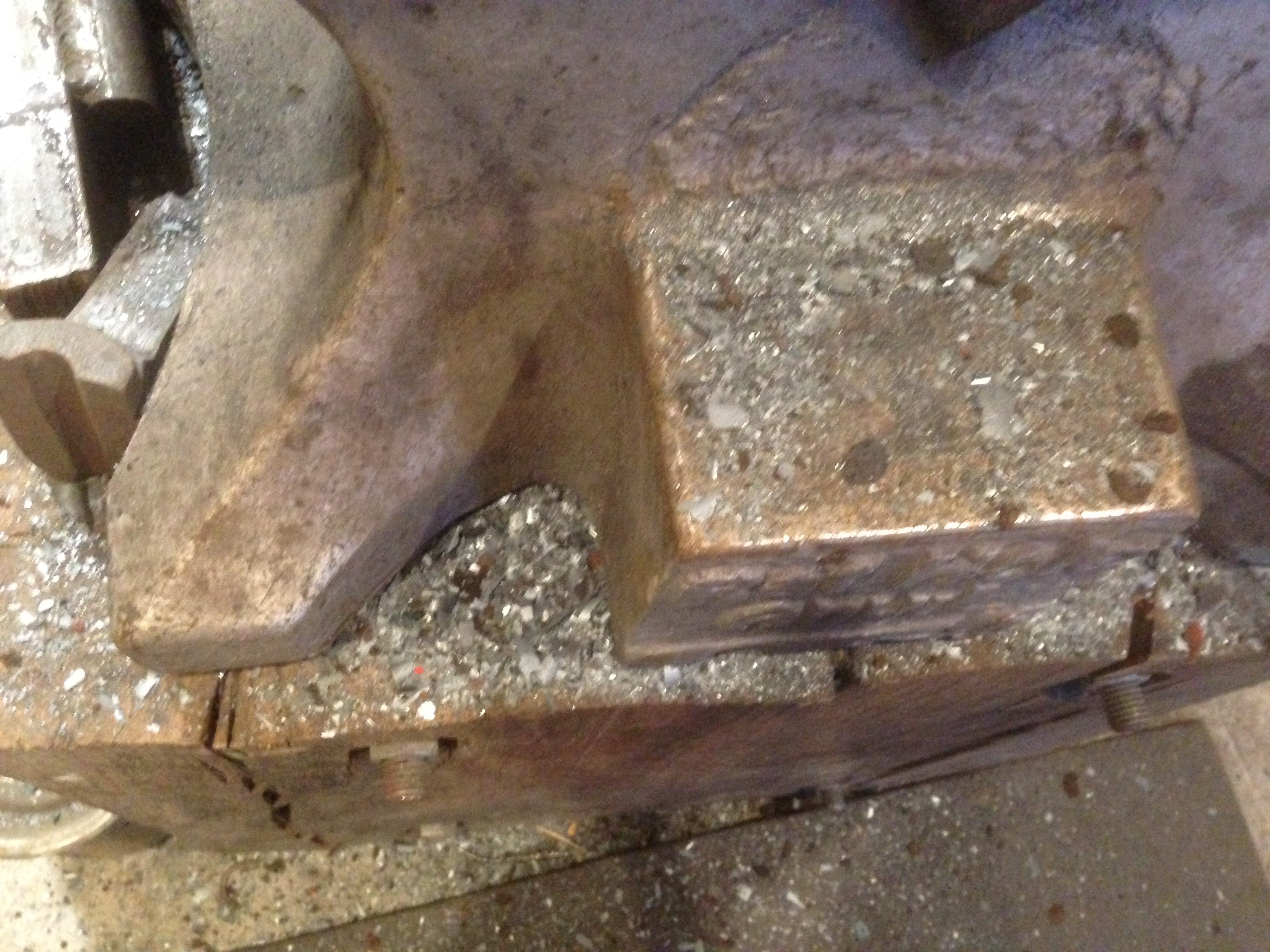

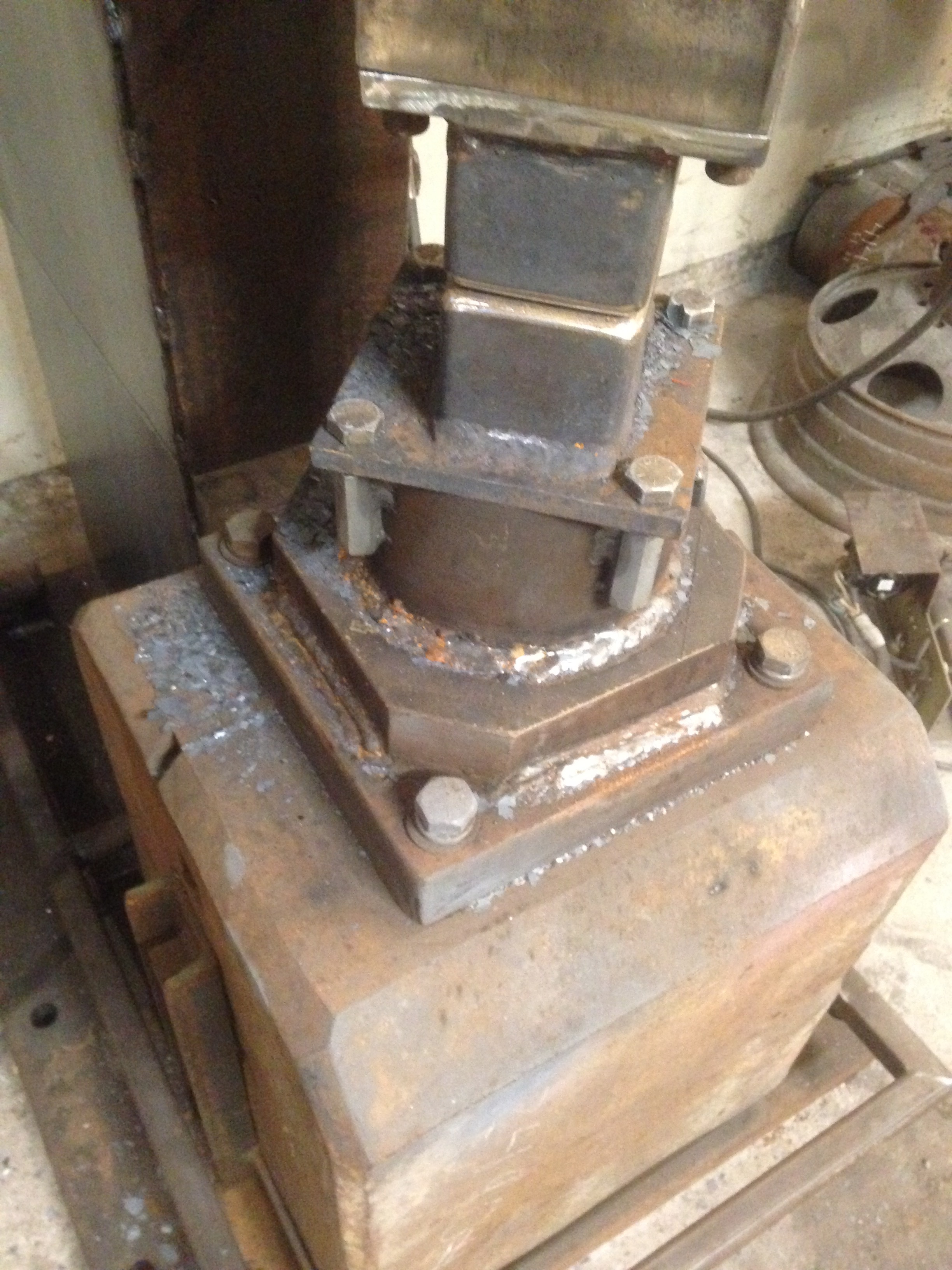

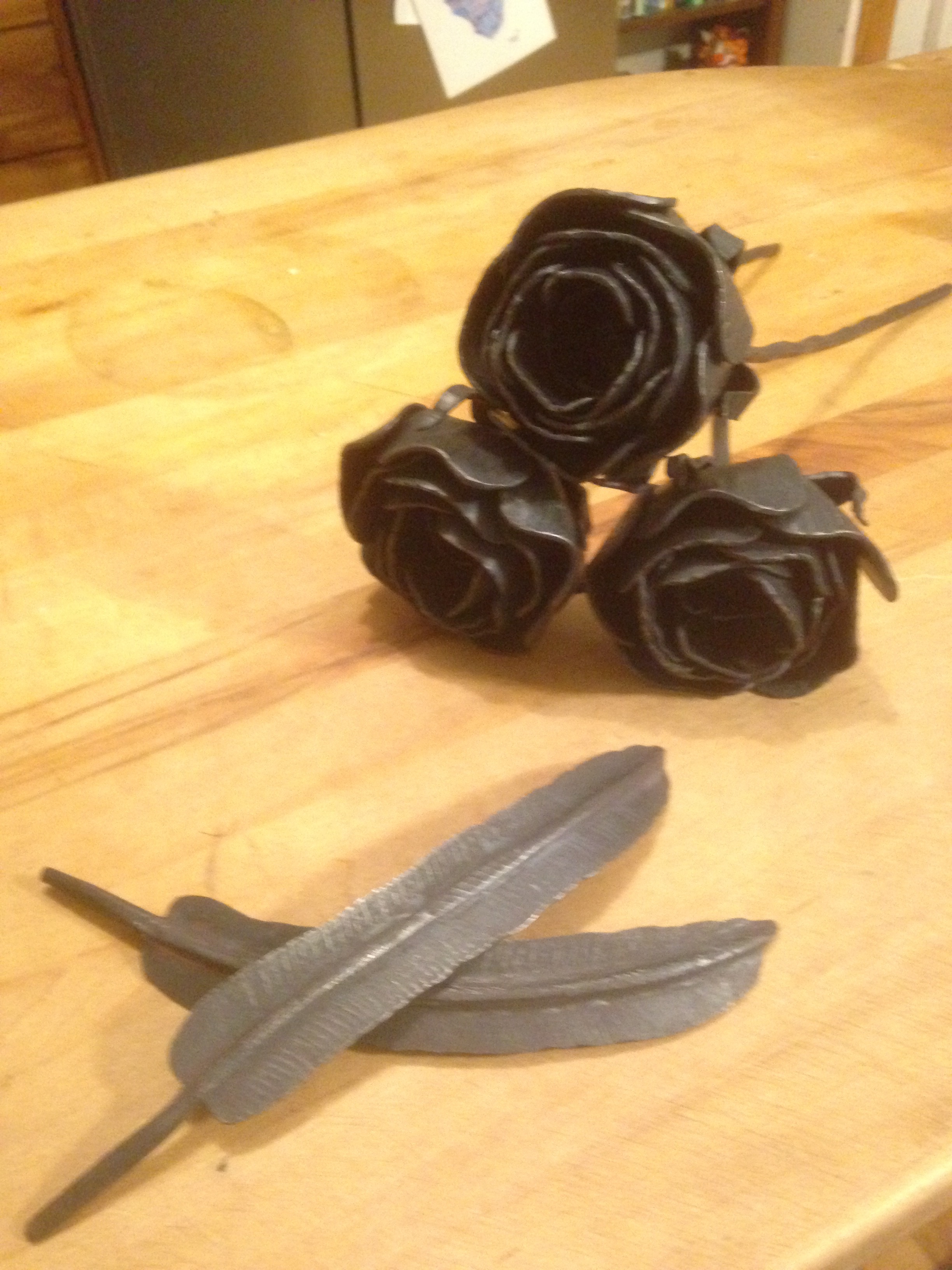

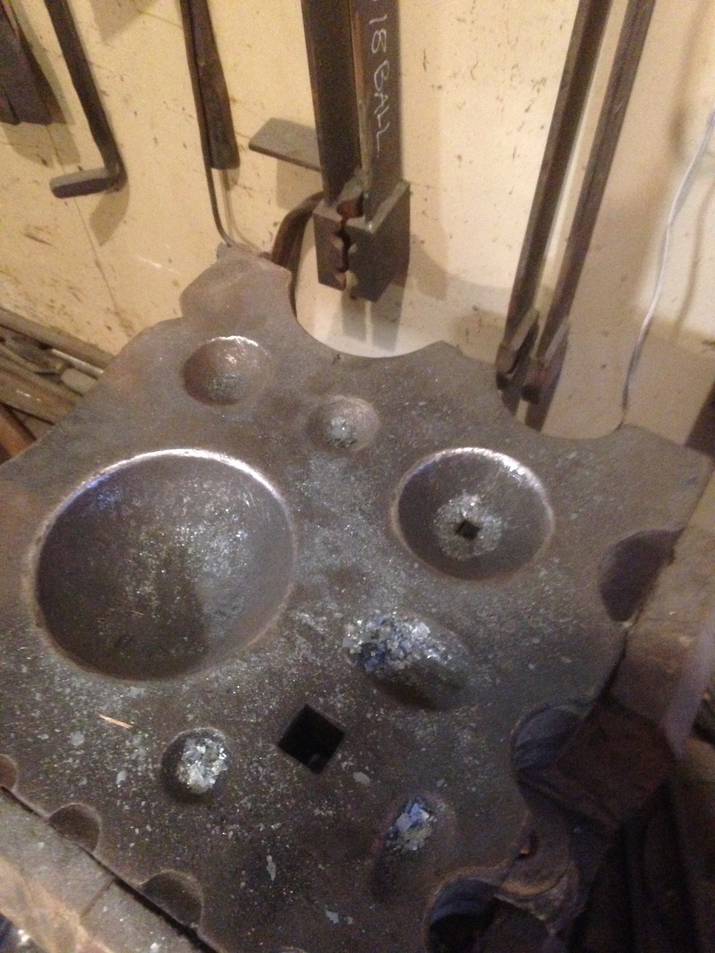

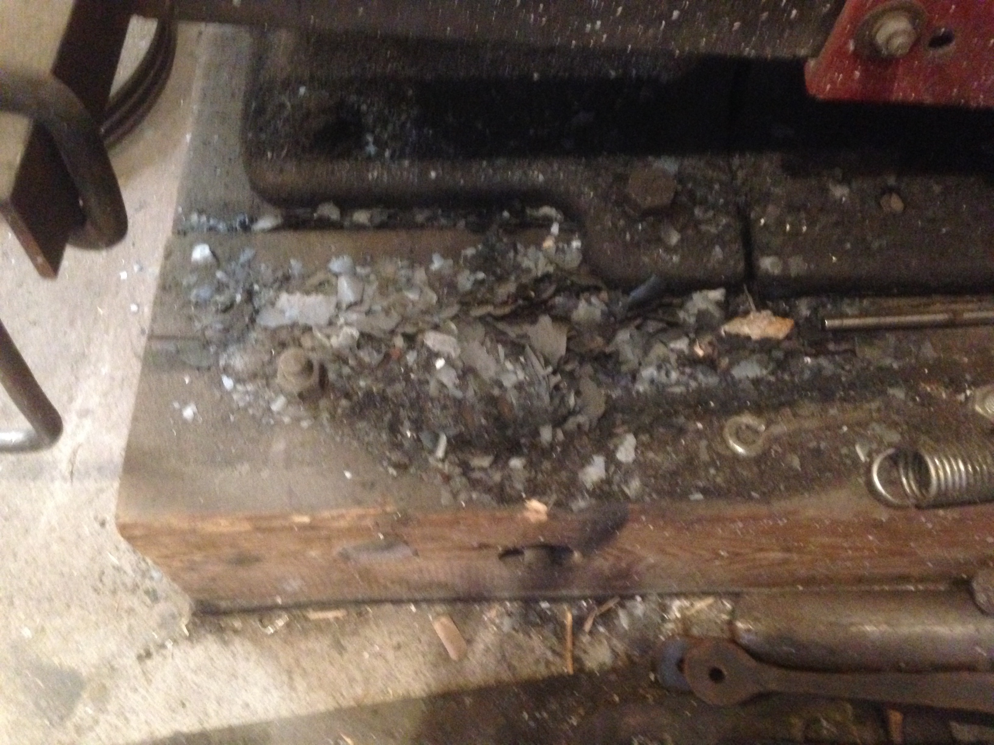

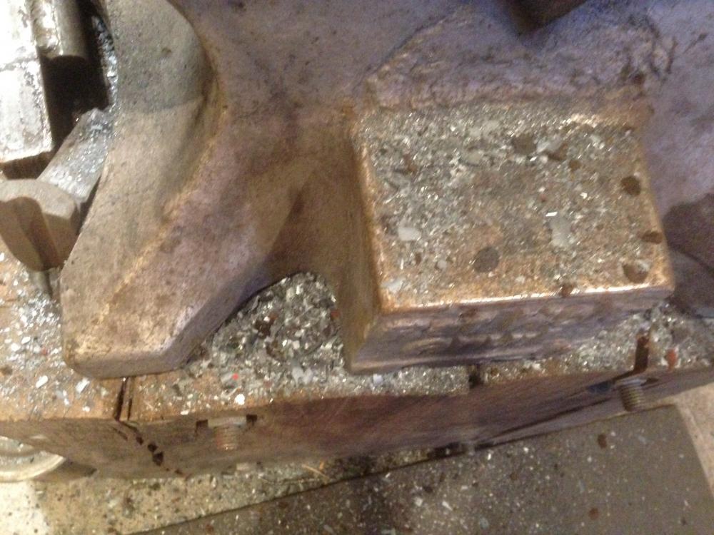

Judson Yaggy Posted March 11, 2018 Share Posted March 11, 2018 Today In the shop I made scale. Scale made at the anvil. Scale made at the swedge block. Scale made at the old power hammer. Scale made at the new power hammer. Sucker hits HARD, joy! While waiting for the bigger stuff to come up to heat I poked around the edges of the fire and made some roses and feathers for a local non-profit raffle. AND, to cap it all off, cleaned out the barn with the help of the world's best dog. Quote Link to comment Share on other sites More sharing options...

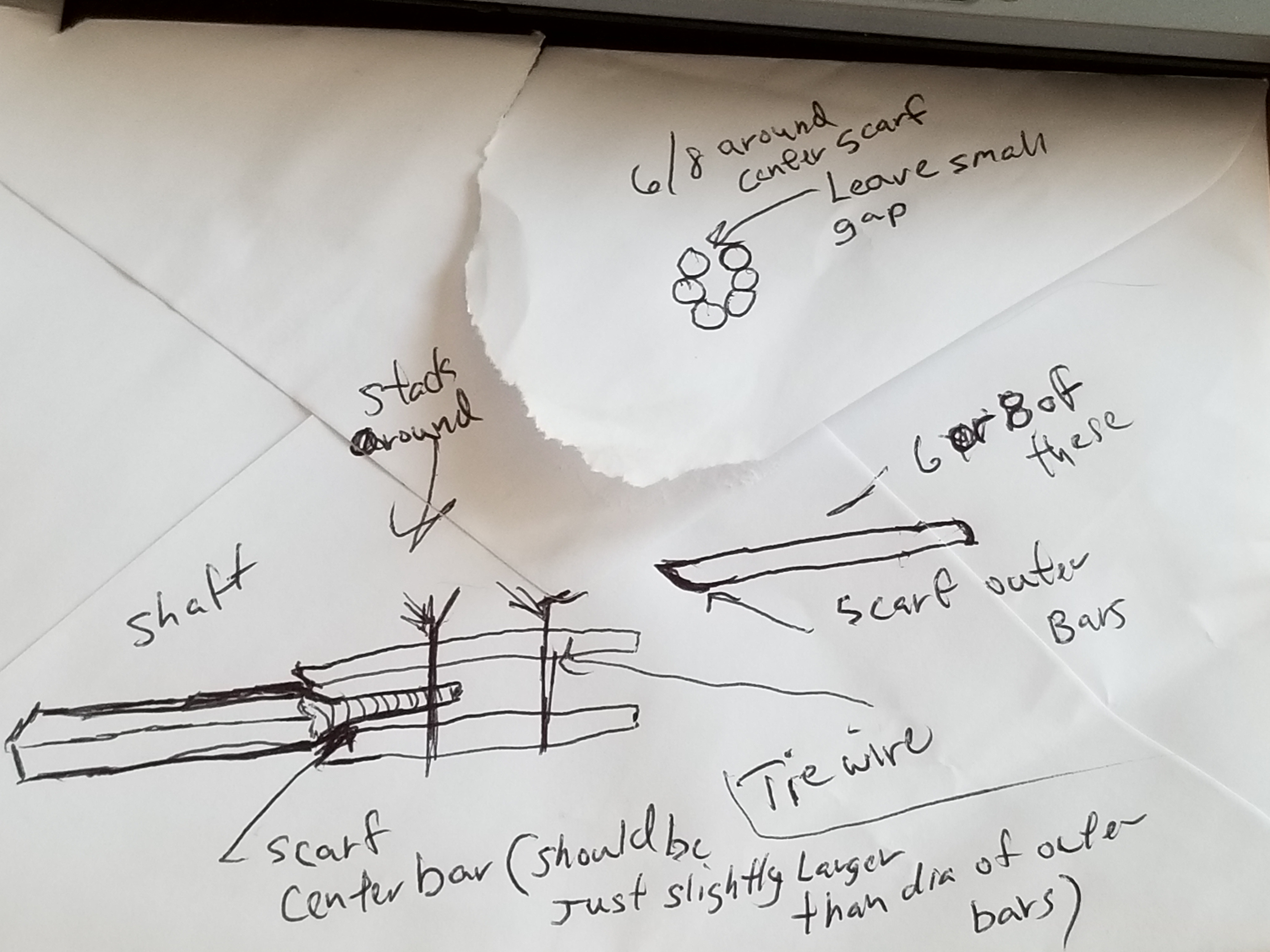

jlpservicesinc Posted March 11, 2018 Share Posted March 11, 2018 13 hours ago, ausfire said: I, too, have a few of those sitting on the bench waiting for use as handles, but the thought of scarf welds is a bit daunting. I have some (limited) success with fire welding folded fire pokers where the two pieces are already together, but I've never been able to weld two separate pieces. Not enough hands, and one piece always loses heat too fast. Good luck with your practising and I hope you have better outcomes than I did. Just a hint.. Don't open the cage before it's welded onto a shaft.. If you can weld the 4 bars together then you can take a center bar and scarf the end with a round scarf vs flat.. Then with 6 or 8 round bars vs the 4, the diameter of the bars should be just slightly smaller than the inside diameter of the shaft round scarf. (There must be a small gap). Then wire the bars after scarfing one end with a flat rounded face scarf, Put these with the scarf around the scarf of the shaft, flux and weld.. This way everthing is held in place and since the scarf is all ready in the center of the bars it will hold everything together as you come up to welding temperature.. if you are good, you can actually twist the shaft as the bundle comes up to welding temperature and you will feel it weld or tack.. At this point remove it and set the tack, clean and reflux, put in for a full welding heat.. There are 100's of different scarfs used depending on what the shape of the materials are.. Not just the 2 commonly used now.. One being the stepped scarf as popularized by Mark Aspery's videos' as well as others and then the old faithful flat rounded scarf.. There are Y scarf, T scarfs, flats, fillets, V etc, etc, etc.. The main problem with any light gauge weld is the ability to get everything lined up and at the same welding temperature and still be able to move it to the anvil.. The method shared above will take all those problems away.. Easy Peasy.. Quote Link to comment Share on other sites More sharing options...

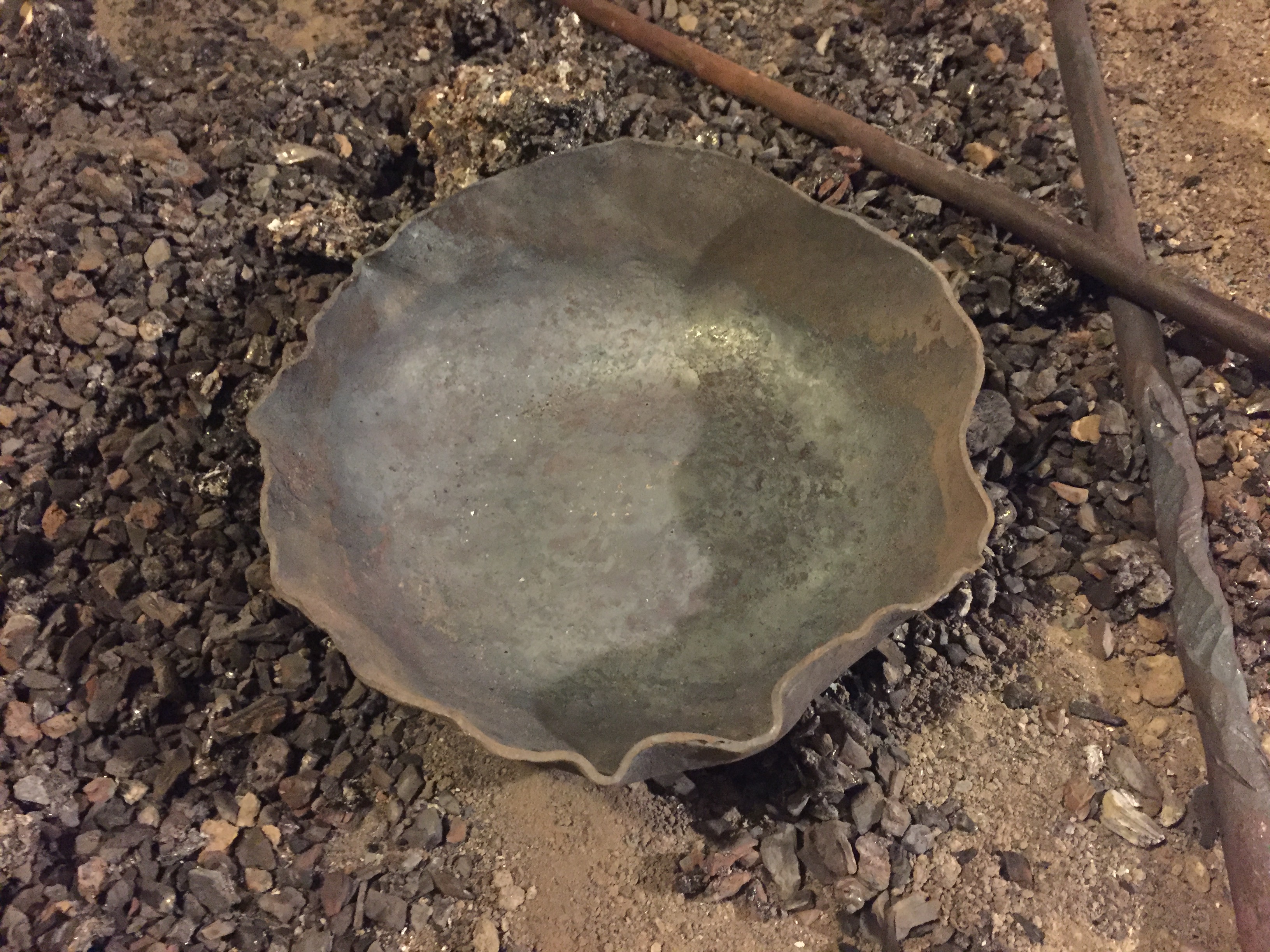

JHCC Posted March 11, 2018 Share Posted March 11, 2018 Not much time in the forge today, but got in some more work on the forged bowl I’m making for Lisa. Quote Link to comment Share on other sites More sharing options...

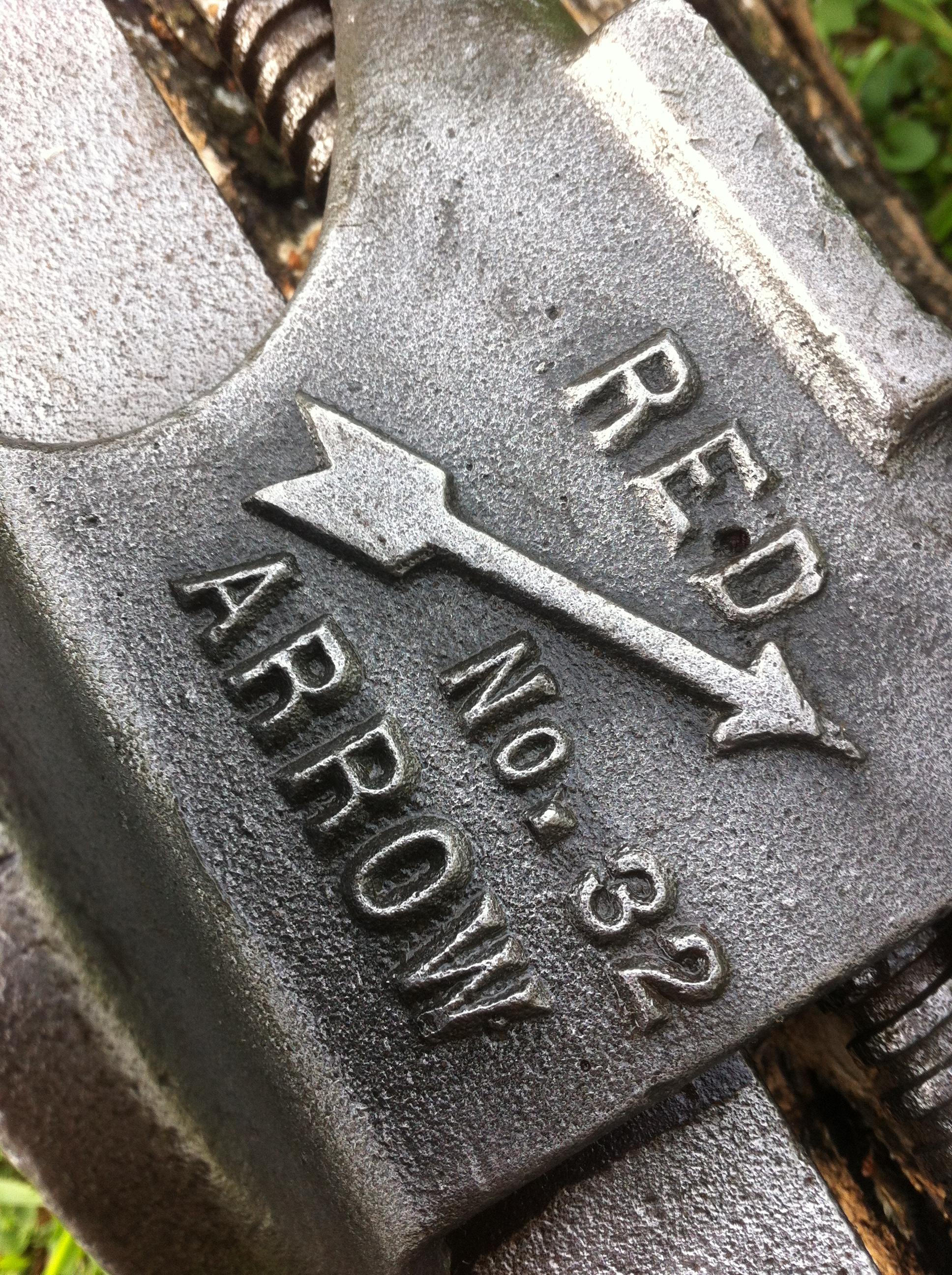

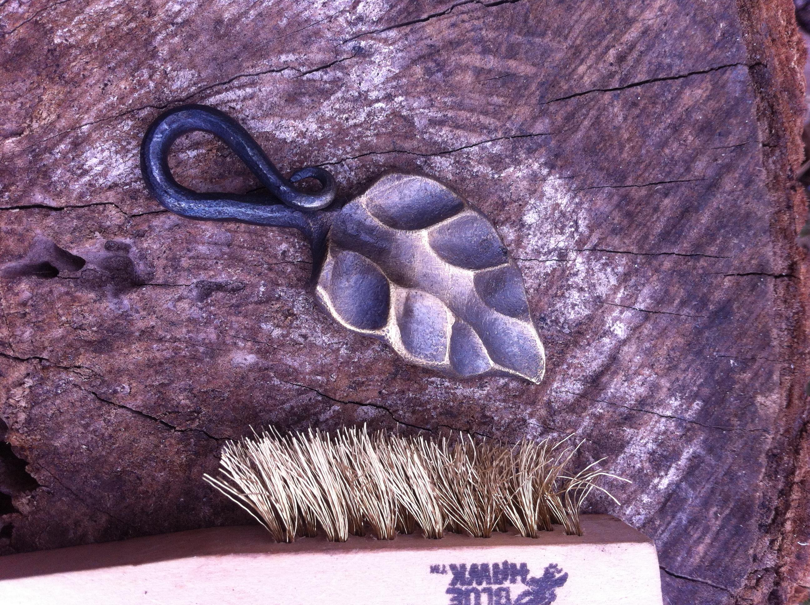

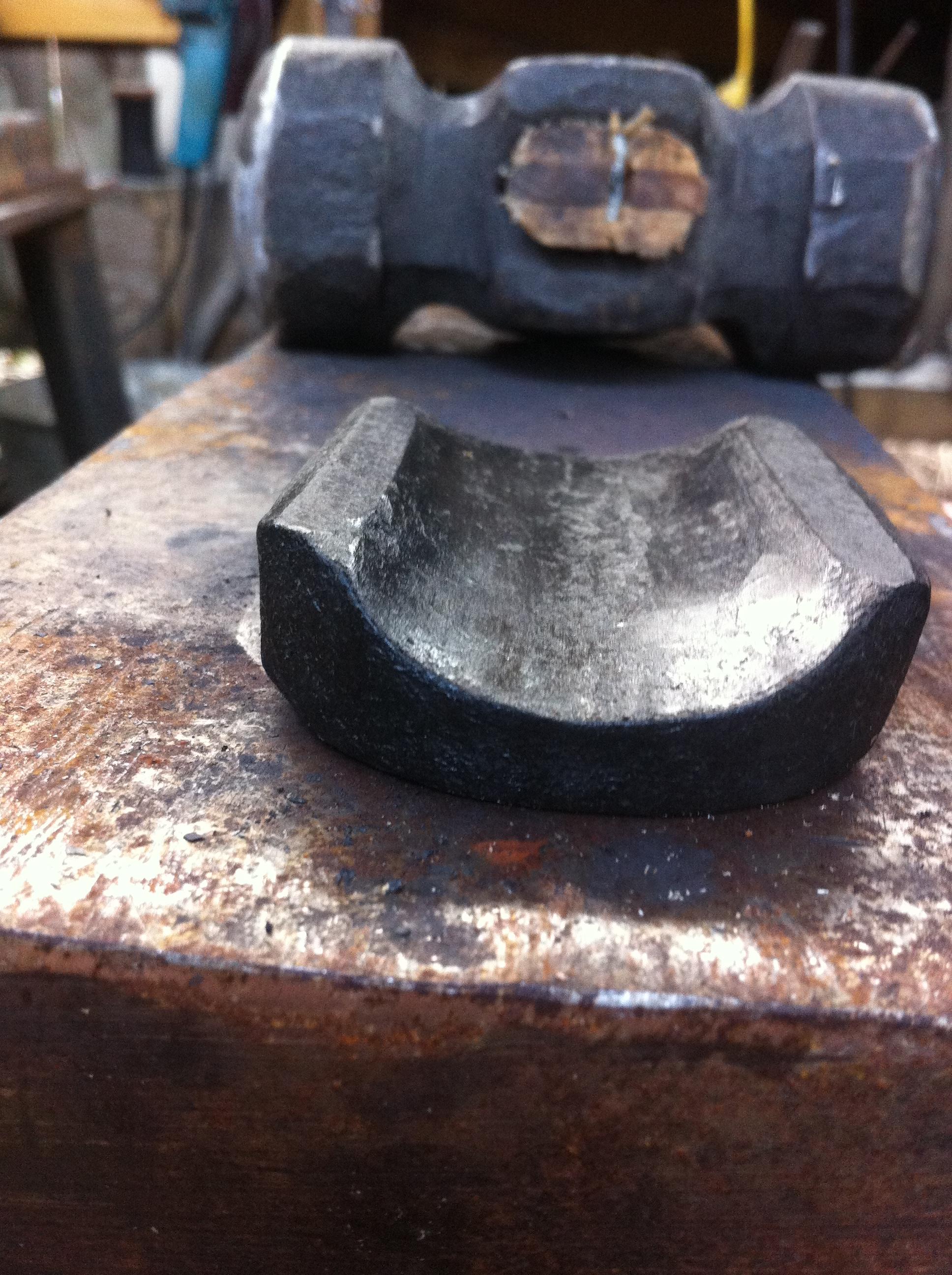

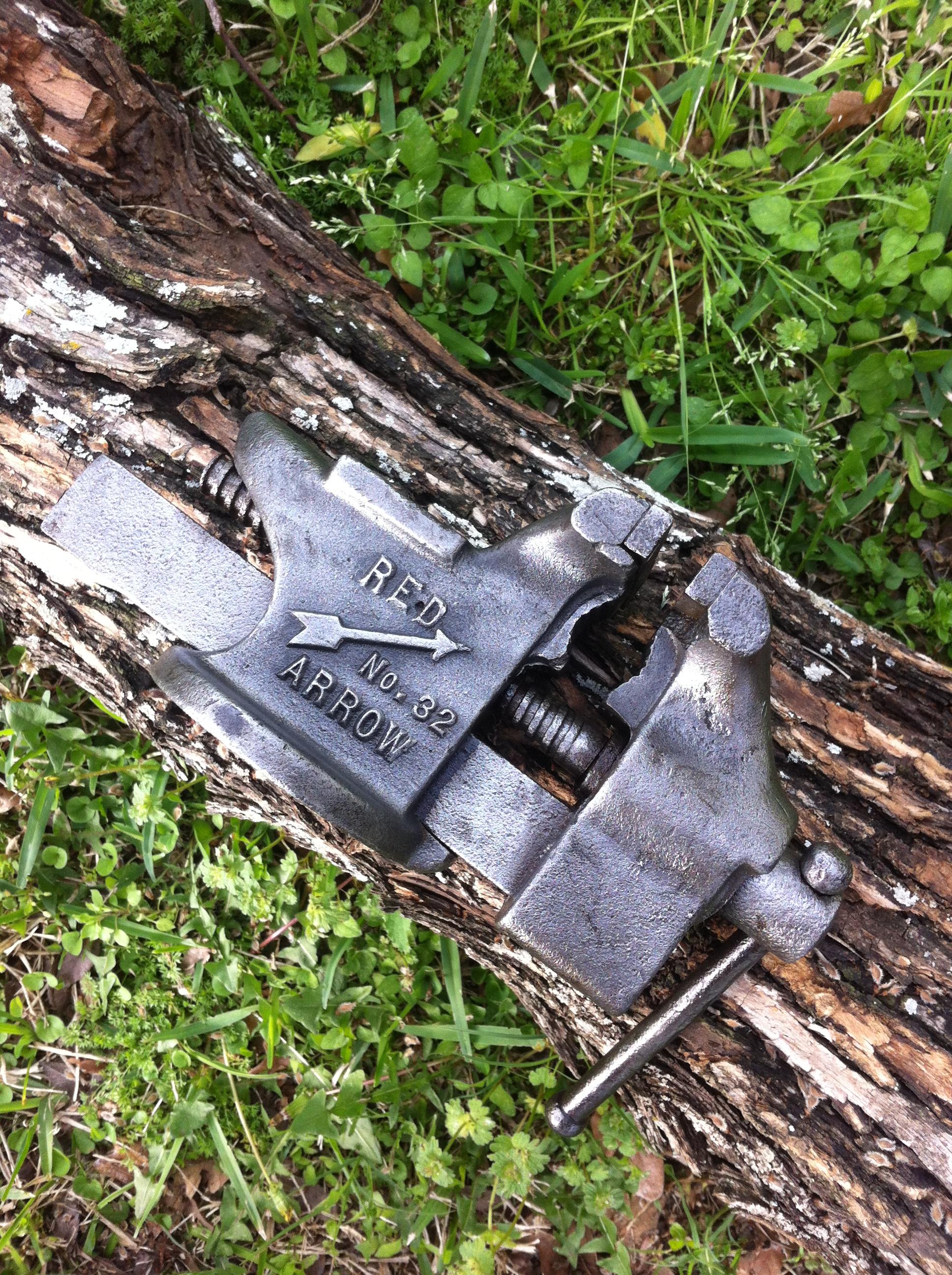

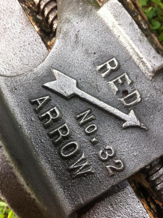

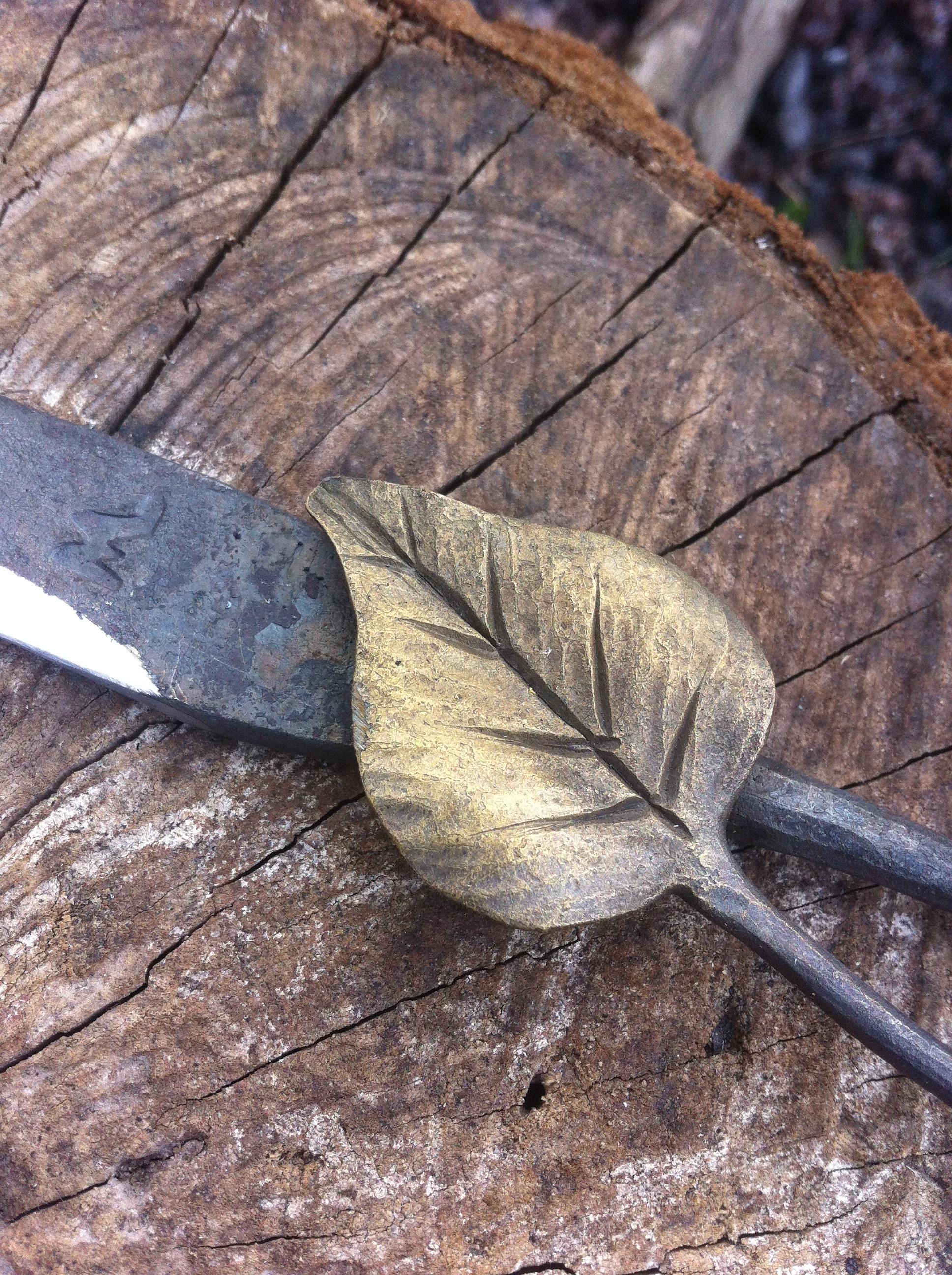

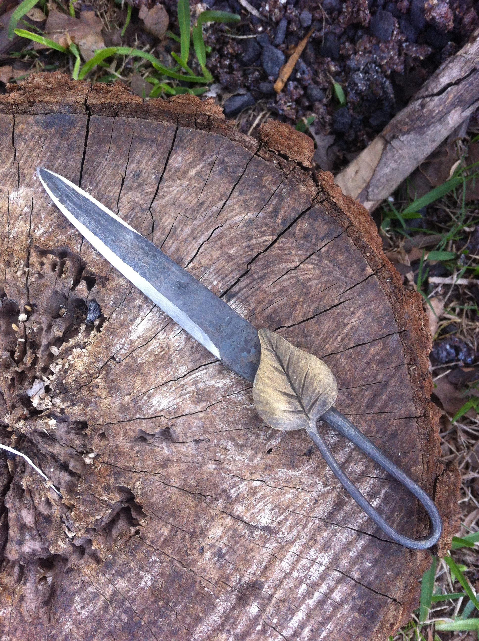

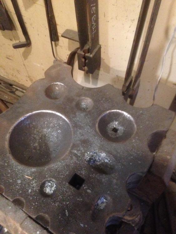

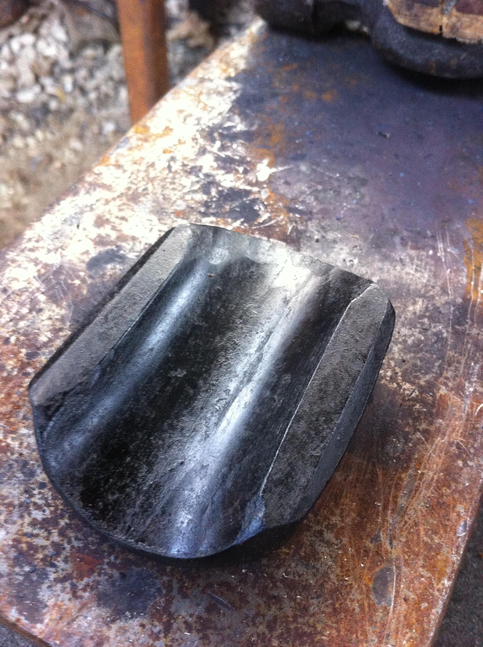

Mark Ling Posted March 11, 2018 Author Share Posted March 11, 2018 with the time I had I tried out my new brass brush on a key chain and letter opener, I like it. Then about a week ago I did a 1-3/4" bottom swage. And also I cleaned up a vice I got at the scrap yard a while back. Littleblacksmith Quote Link to comment Share on other sites More sharing options...
ausfire Posted March 11, 2018 Share Posted March 11, 2018 11 hours ago, jlpservicesinc said: Just a hint.. Don't open the cage before it's welded onto a shaft.. The method shared above will take all those problems away.. Easy Peasy.. Wow! Easy Peasy? I really think I would have to see that done. Way beyond my current skill level, but thank you for the advice. Quote Link to comment Share on other sites More sharing options...

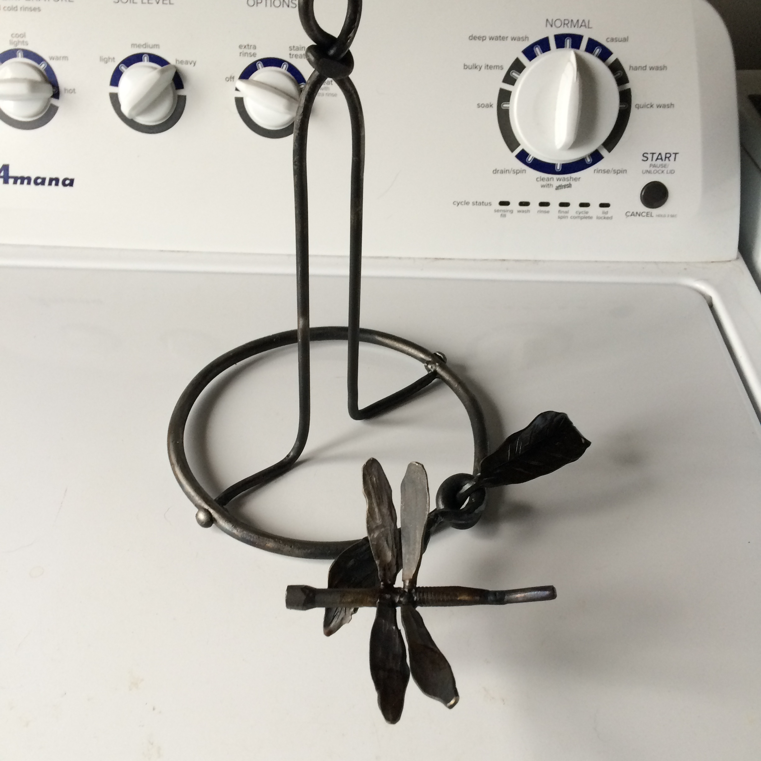

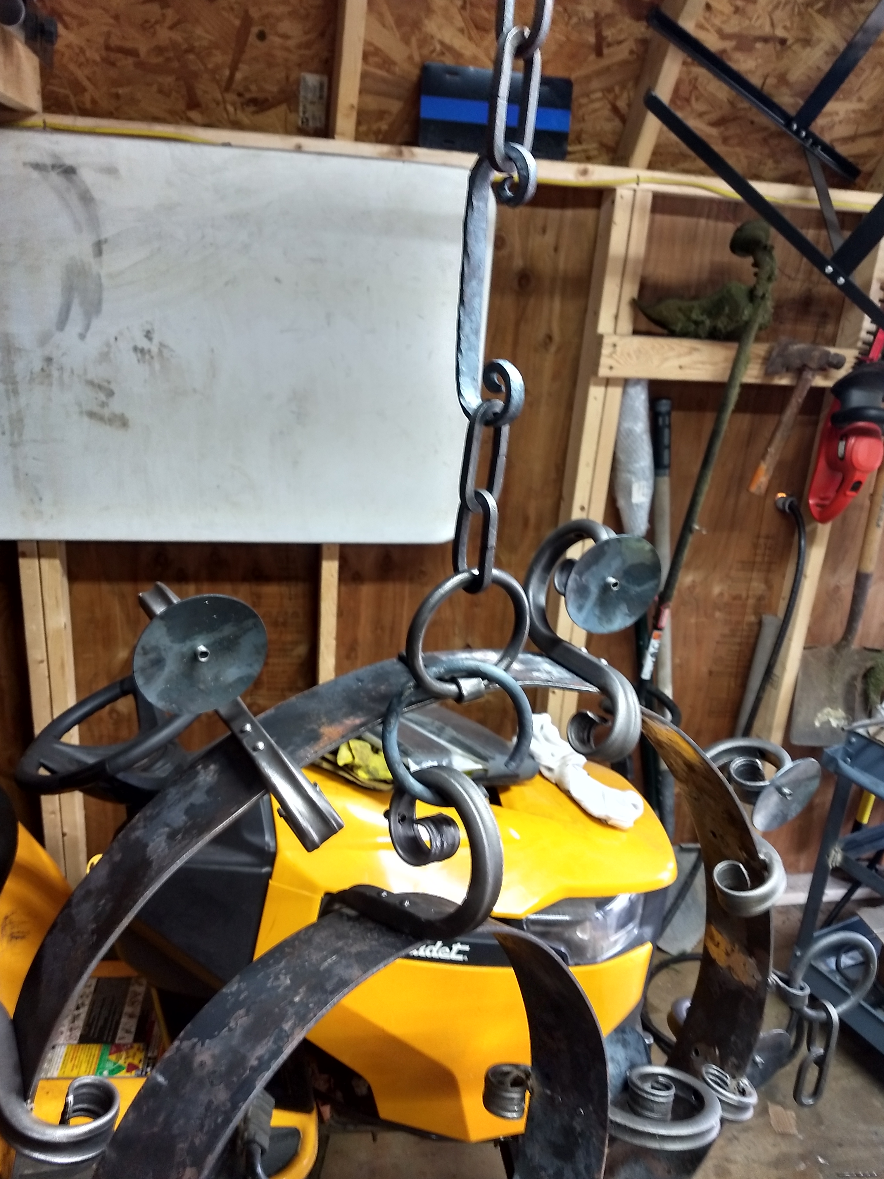

DaveGas Posted March 11, 2018 Share Posted March 11, 2018 Did a lot of staring and beer drinking the other day as I began a hang test for my first chandelier project. Far from scientific, but if one scrolled hook can hold the entire weight of the project then four definitely can, right? Sounds reasonable. I plan on going hook to hook until I've done all of them and I'm satisfied. If anyone has experience with this subject I would appreciate input (I've never made an overhead piece before). So far it's weighing in at 76 pounds with chain and all. All load bearing pieces were riveted with two 1/4" and also welded on the upper ends to ensure they will hold (don't like the idea of this thing falling on my head so I'm not taking chances). When I mocked it up the entire chandelier is 69" tall. Turns out it's going to hang too low for where I wanted to put it. Plus side is that I have a split entry house with a cathedral ceiling in the living room. The 30" ring will be come the living room chandelier and the 20" ring will become the entry chandelier. It was originally supposed to be a 12 light, two tiered chandelier. Looking like I'll have one 8 light chandelier and one 4 light. Oh well, now I know and knowing is half the battle. I was thinking of 1/2" tubing running along the inside from light arm to light arm. Probably with a 1 inch gap between runs to splice and the wiring and hide the wire nuts inside of the light arms. Quote Link to comment Share on other sites More sharing options...
jlpservicesinc Posted March 11, 2018 Share Posted March 11, 2018 1 hour ago, ausfire said: Wow! Easy Peasy? I really think I would have to see that done. Way beyond my current skill level, but thank you for the advice. it sounds way more complex than it is.. It's one of those a picture is worth a thousand words.. If you can weld the 4 bars together and get the nice baskets you are.. This is nearly as easy.. just takes a few more minutes in scarf prep time.. I get asked all the time what is the most difficult thing to make... There is nothing more difficult or less difficult than the other.. It just takes longer.. The skill set is the skill set.. It just depends on how one applies it.. Quote Link to comment Share on other sites More sharing options...
JustAnotherViking Posted March 11, 2018 Share Posted March 11, 2018 Thanks for taking the time to do the illustration jlpservicesinc, that really clears it up! I shall definitely be trying it out next weekend. The baskets I did for practice were much simpler... two pieces of round, bend them in half so you have two U's and slot the two 'open' ends together... much less welding, and no messing about trying to hold or tie the bits together. Not as nice as 6 or 8 piece baskets, but a very quick and easy way to practice without investing too much time on failed attempts and burnt steel. The following pic is an in progress shot of the tree I am working on... I will either do some file work to cut some notches into the branches, or some bending with the oxy-propane torch to add hooks for the key rings to sit in... have just hung them on for illustration now Before I get that far, i'll need to make some roots, and i'm thinking of either wrapping the roots around a small rock, or for a twist, I might try making a rock-like shape out of wood, and curl the roots around that. Quote Link to comment Share on other sites More sharing options...
ThomasPowers Posted March 11, 2018 Share Posted March 11, 2018 All y'all are saving your scale to do a bloomery run and make it back into iron, right? It's magnetite a high grade iron ore much like the iron sand used by the japanese for smelting. Quote Link to comment Share on other sites More sharing options...

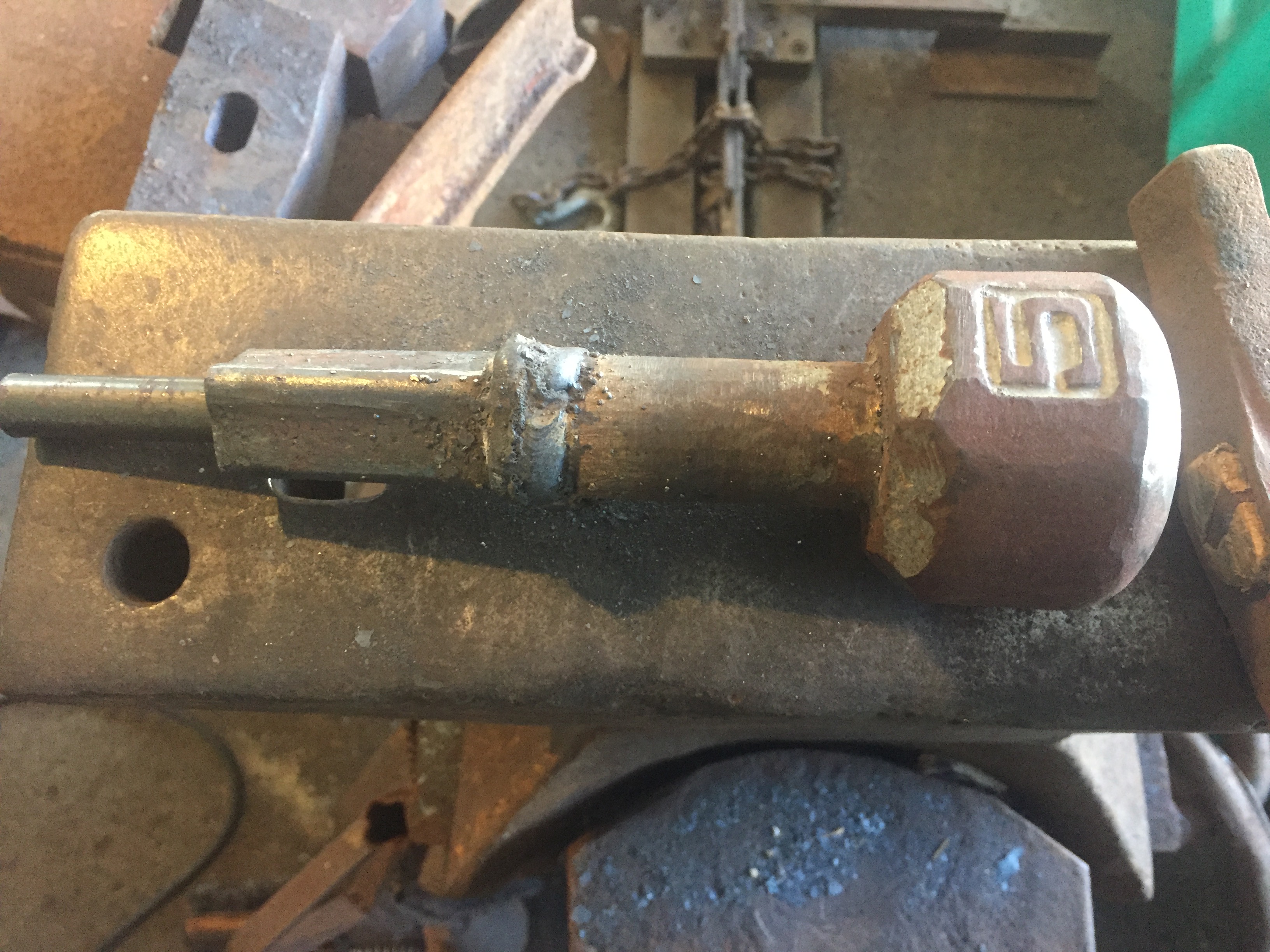

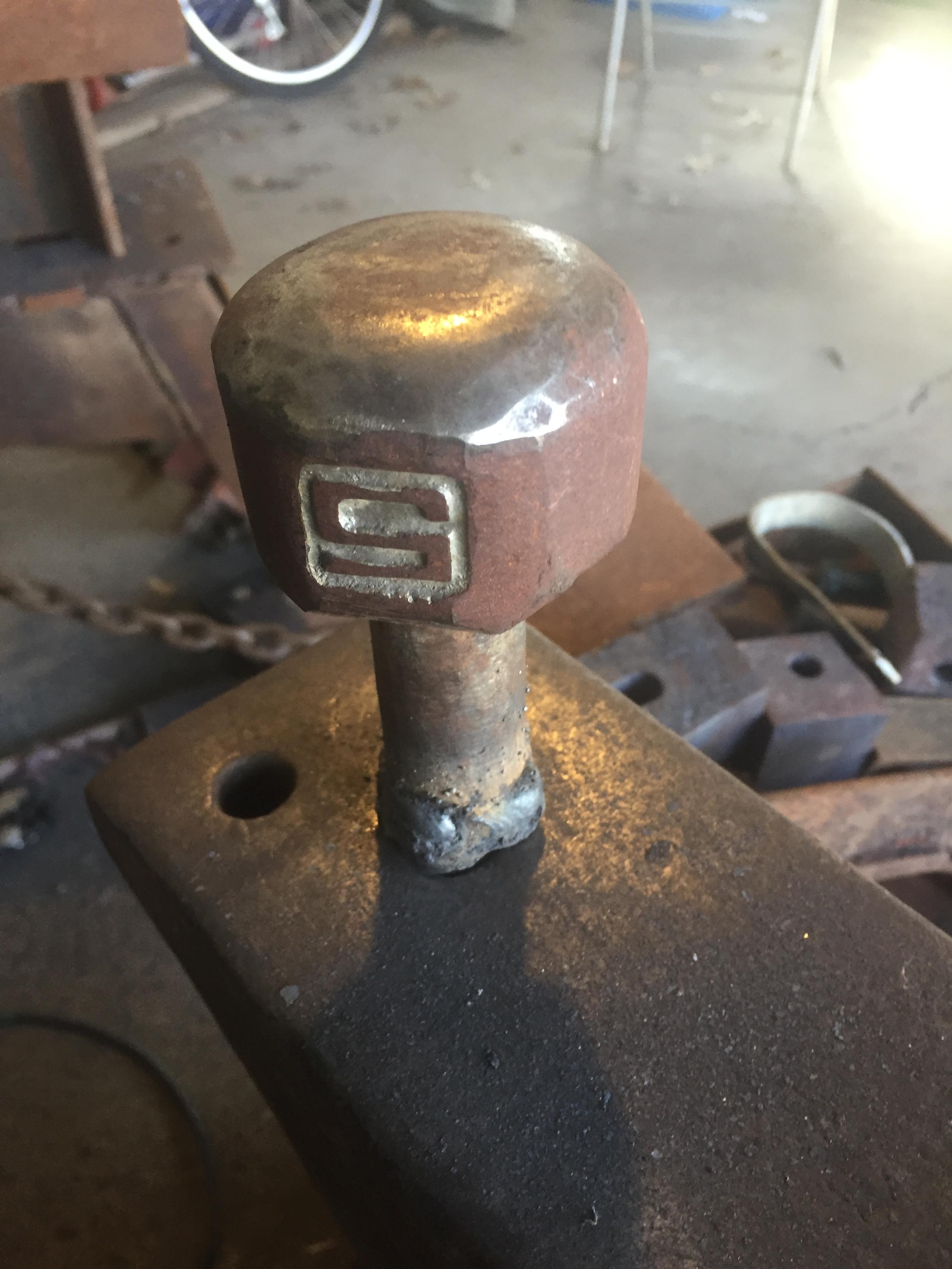

JHCC Posted March 11, 2018 Share Posted March 11, 2018 I’ve been using this rounded-off 5# dumbbell in the vise as a ball stake, but decidedly to weld on a hardy stem for use at the anvil. The ball is cast and the stem is some kind of mystery ferrous, so I hope the welds hold up. Quote Link to comment Share on other sites More sharing options...
Glenn Posted March 11, 2018 Share Posted March 11, 2018 We have a whole size range (different weights) of those in the shop. They come in handy for lots of projects. The round weights for bar bells are good as bending dies. Thin tin does not need much to be able to form against. Hot metal can be formed easily against an object. Working cold metal ... well, they have a saying about doing that. (grin) Quote Link to comment Share on other sites More sharing options...

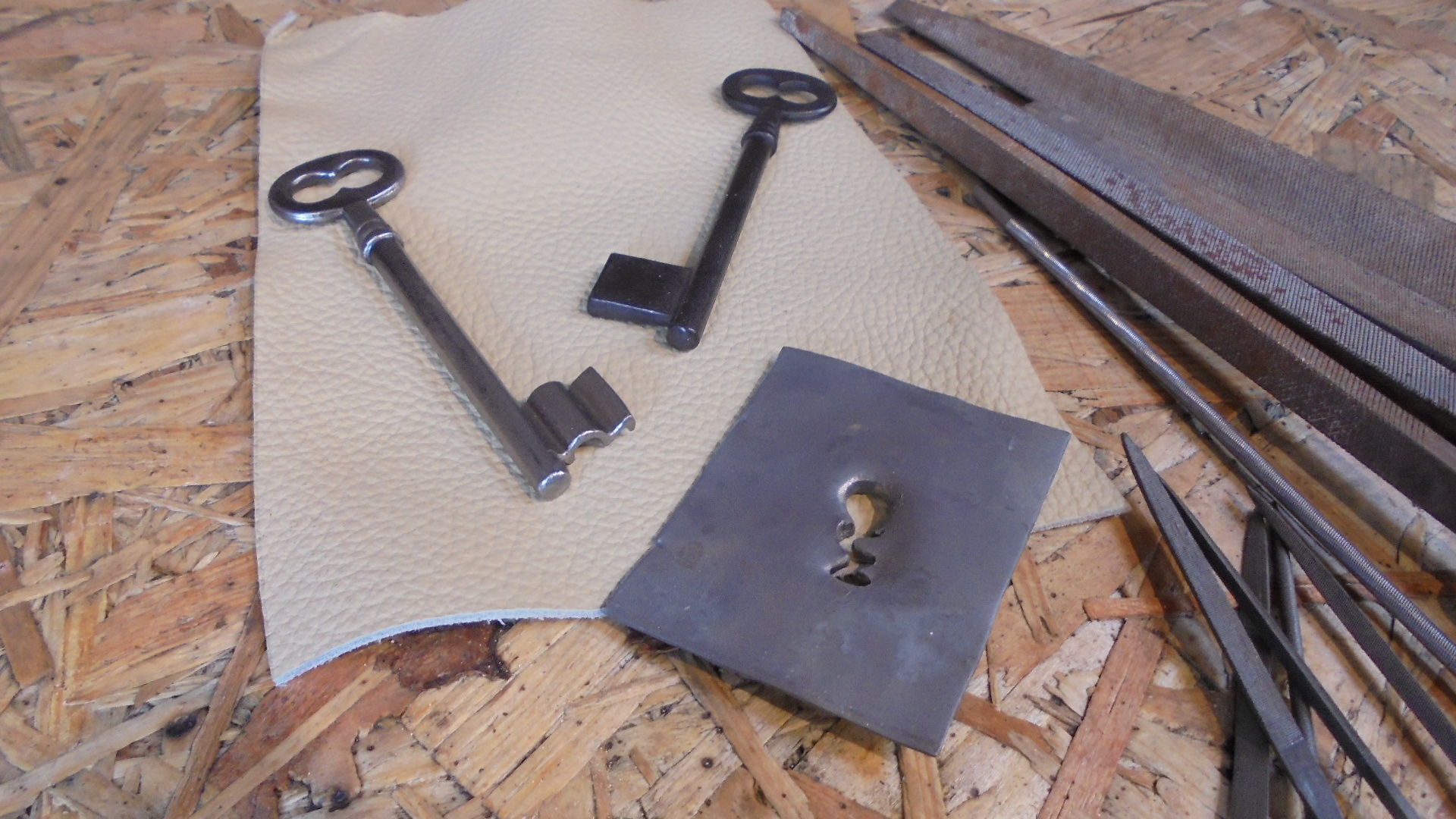

Hans Richter Posted March 11, 2018 Share Posted March 11, 2018 Have this key worked out for a friend of mine, he owns a house in Germany that is listed as a monument. Part of this agreement is that he can not simply replace hang and latches against modern locks. So the question was to make extra key(s). So before I started I made a print of the original key in lead as a template for the copy. I hope it fits when he visits his vacation destination next time. So as you see the blacksmith becomes also a lock smith in some case. I did have to clad up the beard by MAG welding because it was too thin for the original beard. Quote Link to comment Share on other sites More sharing options...
Marc1 Posted March 11, 2018 Share Posted March 11, 2018 Interesting Hans ... I have a similar key for the screen door at the front of my holiday house. Has a few extra slots across but basically the same. We can still buy blanks like that here. Quote Link to comment Share on other sites More sharing options...
