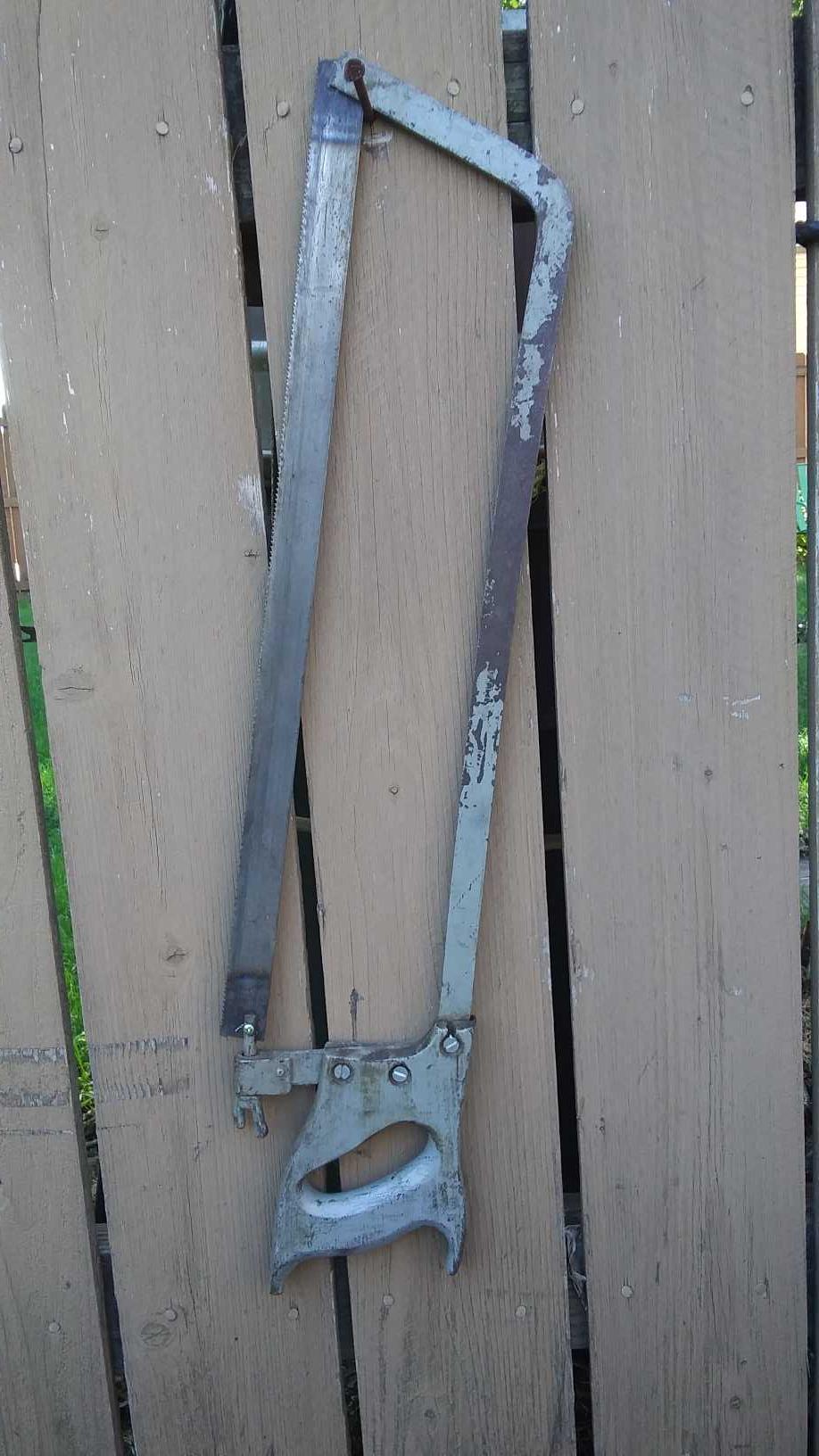

If you already have a saw kerf on one side. Use a cold chisel on the other side and then break it in your postvise.  Now I put a piece of bandsaw blade in a wood cutting bowsaw frame and have a LONG LARGE hacksaw that doesn't break blades.  Used my whitney punch to make the mounting holes and did them slightly inboard from the wood blade ones to have slightly more tension.  I've used it to cut 1.5" round stock before.

Hacksaw, cold chisel, hot chisel, O/A torch. I got the idea from someone here to use a bow saw with a metal cutting band saw blade to make a hacksaw on steroids.

Thomas:  Would you be able to share your “bow hack saw” blade suggestions?  Length / TPI / width for cutting thick ~ 2” steel stock by hand?  I recall you suggesting relatively coarse teeth?  Just wondering what has worked for you since it is an “off-label” use.

  Heres one I re-equiped with a bandsaw blade, Thomas.  I think the frame is an old meatsaw or something. The teeth are a bit worn out in the middle, time for the billet pile?  I counted 10 tpi but my eyes arent what they used to be.  Maybe I need to carry some readers around.
The rule of TPI for saw blades is. 3 teeth on the stock at all times. Hacksaw blade come in packages real fine blades aren't that useful, 1/8" wants 24 tpi max. WhenEVER possible cut the thinner dimension.
