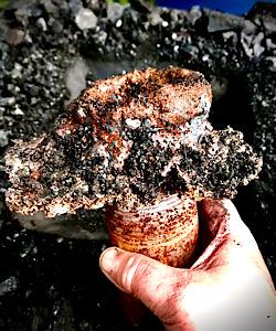

On 6/9/2021 at 7:54 AM, Charles R. Stevens said:
Have you considered a bullet grate? A 2” pipe cap with a 3/4” hole drilled in the top will shed slag in a nice donut.
Do you weld it in place?

No, and a short nipple is optional. The original bullet grates were solid, but unless you have one cast or turned your kind of SOL.

It didn’t turn out quite like I expected it might. Whatever that piece is, it was not structured like I thought it might be. The nipple at the bottom is too wide to be slid into the top. I had thought I would use it to decrease the size of the opening. That nipple is very thick walled and would have left me with an opening of 1.5”.  I could have ground it down to fit, but that would have been a lot of work and I didn’t think I could grind it evenly. So I just cut the top third off of the top piece, necked down a short piece of 3” pipe and welded the 3” piece to the top piece I had cut off.
It works ok. The opening is 2” wide, but I don’t seem to have a problem with coal falling through it. The coal clumps together so that isn’t a problem. The clinker mainly flows down below the top of the “bullet” grate. The opening does get clogged with clinker, but clearing it isn’t a problem. The 3” pipe down the tuyere holds the grate in place while I clean it out. I am not sure how long it will last. It has melted just a little around the opening.
One thing I wish I had not done was flare out the bottom of the 3” pipe. I did it thinking it would help with air flow, and it may very well do that, but what I had not expected was the bloody thing would get wedged in place by ash and small bits of coke and clinker. I will have to pry it out.
This is it now. The top is 2.75 inches from the top edge of the fire pot. The top of the bullet grate is two knuckles on my middle finger to the bottom of the pot.
It does work. Clinker forms and falls down in a ring around the grate.  Clinker does form and clog the opening, but my poker can clear it without disturbing the fire.
The problem is it melts quite a lot during each session. I need to try something else. The grate is carbon steel of some sort. Perhaps that is why it burns. This evening I went back to using bits of square stock placed over the tuyere opening. Better air flow. And don’t have to unclog the opening as often.
The advantage of parallel bars is that you can clear them simply by dragging a poker between them.
Forge clinker ball. Once you try it, You will wish its what you started with.  ;)

The problem is that you've got the "bullet" sticking too far up into the firepot. That exposes more of it to the heat, so it oxidizes faster. You want it lower down, so that it's below the fireball.
