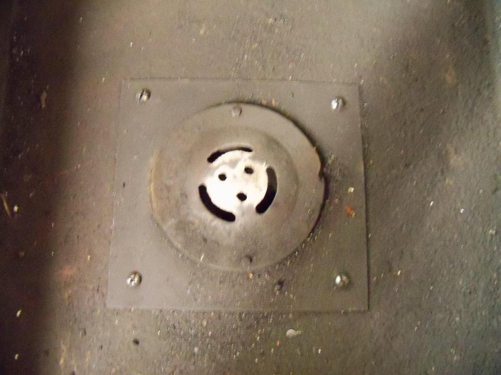

On 7/12/2021 at 3:23 AM, DHarris said:
This is it now. The top is 2.75 inches from the top edge of the fire pot. The top of the bullet grate is two knuckles on my middle finger to the bottom of the pot.
It does work. Clinker forms and falls down in a ring around the grate.  Clinker does form and clog the opening, but my poker can clear it without disturbing the fire.

Mine is simply too deep. I’ve considered clay, but I am likely going to just make a new pot with a “ball” clinker breaker. :D
On 12/14/2021 at 6:32 AM, DHarris said:
How has that worked out?
HOw much is too deep 5 inches ?
Depth is determined by the size stock you use. Any depth will heat any size stock, more or less. the shallower your firepot, the longer it takes to heat larger stock and the number of irons in the fire decreases. 4" is a good depth for most contemporary shops of any sort. It will easily and rather quickly heat multiple pieces of 1" square stock. Multiple pieces over this size start to take noticeable more time. If I were to heat over 1" square on a regular basis, I would add an inch more, 5" depth. The Railroad firepots I've seen are 5" or more. Never forget, the initial heat is the longest. Doing multiple pieces basically take the ~ the same amount of time for the initial heat as a single piece. Always do multiple pieces when possible. Once all are up to a working heat, when you finish working the first, the rest are ready. Width and length tend to limit the number of irons and the length of heat. Centaur Forge rectangular firepot is a good example for most contemporary firepots.

I still need to add clay, but I now have a shallower fire pot. I had planned to chop the bottom off and just reinsert it from the top, but that left it too deep still. I wanted 3.5”. So I welded strips of steel around the bottom and snugged the bottom of the pot to that. It is ugly as heck, but I don’t get points for that, so I am fine with ugly.

Short of welding strips of steel to close off that big gap between the inner and outer pots, how can I keep water from pooling between them? I assume just clay will not do that?

Personally, I'd solve that dead space problem between the insert and the outer old firepot before doing anything else.
Funnin aside D. If you weld a flange to your insert firepot and make the flanges wider than the old one and slope them down slightly it will shed water away from them and make a little ramp so raking coal in is a little easier. Not a great plus in either case but it's easy enough to get the benefits of both it's a why not in my books.
My forge stays outside in the weather. The pot is pretty thick, almost half an inch, so it would take quite some time for moisture under the clay to rust through. Still I would like for “some time” to be as long as possible.
Welding in strips to cover those gaps would definitely help keep the water out. Clay would absorb water from any precipitation you might get, which could cause problems both from expansion and contraction working it loose and breaking it down and also from the water turning to steam when you fire up the forge.
My recommendation would be to weld in some metal that's sufficiently massive to keep from getting burned away by the fire, and then to build a removable cover for the firepot to keep the weather out when you're not using it. Something like a big metal trashcan lid would be perfect.
