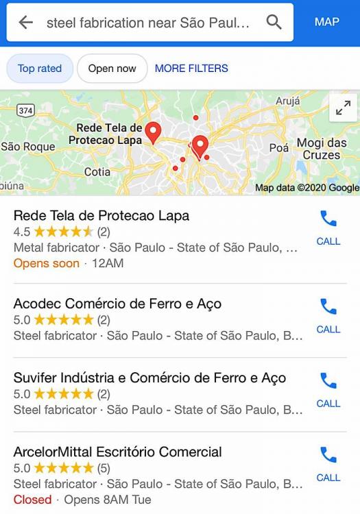

I used 1/2” which equates to something like 12.7 mm.  There appear to be several steel fabrication shops in São Paulo. Call them all until you find one willing to let you pick from their scrap pile. If they won’t, remind them you were planning to pay 4-5 x the current scrap price. If that won’t work, see if they will let you pick through their pile for free if you sweep out their shop.
Actually if you tell them you are looking for steel plate to make an forge so you can begin blacksmithing, they may just let you have anything you want.
