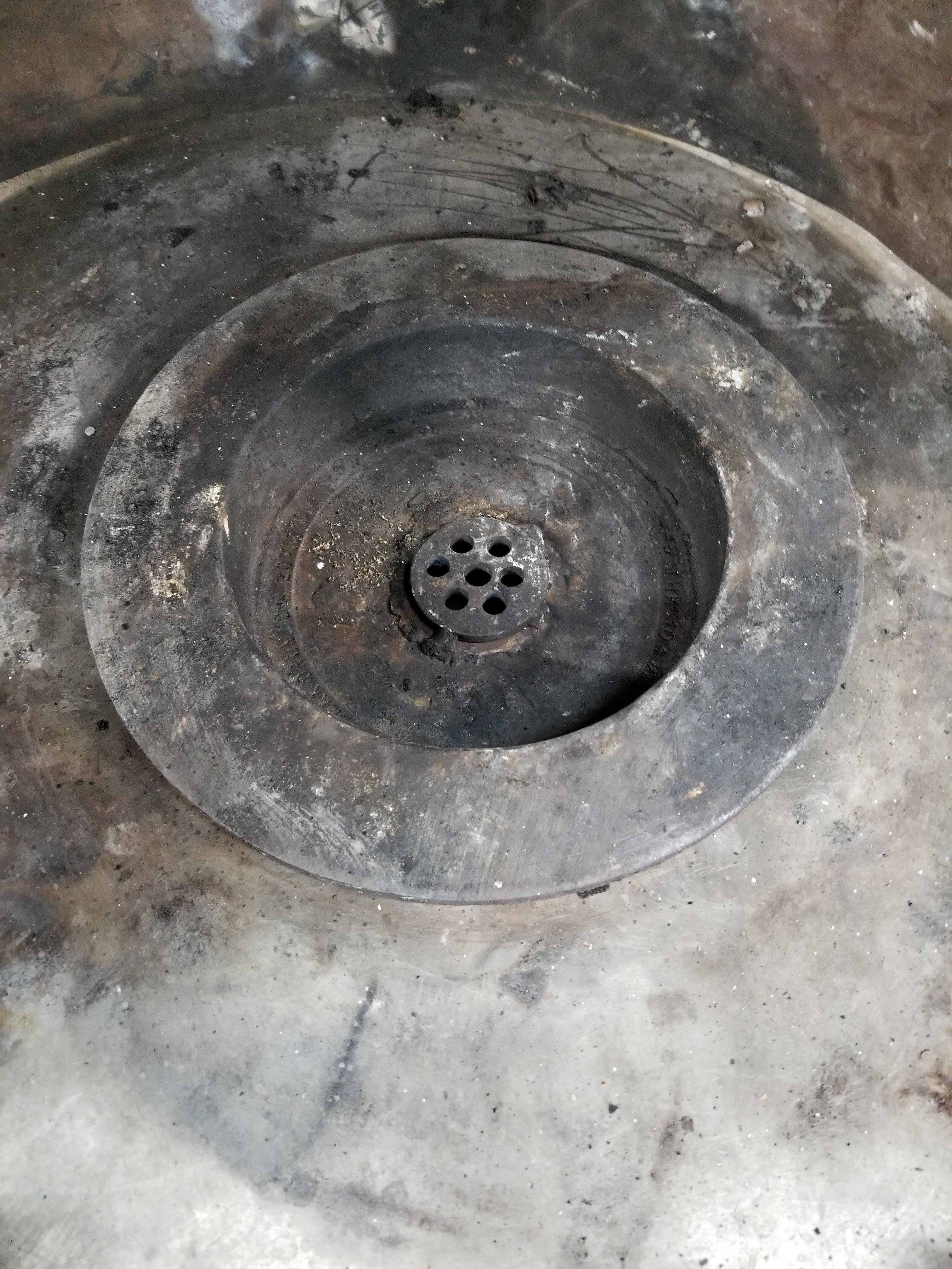

Daswulf Posted July 14, 2021 Share Posted July 14, 2021 Just to show you what I use. It's a steel plate with holes drilled in it. I dont think it would be good to tack weld to your cast fire pot but I tack weld it to my brake rotor fire pot. When it wears out I can simply cut the 4 tack welds and replace it. It could easily (depending on your skills) be fabricated to fit in the hole with a lip holding it in place. Link to comment Share on other sites More sharing options...
Charles R. Stevens Posted July 14, 2021 Share Posted July 14, 2021 Sorry I have been remiss in visiting you, and for that mater keeping up with this thread. Dad had had a heart attack about 3 months ago fallowed buy a stroke a month later. Been a bit hectic around here sense. as mentioned the gilet gray was to high, an inch or two would be sufficient and the lip underneath as you now know catches the slag so you can’t fish it out. Link to comment Share on other sites More sharing options...

anvil Posted July 14, 2021 Share Posted July 14, 2021 6 hours ago, JHCC said: think anvil meant the CF clinker breaker Thanks,JHCC, that's what I meant. I can't put their addy down. Check Centaur Forge. I'm not a fan of a metal grate. My first home built forge used one. I made the grate out of 1/4" welding rod for cast. When I learned of and used a clinker ball/breaker it made a major difference in my work. From keeping a clean fire without having to break it down to air distribution in the firepot. They are inexpensive and not that hard to add to a home built firepot. Link to comment Share on other sites More sharing options...

JHCC Posted July 14, 2021 Share Posted July 14, 2021 56 minutes ago, anvil said: When I learned of and used a clinker ball/breaker it made a major difference in my work. For a bottom-blast firepot, definitely. Not necessary for a side-blast. Link to comment Share on other sites More sharing options...

anvil Posted July 16, 2021 Share Posted July 16, 2021 On 7/14/2021 at 2:09 PM, JHCC said: Not necessary for a side-blast Back on topic. I think you are right. To be clear, I've never used a side blast, but I've burnt a lot of coke. No matter what direction the air comes from, it basically does 3 thing. It produces heat and heat rises. It makes clinker and ash, which falls down. Thats it. The heat heats our work and we must remove the clinker and ash. Then there's air and we need to remove the O2 from it to have a reducing fire. Simple stuff for simple blacksmiths. I'm not a fan of a grate. With a grate, slots or holes, the air basically rises straight up. With a sideblast, the air moves horizontal broken up via coke. We have far less control of this, so less control over our fire,,, possibly. A clinker ball due to its shape channels the air twards the sloping sides, and up. This creates a fireball that burns from the outside in giving us a large controllable fireball. A clinker ball also allows us to remove all clinker and ash without breaking down our fire in able to do this. A flick of the handle, and done. With a grate, to remove the fines and ash, you must break down your fire and shovel it out. A side draft has a depression below the air inlet that clinker and ash can fall into. Of course you can remove the clinker ring, but what about the rest? \ Just my opinion Link to comment Share on other sites More sharing options...
Charles R. Stevens Posted July 16, 2021 Share Posted July 16, 2021 Well with a well designed side blast you have as much control over the fire as with a side blast but you do not have the slag directly over the draft sorce. As to removing the slag, kill the air, lift the fire with your shovel and hook the slag with your poker and pull it out. Easy enugh. Link to comment Share on other sites More sharing options...
JHCC Posted July 16, 2021 Share Posted July 16, 2021 16 minutes ago, Charles R. Stevens said: with a well designed side blast you have as much control over the fire as with a side blast As much control as a bottom-blast, but Yes. In this context, control has more to do with the controlling the speed and volume of the air supply than anything else. Link to comment Share on other sites More sharing options...
