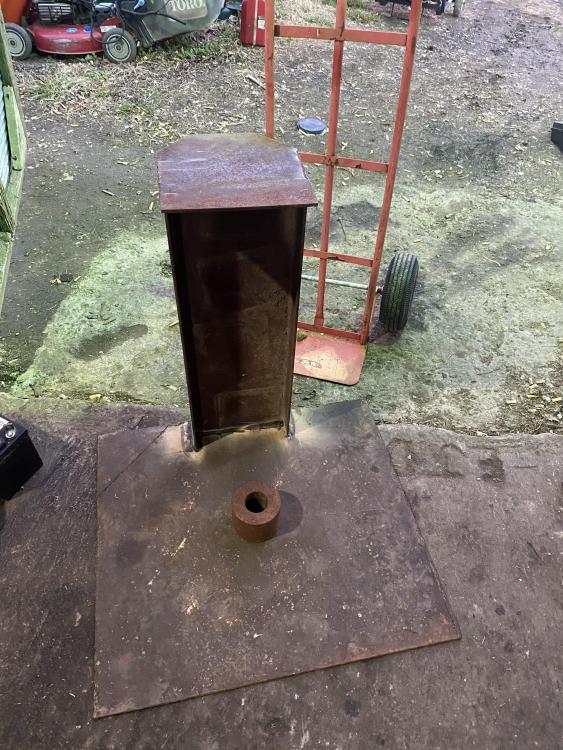

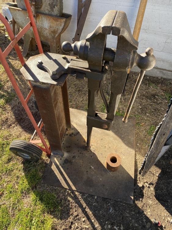

Just started building my vise stand today I’ll  get it finished up tomorrow. I used 1/4” plate and 4”x10” ibeam. I still have to drill the mounting holes and weld on the socket for the foot.

Good Morning TW,
I have very similar style portable Vice Stands. They work well, you will learn to work with the flex in the bottom plate. When you are filing, you will match your stroke with the bobbing Vice. You can cure it partly by adding some triangulation to the upright support. Don't make the stiffners too big or you will forever be tripping over them, at least to the base of the Post Vice block. Sideways as well as forward, maybe even weld another plate to the rear and make a rearward stiffner as well. Take the time now!!
Neil
Thank you for the advice Neil I was wondering if I would need to add gussets on the main support but you answered that thought for me.
Irondragon, yes the bottom plate is 26”x30” and when I did a mock up before welding it all together I was able to stand on the plate with the vise.
Swedefiddle, I found out what you mean on the flex, after I got the holes drilled and bolted down the vise, the stand wasn’t near as ridgid as I thought it would be, when pulling on the handle you can watch the ibeam and plate flex. I’ll most definitely be taking your advice and I’ll add some channel to stiffen it up, Thanks for the tip

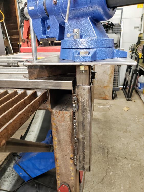

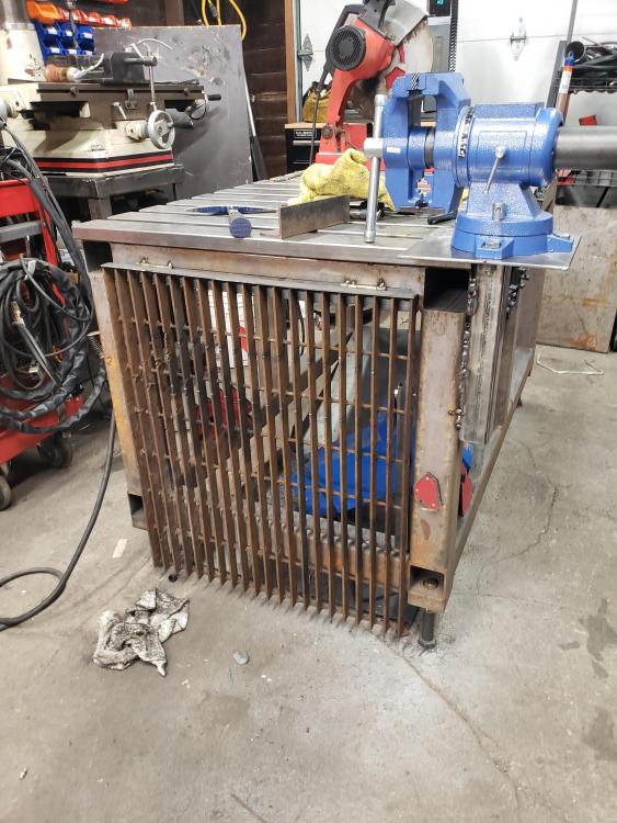

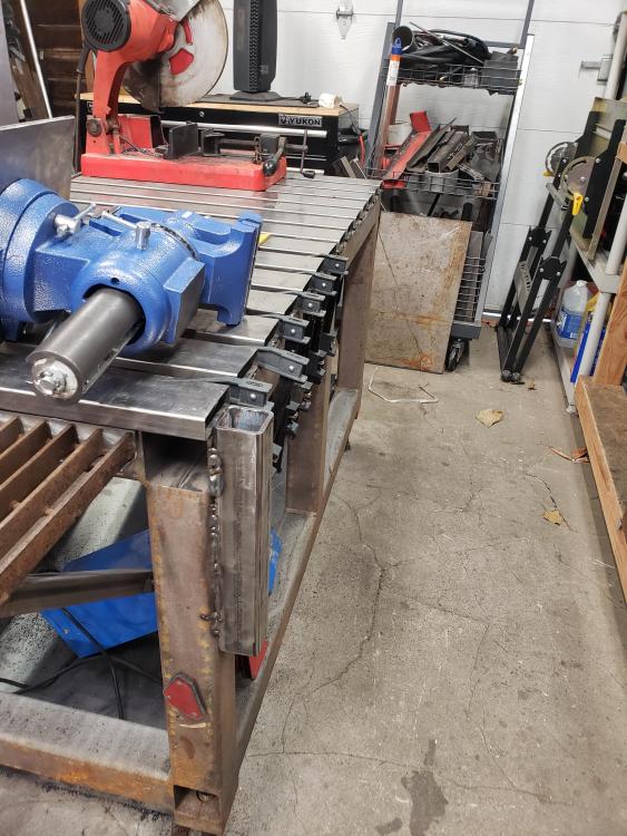

Here's what made for my fab/welding table. Designed it so it  an be removed.if I need the space

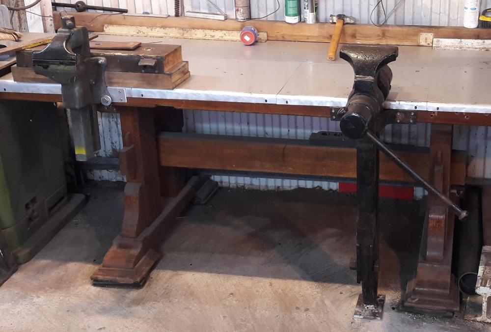

Discarded old oak dining table, hereby reclaimed to become workbench & vise mount. I also put a 3mm aluminium plate on top. Makes it last somewhat longer.
I like the vertical mount bench vise. There are projects where a vise mounted like that, would be just the ticket.
I have seen that done by catching the end of a drill press vise in the jaws of a horizontal vise.
especially for sawing and grinding it's handy since the bottom jaw doesn't move; and if I get new people in my workshop; it's one of the good ideas they take home; as it's invariably the most used vise during the day. The wooden frame does take up a lot of workbench-space. Maybe i should try mounting the blocks below the table....
Bart,
Now I need to scrounge another bench vise and mount it. I think a removable version could be made easily enough for lighter work, and it would not add more clutter to the front of the bench.
George,
I have a drill press vise and never thought about clamping it in my bench vise...Brilliant!
I've seen a couple of people mount a tongue vise horizontally for the same reason.   It works great for holding while sawing or filing.

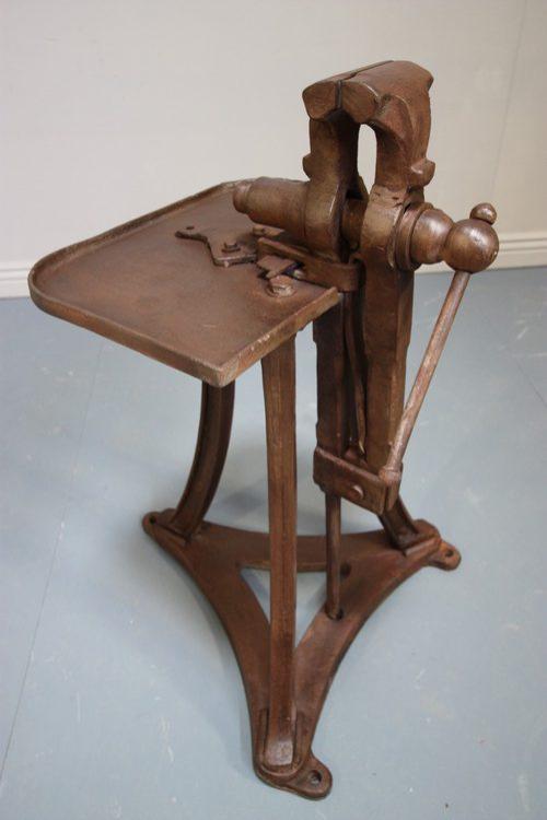

Not mine, just wondering if anyone has knowledge/experience with stands like these. Are they factory built specifically for a leg/post vise?
At my school there are a couple of tables made for vises. They don't look that nice.
Handy thinks. You can move them and yet stable when hammering. But big, they take up floorspace. The ones mounted on a heavy pole, take up less space (also to walk around them)

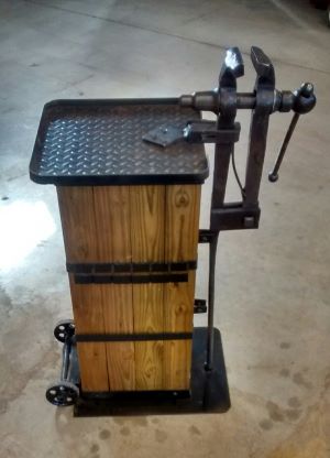

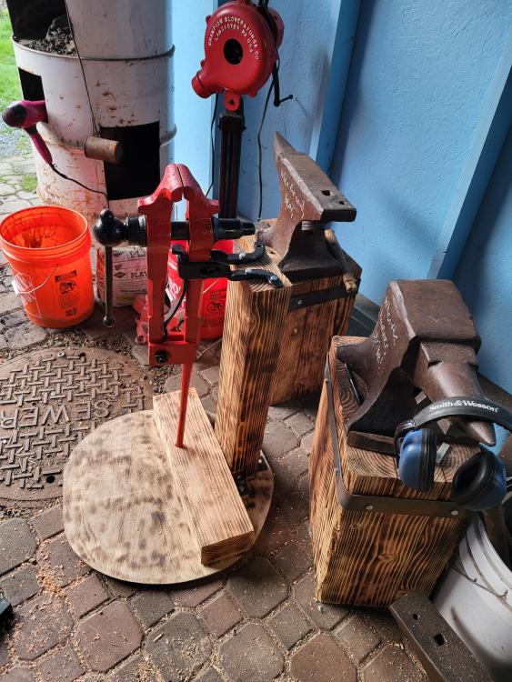

Made this today. Surprisingly rock solid for wood. Reinforced with forged brackets at the bottom.

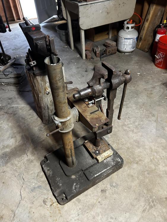

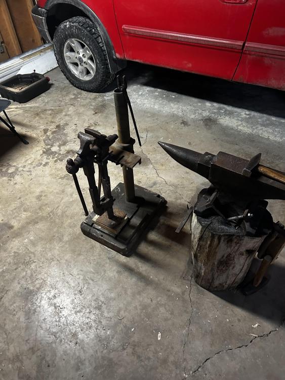

I posted this idea in the show me your shop thread, but I just made a mount for a shortened vise that I hope to use as a striking vise. The idea is taken from Mt. Phillip Metal Works. He takes a broken camelback drill press, cuts the top off and mounts the vise to the table. A potential problem is that the table and base are cast iron, so not super impact resistant. I have not used it for much striking, or for anything really to see if it survives much striking, but so far I like it, if only for the looks and having a vise by the anvil!
