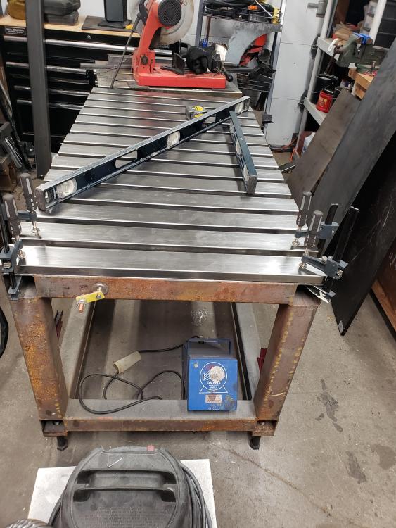

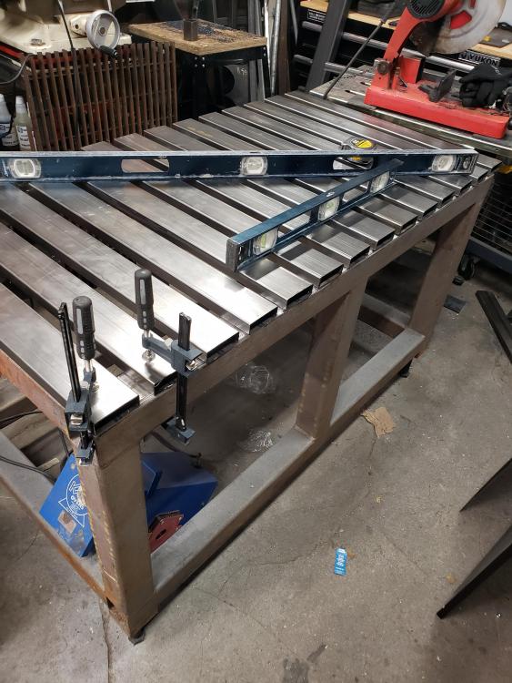

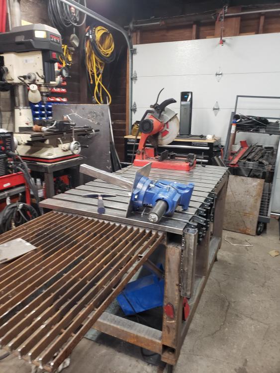

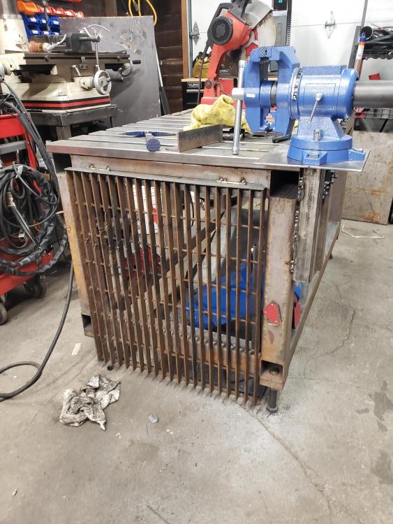

  5. well I ended up tacking the cross bars to the frame clamped them good and had very minimal warpage( i think thats a word) . Put the plasma table on the end w hinges so it folds out of the way when not in use. I'm able to clamp things square and flat now. I also put a receiver for my vice so it's also removable when I need a flat surface

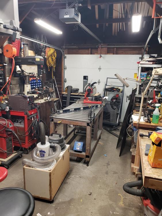

  6. I'm looking for some advice. I got this great table frame and need to put a top on it. Can't afford to put a decent solid steel plate on it so I decided to use rectangular tube. my question is should I weld the tube on or bolt it. It's 1x3x.060. a little lighter then I was hoping to get but the price was right. 60.00 compared to over 200.00. the frame can support thousands of pounds and maybe when I go back to work I'll change it to something more sturdy. I'm putting a plasma table on one end and a pull out shelf for my chopsaw on the other. as you can see my little workshop is very full of stuff. I'm trying to weed some stuff out but it's hhhaaaaarrrdddd. I like my stuff. here's some pics of what I'm talking about

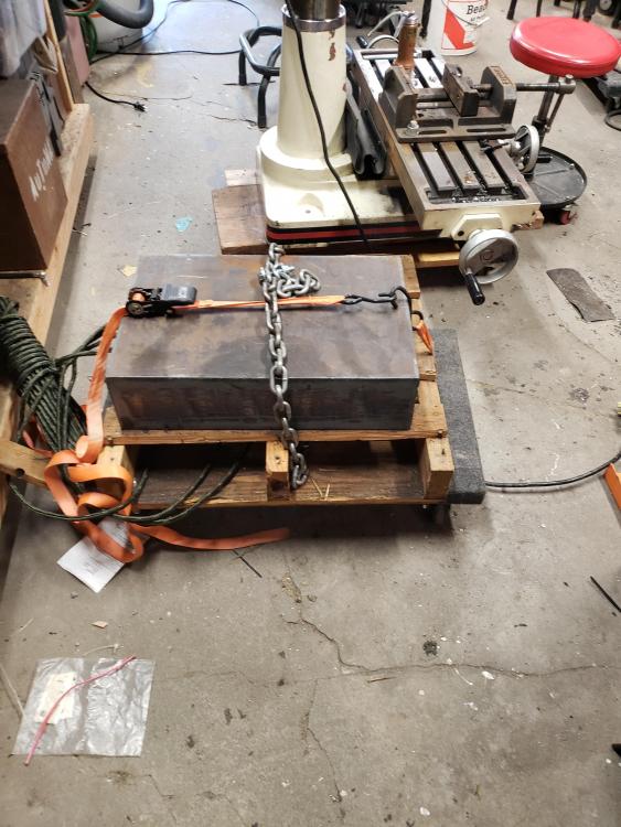

  7. Well.....first try getting out of the truck....not so good. All I managed to do was tip it over...shoot.. now I have a 550 lb pancake that is no longer on the pallet aaaaannnnd still in the bed of my xxxxx truck!!!. So I gotta re-think this process. The magnetic lifting eye won't be here til nov 5th. I guess I could back up real fast slam on the brakes and hope it doesn't destroy my tailgate and bumper although I don't think I can build up enough speed to do it. No not really..... just a little frustrated right now. Gonna look at it tomorrow. I might weld a eye on it. Use a lever and fulcrum to lift it up enough to get a chain around it. I have access to a mag drill I could drill a couple of 3/4 in holes in it and weld round stock for a handle. We'll see. Thanks for letting me vent. I'll let yuall know how it goes (-:《
