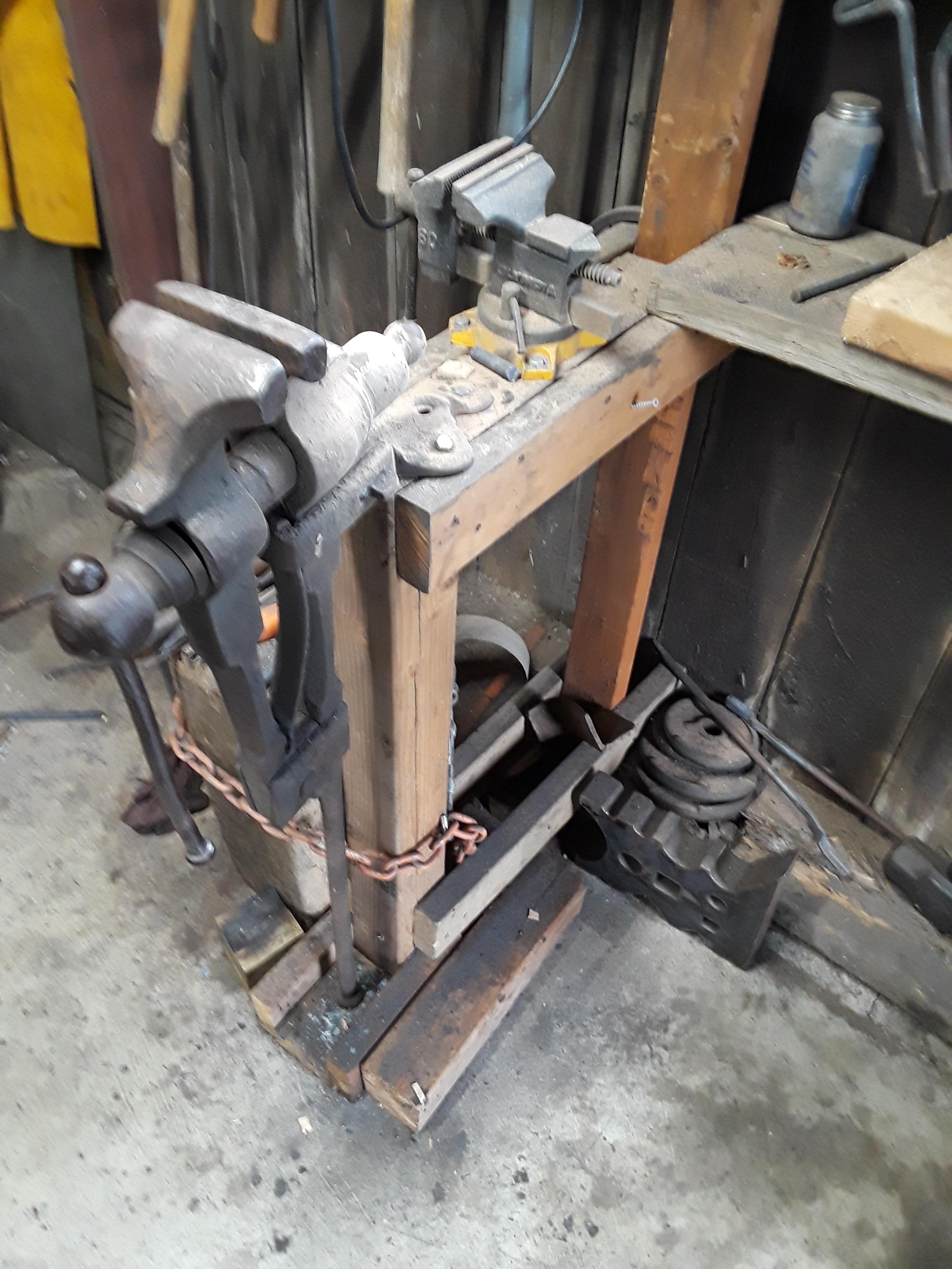

Pretty simple really. A piece of 4x4 and some 2x4s. It is actually much sturdier than it looks, i am "one of these days" going to put 2 more 2x's coming out at an angle on the bottom and tie them into the 10x10 that is the base of my shop wall. You may also see a pile of weights next to it on said 10x, may have to change the bottom plate now.

Just got my post vise, Chris.
Made this attempt at a stand today. It's not as stable as I would like, but I think I'll be adding another steel plate like the ones I have now as a counter weight stand.
Obviously the plan is to bolt it down eventually, but I need it portable for now.
