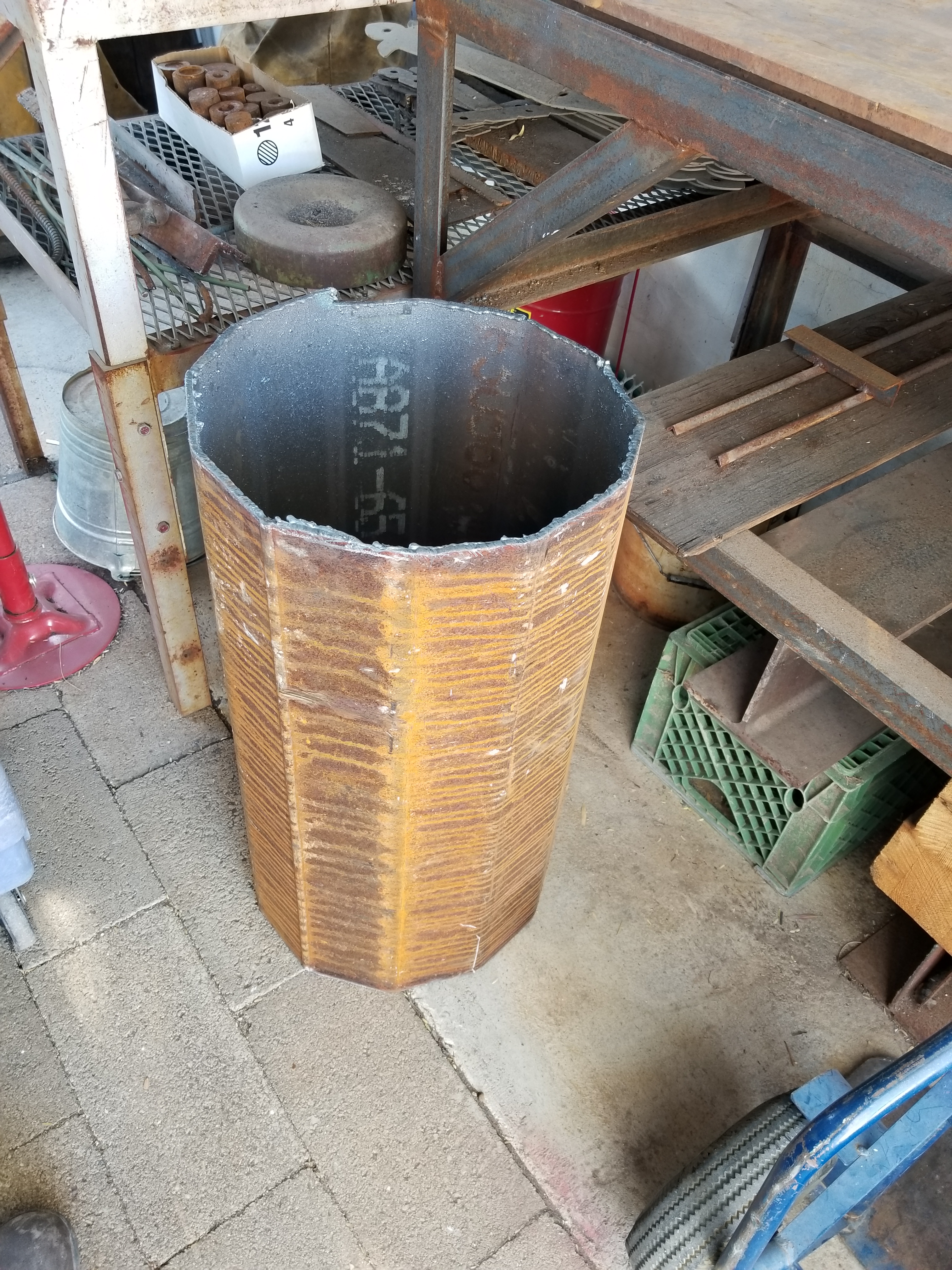

bigb Posted February 18, 2018 Share Posted February 18, 2018 My anvils are all outdoors but hidden from view. I am in the process building my stand for my newest acquisition, my 149 lb A&H. My plan is to use a section of 1/4" steel utility pole (it wasn't me Cactus Bob!) since they are tapered and have a perfect shape to be able to walk around while being very stable. I will weld a base on the bottom (the wider end), cut the top to the proper height then fill it with sand. Then I will attach the anvil to a plate that fits just inside the top diameter and place it on the sand. Then I will weld tabs around the top edge of the base so I can still turn or level the anvil but it cannot be lifted out without grinding off the tabs. At least this way it will weigh enough to deter theft. The picture is a piece of utility pole I got at the scrap yard last week. Quote Link to comment Share on other sites More sharing options...
