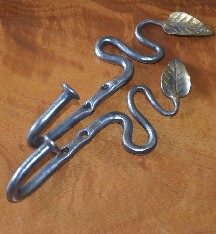

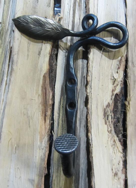

Today's effort was to make a pair of leaf nail hooks. I have left the nail heads untouched as they are smooth enough not to damage coats, hats, towels or whatever hangs on these, and I like the idea of repurposing nails. I have never seen nails that big (about a foot long) and I imagine they must be used for pinning large soft timber such as pine logs for cabins or something.
Anyway, I am indebted to Vaughn T for mailing me a pack of those nails along with some long-sought-after duplex nails which are unavailable here in Australia. I have a few ideas in mind for those long nails and will post results if successful. Thanks, Vaughn.

Aus, your scrolling work is always great. Do you just use tongs or do you use jigs and stuff?
Blaster, not really scrolling on these hooks - just a bit of free-hand bending, done with scrolling tongs to avoid marking the metal. I do use a purpose built jig for the hook ends to get them something like equal if I'm doing a pair.
And for a pair I will usually start the leaf bends in opposite directions (as in the photo) for the sake of balance when they are side by side on the wall.

How did you get enough material on the end to make the leaves?  Fold over and forge weld?  Upset?
It looks to me like maybe he drew it out, but left some material on the end to make the leaf?
Beautiful work, Aus!  You really did those nails justice!!
Tundra: The nails are about 3/8 inch (10mm) round, and that's plenty to forge a reasonable leaf. You just neck out enough for the leaf, draw out the stem section and away you go.
Beech: Yes, pretty much.

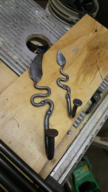

I missed what y'all are talking about, but my compliments on your leafy nail hooks. Nice work.
The top one pictured reminds me of a rattlesnake on the move.
