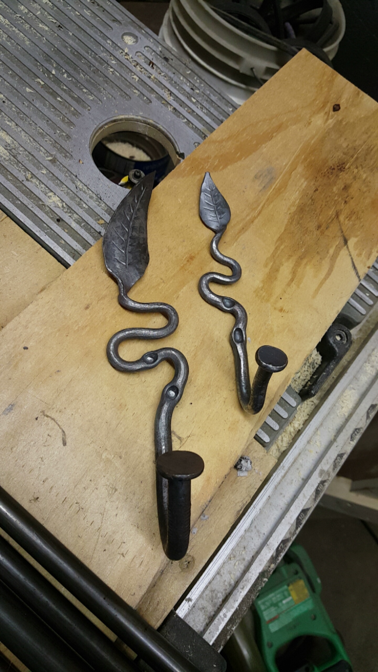

Gergely Posted January 25, 2017 Share Posted January 25, 2017 Walking on Aus's path I tried to take this to more reproductive level: hook stem part is half of the original nail's size, hook bent on jig, leaf stem is drawn down to fixed size (the whole length is 390 mm when it's drawn). Tried to jig the leaf stem bend but it wasn't good, have to think more. Also need something to uniform the place of the punched holes - but I think I just eyeball them for a while. Tried the thinner, longer veining - I like it better! Also made a slightly curved chisel for veining, but it has to be reground -failed the test. And can't find my crimping stake... So, more work ahead! Bests: Gergely Quote Link to comment Share on other sites More sharing options...
Daswulf Posted January 25, 2017 Share Posted January 25, 2017 Nice Gergely, the leaf does look better. Quote Link to comment Share on other sites More sharing options...
ausfire Posted January 25, 2017 Author Share Posted January 25, 2017 Gergely, your eye-balled punched holes look fine to me. I'm adopting Vaughn's technique of making divots for the holes first. The bit of flattening that occurs helps keep them in line. I place the holes about 30mm apart, halfway along the nails. Two chalk marks on the anvil indicate the spot. And yes, the longer veins look good. The slightly curved chisel is the way to go, so you can chase the groove. I prefer a bit more shoulder on the leaves, but that's just my choice. Great work, and thanks for posting the pics. Quote Link to comment Share on other sites More sharing options...

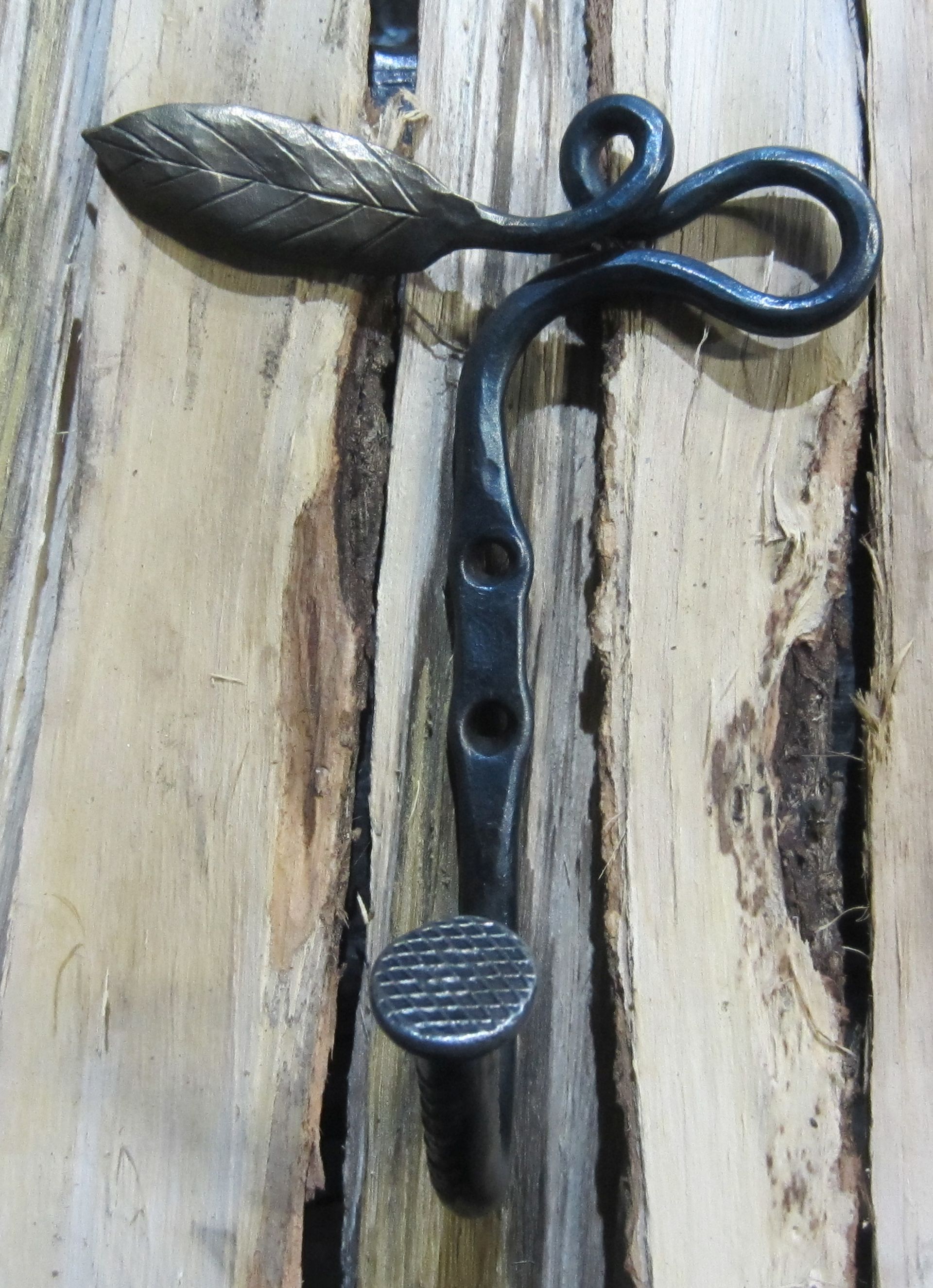

bryson489 Posted February 18, 2017 Share Posted February 18, 2017 I've had a few of these nails laying around for years and after seeing this post had to jump on the wagon. These are so simple yet so cool. I gave it a try with a couple sized nails. Gotta love this forum. Quote Link to comment Share on other sites More sharing options...

ausfire Posted February 18, 2017 Author Share Posted February 18, 2017 Nice work, guys. Bryson, you have the holes well placed on the bends. I like that idea. I assume you punched the holes last. Well, before the final hook anyway. I've always done the holes first because I reckon if you do all that work with the leaf and the bends and then mess up with a hole punch you lose all that work. I'm better at hole punching now than I used to be so I'll do it your way next time. The bends would stop the round bar from rolling, too. Quote Link to comment Share on other sites More sharing options...
