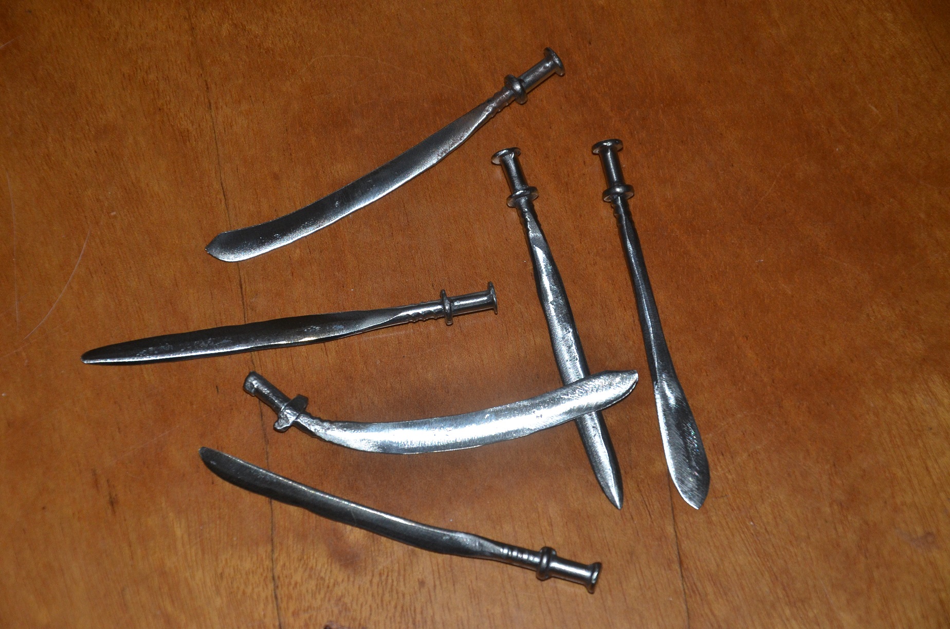

ausfire Posted January 15, 2017 Author Share Posted January 15, 2017 OK, while we're on about using nails, here are a few little swords made from duplex nails today. That's about the extent of my hammering at the moment ... nothing heavy till the back eases up a bit. Those duplex nails (formwork nails, scaffold nails) make good little swords. We have all been asked innumerable times at demos, Can you make a sword? These are very simple of course and take about 10 seconds to make before cleanup. I guess the possibilities are limited, but anyone have any variations on these? I know of one idea of wrapping the handle in copper wire. And thanks to Vaughn for sending the nails to me. Quote Link to comment Share on other sites More sharing options...

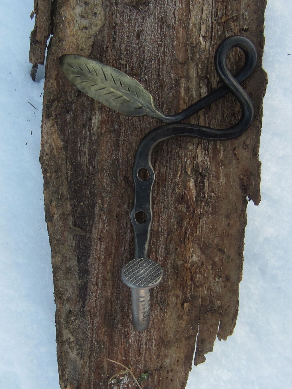

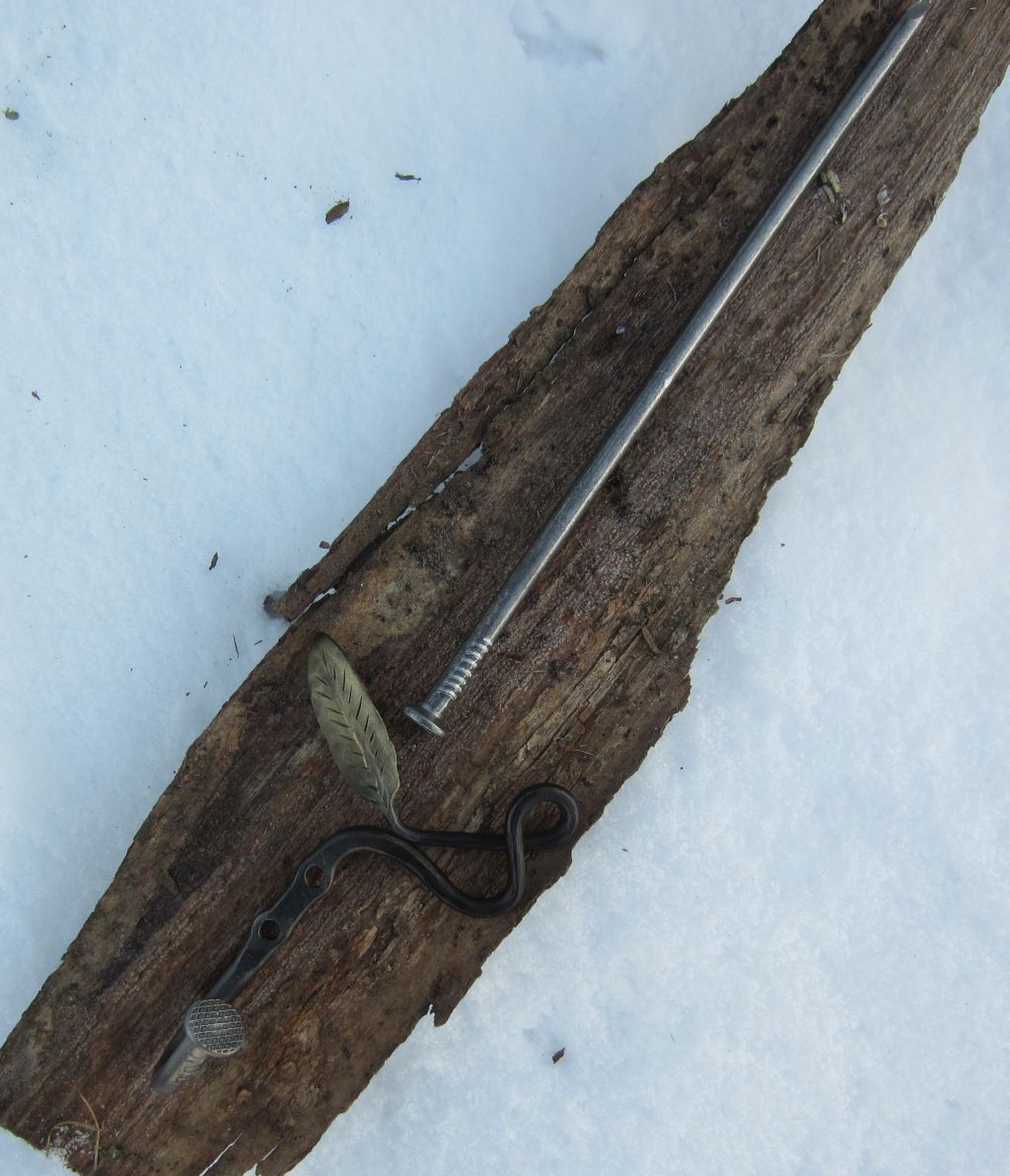

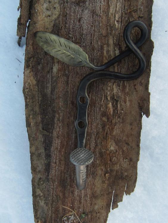

Gergely Posted January 19, 2017 Share Posted January 19, 2017 They arrived today! Boy those are big nails! These are 9mm/3/8" thick. Prototype experimenting on Ausfire's path : Quote Link to comment Share on other sites More sharing options...
Daswulf Posted January 19, 2017 Share Posted January 19, 2017 Nice! A friend just brought me over a handful of rusty ones. The ones I find to buy are galvy. coated and need an acid dip to remove the coating, then neutralized. Quote Link to comment Share on other sites More sharing options...
ausfire Posted January 19, 2017 Author Share Posted January 19, 2017 Das, the ones that Vaughn sent to me were not galvanised. They are a bright steel and they seem to be a bit harder than mild but nowhere near as hard as stainless. Vaughn might reveal where he sourced them. And nice hook, Gergely. Your punchings are very neat. Quote Link to comment Share on other sites More sharing options...
Daswulf Posted January 19, 2017 Share Posted January 19, 2017 26 minutes ago, ausfire said: Das, the ones that Vaughn sent to me were not galvanised. They are a bright steel and they seem to be a bit harder than mild but nowhere near as hard as stainless. Vaughn might reveal where he sourced them. There are a few more places I havnt looked at yet. If they don't pan out I will have to ask. I'm probably paying more for galvanizing that I have to strip off anyway. Quote Link to comment Share on other sites More sharing options...
ThomasPowers Posted January 19, 2017 Share Posted January 19, 2017 The ones sold for landscaping tend to be galvanized in my experience---if you are dealing with good landscapers. Ones for construction might be clean. Quote Link to comment Share on other sites More sharing options...
Gergely Posted January 19, 2017 Share Posted January 19, 2017 2 hours ago, ausfire said: Das, the ones that Vaughn sent to me were not galvanised. They are a bright steel and they seem to be a bit harder than mild but nowhere near as hard as stainless. Vaughn might reveal where he sourced them. And nice hook, Gergely. Your punchings are very neat. Thanks, Aus! Interesting to hear about harder nail material. I always tought nails are made of pretty soft steel. My nail sure moved like butter while hot. Quote Link to comment Share on other sites More sharing options...
ausfire Posted January 20, 2017 Author Share Posted January 20, 2017 11 hours ago, Gergely said: Thanks, Aus! Interesting to hear about harder nail material. I always tought nails are made of pretty soft steel. My nail sure moved like butter while hot. Yeah, maybe it was my imagination. I have been hammering very lightly since making a slow recovery from a back injury, and maybe the metal just seemed harder. Quote Link to comment Share on other sites More sharing options...

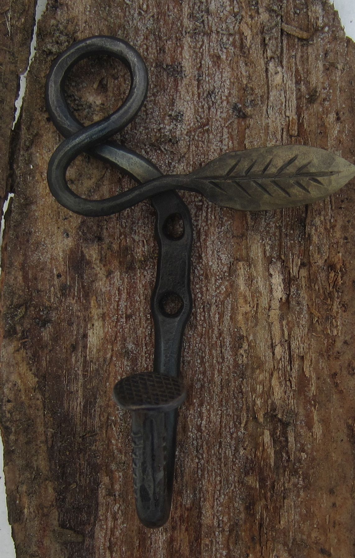

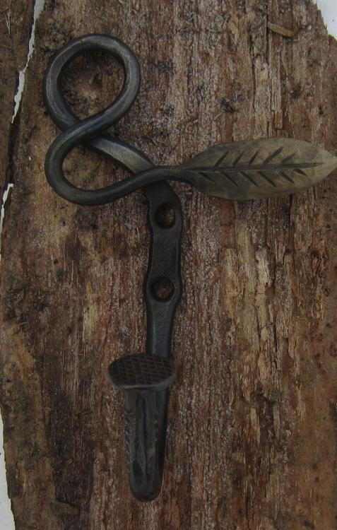

Gergely Posted January 21, 2017 Share Posted January 21, 2017 Made another one as an opposite piece, can't say I'm very pleased, but learned a bit again: Quote Link to comment Share on other sites More sharing options...
JHCC Posted January 21, 2017 Share Posted January 21, 2017 23 minutes ago, Gergely said: Made another one as an opposite piece, can't say I'm very pleased, but learned a bit again: Chiseling the veins all the way to the edge will make things a bit more leaf-like. Quote Link to comment Share on other sites More sharing options...
Gergely Posted January 21, 2017 Share Posted January 21, 2017 I'll try that! Thanks g Quote Link to comment Share on other sites More sharing options...
Mark Ling Posted January 22, 2017 Share Posted January 22, 2017 Or at least chiseling all the way to the edge on the ones closest to the stem, and then going less and less as you move towards the tip has a nice effect. Littleblacksmith Quote Link to comment Share on other sites More sharing options...
Gergely Posted January 22, 2017 Share Posted January 22, 2017 Yes. I was also thinking of making a slightly curved veining chisel - nature doesn't like straight lines that much. And maybe a bit sharper edge on it. Quote Link to comment Share on other sites More sharing options...
ausfire Posted January 22, 2017 Author Share Posted January 22, 2017 I see you have bent them in opposite directions. They would look good on the wall together. Quote Link to comment Share on other sites More sharing options...
Gergely Posted January 22, 2017 Share Posted January 22, 2017 Thanks, Aus, that was the idea you mentioned earlier. Funnily I left the first piece in the house, so they don't match. But as I said I learned a lot about this thing: I won't do another without a jig. At least the big hook part has to be done on the jig, but I consider making a stem-bender, too. Today it hit me, I should mix my small flowers with this design: the two stem variation could get a leaf and a flower head. I still have a couple of those to spare: Bests: Gergely Quote Link to comment Share on other sites More sharing options...
