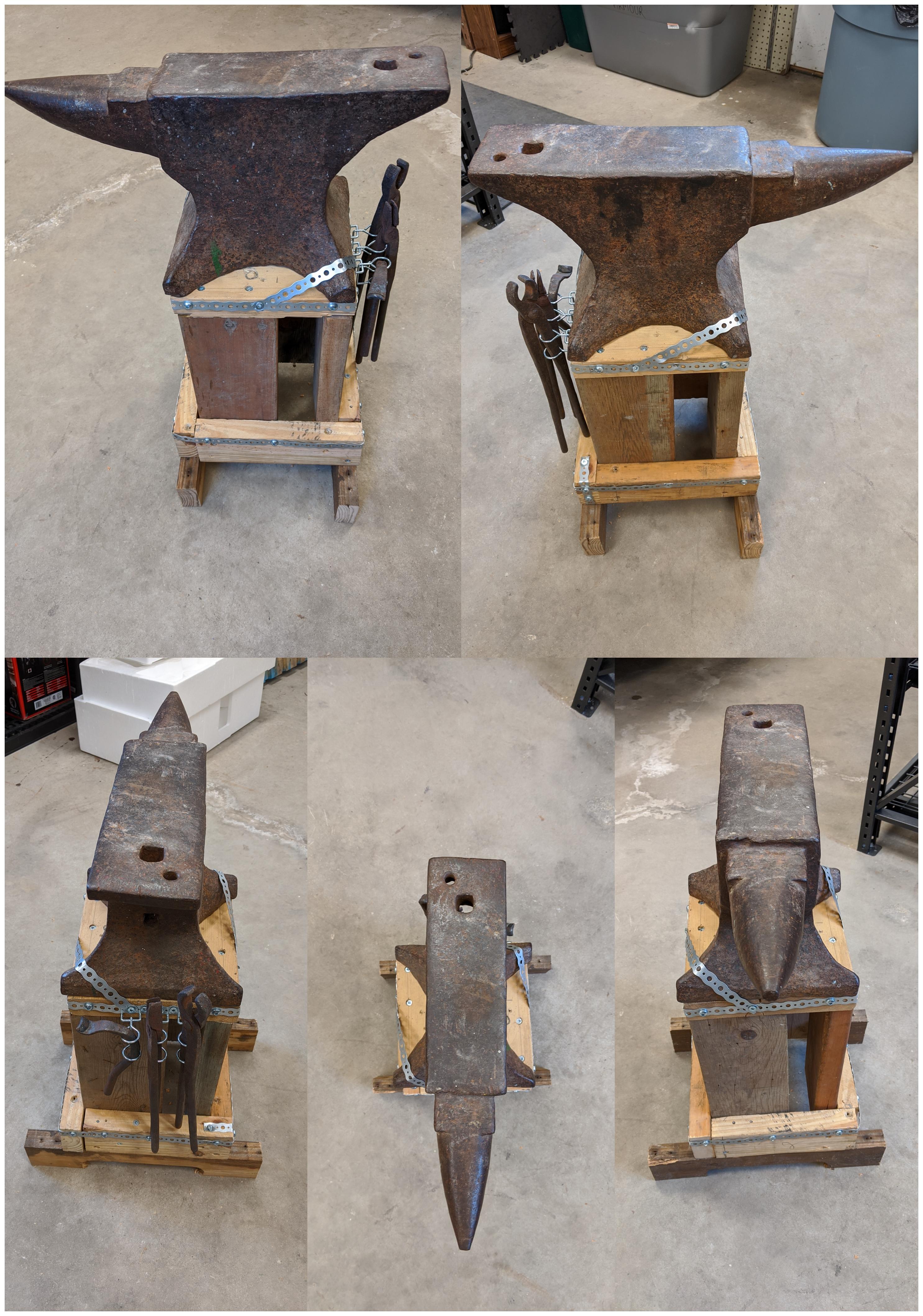

Wandering_R0gue Posted July 29, 2022 Share Posted July 29, 2022 This is mine. Paid 1.00/lb for it from some old guy's barn. 90lbs, but I don't know the maker. There are traces of a maker stamp on the side, but it is too rusted to be legible. Could be in better condition, but for the price, it does the job. Quote Link to comment Share on other sites More sharing options...
Rojo Pedro Posted July 29, 2022 Share Posted July 29, 2022 Nice score WR. looks in good shape Quote Link to comment Share on other sites More sharing options...
Wandering_R0gue Posted July 29, 2022 Share Posted July 29, 2022 It is in fairly good shape. Shoulders are a bit rounded, and there is a cut in the tip of the horn, but otherwise, it is workable. Quote Link to comment Share on other sites More sharing options...
Frosty Posted July 30, 2022 Share Posted July 30, 2022 Looks good to me from here. Putting hammer to hot steel on her will shine up and smooth her face nicely. Frosty The Lucky. Quote Link to comment Share on other sites More sharing options...
FlatLiner Posted July 30, 2022 Share Posted July 30, 2022 Those edges don't look to rounded to me. In the book Practical Blacksmith by M.T. Richardson on pg. 92 a blacksmith from about the turn of the century wrote. "For my own part, I am satisfied not only that the sharp edges are useless, but that they are also destructive of good work. I cannot account for their existence except as a relic of a time when the principles of forging were but little under stood. I want both edges of my anvil rounded, not simply for a part of their length, but for their whole length. To my mind the ideal anvil of 130 pounds is one having its edges (from the table to about 2/3 the length) rounded to a curve of three-eighths of an inch radius (from about 2/3 to the heal) rounded to a curve of three-sixteenths or one-quarter of an inch radius. The (edge of the heal) can be sharp to satisfy the unconverted.-By X." Quote Link to comment Share on other sites More sharing options...

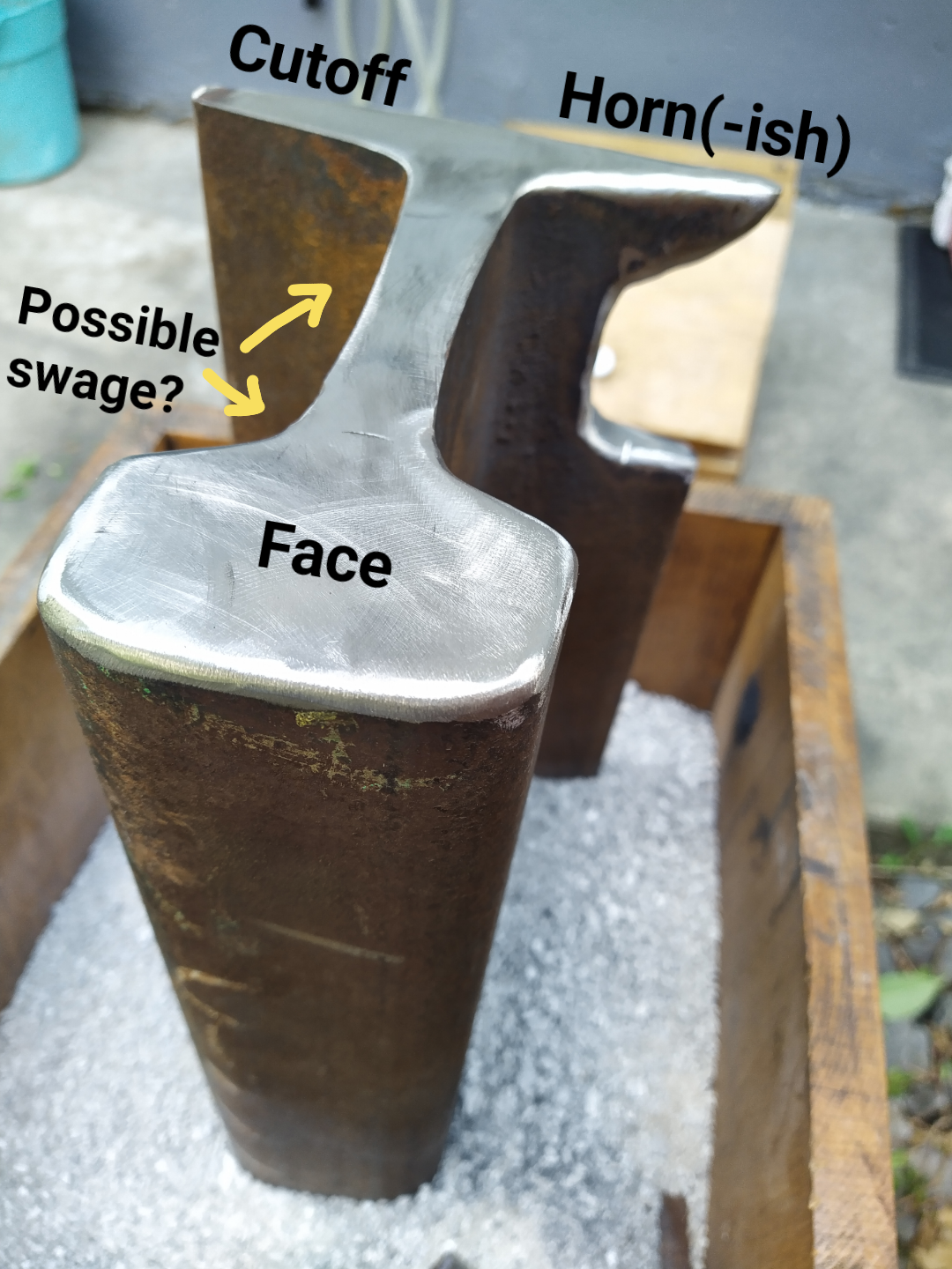

Shainarue Posted August 18, 2022 Share Posted August 18, 2022 Thanks to some wonderful advice on this forum, I'm on my way to a functional anvil. I still want to add a piece of square tubing to hold hardy tools, especially the hold-down tool because this hammering surface is tiny to try to hold something steady in that spot while holding the other end/tongs between my legs. Quote Link to comment Share on other sites More sharing options...
JHCC Posted August 18, 2022 Share Posted August 18, 2022 When you say “possible swage”, are you thinking of cutting grooves across the web, or rounding the web over as fuller? For what it’s worth, I haven’t used the fuller I ground into the web of my own rail anvil, but your mileage may vary. Quote Link to comment Share on other sites More sharing options...
