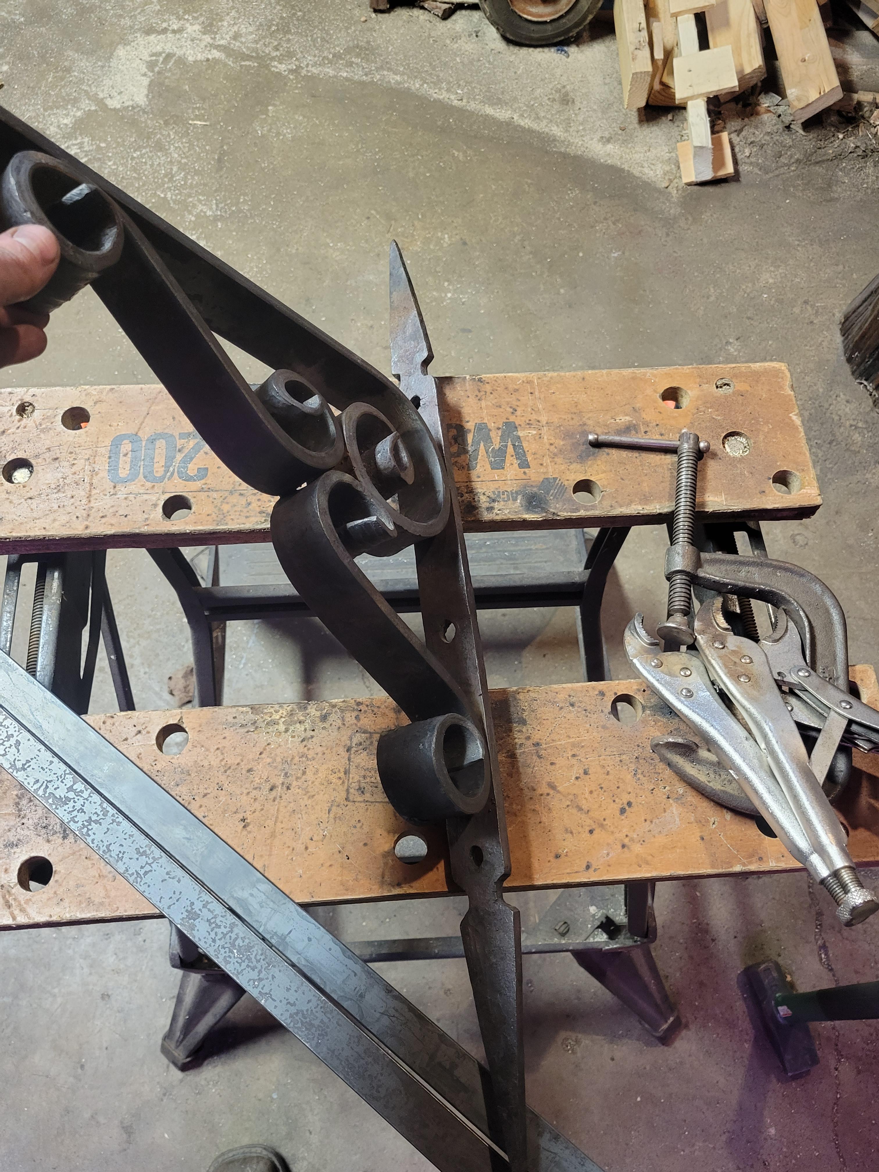

  20. George, thank you for saying so. I couldn't agree more, being able to hold and use something of your own creation can be a wonderful feeling. He likes to make oil and acrylic paintings and so wanted a pallet knife to use that is truly his own. I hope he wants to forge more next time he visits. Shoot, I meant 3/16" not 3/8" lol. I am concerned about the busyness of the inner collars too, thanks for mentioning it. I did consider a thinner stock, but my thought was that it would stray from the uniformity of the collars. But thinking about it now, the width of the collars is more noticeable than the thickness. Do you think 1/8" would look nicer?

  23. Most of the week has been spent forging the wrought iron back bracket and assembling the hanger. My youngest brother has been in town visiting from out of state and has been my "minion" at the forge for a few sessions. He is currently climbing up from a personal rock bottom, so it is a blessing to be able to spend so much time with him. He said he had a great time at the forge, especially when I gave him some time to himself at the anvil forging a pallet knife from some rebar. I've missed him. The hot collars took a good wrastlin' but we got three and a half on before it was time to call it quits due to fuel shortage. The last three will be 1/2"x3/8" as they will be wrapped on close to one another. After that its just down to more refining and finishing. I am leaving it up to the customer to decide whether it should be painted or BLO/turp/waxed; no response yet. Whitaker suggests that outdoor items should be painted. That might be the best route here as I imagine it will be quite the chore for the owner to touch it up in a few years if I go with BLO. We will see what they decide.
  24. I have a few things of smaller diameter that should be helpful. I like the wooden mallet idea too... been meaning to make one of those! I'm sure a small wieldable log will work for now. Thanks, Thomas!
  25. Hit a small checkpoint this weekend: it hangs again! But just a short test hanging. I forged the 2nd yoke (please correct me if it should be addressed with a different term), put the main arm of the hanger in the vise and hung it up. I struggled to achieve the correct arch on the 2nd yoke, but was able to shape it cold around a scrapped air compressor tank of the same diameter I need to meet for the bell's main yoke to fit properly. I used 1" x 3/16" flat stock. In order to orient its hooks properly, I had to twist them. I figured, if I have to twist I might as well try to make them decorative, so I went with 1.5 turns on each side. For the hooks to end up facing the same way, I had to twist each end in opposite directions; one twisting out and one in. This left each twist looking like it is out of line with the arch. Am I doing something wrong here, or do I just need to make more adjustments with my scrolling fork to make them line up with the arch?
