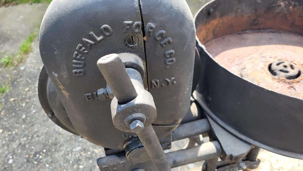

A buffalo forge.
Those are rare here in eu I think.
Was used as a bbq for the last 40 years.
Blower works, spins 1 turn extra. Is all greasy. No idea how to maintain it.
The forge bottom ia a bit wobly and rusty. Thats the only part.
Do I need clay or anything?
Price was cheap, so even i wasn't looking for a forge, it is hard to pass on it.Compress_20230518_160349_9370.thumb.jpg.bf2872fdab5d7d94040a6846995e5e87.jpg
These are indeed very rare, in the Netherlands I've seen 2 champion blowers in 2 years, no buffalo's so far. Very nice catch!!
I've been wanting for a hand crank blower for a while now...
~Jobtiel
No need to clay it since it appears to be a steel fire pan.  Claying is to protect the more brittle cast iron pans.
You may need to open up the gear box and spray or pour it some sort of solvent if it appears to be gummed up with old grease.  If it is clean inside just lubricate and put it to use.
I'd say coal is the preferred fuel but charcoal could work with a small bit of modification.
No need for clay but I would put dirt or refractory in to raise the level to make a ducks nest fire pot or use bricks around the fire grate so the fire would be deeper and not take so much coal to make a deep fire. You can see the mark on the wall of the pan how far it was filled in the past.
For the blower it takes oil not grease and not too much as they are notorious for leaking oil. All in all a very good find. Here is an example of a ducks nest fire pot. I made mine from fire clay because that is what I had on hand.

Thanks.
There is a greasenipple on top of the blower (painted over).
got this  a last week for free, needs some fittings but otherwise good. Prior owner replaced it because it started to pump slower
18 hours ago, gewoon ik said:
greasenipple
Someone has added that Zerk grease fitting, not knowing the blower is designed to run in oil. It should be a flip or pull open oil port so the operator can squirt a little oil in. The grease will not get into the bearings and stay on the teeth of the gears causing premature wear. The oil system is called a splash oil system where just the teeth of the lowest gear runs in the oil and distributes oil to the other gears and bearings. I like to use 80 wt gear oil or chainsaw bar oil with a little STP mixed in. There a lot of threads about that blower in the Solid Fuel Forges Bellows/Blowers section. Here is just one it shows the oil port that should be on it.
https://www.iforgeiron.com/topic/69998-new-buffalo-project/
You might want to start a thread there so it will get more responses.  https://www.iforgeiron.com/forum/64-solid-fuel-forges/
I can't control the wind, all I can do is adjust my sails. ~ Semper Paratus
Thanks. Irondragon.
Its used as a bbq for the last 20 years orso, so i think the wear will be ok.
But will look into it. Thanks
