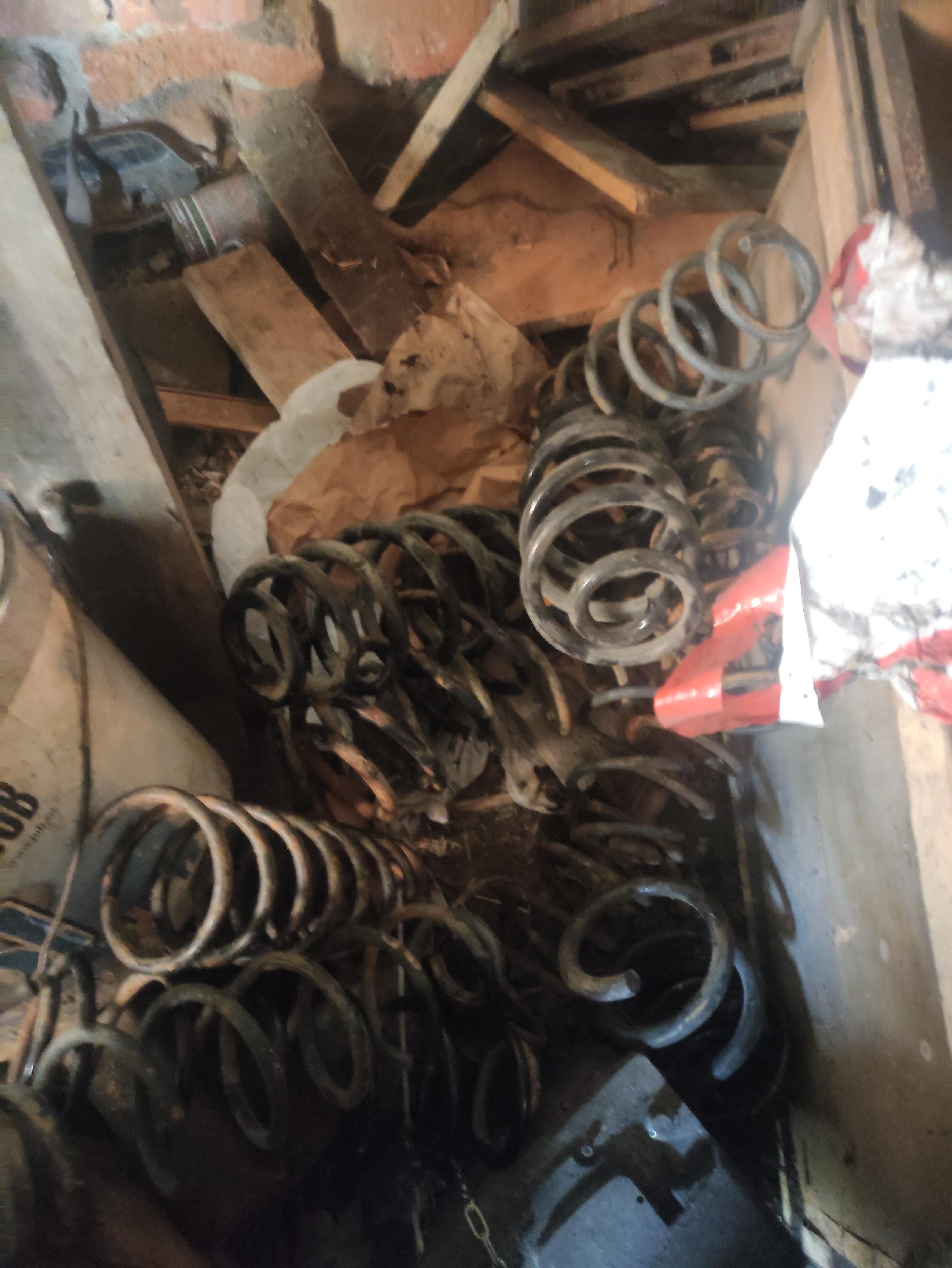

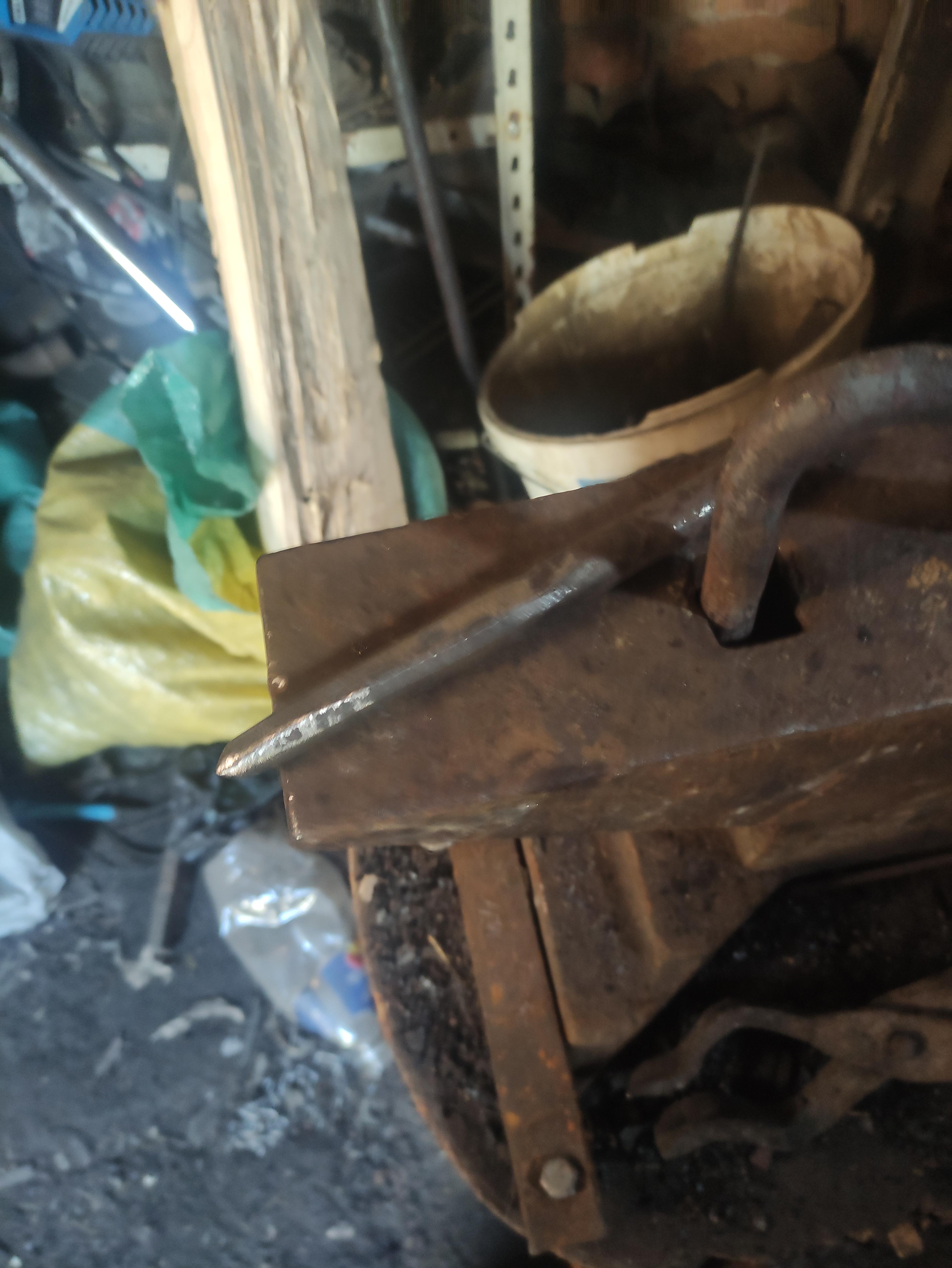

The easiest way I have found to straighten coil spring is with a post vice,scrolling wrench and bending forks of the right size. Coil springs make great chisels, hot and cold, punches, drifts, center punches.
 WEll i think that depend of thicknes of coil spring, some coil spring maybe in my case wich is 1/2 inch in diameter deserve hammer treatment.
  • Replies 17.1k
  • Views 2.2m
For beginner bladesmiths I suggest cutting down the side of the coil, (or both) to get a bunch of ( ( ( ( ( ( ( ( ( ( pieces that are all the same alloy so you can make a lot of test pieces and learn the forging and heat treat temps and break the finished blades to learn what you did right and what you did wrong.

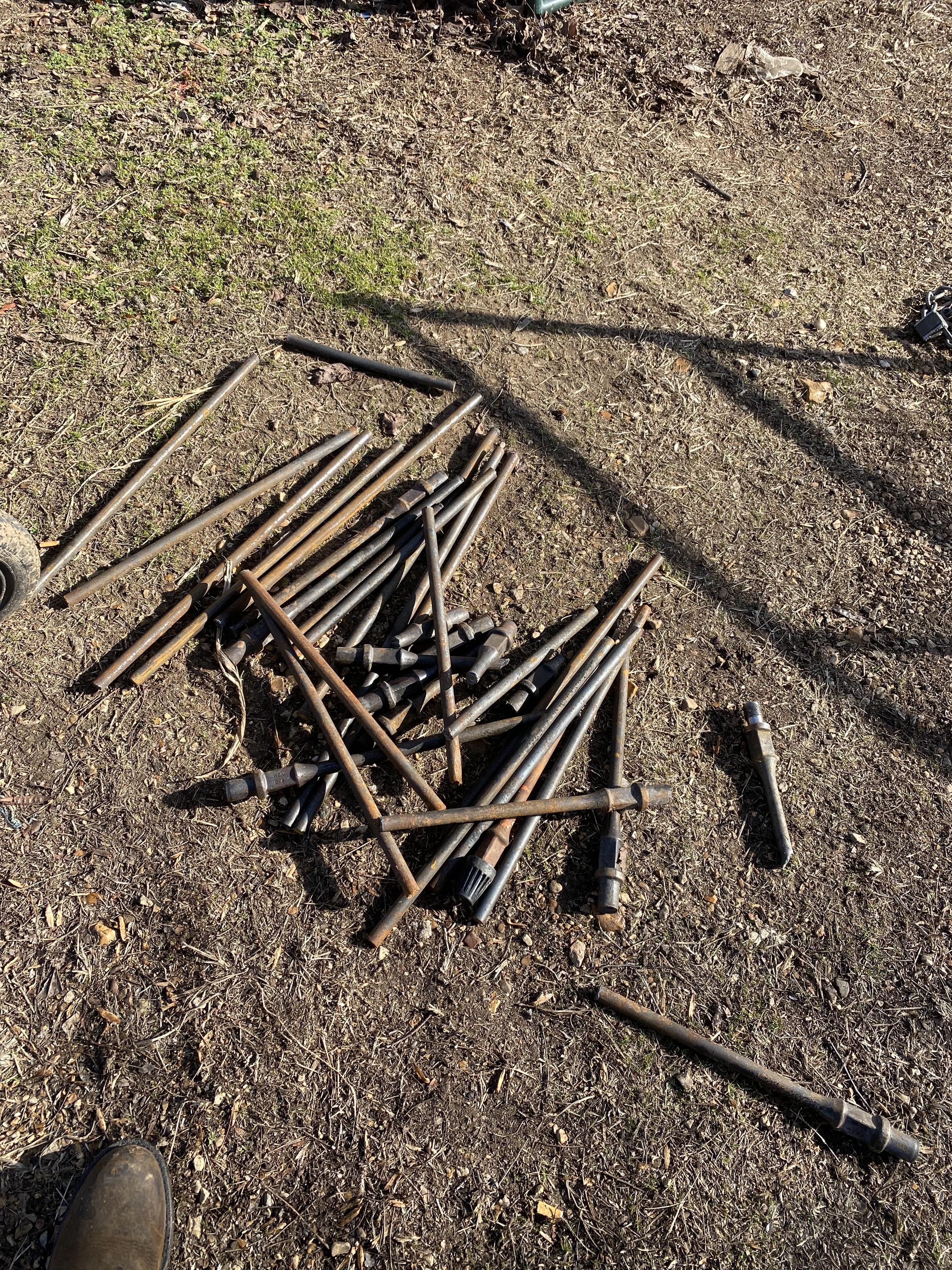

A welder I know, who builds a lot of corals and fence stopped by the shop an visited and gave me a pile of sucker rod ends and cut offs 1-2 foot lengths
I always love when hardenable steel shows up on my doorstep.
Great haul Twisted
thanks y’all, I’ve already got piles of sucker rod around but it’s hard to turn down more when it shows up,

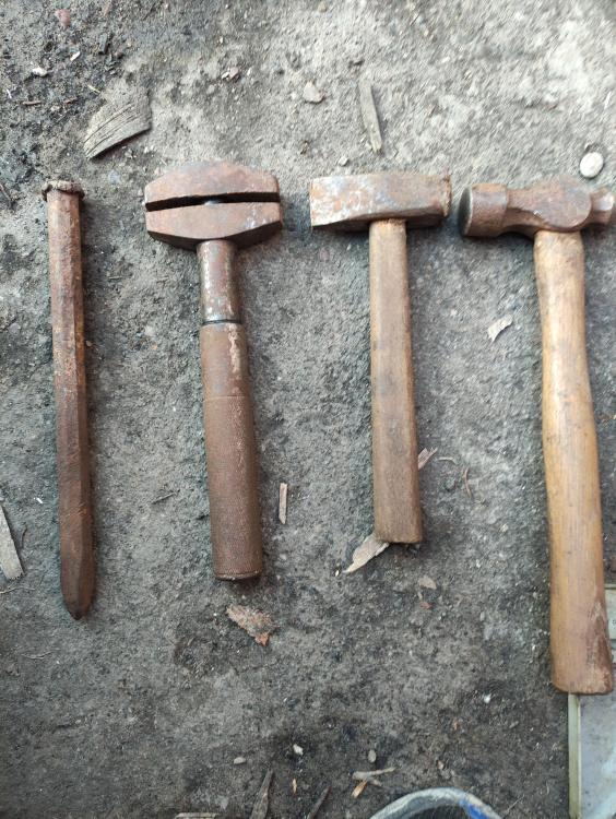

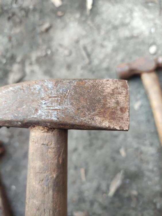

Ian wondering this hatchet shaped hammer was it chip off or is it like some fuller
If I weld leaf spring to it and make it like hot cut will I ruin it , o think that one part is broke it does not have cuting edge
I think the hammer with the vertical edge may be a mason's hammer for chipping stone.  Just an educated  guess.
I'd have to bet it's a mason's hammer too.
I agree that it is probably a mason’s hammer. I would recommend grinding the narrow edge round and using it as a top fuller.
I doubt that it is masonry  because there is some left traces from mushrooming of head .
Like someone pounded on it like striker
Just because someone used it that way doesn't mean that it was not originally designed as a mason's hammer.  I agree with John that the best use of it would be as a top fuller.
GNM
I remember seeing a tool like that with a shallow groove in its working edge being called a caulking tool, something used by folks who built boilers or other pressure vessels.  I think I have one in my pile that I've never used for anything.  I don't think a grooved working edge like that would hold up long on stone.

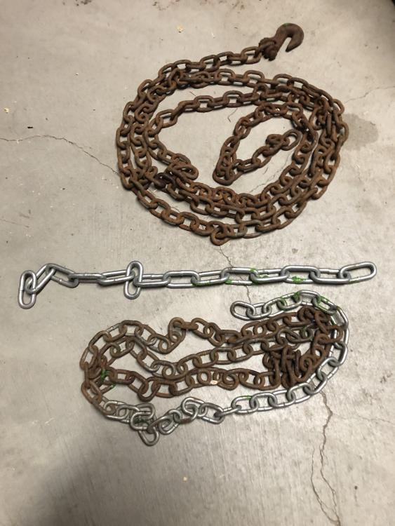

A while ago this chain followed me home. The top section is 7/16 diameter, the middle is 1/4 and the bottom is 5/16.
I know that I will have to move in a year, and was wondering if you think it is worth holding on to? Especially the small section. I can see the other sections being useful, stick it in the forge, put a finish on it and you have decorative chain. Thoughts?
Be wary of putting the 1/4” and 5/16” chains in your forge, they look plated with n your picture. They could be very useful and wouldn’t take up a bucket’s worth of space. I guess it all depends on how much you have to move, chain it not that hard to find.
Personally, I’d keep the non-plated chain. If you run into a time sensitive project where you need it, finding new chain without plating can be challenging.
Keep it fun,
David
I recommend not throwing any chain you didn't make yourself in the forge, galvanized chain can rust under the right conditions but the zinc is still there. The galvy can be stripped by soaking in diluted muriatic or acetic acid acid or for longer in vinegar.
Thank you for the warnings on zinc plating. I am very much aware of that because of this forum and all the warnings given! Thank you! Also, thank you for the justification to keep more stuff lol!
