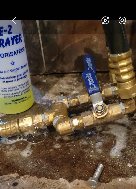

  The scariest moment in all of my welding careers was when an Acetylene bottle with a leaky fitting on the bottle side of the regulator caught fire.  I saw a reflection of it in my welding hood.  We were about 10 feet away and I smothered it with my welding glove.  I suppose it would need to be a massive leak to blow but it taught me a lesson, and I didn't even change the bottle out.  I tend to sniff connections nowadays.

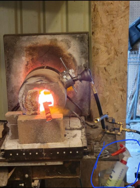

I'm able to have this at hand in my tiny shop and it's indispensable.... Sunlight and water
  Mix some dishwashing soap in that water helps. We didn't have that luxury in many of the rot holes I found myself working in.  :ph34r:  In retrospect, I could have brought my own spritz bottle in but got used to smelling.  Old habits.  I do use bubbly soap water and auditory clues for air leaks tho...  :)
We don’t know where it came from so I really have no idea what it’s intended purpose is lol. Plan on taking it regardless.
Oh it's "sunlight" dish soap with enough water that it'll spray.
Like I say I've got a small shop so it's easy to have it sitting there and since I'm always swapping around burners and forges I just spritz them before I spark up.

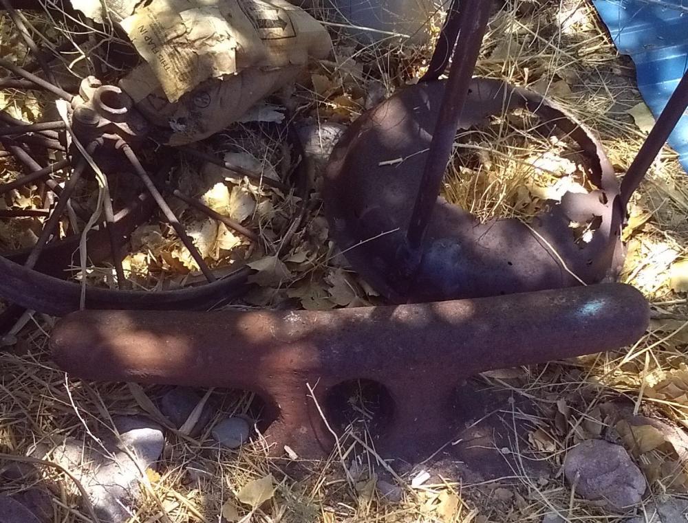

The cleat is 30" across the top---New Mexico doesn't have *any* water large enough for a vessel that would need something that large to moor to!
