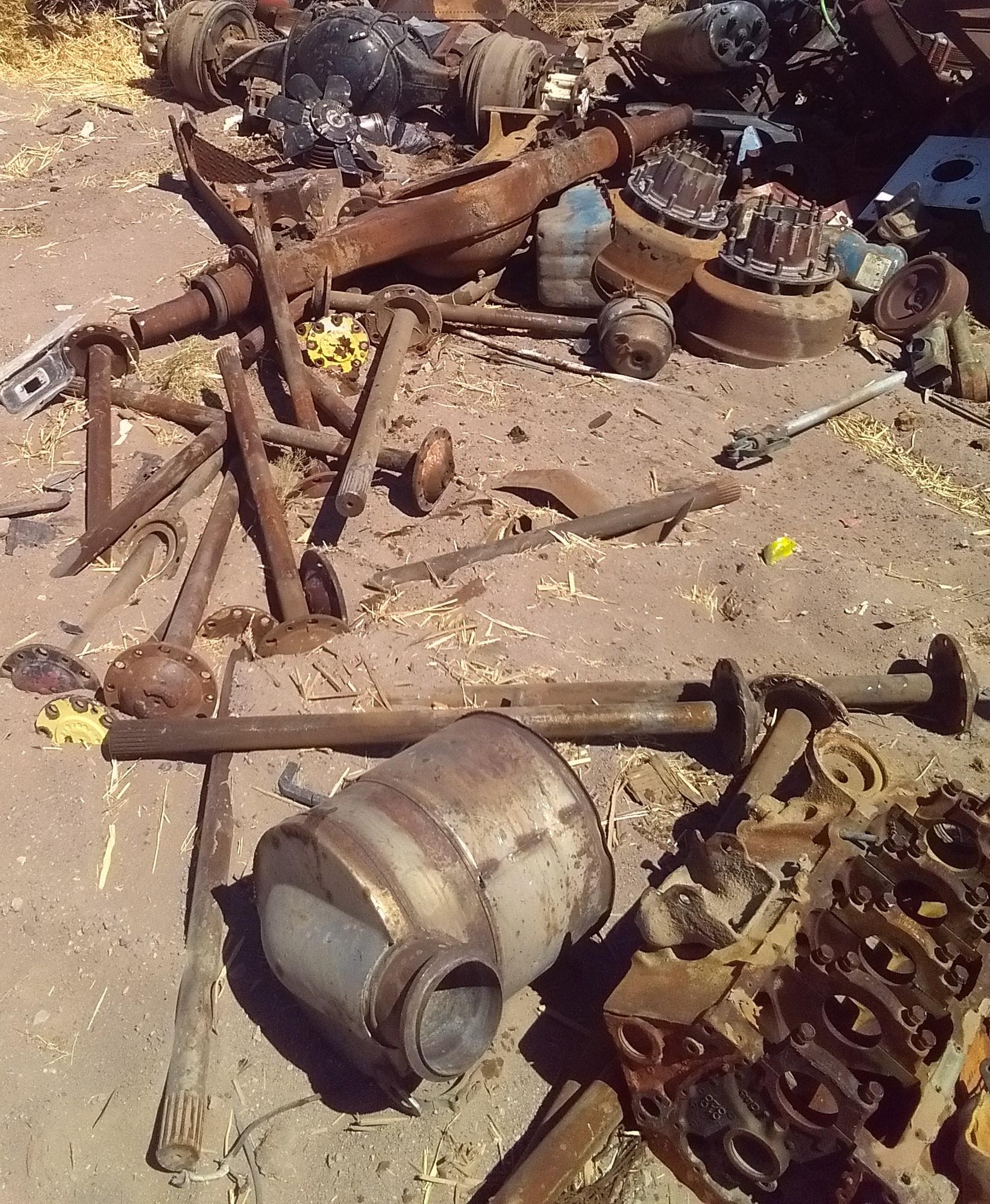

ThomasPowers Posted May 9, 2022 Share Posted May 9, 2022 Just remember not to put heavy stuff or long items in it behind the driver's seat---or passenger's seat if you have one! Blacksmith "en brochette" is NOT SUPPOSED TO BE ON THE MENU! Didn't follow me home as I have a couple already; but a pole of heavy truck axles suitable for hammer forging; generally around 1050 steel, (more were scattered around too!) Quote Link to comment Share on other sites More sharing options...

ThomasPowers Posted May 9, 2022 Share Posted May 9, 2022 Well I did take a large one and put it "to the side" for later perhaps... Quote Link to comment Share on other sites More sharing options...
Scott NC Posted May 9, 2022 Share Posted May 9, 2022 Goes without saying.... Quote Link to comment Share on other sites More sharing options...
ThomasPowers Posted May 9, 2022 Share Posted May 9, 2022 I would have cleaned them out but I don't have a way to cut stock that large easily. Quote Link to comment Share on other sites More sharing options...
TWISTEDWILLOW Posted May 9, 2022 Share Posted May 9, 2022 Thomas, I know someone who got one of those harbor freight metal band saws on sale and he ordered better blades for it and then replaced a few of the cheaper made parts with better stuff, An to my surprise he’s been cutting2”- 3” solid stock with it pretty easy, I see those for sale barely used on Craigslist occasionally for cheap, Quote Link to comment Share on other sites More sharing options...
Frosty Posted May 10, 2022 Share Posted May 10, 2022 I cut axle with my Jet, horizontal, vertical band saw without trouble. Brush the dirt and grit off first nothing dulls a bandsaw blade like dirt. Frosty The Lucky. Quote Link to comment Share on other sites More sharing options...
JHCC Posted May 10, 2022 Share Posted May 10, 2022 I've cut 2-1/2" 4140 shaft material on my little Craftsman horizontal bandsaw. Indeed, my last couple of Quad-State visits were financed in part by selling 3- and 4-pound chunks that I'd cut up thus. Quote Link to comment Share on other sites More sharing options...
TWISTEDWILLOW Posted May 10, 2022 Share Posted May 10, 2022 John, just ask your wife for a (education grant) to pay for your next trip! she’s gotta big ol company now!!! and might need the tax breaks! Quote Link to comment Share on other sites More sharing options...
ThomasPowers Posted May 11, 2022 Share Posted May 11, 2022 Well money is tight right now as I just found out that shipping some parts to LG is going to cost as much as getting them reworked! One of the downsides of rural living. As is finding tools locally that are not in the scrapyard. They would sure make nice hammer blanks. Some are larger than any axles I have seen outside of RR stuff. I may toss a couple more to the side when I go on Saturday... Quote Link to comment Share on other sites More sharing options...

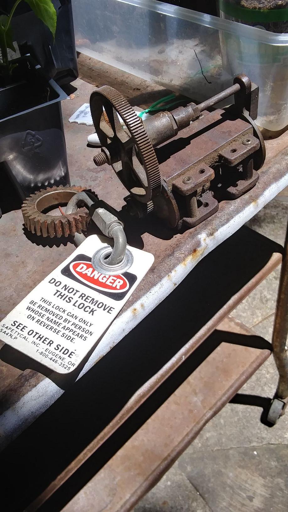

Scott NC Posted May 12, 2022 Share Posted May 12, 2022 I got a brain for my sculpture in the mail. Thanks Billy. Oh and a lockout tag so I can hang my lock on the power switch. There may be high voltage issues.... Quote Link to comment Share on other sites More sharing options...
TWISTEDWILLOW Posted May 12, 2022 Share Posted May 12, 2022 Lol, your welcome Scott! I thought the lockout tag would complement the electric brain! Quote Link to comment Share on other sites More sharing options...
Frosty Posted May 12, 2022 Share Posted May 12, 2022 Electric BRAIN it's that super science stuff! Frosty The Lucky. Quote Link to comment Share on other sites More sharing options...
Scott NC Posted May 12, 2022 Share Posted May 12, 2022 Where's Bill Nye when you need him? With only 2 moving brain parts I imagine it will be kind of slow. Still wouldn't want it tipping over on somebody and frying them with it's Jacobs Ladder. Or blasting them with magneto sparks. That lock n tag go on the power switch.... Quote Link to comment Share on other sites More sharing options...

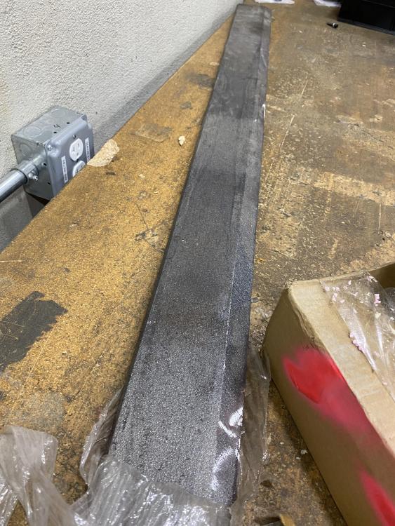

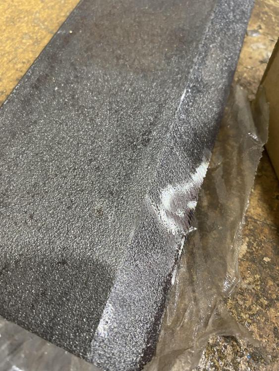

Pat Masterson Posted May 12, 2022 Share Posted May 12, 2022 My next big purchase is oxy propane or oxy acetylene set up. I’ve got this huge piece that looks like a blade of some sort that might follow me home from work. My boss said I can take it but it looks strange. The finish makes it look like it’s some kind of casting or something but I would think if it is a blade it would be some kind good heat treatable steel but I’ve never seen a finish like this. What do you guys think it might be? Quote Link to comment Share on other sites More sharing options...
Scott NC Posted May 12, 2022 Share Posted May 12, 2022 What's your boss say it is? Was it laying out back? By all accounts take it.... Quote Link to comment Share on other sites More sharing options...
TWISTEDWILLOW Posted May 12, 2022 Share Posted May 12, 2022 Is it some kinda break blade for putting bends in something? I’d take it home anyways since it’s free, then do a spark test on it, if it turns out to be cast iron then throw it in the scrap trailer and add a little weight to your next run! Lol Quote Link to comment Share on other sites More sharing options...
JHCC Posted May 12, 2022 Share Posted May 12, 2022 Definitely do a spark test. You can also do a drill test: steel produces shavings, while cast iron produces powder. 30 minutes ago, TWISTEDWILLOW said: some kinda break blade for putting bends in something? No, those are almost always ground to very precise dimensions. They're good steel if you get your hands on one, though: usually 4140 or thereabouts, good for anvil tools and the like. Quote Link to comment Share on other sites More sharing options...
