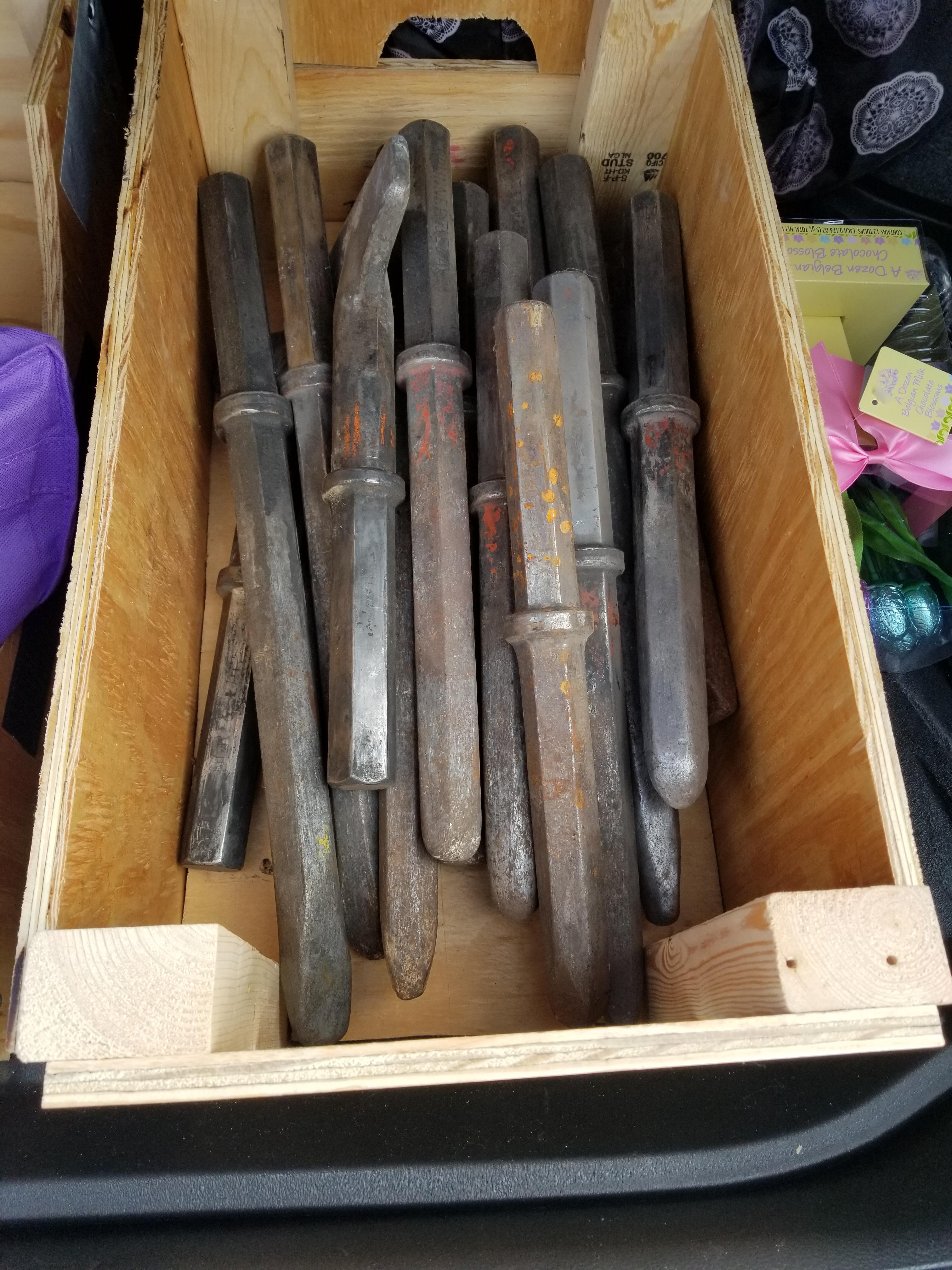

After some back-and-forth I finally met the owner of an equipment rental place and made off with some of their unusable breaker bits.  If I had the time and skills I'd look at sharpening some and see what he'd be willing to pay for re-pointing the worn ones he has (the heat treating requirement is what keeps me from looking into it further).  Something like 18-20 bits here, I gave him $20 and a bottle opener.
Those make awesome hardy tools. Square up the shank below the collar, and shape above to the collar to what you need. Also good for small hammers.
My favorite hardy was made from the broken off tip of a jackhammer bit. It had the wedge shaped tip already and all I needed to do was to forge down the broken shaft to fit into a 1" hardy hole---and then forge it down a bit more so I can remove it from a 7/8" hardy hole that college students couldn't tell was colour coded for a different hardy...  No heat treat but normalization on it for my use.
The stuff you've listed is why I've been hunting for 'em, JHCC.  It would figure I finally get these after buying a few feet of 1.25" Hex 1045. :rolleyes:
STASH, all of the manufacturers of diamond saw blades told me they use 4140 for the body.
Well my phone won't take a picture. It says not enough memory, but I did find an internet picture of the Whitney 20-1 punch I bought for $4 at the yard sale. And it appears the punches and dies I found in box of misc go to the Whitney.
Thanks Biggun- that's about what I was figuring. I was speculating with the guy I bought them from, he was shooting for 1040-1050ish.
