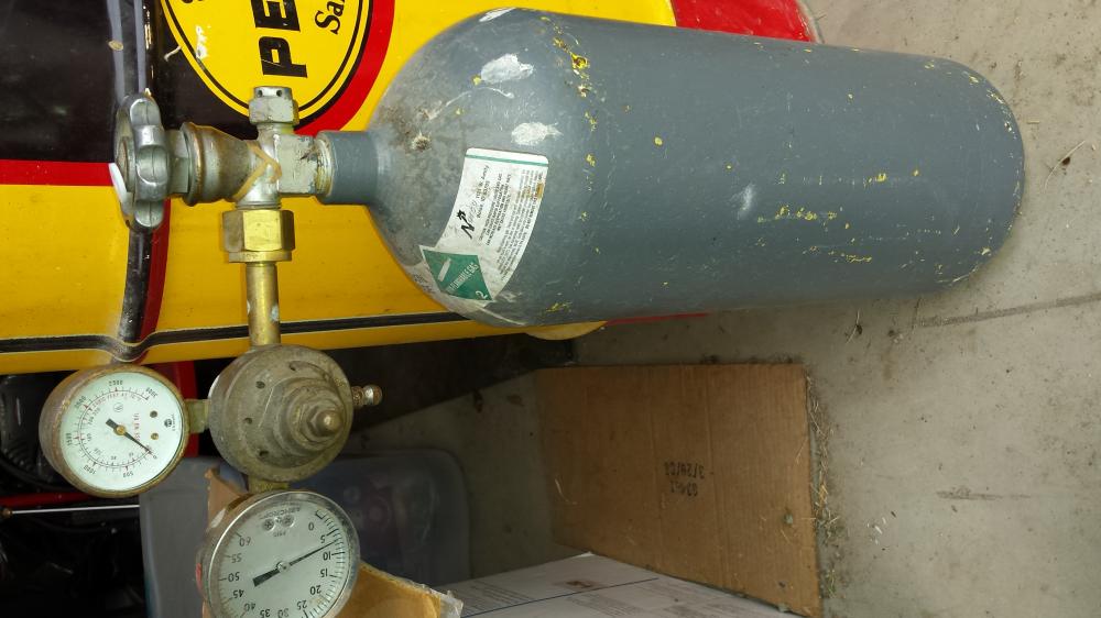

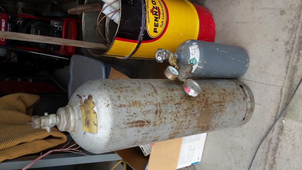

I picked up these bottles at a yard sale, not until I arrived home did I notice that one bottle has a sticker  with "Anhydrous Ammonia" on it.
I Have googled it and it don't look good... I was thinking of making a bell of it...
The little one is a C02.. $20 for both. The photos were rotated sideways without my permission
Anhydrous ammonia is basically fertilizer
​That's true, ... sort of, ... it's used to "bond" Nitrogen in the soil, so that it's available to root systems.
But a little bottle like the one pictured, was most likely used to charge Ammonia based Refrigeration Systems.
Around this area, some of the older Dairies still use Ammonia Systems, ... although they're very dangerous, ... due to the poisonous nature of the Ammonia Gas.
Before and during WWII, ... my Grandfather had an "Ice Plant" in Brunswick, Maryland, ... that used am Ammonia Refrigeration System, ... powered by a Rex Buckeye, diesel, "hit & miss" engine.
( That engine ran the Refrigeration Compressor, ... a DC Generator for lights, ... and furnished Domestic Hot Water to the living quarters adjacent to the Plant.
My Dad can't remember the horsepower of the "Buckeye", ... but claims the flywheels were 7' tall. )
Being quite familiar with Ammonia Refrigeration, ... at a time when many "Tech People" were "away" in the Military, ... He was often called upon to repair Ammonia Systems for Dairies, Breweries and Meat Packers, ... in a 5 State area.
Edited by SmoothBore
When I first stared working in refrigeration it was on a 400 ton ammonia(R717) plant it can be dangers stuff. Its boiling point is -28F at atmospheric its somewhat flammable and can be explosive with the right air mix a small amount may burn, damage the eyes and cause loss of consciousness so be careful !Note that applies to ammonia refrigeration don`t know if Anhydrous is any safer.
Edited by stan
I am going to find the right threaded fitting for the opening run copper tubing some distance away and open the valve, I haven't even opened the valve yet...
the threads look good, there are many farms in the area, including mine. but it is rather small for any type of fertilizing application.
Thank you all for your valuable input, I will proceed with caution.
