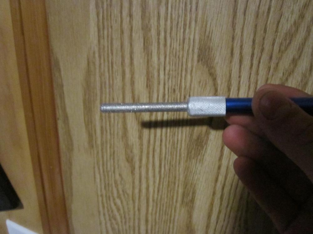

gmbobnick Posted March 12, 2022 Share Posted March 12, 2022 My latest blade looks like…well, a Frito corn chip. But I want to try carving spoons. Quote Link to comment Share on other sites More sharing options...
Daswulf Posted March 12, 2022 Share Posted March 12, 2022 Nice! I've wondered how to sharpen these and how sharp you make them before forging the curve. Quote Link to comment Share on other sites More sharing options...
gmbobnick Posted March 12, 2022 Share Posted March 12, 2022 I got the edge butter knife thin, flat on one side and beveled both ways on the other. Then rolled it flat side out. It was 1084 steel. After figuring out what color wouldn’t stick to a magnet, I danced it around the edge of the burner blast until it was even color then quenched. Just work the flat side on flat sandpaper to sharpen. Learning as I go. But so far seems good. Quote Link to comment Share on other sites More sharing options...
M.J.Lampert Posted March 12, 2022 Share Posted March 12, 2022 this is what my father uses to sharpen his oval hoof knife not sure were one can buy these though. its a Dimond sharpener that has a angled and a rounded section M.J.Lampert Quote Link to comment Share on other sites More sharing options...
Frosty Posted March 12, 2022 Share Posted March 12, 2022 Round ceramic sharpening rods AKA Crock sticks, etc. work a treat on hook knives. Just the rods not the wood stand and sticks as shown. I used to carry a diamond sharping stick similar the one above back packing and sharpened everything with it. It was too fine to be really good on a hatchet but loved sharpening my old (1964 birthday present from Dad) Buck knife. Frosty The Lucky. Quote Link to comment Share on other sites More sharing options...
SHC Posted March 12, 2022 Share Posted March 12, 2022 I’ve got a folding sharpener from DMT, it’s great. Folds up and opens like a balisong, with the diamond sharpening “stone” concealed within the handles. It seems they’ve started making them with pointy rods now! Not sure when that happened but it wasn’t available when I got mine. I usually keep mine in my work truck for touching up tools on the job. Frosty, I’ve got a couple of old Buck knives from the mid 70’s. One is a 124 I believe, the bigger bowie style they made back then. My dad gave it to me. My uncle (younger than my dad) cut grass and saved up the money and bought it for him as a graduation gift when he graduated high school. He passed it on to me when I graduated. I carried it in Iraq and it saved my butt when I had to poke a feller with it. The other is a Buck 110 I picked up CHEAP, practically for a steal, in a sportsman’s consignment shop. Their policy was that after 45 days an item gets discounted. Each additional 30 days results in another discount percentage. This one had been sitting in a case overlooked for quite some time. I paid six dollars for it. Original leather sheath and factory edge. My opinion on them, mid century was the best era for Buck. I like their new stuff, but they just don’t seem as tough as the old ones. Quote Link to comment Share on other sites More sharing options...
