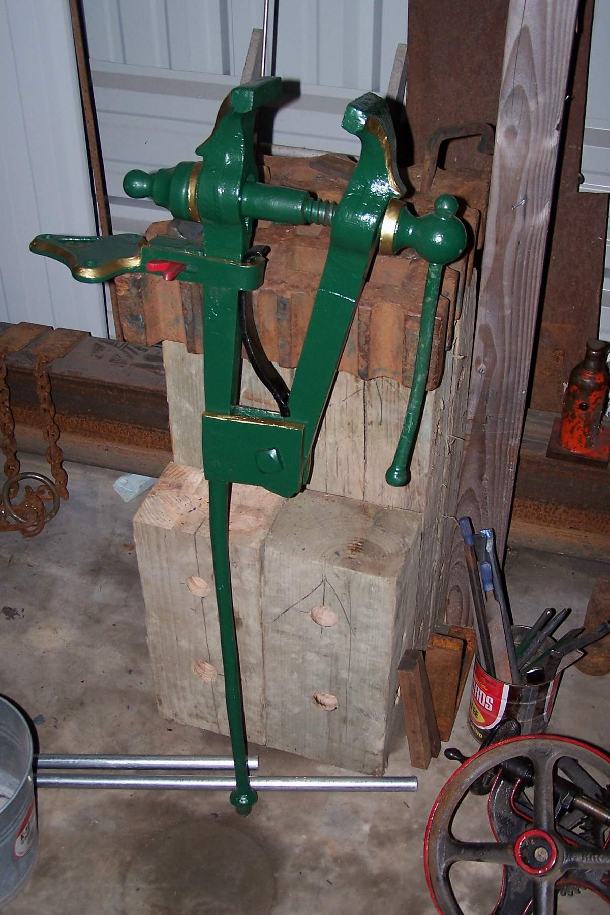

A leg vise spring is one of the easiest repair parts to make, all a leg vise needs is something to tip the mobile jaw past the tipping point and it'll open itself. Do you have the mounting plate, bail and wedges? IF that is that is how yours mounts.
When I made mine I fretted over it for days and it only took an hour to make start to finish. The trickiest part was finding stock that fit inside the bail. Pulling the tabs and arcing it were EZ PZ. I spent more time making the wedges, red. Mine takes two wedges one from each direction and I paint components that bear watching red. Being the first I over arched the spring, it doesn't really need to push the jaw all the way open but it doesn't seem to hurt.
Your leg of vise look bend to much toward person operating vise.

Just because the leg isn't bent enough to effect anything, Nat. It's the light duty mobile vise in my shop, not a display piece. Green and gold are my shop colors and helps prevent my tools from growing legs and going home with someone else.

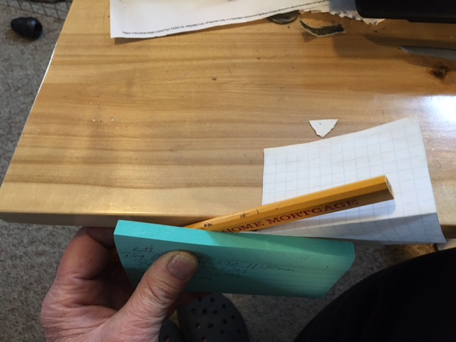

I'm with Don - also having trouble conceptualizing what Frosty is describing. I even tried it with paper.
Folded a 6" piece of paper in half to look like 1.5" x 1.5" angle iron. Then cut 6" off one side - at which point there's nothing left to 'separate from the rest' so I assumed you actually meant just shy of 6". So I cut just shy of 6" into one side and then cut 90* over - which indeed separated it from the rest. So I have a little piece of 0.75 x 5.75" paper and a piece of 'angle iron' paper with one side about 1/2 its original width with a little tab at the end of the original width.
Using my fingers to imagine the vice jaws, I tried various ways of clamping that piece of angle iron and none of them so far have resulted in a way that would allow a block (pencil in my case) to both clamp in the vice AND rest on the angle iron.
I WAS able to make it work by assuming you meant 90* BEND instead of cut (and still cutting just shy of the full length).
So I made a 4.5"long paper angle iron. Cut a strip about 4" along the length of one side, then bent that 4" strip down. Then bent the tab up. Here's a pick in paper - with the 4" strip between my knees as it would be in the vice jaws:324951036_871197574153380_8770108634639357324_n.thumb.jpg.2acc94fde01d5885b901e5cfbdf68a4d.jpg
