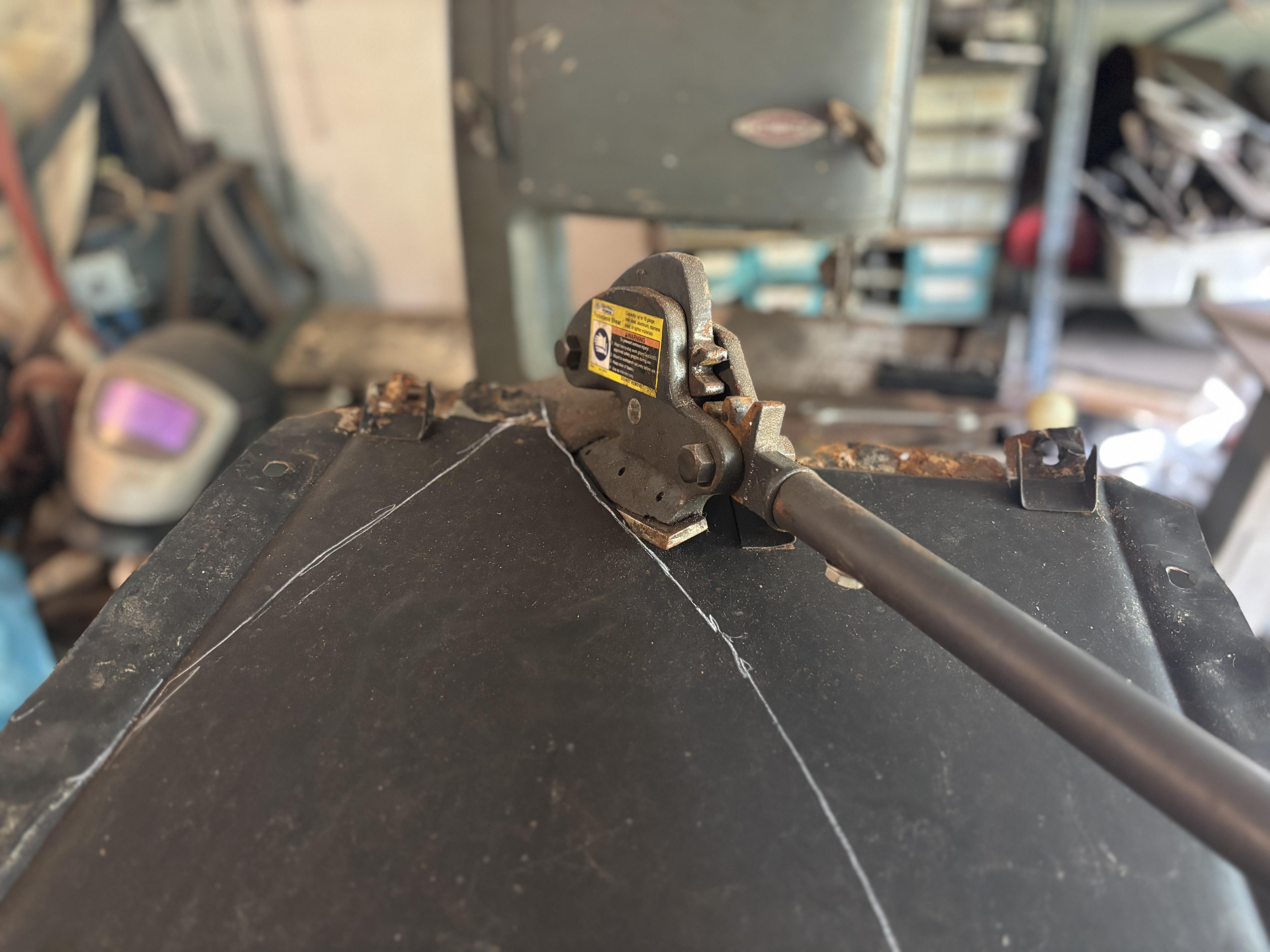

I started a sheet metal work for the body of the flamingo. Gotta love a throatless shear.

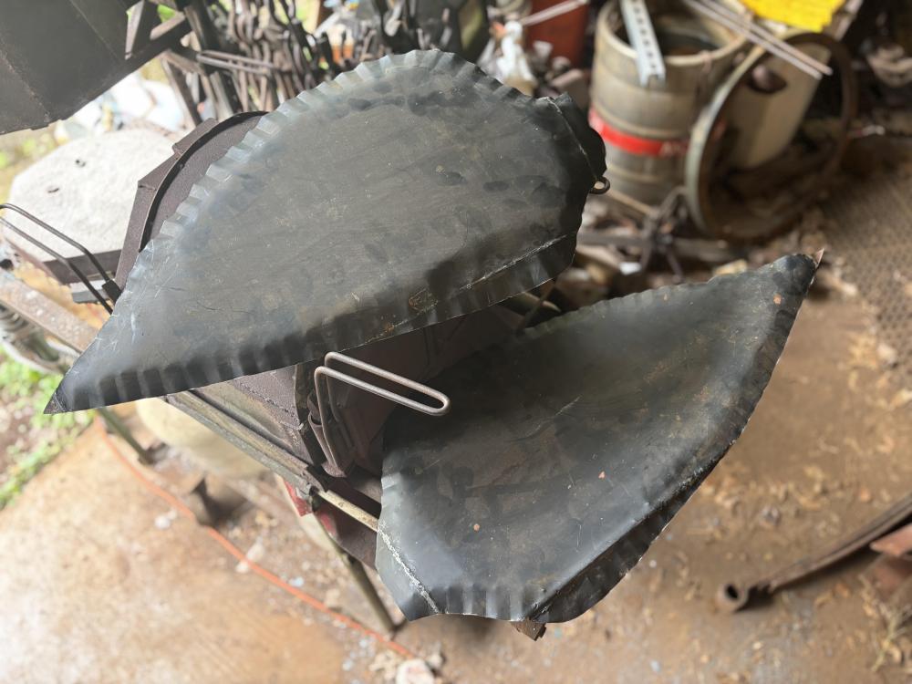

 And by some miracle, my tucking fork was where I left it sometime last year.
 Which helped greatly with the initial shaping:

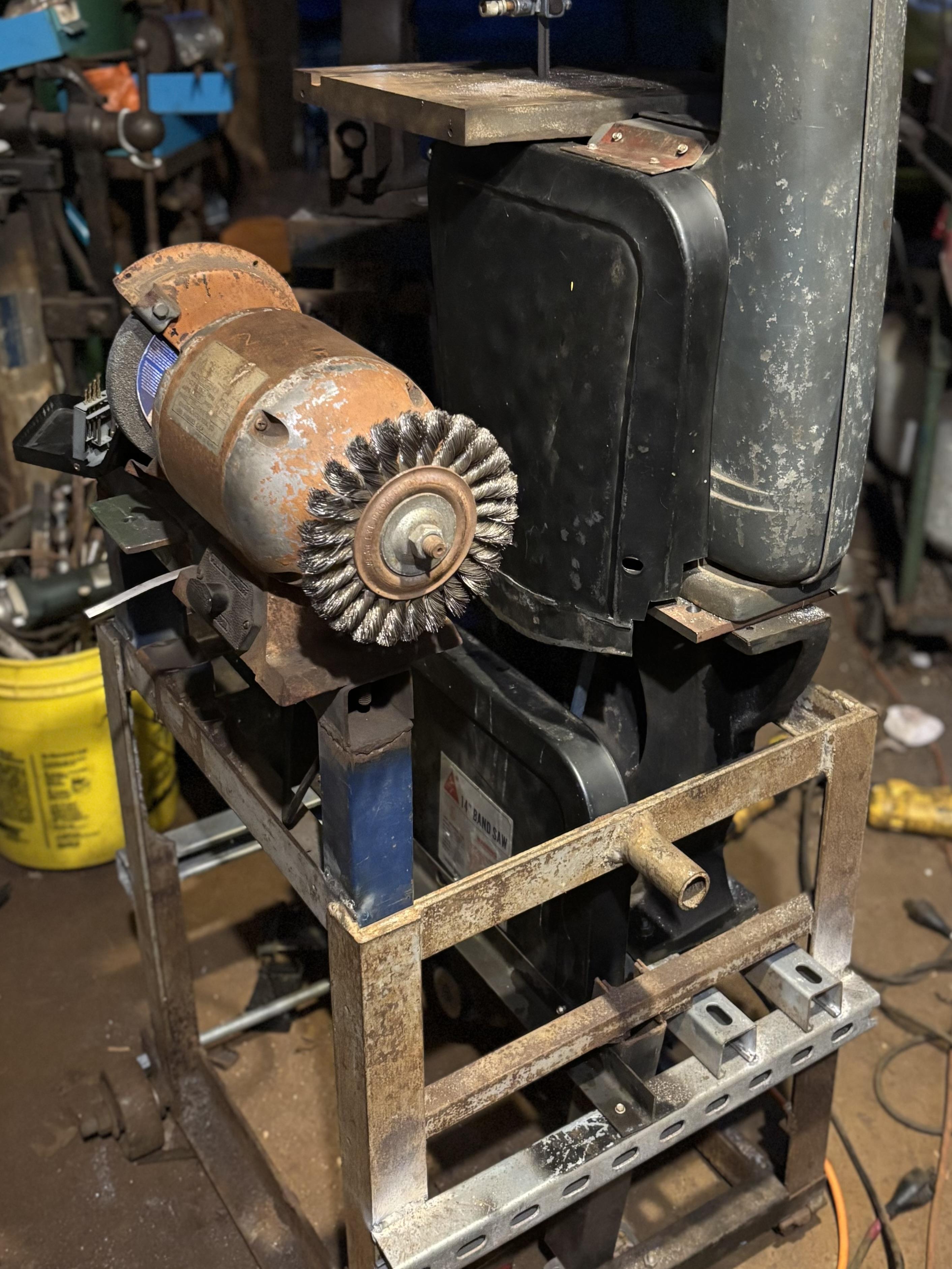

Also reattached my bench grinder and its support to the back of the base of my metal cutting bandsaw.
You can see that old wheel covers from the cannibalized bandsaw worked very nicely for covering the belts and pulleys, shielding them from grinder dust.

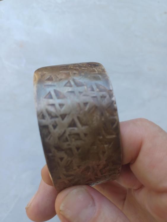

I make textured hand hammers for jewelry making.
Not sure how you make yours, but I take old hammers and use nail polish to make designs and then use dilute nitric acid to dissolve out every thing that isn't protected by the nail polish. I'm guessing you have a lot more labor into yours than I do.
That’s a clever idea. Might have to give it a try.

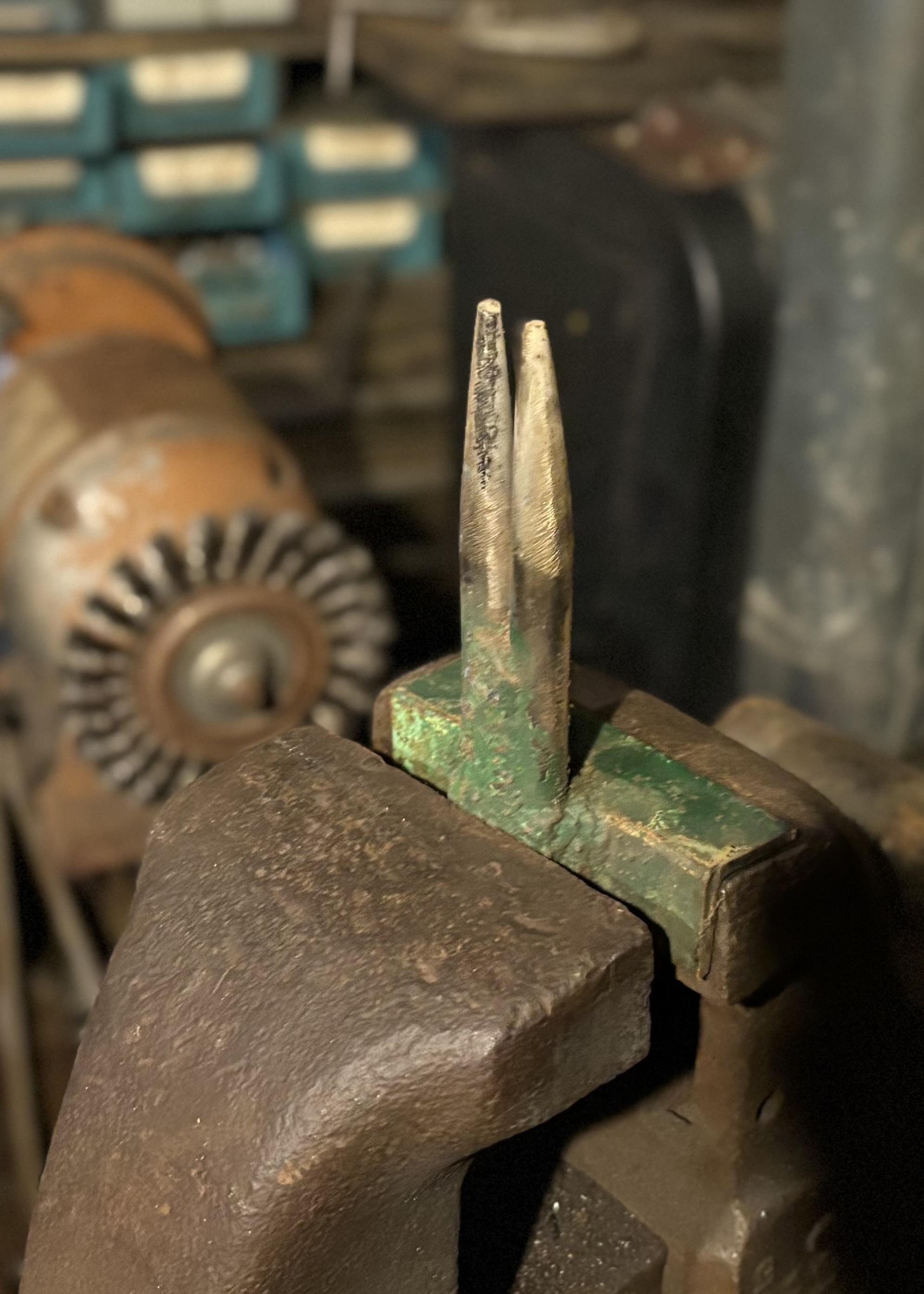

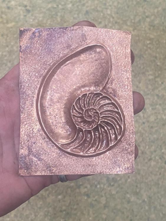

Along the same lines, here are some repoussé texturing tools I made by heating the end of the stock and hammering it against an appealingly rough spot on my garage floor:

 Nice dies Billy, cool tools John and love the texture Florida man - that is how I feel about it anyway

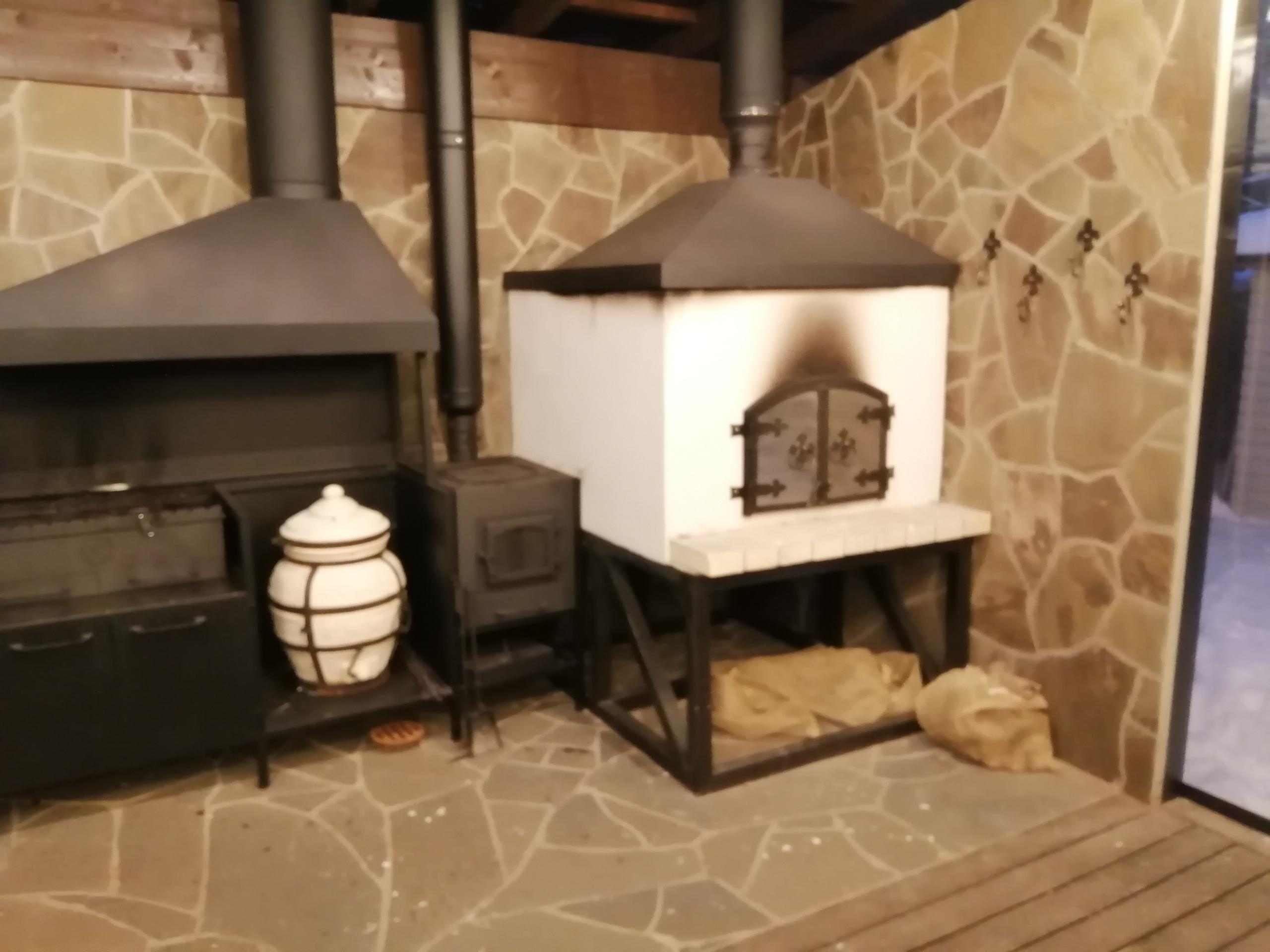

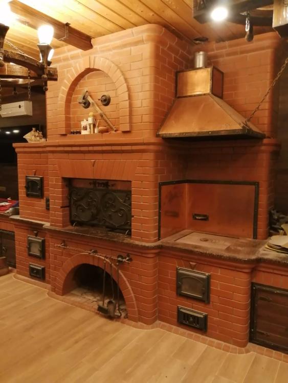

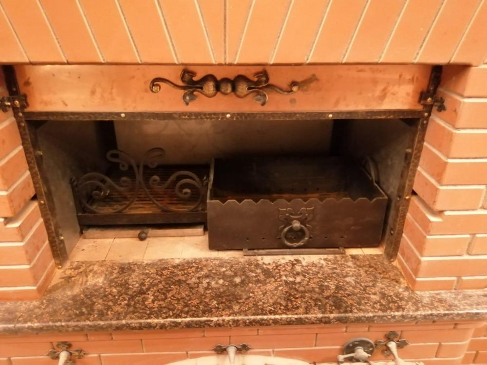

Alex, are the pictures of the stove doors as installed in the commissioner's kitchen? These are replacing solid iron or steel doors, yes?
On 7/18/2025 at 8:40 AM, Frosty said:
Uhhh, Alex. The term Cat House is another way of saying house of ill repute over here. Not that we don't know what you mean but it's still kind of funny. :lol:

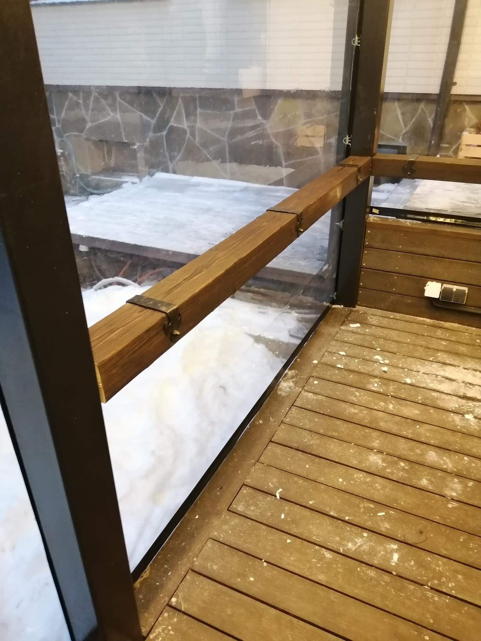

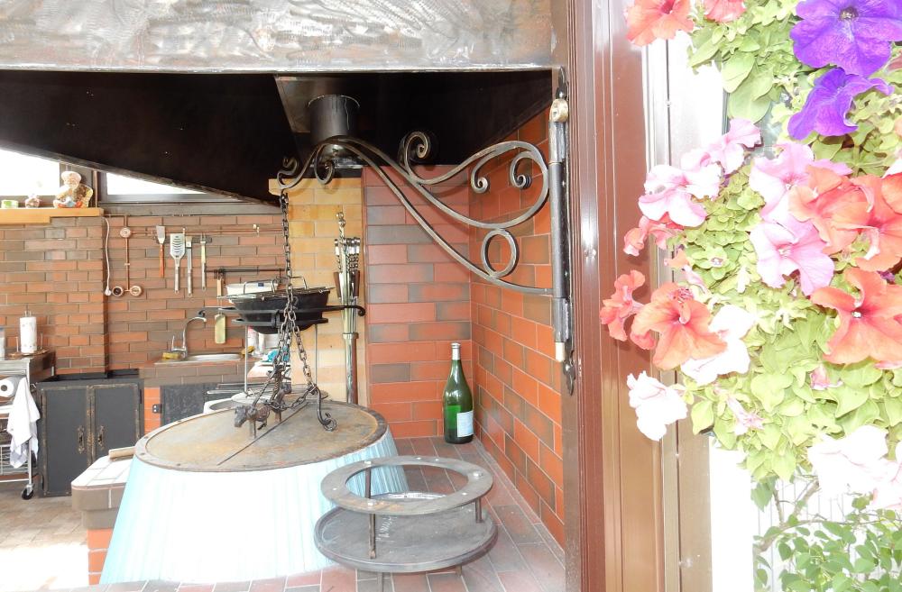

This is a gazebo with a cooking area. Many of us make these now. Yes, this is a house for cats. Inside there is a heater, rugs, a surveillance camera and lots of food.
On 7/18/2025 at 10:37 AM, BillyBones said:
Is an out house the same thing in Russia as it is here? A toilet?
Yes)))

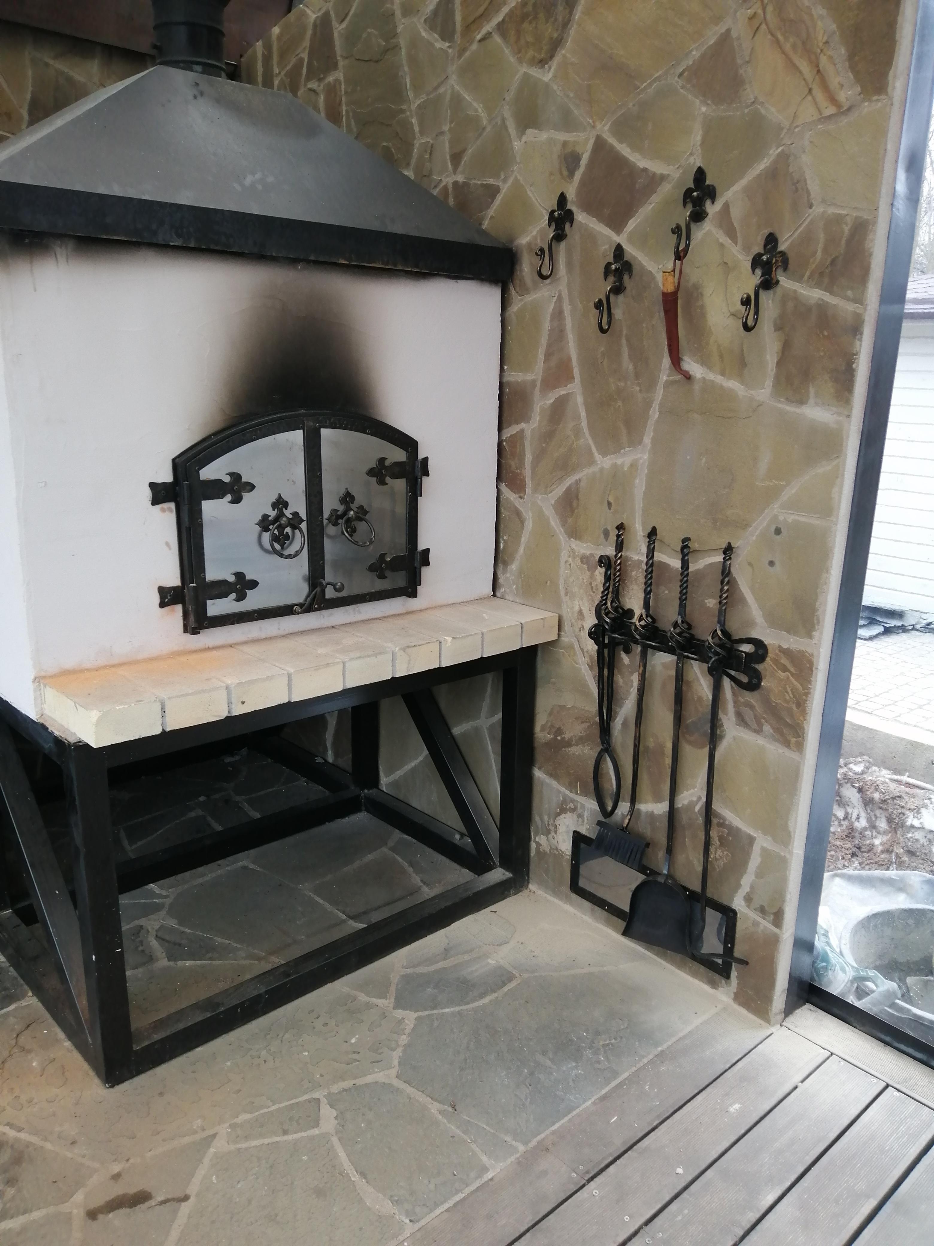

In the pic of the oven doors i see off to the right what looks to be a set of log tongs. Can i assume that you made the fire set as well? Like to see a pic of those.
My fireplace set and doors and wooden beams.
On 7/18/2025 at 3:41 PM, MeltedSocks said:
And it goes without saying, outstanding work!
Thank you !:)
You've shown us pictures of your gazebo before and I'm still as envious now as then. Thomas Powers would've loved this kind of stove. Heck I wouldn't be surprised if he had one or more. He called it "down hearth" cooking, basically cooking in a fireplace hearth.
Thanks for another look Alex.

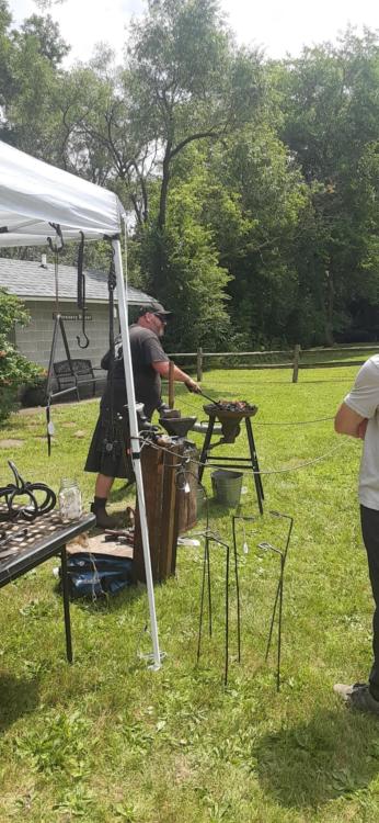

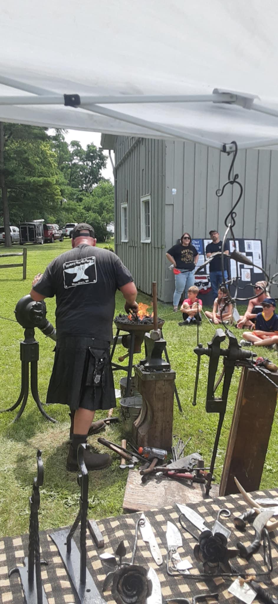

Had a demo today at the local historical park.   Great day,  really busy, and had better than expected sales.  They had civil war reenactors there and they made their way over to me.   Asked if I could do boot plates.  My reaction was,  what are these, do you have an example.  Hooked them up and they are going to be contacting me for more.   If you don't know what they are like I didn't, they are basically horseshoes for old boots.  Other than that I made a couple spike knives when the crowd got big for something loud and flashy.  I didn't get any pictures of the crowd but I'm about to go buy chairs.
Btw, I didn't understand the kilt thing until I got one a week ago.  Today it a as hot but with the breeze, I didn't have to worry about swamp butt.
