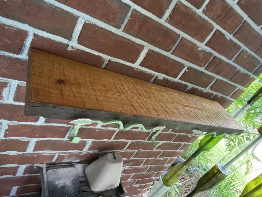

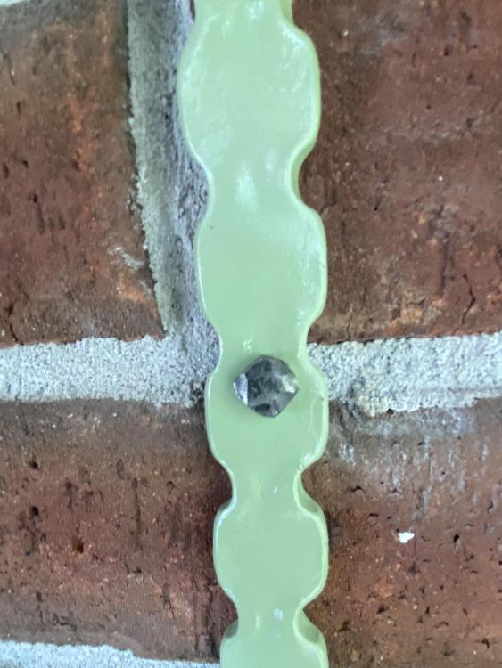

I made a bolster with holes of diameter 3/16", 1/4", 5/16", and 3/8" in the middle.  I left one spot for future use.  After making this tool, I converted 1/4" hex head lag bolts into square head.  They turned out okay.  I need to get one of those "As Seen On TV" sockets with all the spring loaded pins that will fit odd shapes, because it took a while doing quarter turns with an adjustable wrench on a 2-1/2" lag bolt.  Still need to paint the square heads, but otherwise, it's ready for succulents.

Blacksmith Bolt & Rivet Supply sells 8-point socket sets for square-headed bolts.
(Photo credit: company website)
And now I'm wondering if one could make an 8-pointed mandrel around which to reforge standard sockets...
(Old ones without plating, of course.)
You can also buy square sockets. Some of the machines i run have square head bolts. You could also weld a bar into the business end of a socket, put a "T" on the end and use the drive end to turn the bolts. That is how we make 1/4" and 3/8" T-handles for making adjustments on those machines.
Not to mention drain plug sockets are both internal and external square.

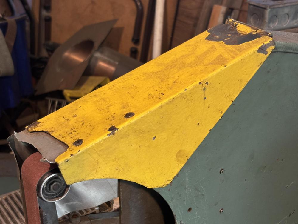

The Square Wheel grinder I picked up the other day was missing the knob that holds the side door shut. This meant that I needed to keep the upper guard down, in order to keep that door in place.
So, I made a replacement from one of the knobs from the cannibalized bandsaw:
This allows me to flip up the guard if I want to do any slack-belt grinding:
Which works perfectly!
(I also removed the “WOOD CUTTING” label from the side of the table. It applied to its parent bandsaw, but not to the grinder.)

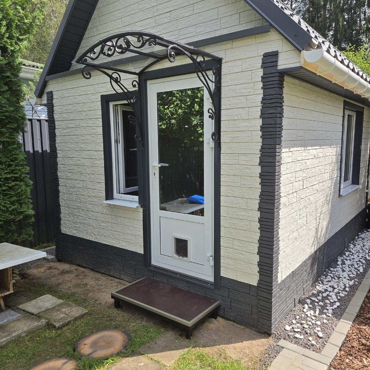

The week was very busy. Packed and sent. Coped alone. Made new doors with glass on the stove. The owner of the house likes to cook in it, wants to watch the process without opening the door. Installed a canopy on the cat house. The rich owner of the house loves animals. Feeds homeless cats.

I love the canopy over the cat house door.
Uhhh, Alex. The term Cat House is another way of saying house of ill repute over here. Not that we don't know what you mean but it's still kind of funny. :lol:

My wife would get along with him. She also feeds the homeless cats. That is a heck of a cat house, best we do is some boxes and cubbies in the barn filled with straw.
I did a kitchen and bathroom remodel for a couple who ran a cat rescue in their home.  Dozens upon dozens of cats and litter boxes.  They tiled every square inch of that house, including the first four feet up the walls due to the spraying and marking.  The stench was awful.  Had it not been during one of those "famine" times (from the phrase "feast or famine"), I would have turned and walked out when I came for the consultation.  But, I was hungry.
When I did the demolition, I found cat urine running down the backside of all the upper cabinets, on the backside of the countertop backsplash, down the back of the base cabinets, and even inside the cabinets.  It was making my eyes water. The next day, I rubbed Vic's Vapor Rub inside the face piece of a charcoal respirator and all in my mustache and beard.  That's the only way I could tolerate such a hazardous dump site. I was well past caring about offending them.
What shocked me more than the 100+ cats inside the house was the fact they had several outside utility buildings the size of what you posted that were also full of cats.
Those people had to have been mentally deranged.  Looking back, I guess I'm lucky that I only have an AirBnB on one side of my home and a veritable frat house (due to the partying) on the other side of me.
And it goes without saying, outstanding work!

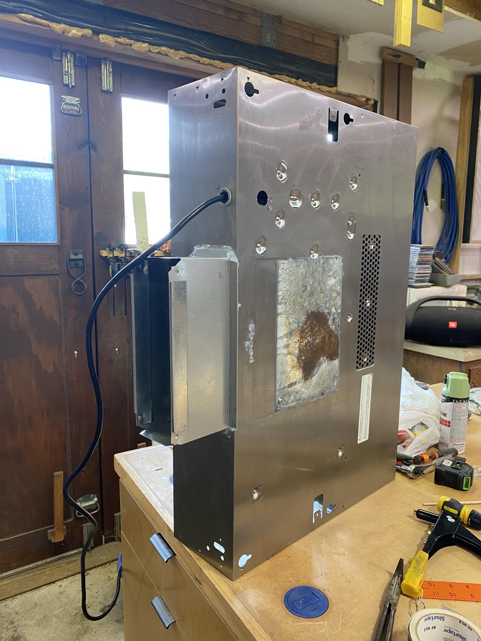

One of the nice things about being a kitchen remodeling guy is that I can snag some nice items that the homeowner doesn't want.  I got this practically new range hood and a heavy gauge, large single bowl deep stainless steel sink.
I'm in the process of installing the hood above my welding table.  It will exhaust straight out the back.  So, instead of opening all the doors and windows to this hot, humid weather to do a bit of welding, all I have to do is crack a window and turn this vent on.  It'll be a little higher than I'd like, unless I decide to extend the cabinet downward, and it is off-center due to the stud, and that will forever bug me, but I'll get over that.

I know what you mean about kitchen remodels socks. I fabricated and install corian countertops for a decade until corian fell out fashion with the rich folk here in Windsor and John's island. I snagged a nice downdraft from an expensive cooktop. I built a laminar flow hood with it. The best part was the wiring was perfect for plug and play with a normal duplex outlet with a selector switch with 3 speeds.
