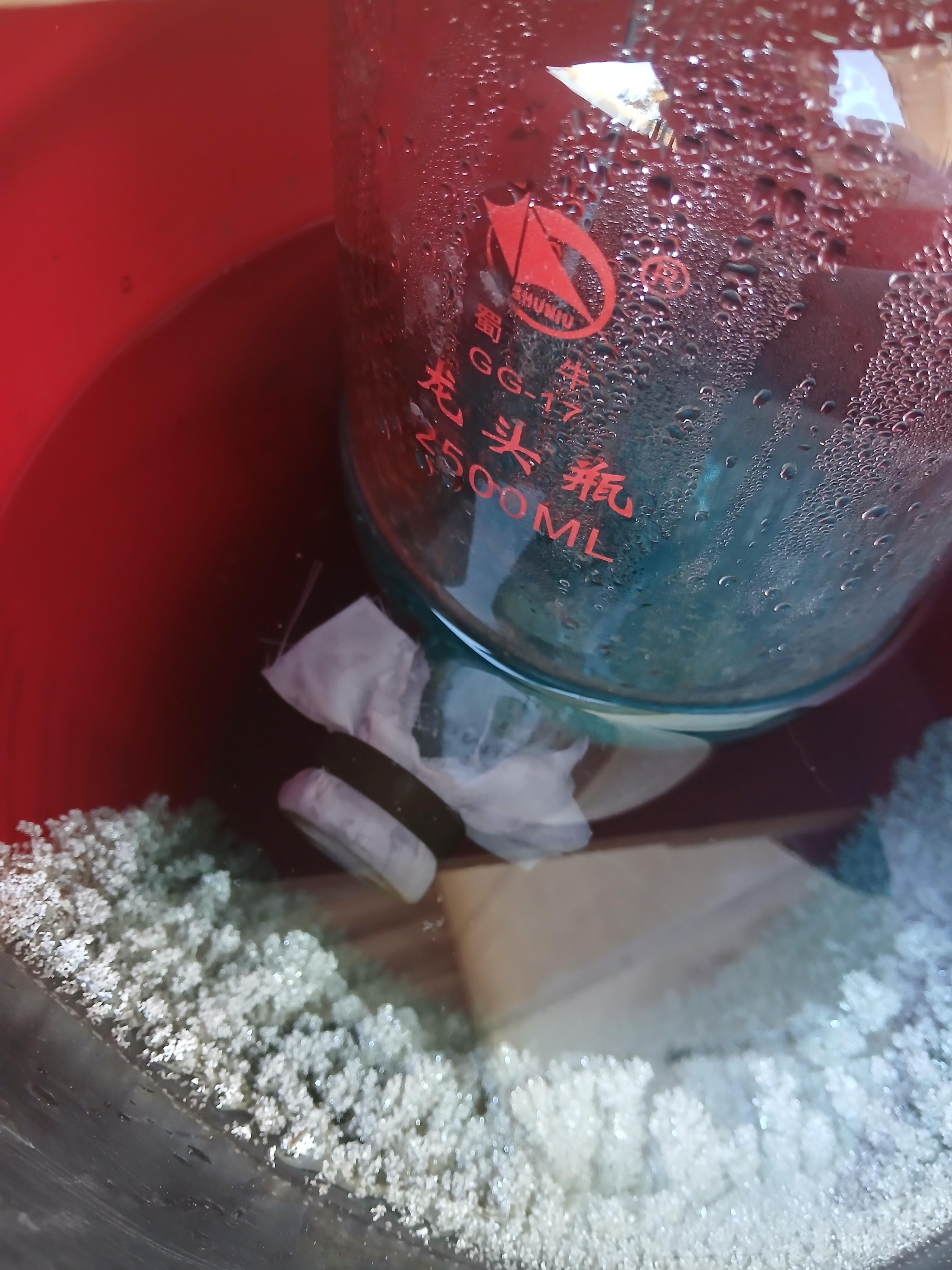

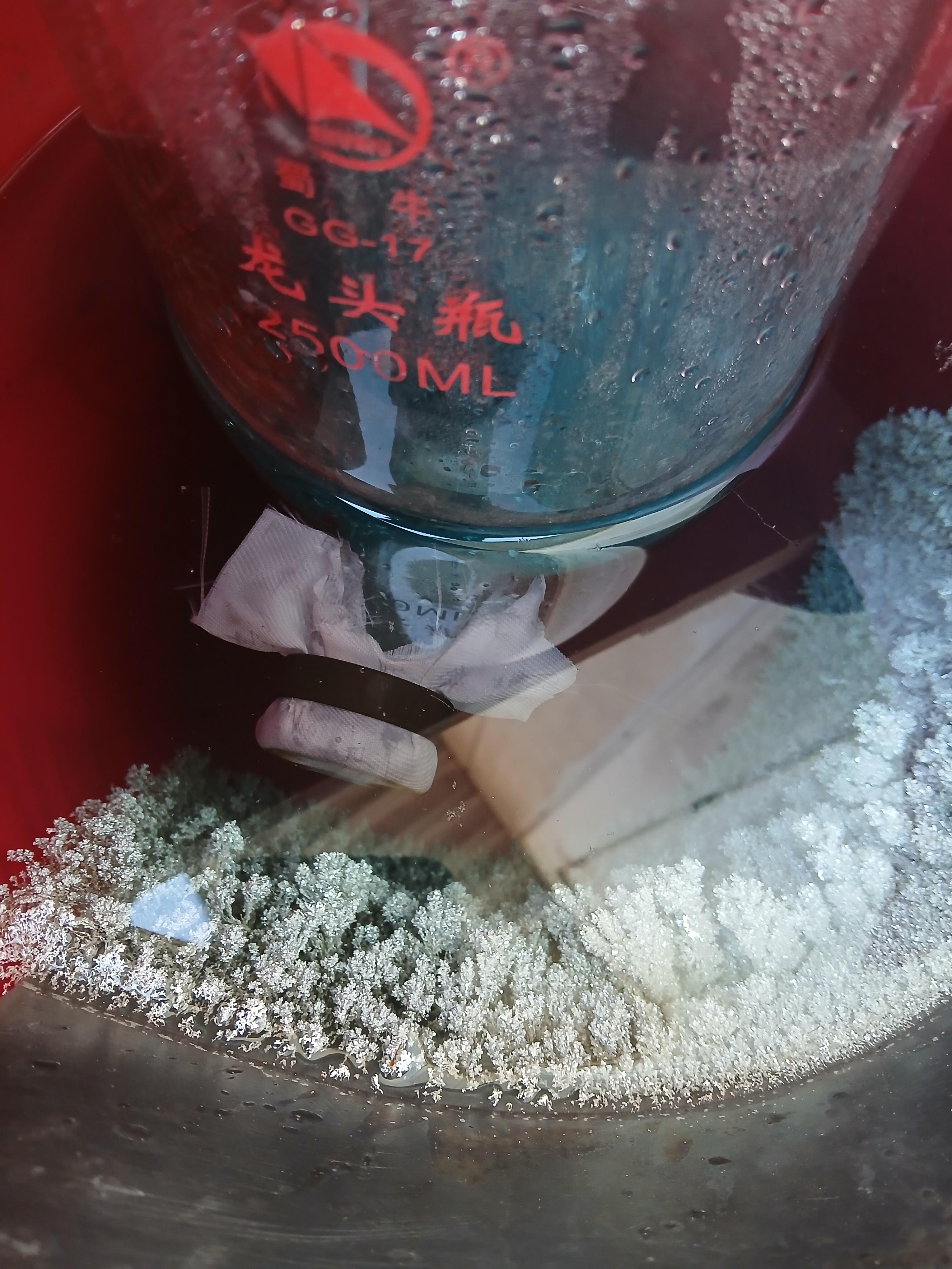

  9. It being almost a year since my first silver cell post and the price going crazy I figured I would update the group. Even if there isn't anyone interested. Spot silver at time of this post $116.55 usd per ozt. I built a much large silver cell capable of producing a lot more silver crystals before needing cleaned out. It is now a five gallon bucket and I am using a 2500ml reagent flask as my anode basket. It works so much better with a glass bottom to catch any sediment from falling down into the electrolyte. It has been running for two weeks at the time of these new photos. *almost two years

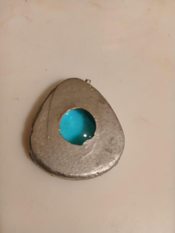

  10. I cast tin all the time. Tin is a low heat metal that will work great for this project. Your idea has merit. What is your tin source if you don't mind me asking? I like to use tin/pewter to cast metal around glass objects. I would just go for it. No one has really tried this before but I like it. My advice as someone who cast tin and pewter regularly is that tin will penetrate even the smallest of gaps. As long as you can keep it from freezing up in the mold. Tin melts at like 400f use a stainless steel pan or bowl to melt in. The most important thing is everything is dry and hot. You will want to take a small mapp torch or something to heat the mold before and during when you pour the metal to keep it from freezing up. The copper will act as heat sinks. I would pickel my copper if it needed it. (salt, vinegar, and a little heat) Worse case scenario (apart from the fire and molten metal) is you don't like it. Melt and try again. You can try a hundred times. Melt, reclaim the tin, pickel the copper, set up the mold and repeat until you are happy.
