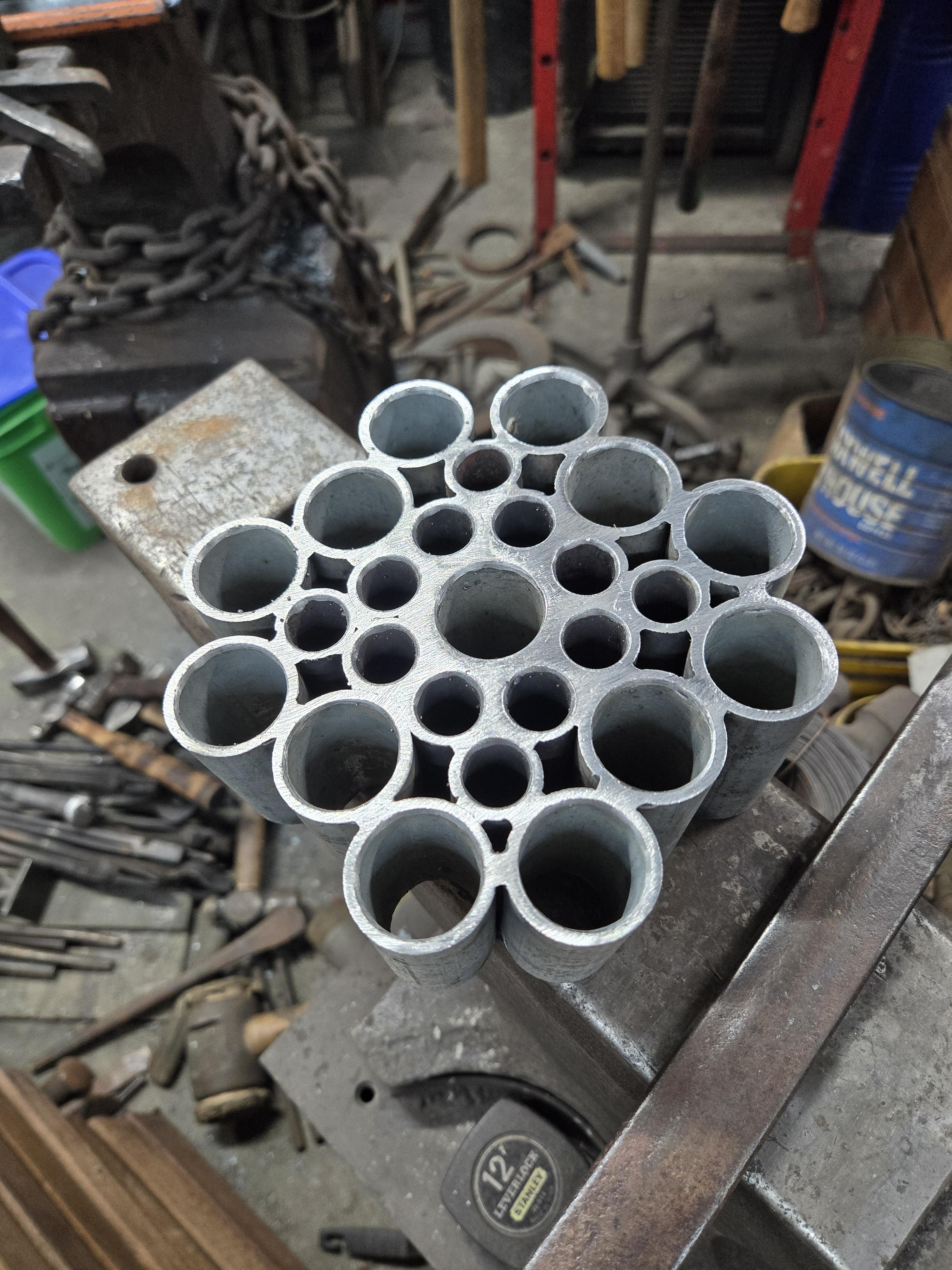

Other than a base or handle (if I add one) , got the punch chisel holder shaped out.
Not bad for something totally winged and random. It can hold all the shaping chisels and punches for a couple projects I have coming up.
That looks really nice Das! And do I remember reading that you were going to add extruded mesh as a base?
It's almost too pretty to put dirty old punches, chisels and stuff in Das. How about putting computer controlled colored LEDs in the tubes and use it for a light show?

I love that design Das! Now that you have made it, what do you think of this design from Scott Wadsworth, otherwise known as Essential Craftsman on YouTube?

Looks good to me. I once made a small table out of cut pipes for our swing bench on the deck that looked a little like it only smaller in diameter.

I have built a "Things Rack", similar to the above. I chose to use a piece of wood that the punch rests on at the bottom. I made mine at about 30 degrees from verticle, not solid tube to the wood at the bottom, leave an air gap for swarf and alligator bits, to fall to the Floor. If you mount the punch with the hammer end down, you can see what you are looking for. DO NOT ALLOW THE CURL ON THE HAMMER END BECOME A PROJECTILE. The pieces break off at the speed of a broken piece!! A flying piece can and will penetrate your Jeans and continue into the Meat Market. Hopefully not a neighbor kid!!
There are so many opinions on this topic. I like a rack, that can move close to where you are working and utilize the smallest floor print. No Trip Hazzzard!!!

Thanks Shain, yup it will get an extruded metal base so any crud can fall through but not the chisels.
Lol Frosty, I cleaned up my punches and chisels too.
Could do one with smaller chunks for sculpture either wall hanging or on a base. It would look neat with lights in it.
Will, I like that design as well. I wanted this one just for certain ones. I still have a bunch of others and a tree style like that would be nice.
IronDragon, that sounds like it would be nice. Cool idea.
Neil, good stuff. I keep my punches I use cleaned up on the ends. I have seen old ones mushroomed so bad the curls went around and back to the handle.  I still have a mountain of old punches and chisels I've picked up over the years to clean up and reshape.
Scott, a lazy Susan tool holder would be pretty cool for on a workbench near the vise.

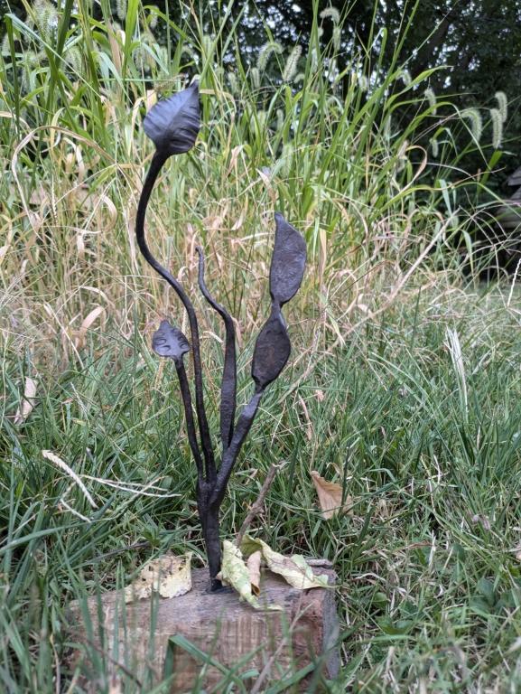

I finished another sculpture last night. This was an entry to a weekly blacksmithing challenge group I'm in on Facebook. The challenge was 4 separate elements forge welded together and then made into a sculpture.
This has two fold-over welds and my first go at a jump weld.
I forged a leaf on each end of a single bar then folded and welded. The next bar had organic shapes on each end then also folded and welded. You can't really tell in the picture but the end that looks like it's just a long tail actually has ridges textured into two sides.
I had multiple failures on my first evening of trying to jump weld to two folded-over welds together. I was given advice to use the post vice to squeeze it rather than hammering - as a jump weld of objects, especially of varying sizes, tends to slip/jump around. I had success with that technique and was able to finish tweaking and mounting. Definitely a good technique to keep in my back pocket.
Good job Shain. I don't recall hearing of using the vise to aid in a weld, but now I can keep that trick in mind.
I typically keep my punches around in a bucket tool bag organizer when I go out. Then just pull the ones I need and lay them where I can. This will help plus with them standing up I can more easily see which one I need.
It would be a good winter project.
If I'm doing a project involving a number of struck tools, chasing chisels, punches, etc. I have a 4" x 4" I drilled holes in at an angle at different depths so everything is visible. The ones in front stick out farther, layers slightly less so to the top so I don't have to reach through tools to reach what I want.
Using a vise rather than a hammer to weld is discussed in older blacksmithing books, "Art of Blacksmithing" is one IIRC. Another and I think better method is to squeeze the join with a pair of warmed tongs. Tongs don't draw heat nearly as fast as a vise and they're much faster to apply.
I have used the tong squeeze method many times when having trouble getting a weld to take. Dont even take it out of the fire, just stick the tongs in and give it a squeeze. This will get it it stuck good enough to refine the weld from there.
Tong squeeze was also suggested, and exactly as Billy outlined. For this project though, the pieces having wonky tops made it difficult to squeeze in the fire and ensure they stayed aligned correctly. If it had been two straight bars, no prob. I tried it all cold first and just couldn't get it to work with tongs so I switched to vice and it worked a dream. Sure, it sucked the heat out quick but I only needed it to set the weld. Once it was set, I repeated the welding heat and refined on the anvil.

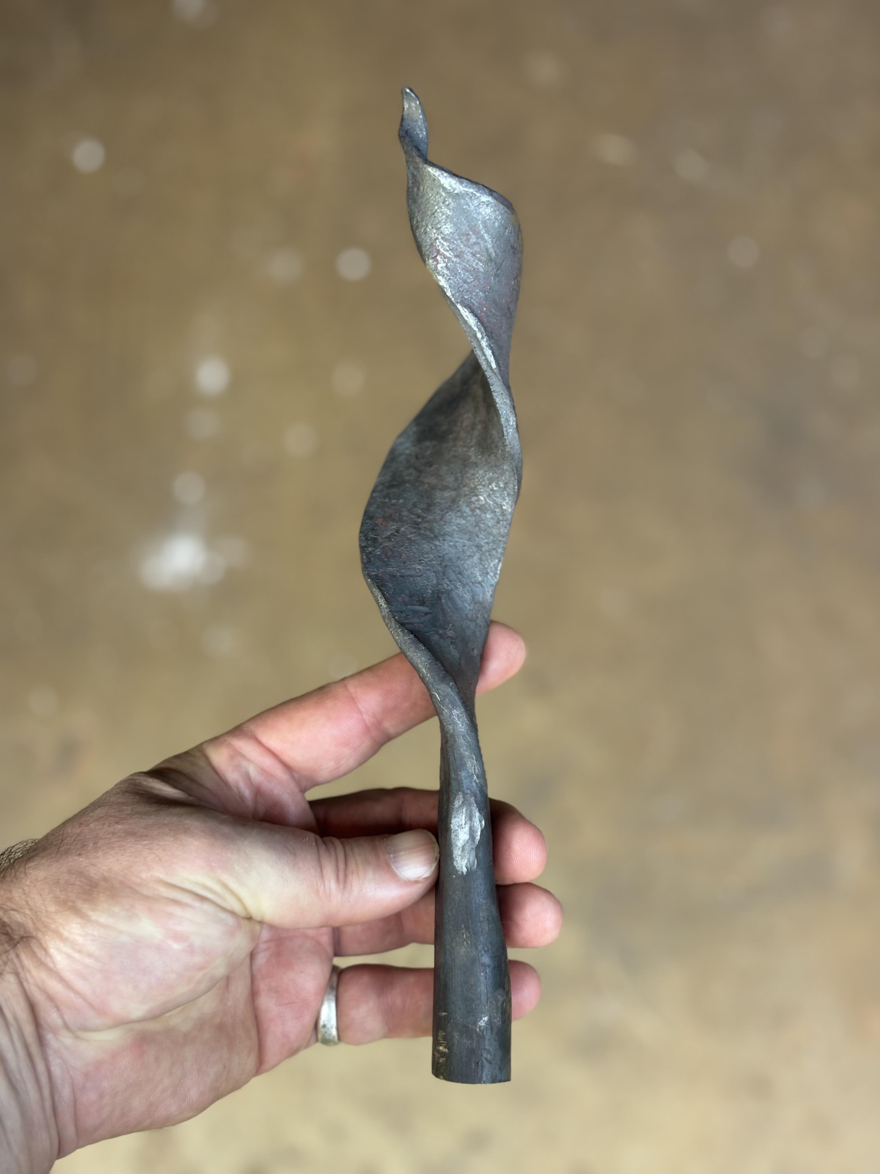

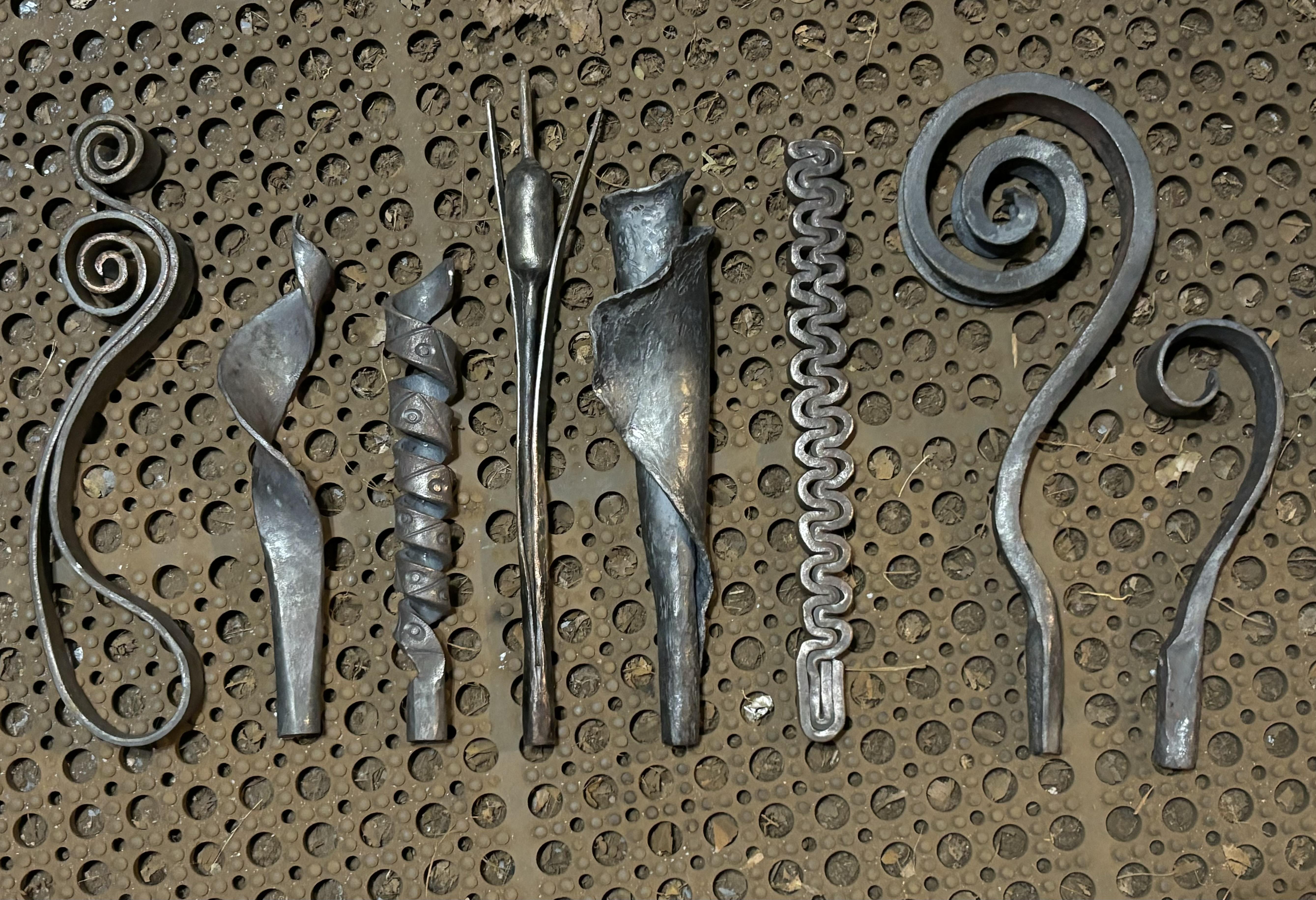

Made a couple more tap handles.
The story so far:
That's a pleasant set of shapes and textures. It would look cool on a bar tap setup.
They need two more for the bar and another two for the kegerator on the side.

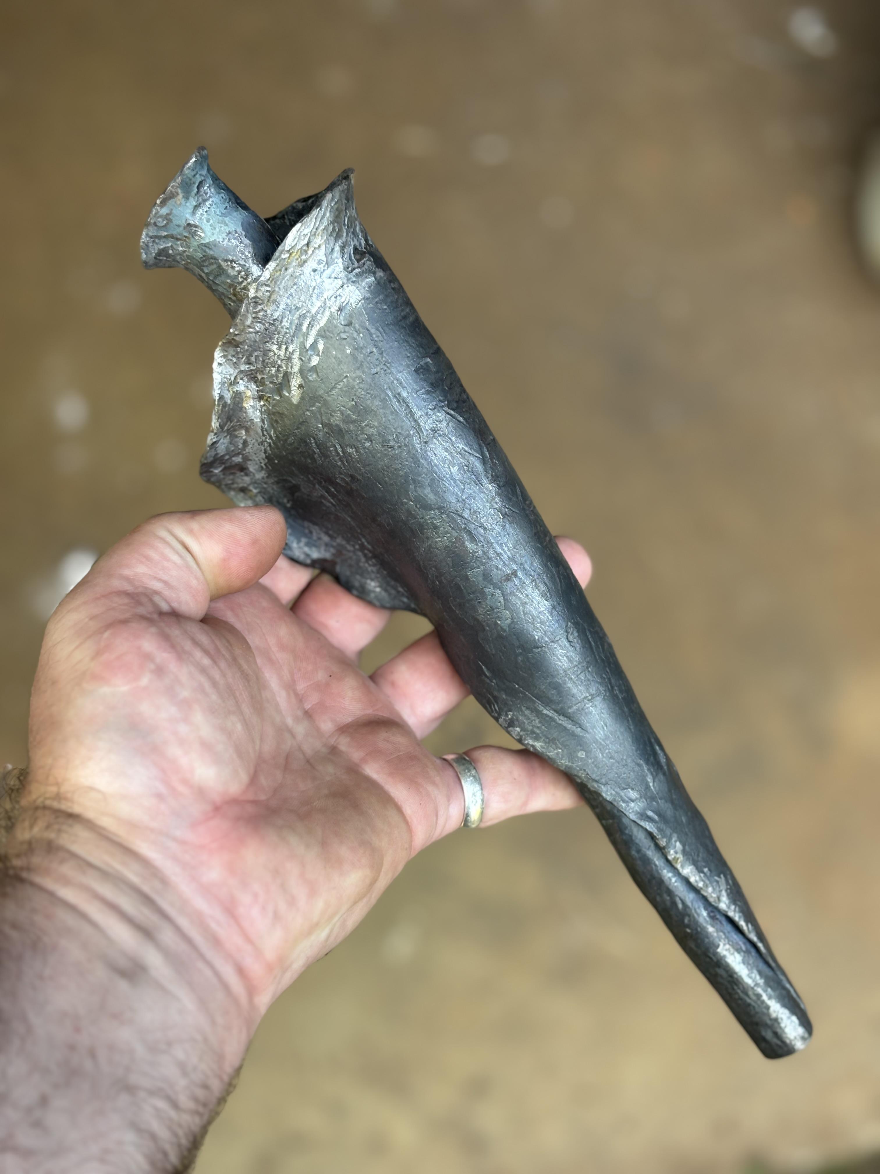

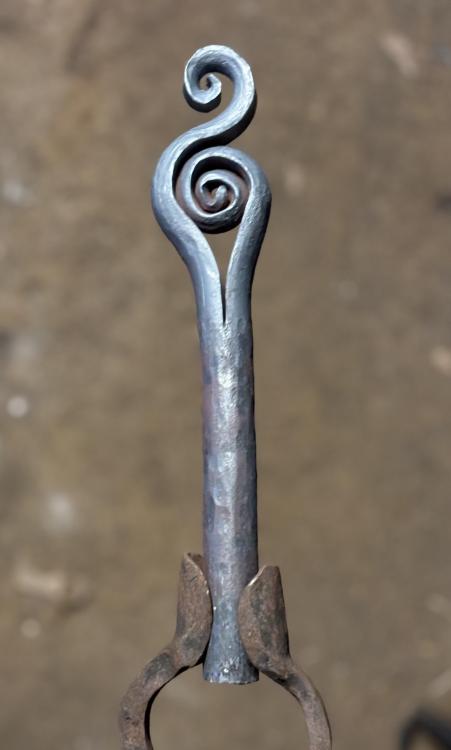

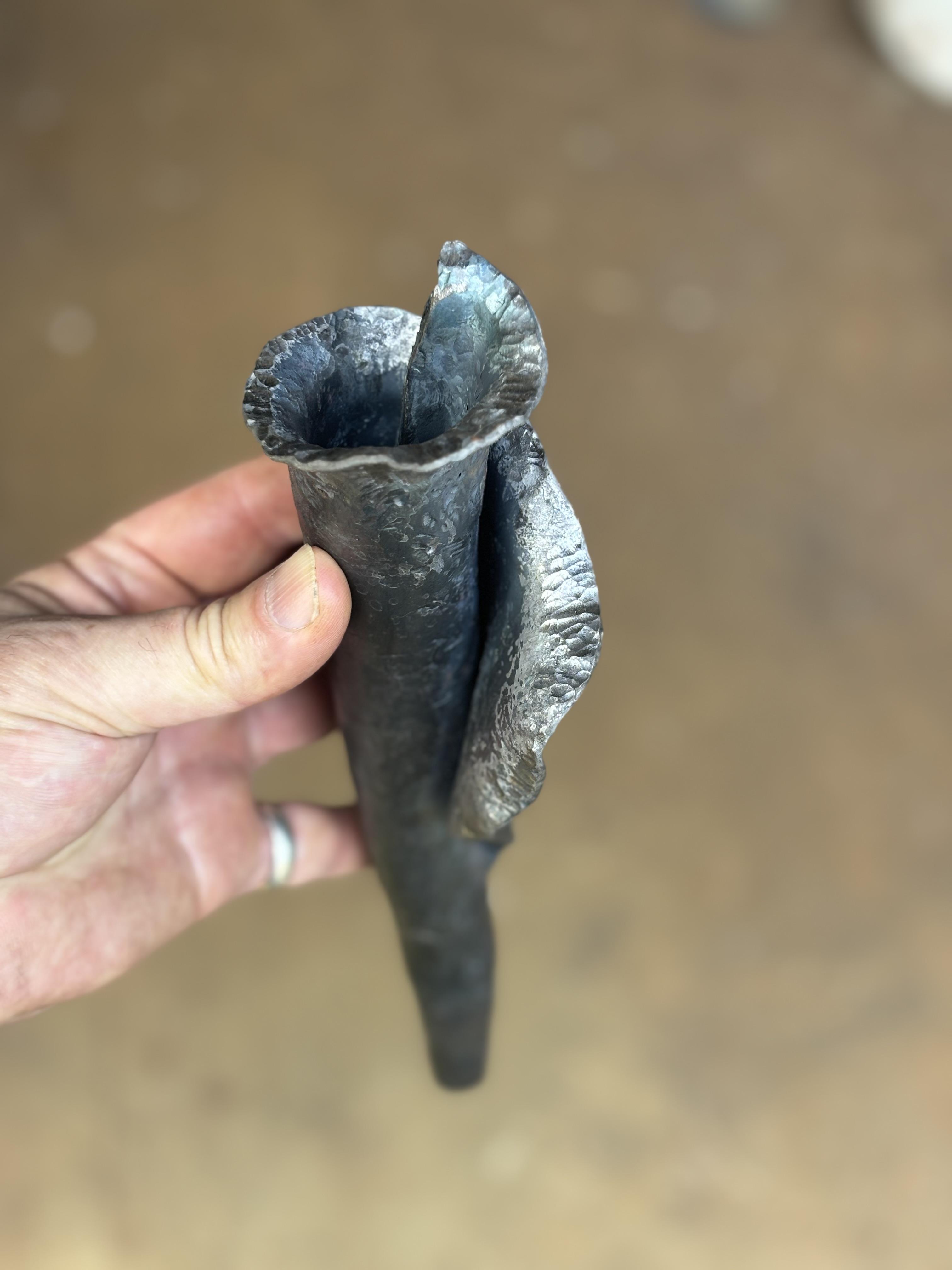

Another tap handle:

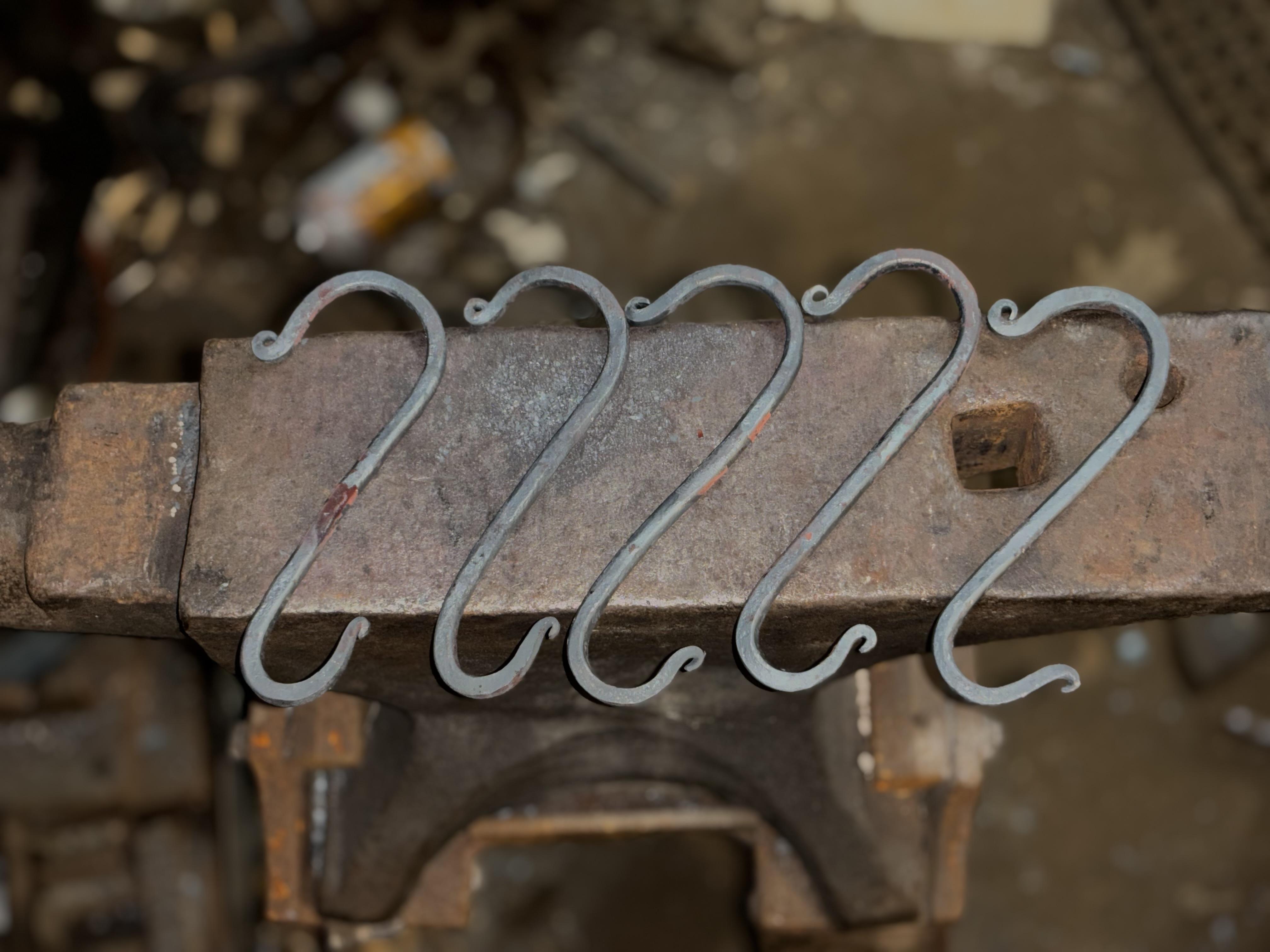

And a handful of S-hooks for a neighbor’s birdfeeders.
That might be my favorite John. Other than the tight swirly one.

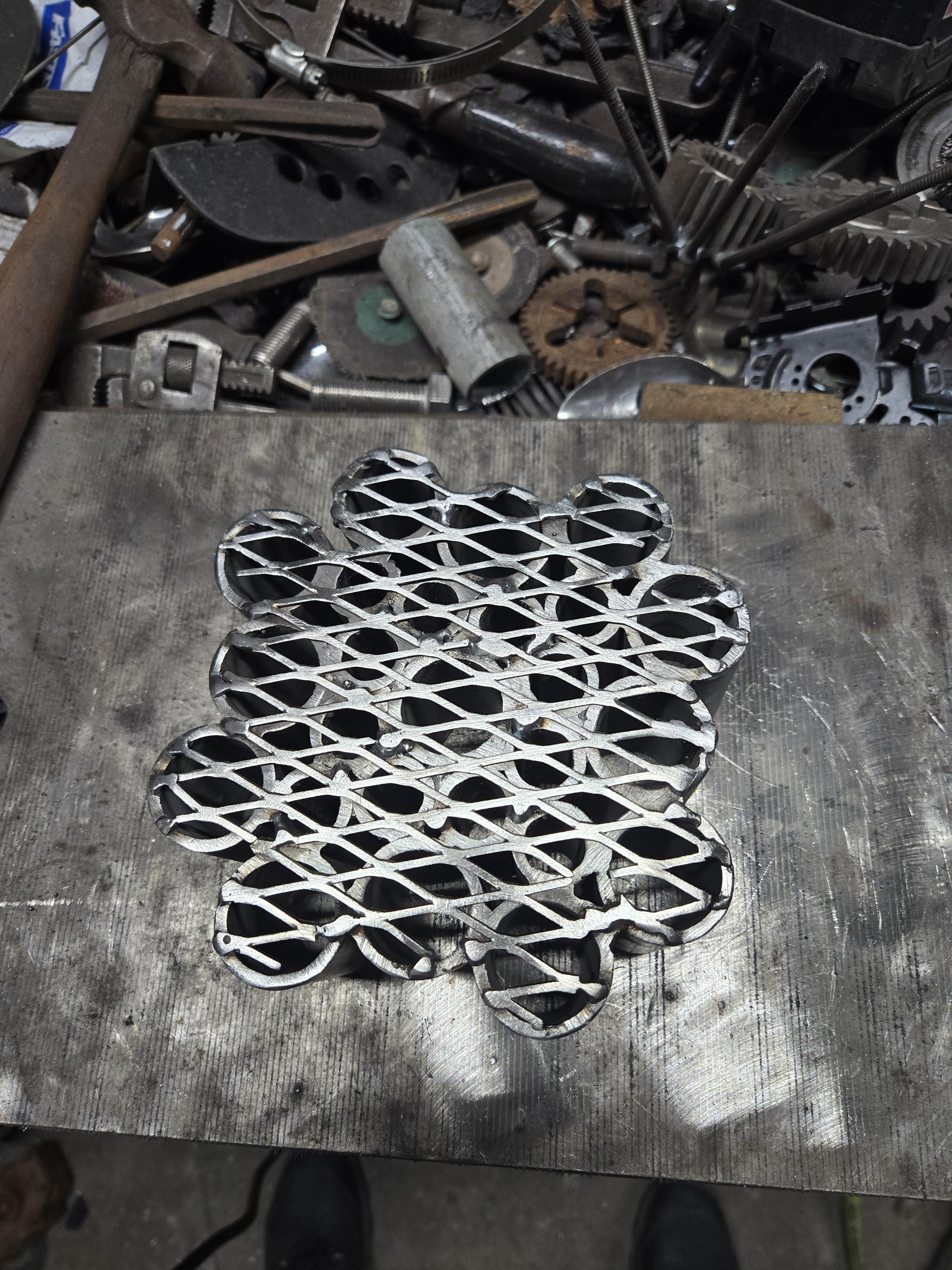

Cut and welded on the extruded stainless steel bottom. Had thought about making it square and with a boarder but again went freestyle on it. Got that cleaned up and painted it all black. Wasn't going to get it done but pushed myself to keep working. Been a rough week and I need to keep moving on something.

Real!y cool handle. I like that one a lot
Nice Das. That is exactly what I need too

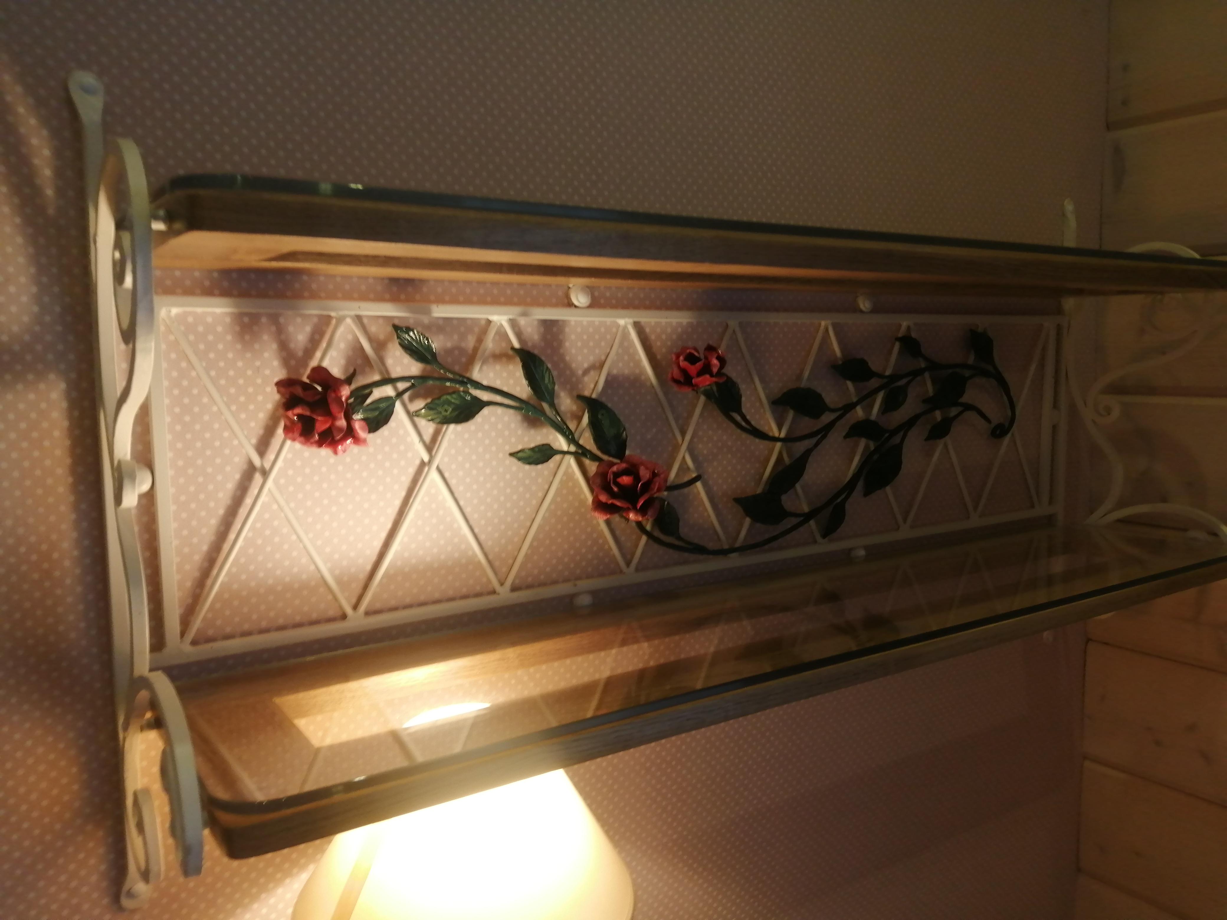

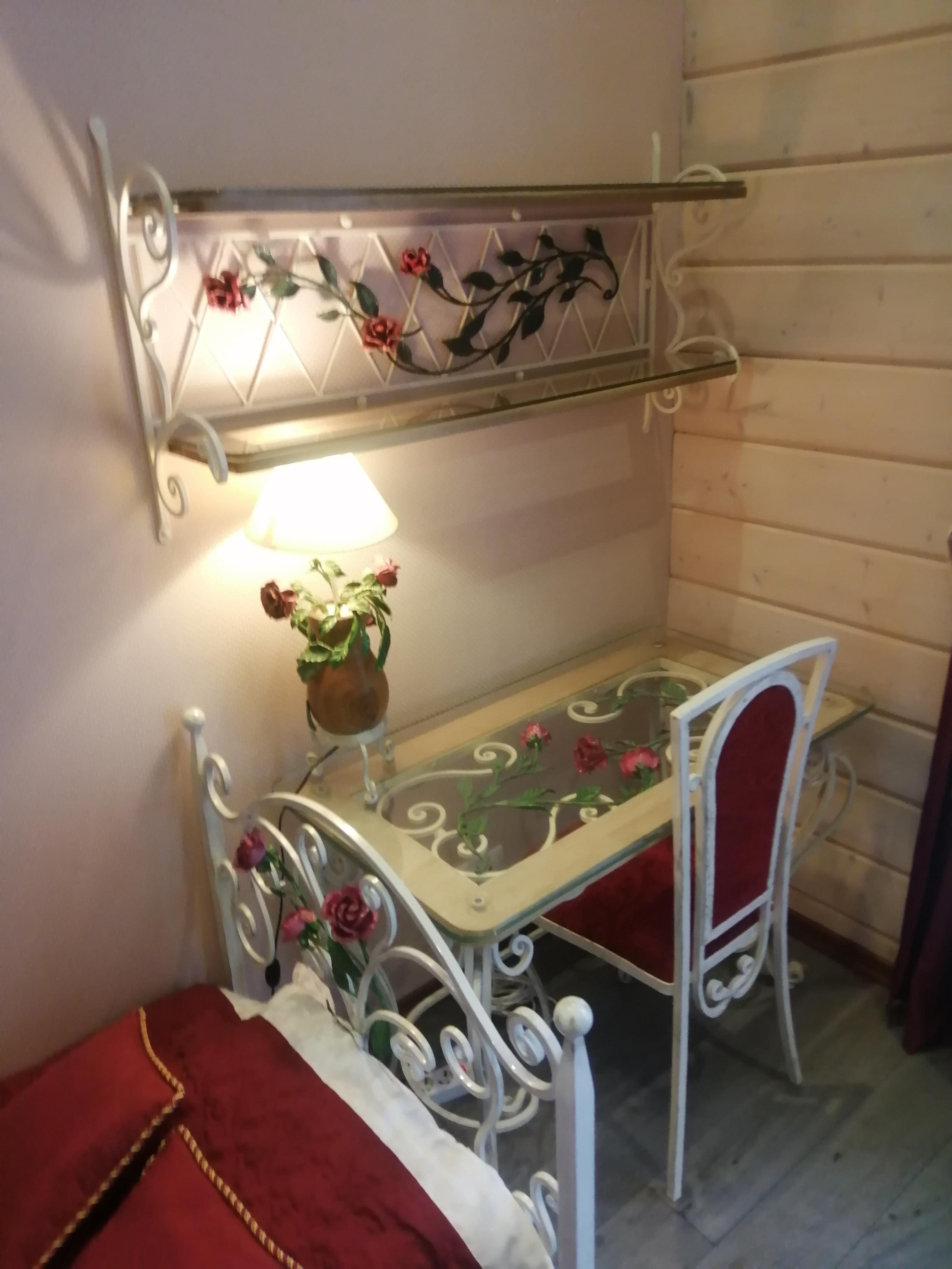

Several years ago I made furniture for a children's room. The customer asked to make an additional bookshelf. I installed it the other day.
