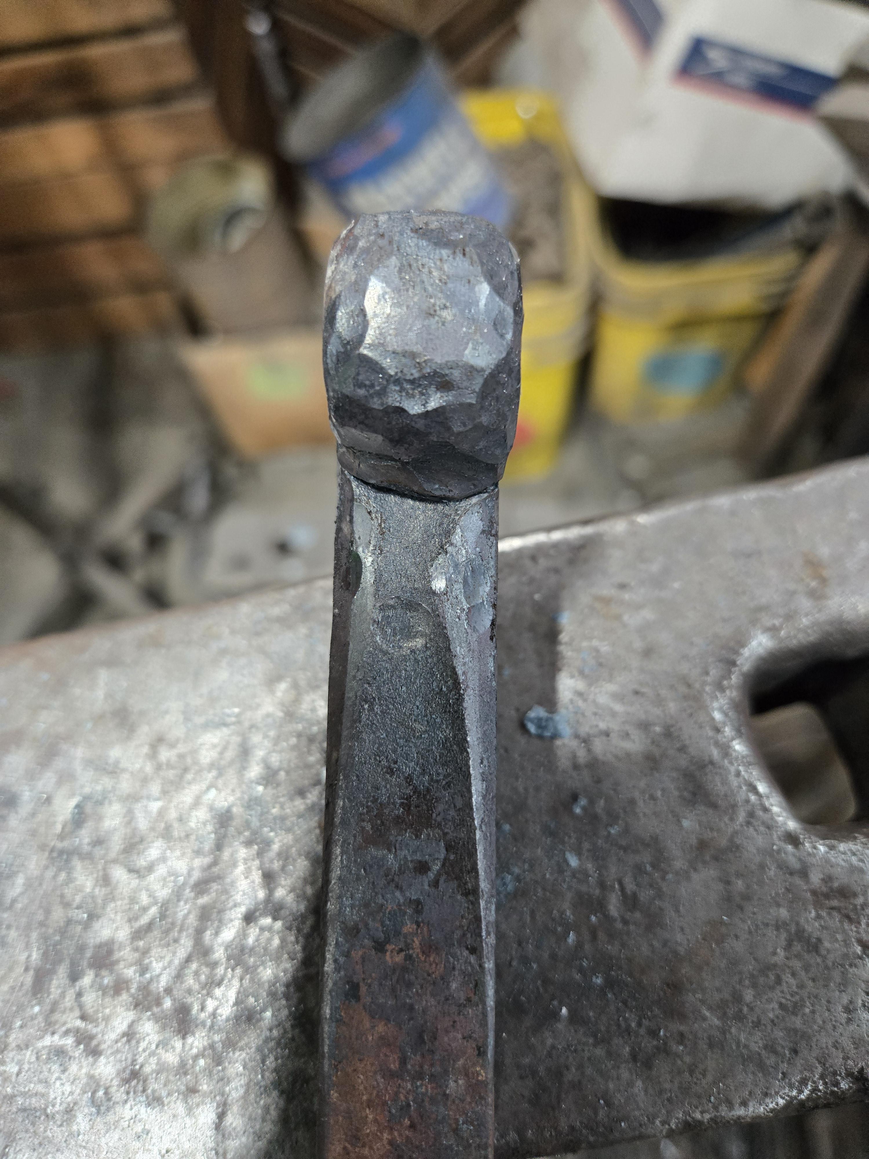

My holder is sloppy at best but works. I have an event to just forge whatever at this weekend before the group event to forge a skull at the later group meet so I have time to practice. Started a skull in 3/4" square bar to practice.

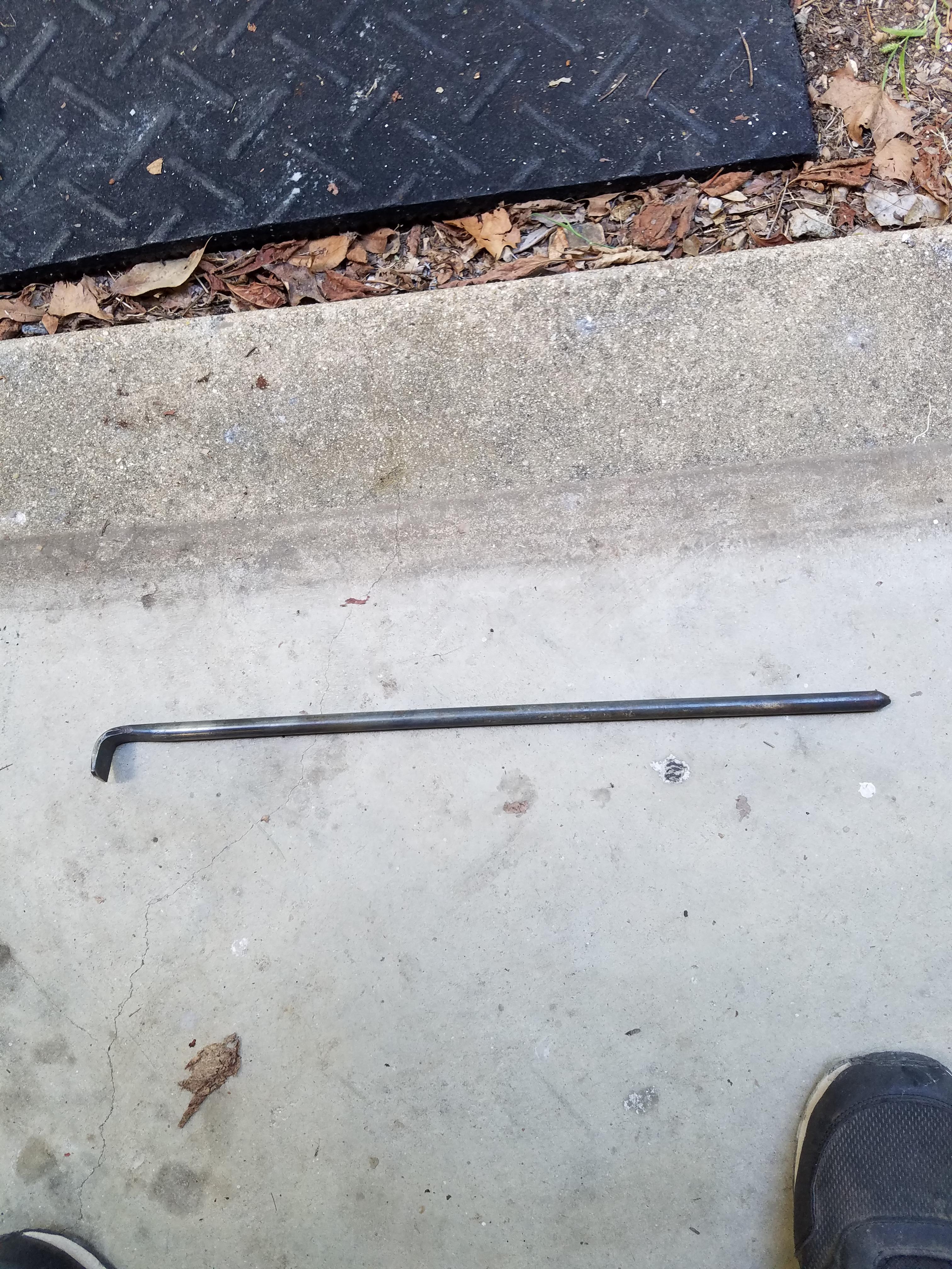

Haven't been in the forge in a while. Debi bought a 5X10 Tear Drop trailer to replace the 4X8 Tiny Tear drop we built back in 2012. It Has a lot more room 50 sq ft verses 32 sq ft 18 sq feet and 12v 110v electric with a kitchen area.
It is used in good shape that was missing the jack and a tool to set the stabilizer feet. The full size spare tire was mounted underneath but the previous owner just threw the spare in his truck as there was no way to put it up in the bracket made to carry the spare and we sure couldn't laying on the ground lift the tire to mount it.
So a couple of days ago I put my red neck engineering to good use and fabricated an adapter to go on an old screw jack, I had laying around that would hold the wheel secure while it was jacked up to mount the spare on it's holding bracket. Works like a charm, set the wheel on the jack, slide it under the trailer, align the studs with the wheel stud holes, jack it up and put the lug nuts on and tighten them then lower the jack & done. Without the adapter the jack will lift the flat tire to change it.
Then I fired up the forge and made a tool to set the stabilizer feet and remove the Baby moon hub caps. Only took a few minutes ounce I found the right stock in the resource pile. I first made it out of 1/4 in round mild steel and it bent when I tried it so I found some 3/8 round hardenable steel which works.
Need a tool, make a tool!

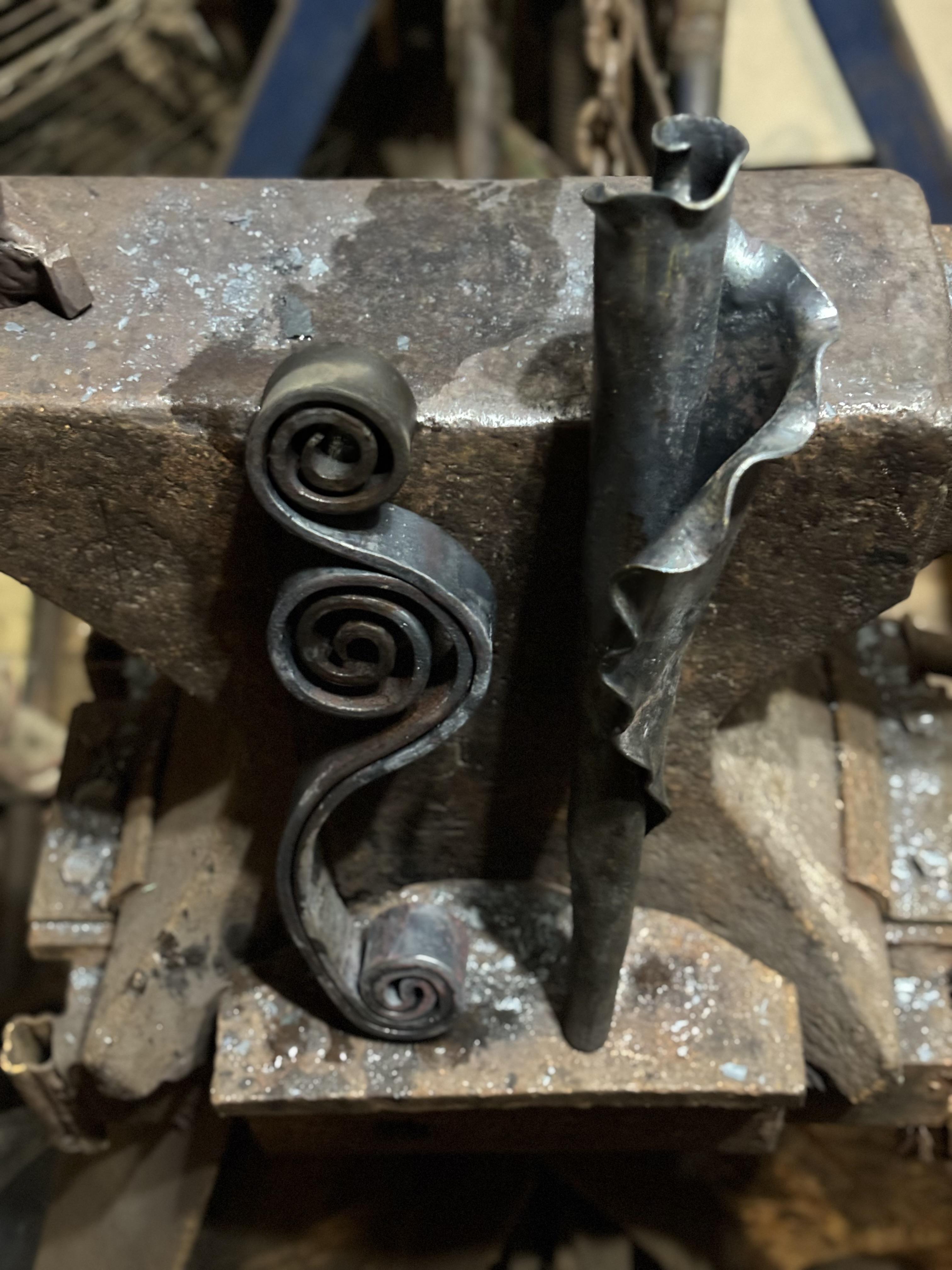

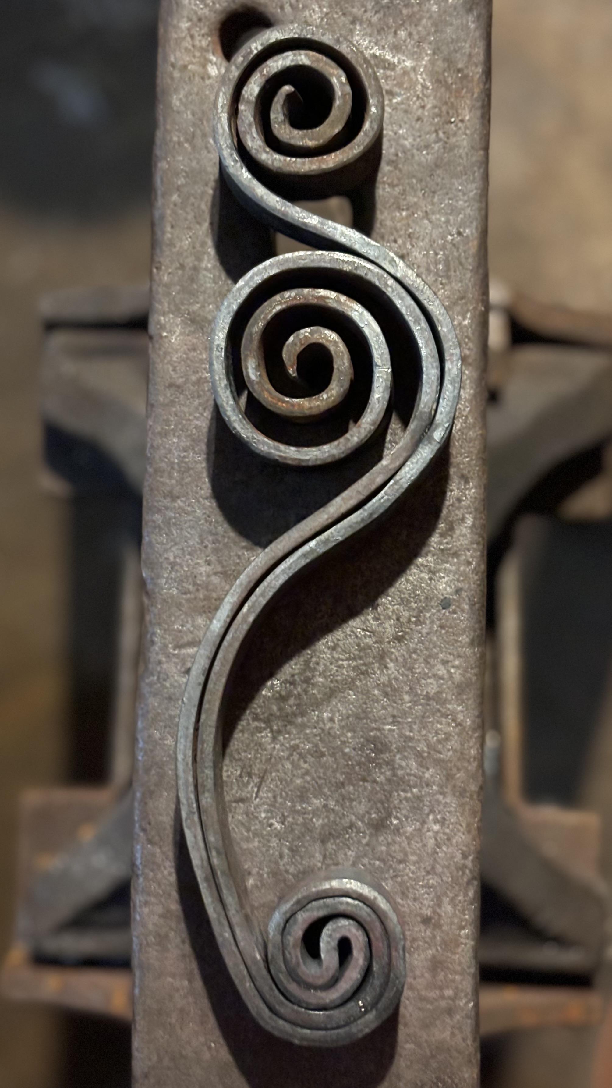

Tried out the scrolled C-channel technique. I’m hoping that my brewpub customers will accept this as a tap handle.
Had a meeting with the brewer last night to review this and the other tap handles I've made so far. This one turned out to be much larger than will work with his tap setup, so I'll unscroll about half of it, tighten up the remaining curl, and make the whole thing a good bit smaller.
One of the other handles needs some similar (if less drastic) modification, and the one that looks like a long tubular flower blossom needs to be remade in a thinner, less heavy sheet. Frankly, I'm happy with that; the initial version wasn't pleasing me anyway.

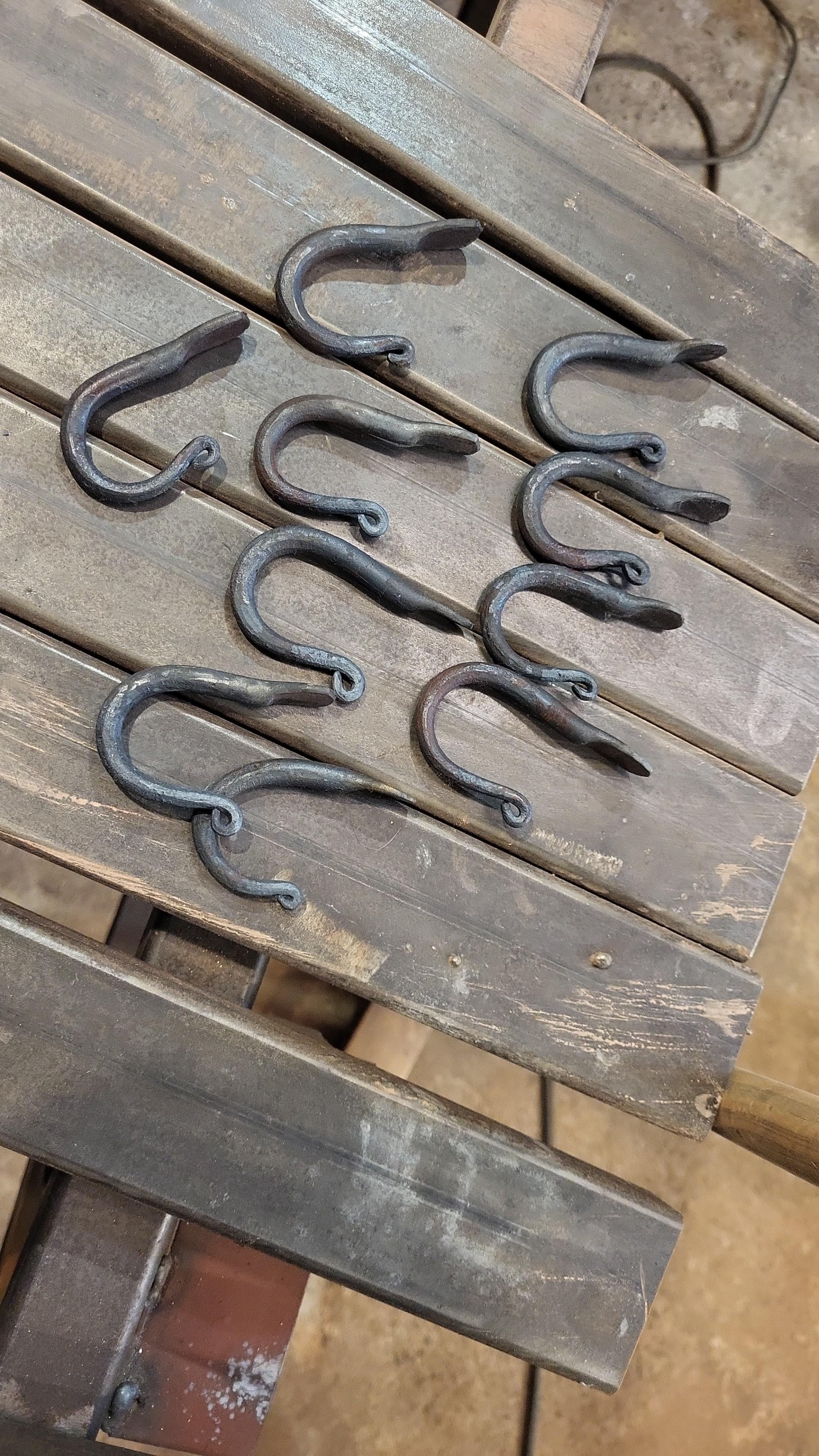

Somebody need a hook?
Actually, my wife needs them, so i cleaned the scale off and waxed them.

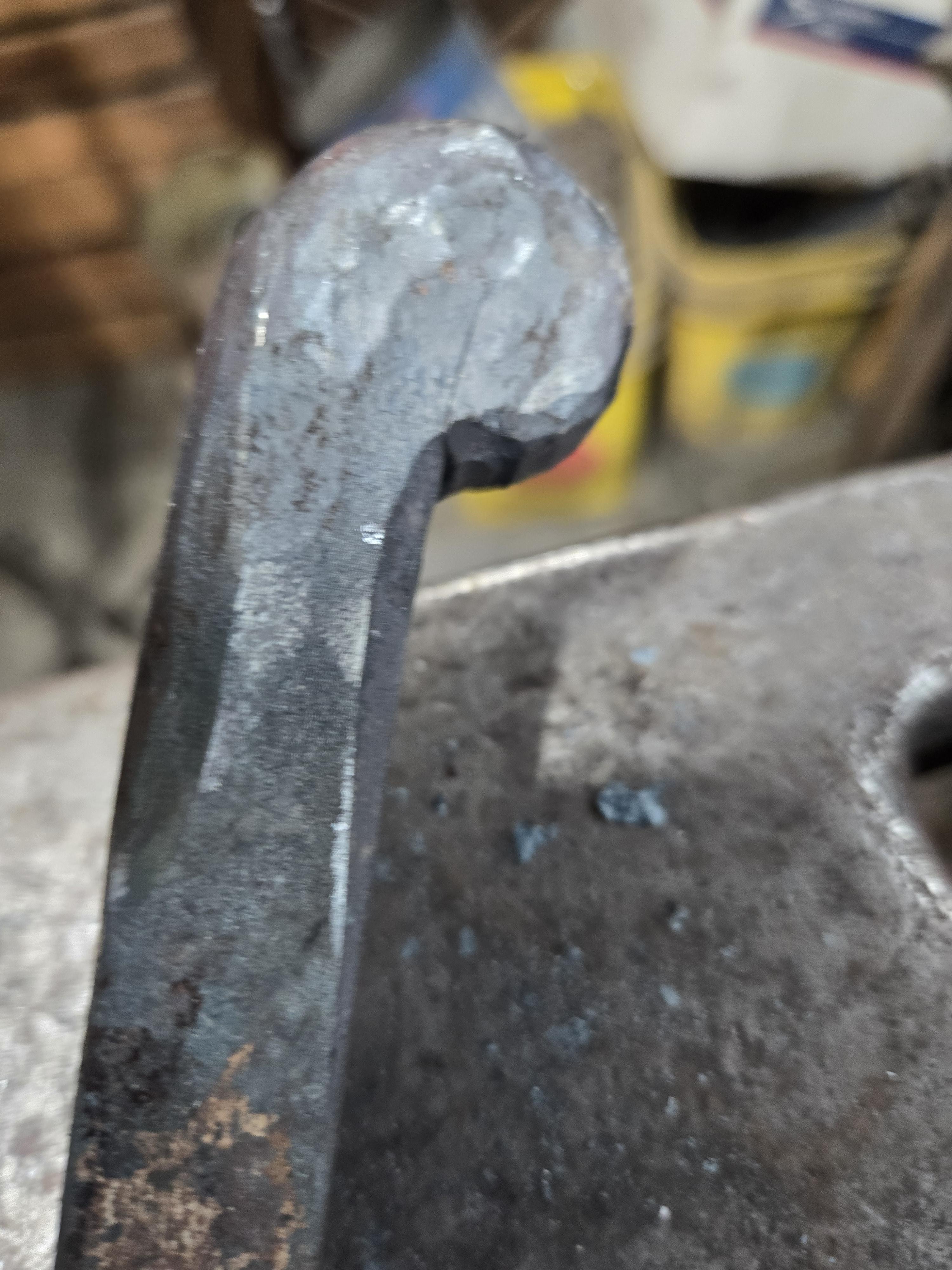

Finished up this skull in practice of my punches chisel and the holder. Turned out ok. Could always improve. 3/4" square stock.
Have a cane feeling to it.
With the skull being the knob of the cane.
No idea why.
It could be either at this point. About anything really.
Looking at it after getting some sleep, I'm thinking I could define the bottom jaw with one of my Fullering punches. Plus I think I could make a punch to define where the teeth terminate.

More work on the tap handles: after consultation with the brewer, reforged the lower part of the spiral one and forged an entirely new trumpet blossom.
I like this trumpet blossom much batter than the last one, I think it's in my top 3.
