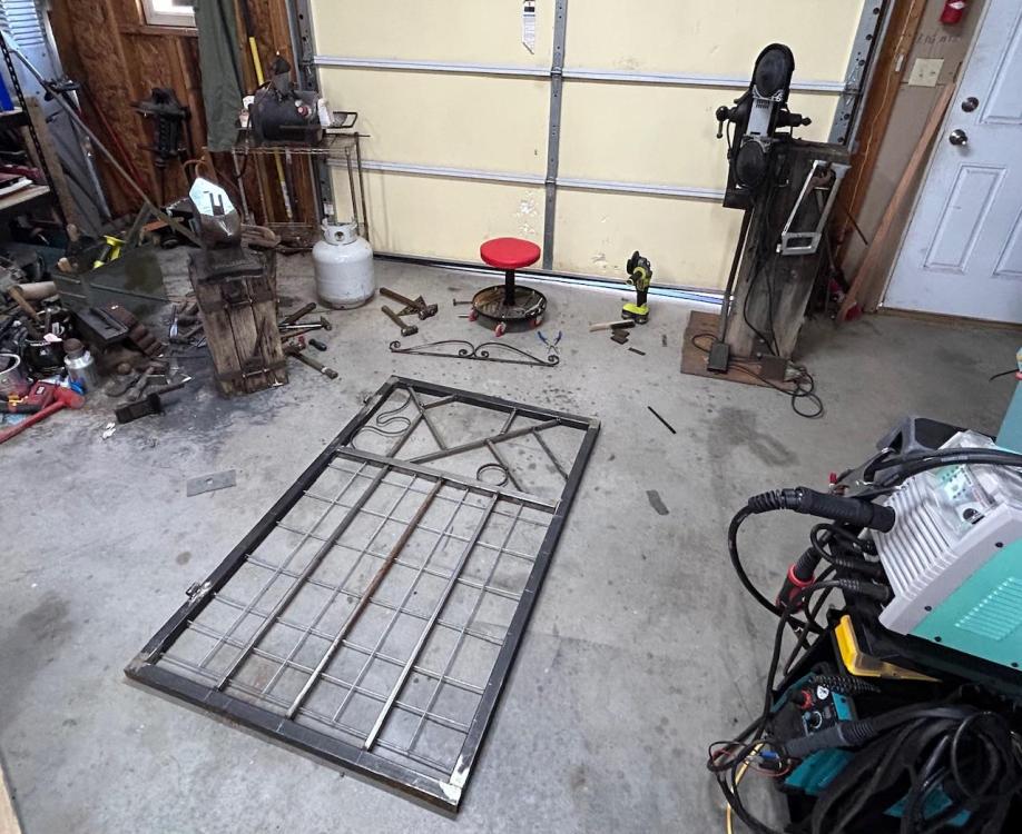

My first real fabrication project. 3’ x5’ gate. I am pretty happy with it and it swings with my 185 pounds riding on it.
That is a god looking gate, it should keep wanted critters in and unwanted critters out. Good job.

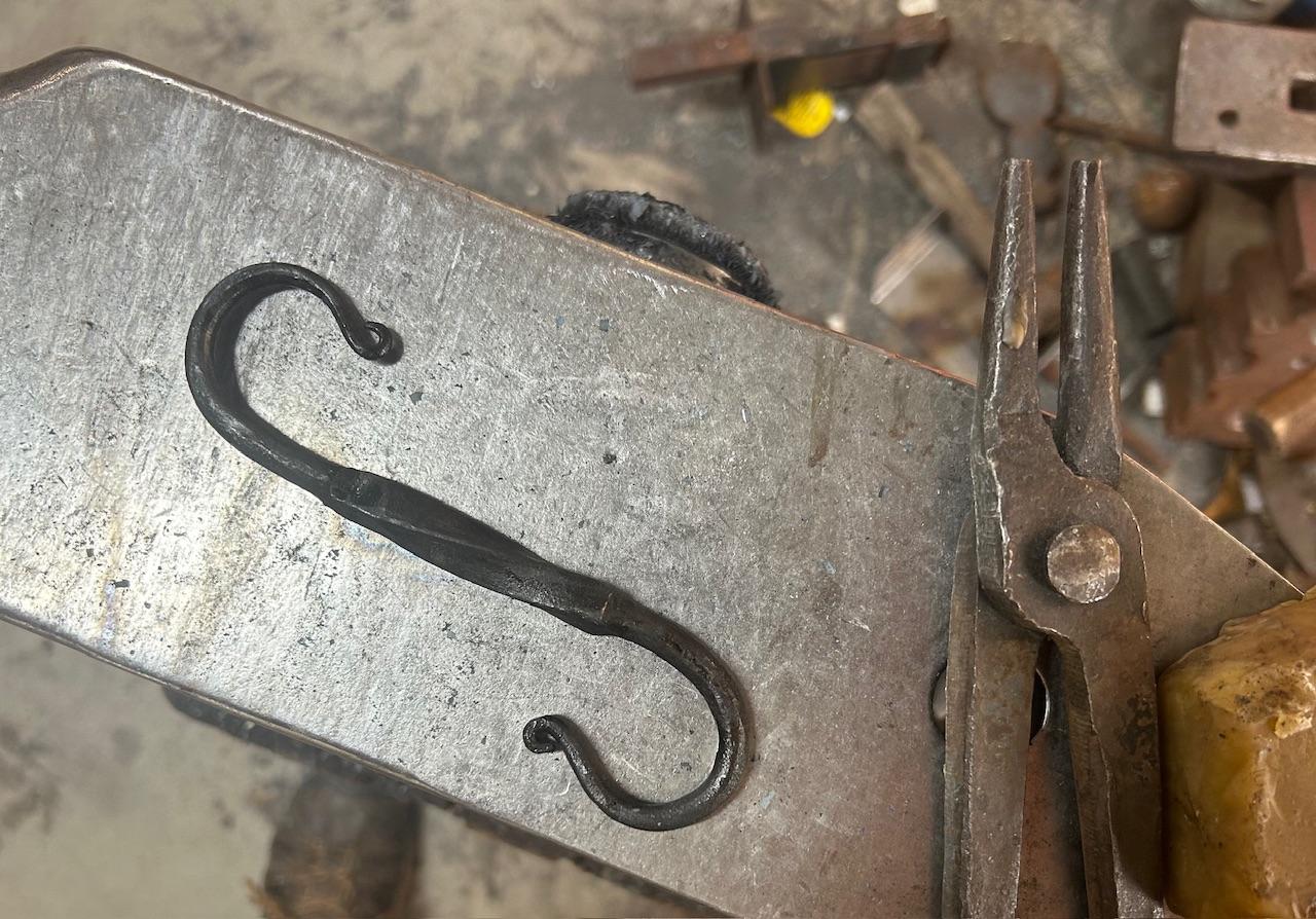

Thx IFCW, also lit the forge for a bit and made another S hook and did some general fooling around as some would say  :-)
Thanks for looking.
RP, I really like the transition from the square twist to the round section for the hook. It's very clean. Is that just hammer and anvil, or is there some kind of guillotine tool or spring swage involved?

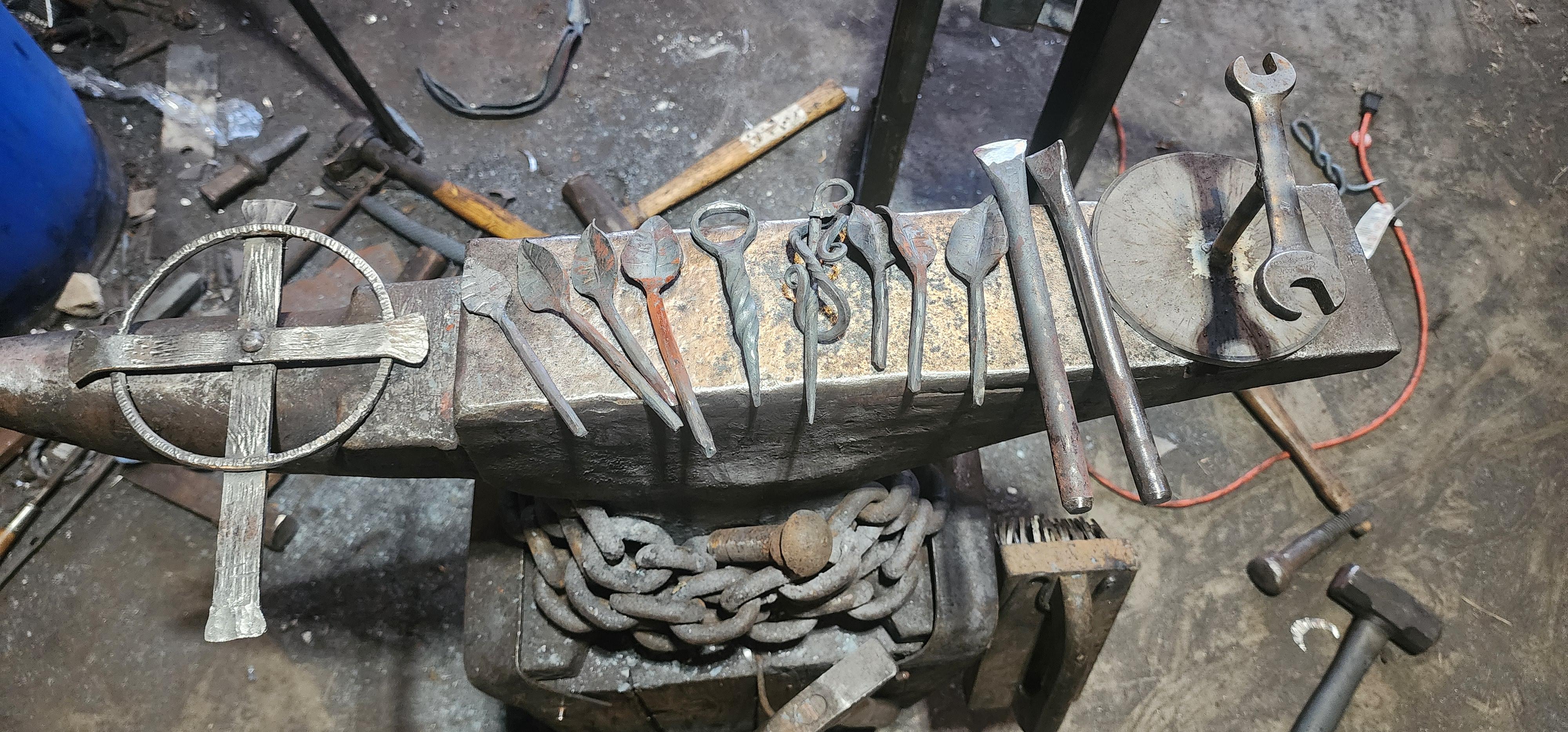

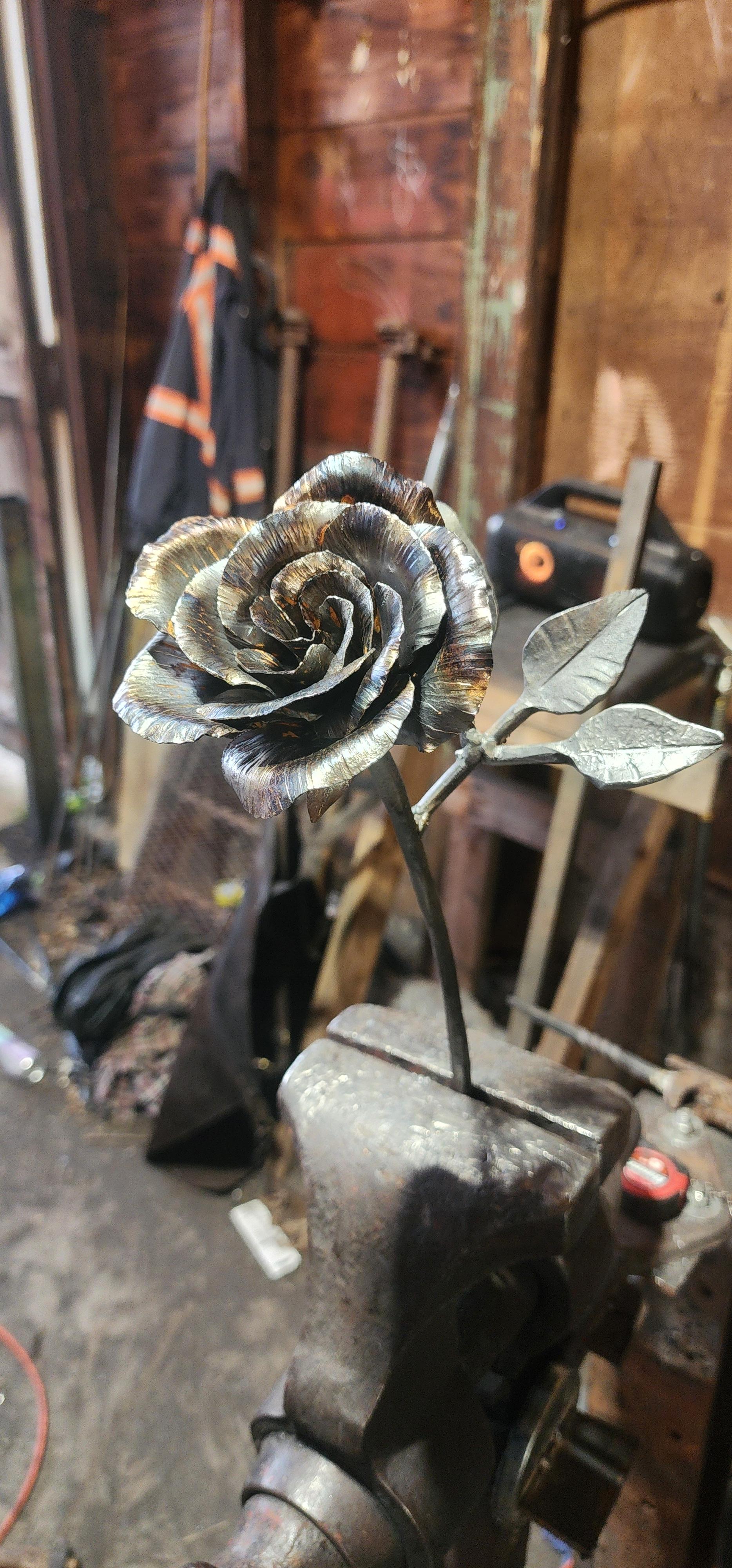

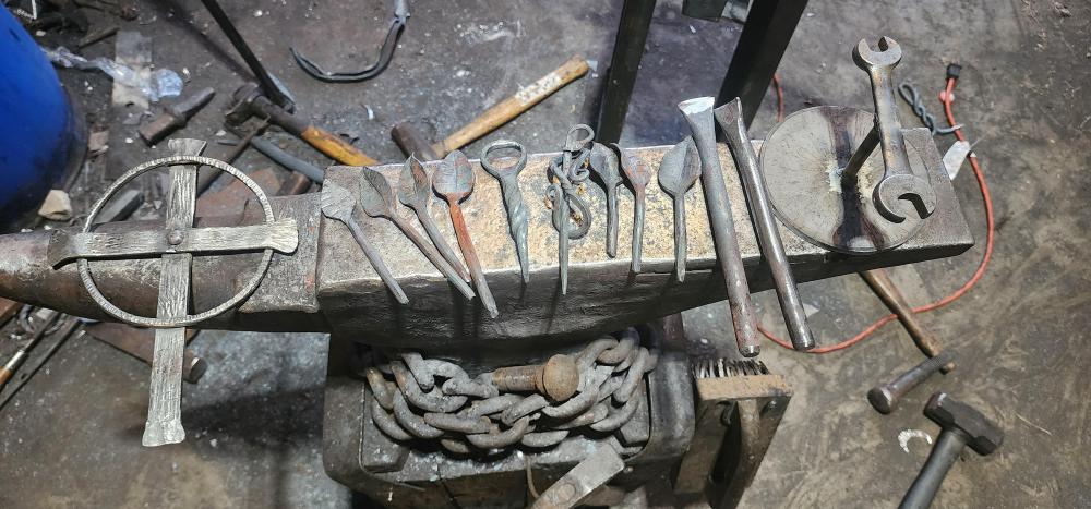

Nice tongs Prag.  It's a great skill to develop,  I need to practice it more often.  I got a full day in the shop yesterday and I am feeling it today.  Made a bunch of leaves from some 3/4 inch round stock for the roses I've got piled up to finish,  a brooch/hairpin, finished up a cross that I had started a while back by making the cross piece and forging the circle, made a hamburger press with a wrench handle,  a double hook, a new viening tool and single bevel chisel for the freidrich's stars I'm developing, and i can't even remember what else.   Tonight I'm going to try a russian rose.
Chad i like that cross.

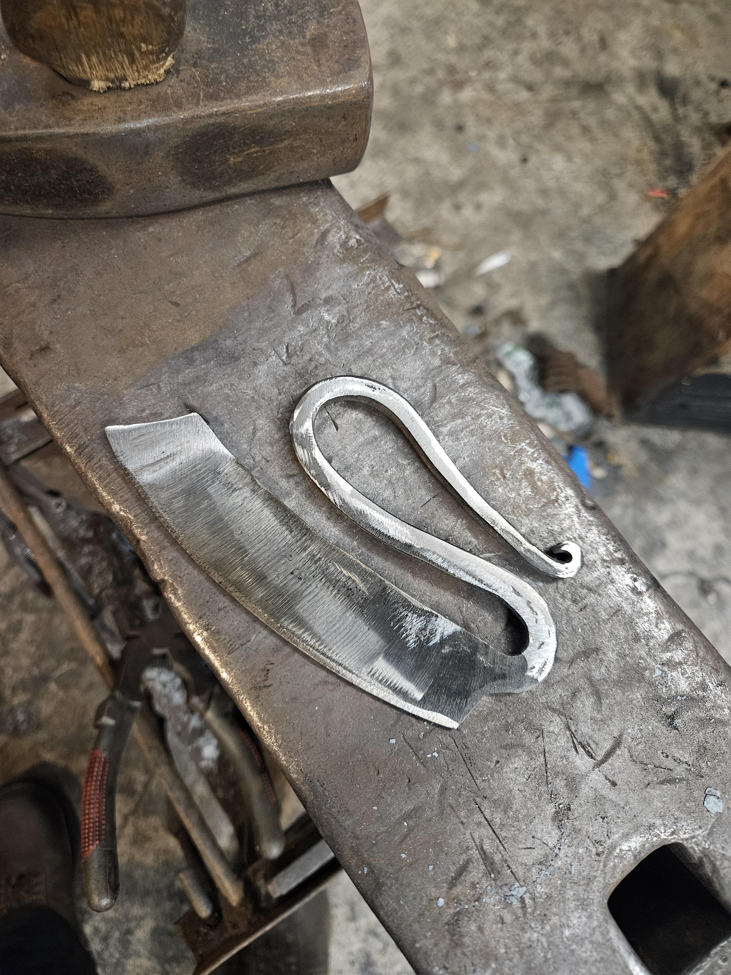

Got a little forge time in. Finished shaping an herb chopper i started a couple weeks ago. Now i just need to heat treat, grind and polish. It is for a freinds daughter that has recently become a chef. I am thinking a nice piece of cherry in the loop will look quite nice on it.
9 layers of 1095/15N20. I do not make many knives much less patern welded. I put a few drill points along the billet to maybe get a raindrop effect. No it does not have an edge yet, just an optical illusion of one being there.

Rojo, I really like that square-to-round transition on your S-hook. No swage or monkey tool even? I can't imagine getting all four sides necked in without assistance of some sort of tool.

Chad, dang man - you were BUSY! A lot of good lookin stuff you cranked out in one day.

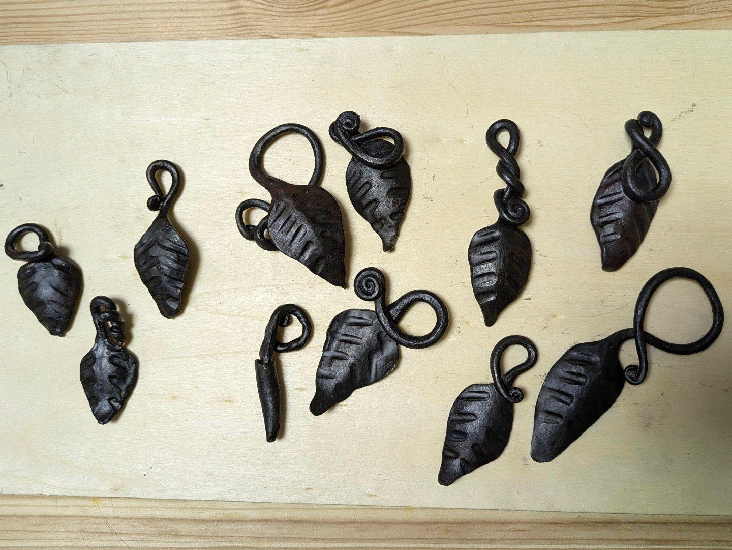

This week, I've been working on leaves, leaves, and more leaves. Started out doing a few for a Weekly Blacksmith Challenge group on Facebook and then decided I really wanted to get more efficient at making these. In the event I ever actually accept an invitation to demo, it would be nice to know I had something I could reliably do in under 30 minutes. I'll be working on these again tonight - and likely the rest of this week. I ordered some keyrings so some of them will become keychains and some will become pendants. The rest will go on a windchime for my sister - as soon as I get that forge welded ring project done, lol

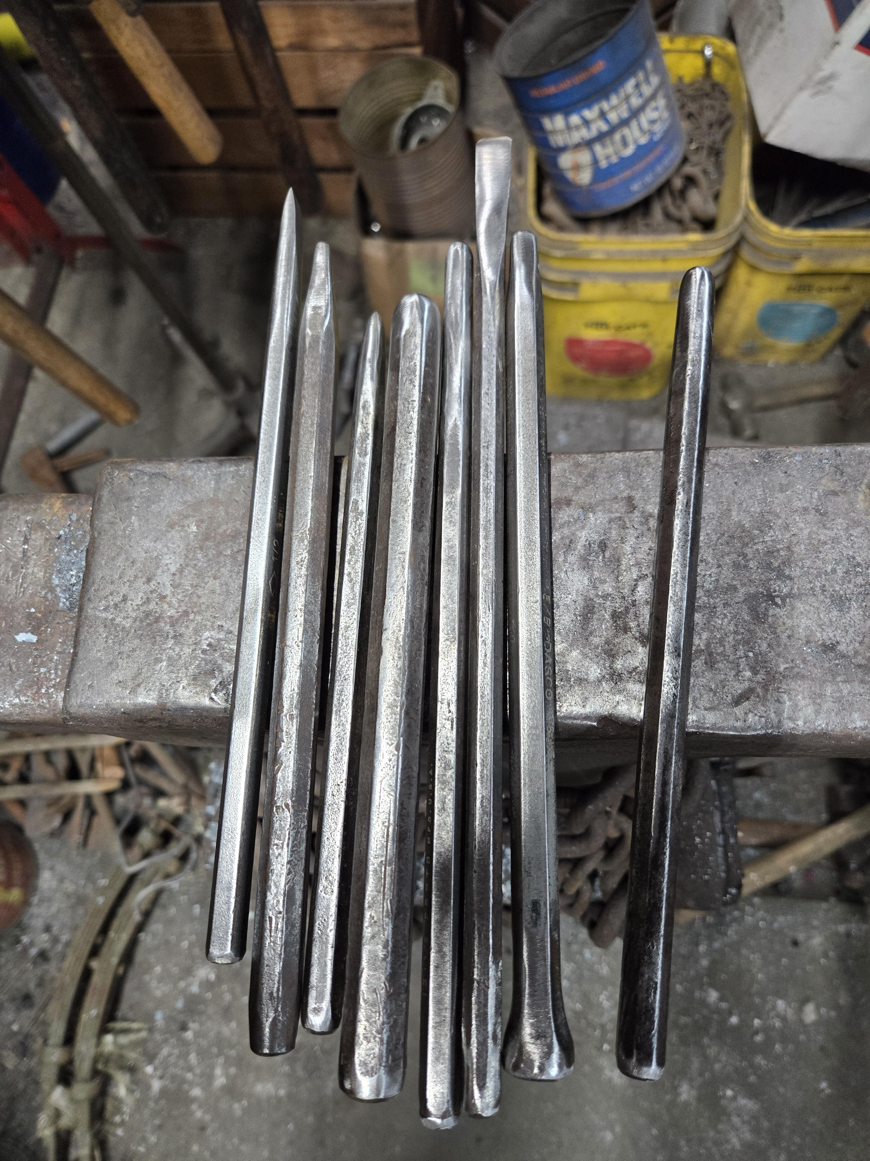

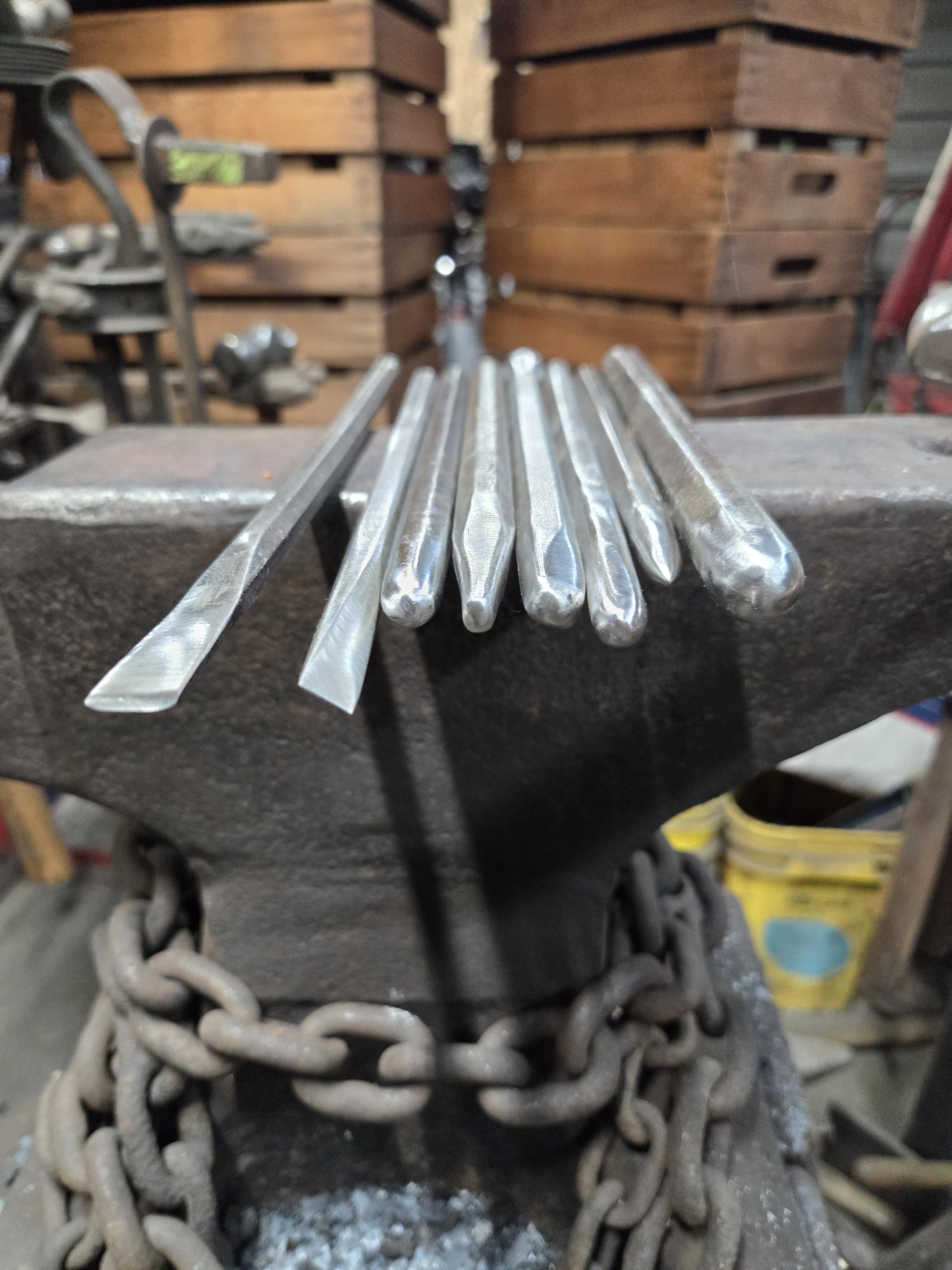

I've been asked to forge a skull at an up coming PAABA meet. This will be the first time I haven't demo's using my own kit,  in someone else's shop and with their forge and vise and whatnot. I'm pretty stressed lol. I know there is no need to be.
Anyway I've been trying to remake some of the punches and chisels I use in making them with longer handles. I've been using old star bits I've collected from fleamarket finds. Once I'm good there I plan to practice so I don't look the fool in front of people that know what they are doing. I can mess one up out in the field and people still like it. I know people with more knowledge deserve a more precise demonstration taking less time than I might normally take.  I can do that I just need to practice before hand. Plus need to test out the new tools. I am so much more comfortable in my home forge.
I won't lie in saying that I thought " why would you want Me to demonstrate?" at the offer. In all honesty I am very glad and honored to do it.

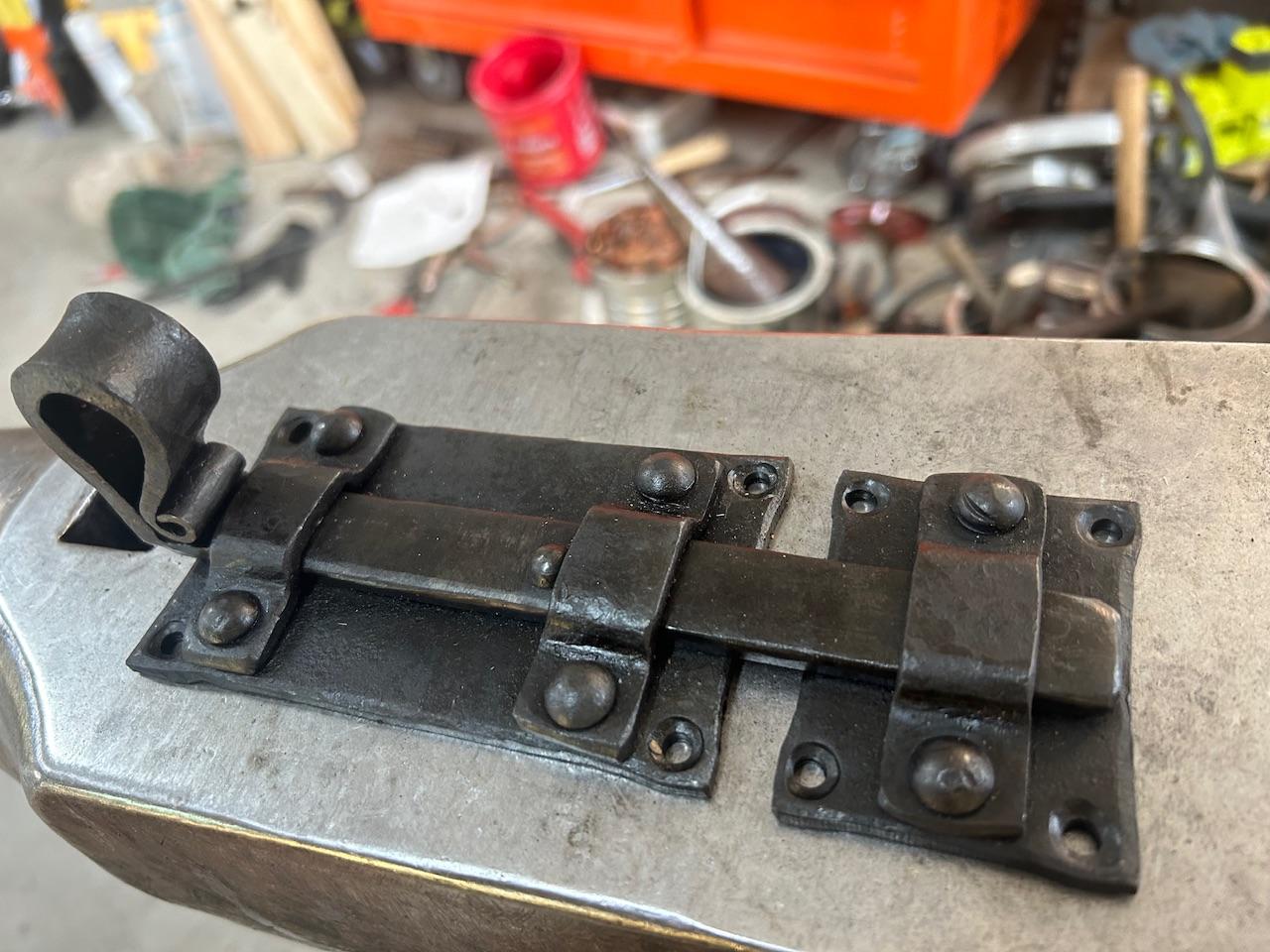

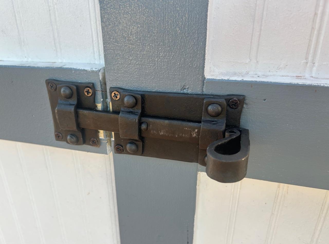

What I did in my shop today is finished the wiring and mounted these wall lanterns. I have been working on this  addition to my shop for the last 2 months for a dedicated forge area .
Took all day but I am super happy with it. I really feel like I have advanced to the intermediate skill level.
Need some longer screws and touch up paint but wanted to proof its function on my new well house. Thanks for looking.
PXL_20240905_010825836.thumb.jpg.859c89f67d768ee1da828c0dabf56929.jpgRojo, that looks really nice!
Daz, the main push behind me working on efficiency for these leaves is because a member from my local club suggested I demo them. I had the same thought as you - disbelief but also honored. I was also asked to demo forge welding awhile back but I declined, thinking I shouldn't be the one to demo because I only had 10 or so successful welds under my belt. Then I found out that the member who agreed to demo had less than that and basically had to crash course in preparation, lol
But a demo for blacksmiths is 200x scarier to me than a public demo, lol. I need to know exactly what I'm doing and as efficiently as possible. Then I need to record myself doing it while giving a pretend demo. I have insane fear of public speaking but I've been told I do it well. My process requires me to rehearse to the point that it's ingrained, so that when I get nervous and my brain goes fizzy, I can still do it.
I'm getting close with the leaves. We'll see.

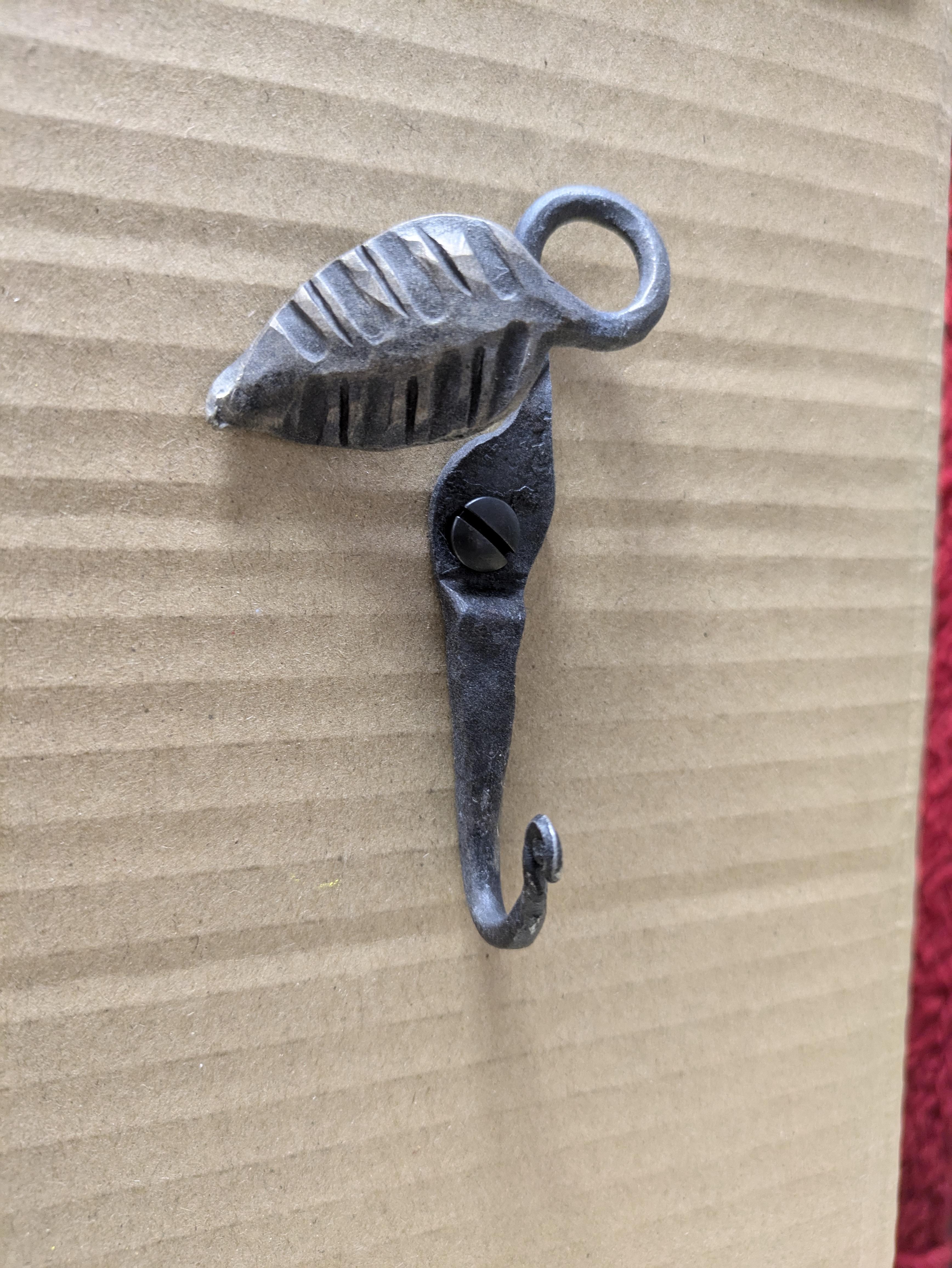

Tonight I just did one more leaf, and turned it into a small wall hook. I remembered at a demo by Matt of Cloverdale Forge at the Missouri conference that he added chisel marks between the fuller marks to add dimension so I tried that. I like how it turned out. He used opposing teardrop shaped fillers but I haven't made a big pair of those yet.
Only one because I got started late and the sun setting earlier than expected ended my session early. I need to figure out how I want to light that area.

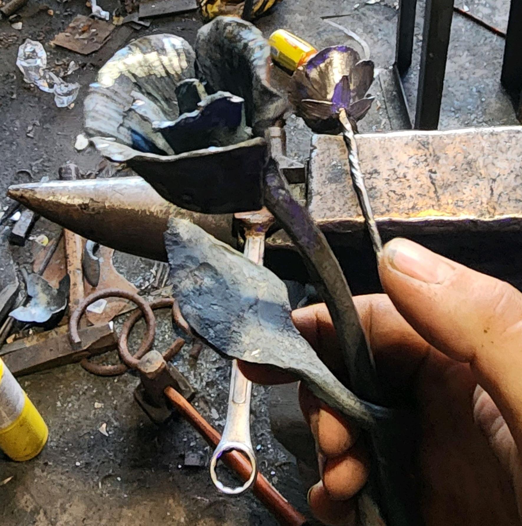

My first attempt at a Russian rose is kinda ugly.  1/4 x 1 x 12 inch piece for starter.  it turned out ok for a first try.  I'm going to do a bit of modification on subsequent attempts see if I can come up with my own tweeks.

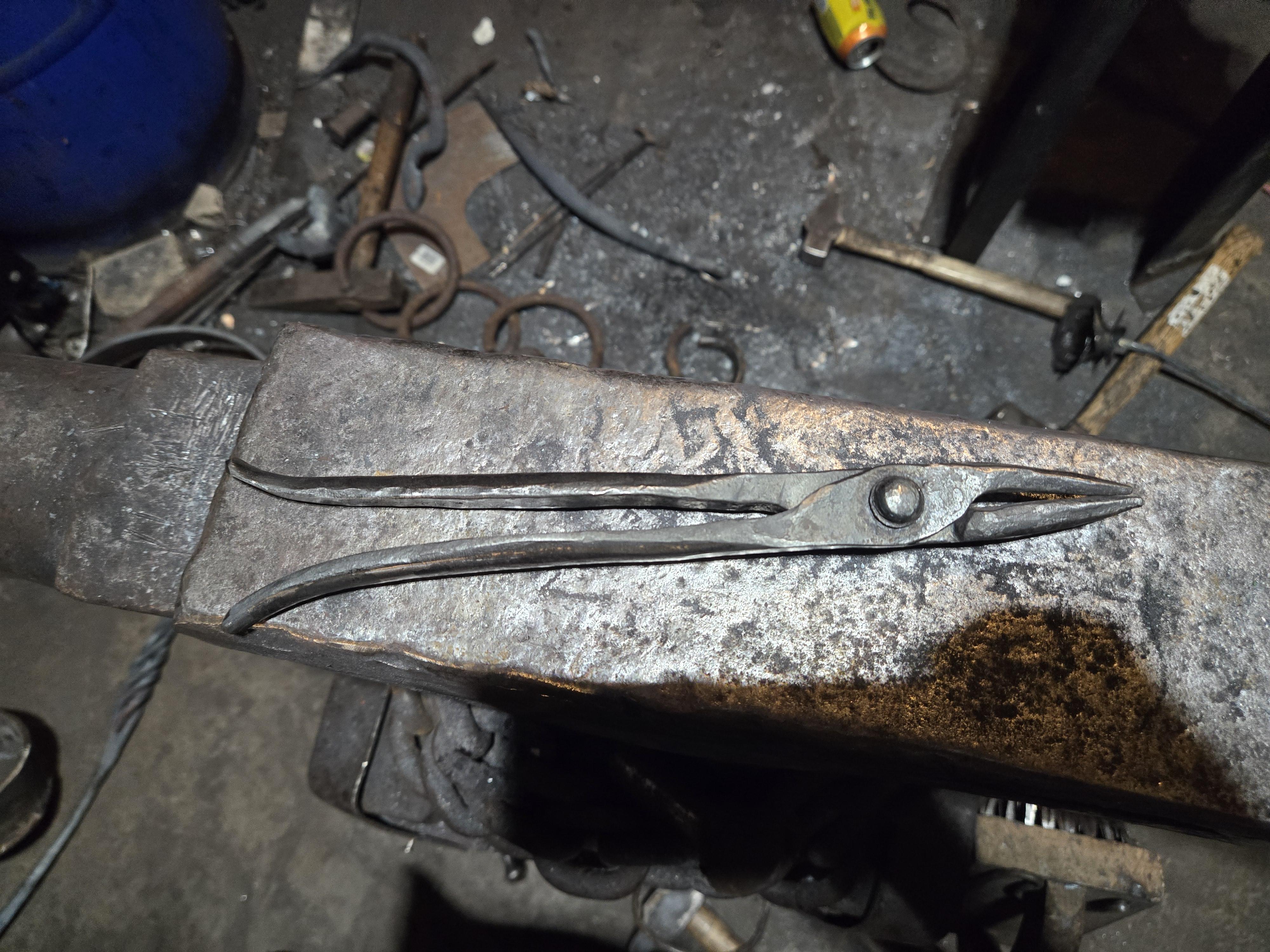

Ok, so this is the prettiest set of tongs I've made yet.  My first attempt at scrolling tongs,  5160 coil, forgot to measure the length but around 8 inches on the reigns and I worked them over my anvil top swage to make them half rounded.  These should help next time I try another Russian rose.  I did minimal cleanup,  some hot rasping and hitting it with the surface conditioning belt on the grinder.
Very nice!
Your scrolling tongs look good, how do they work? My one attempt at a Russian rose didn't work so well and it turned into other things.
